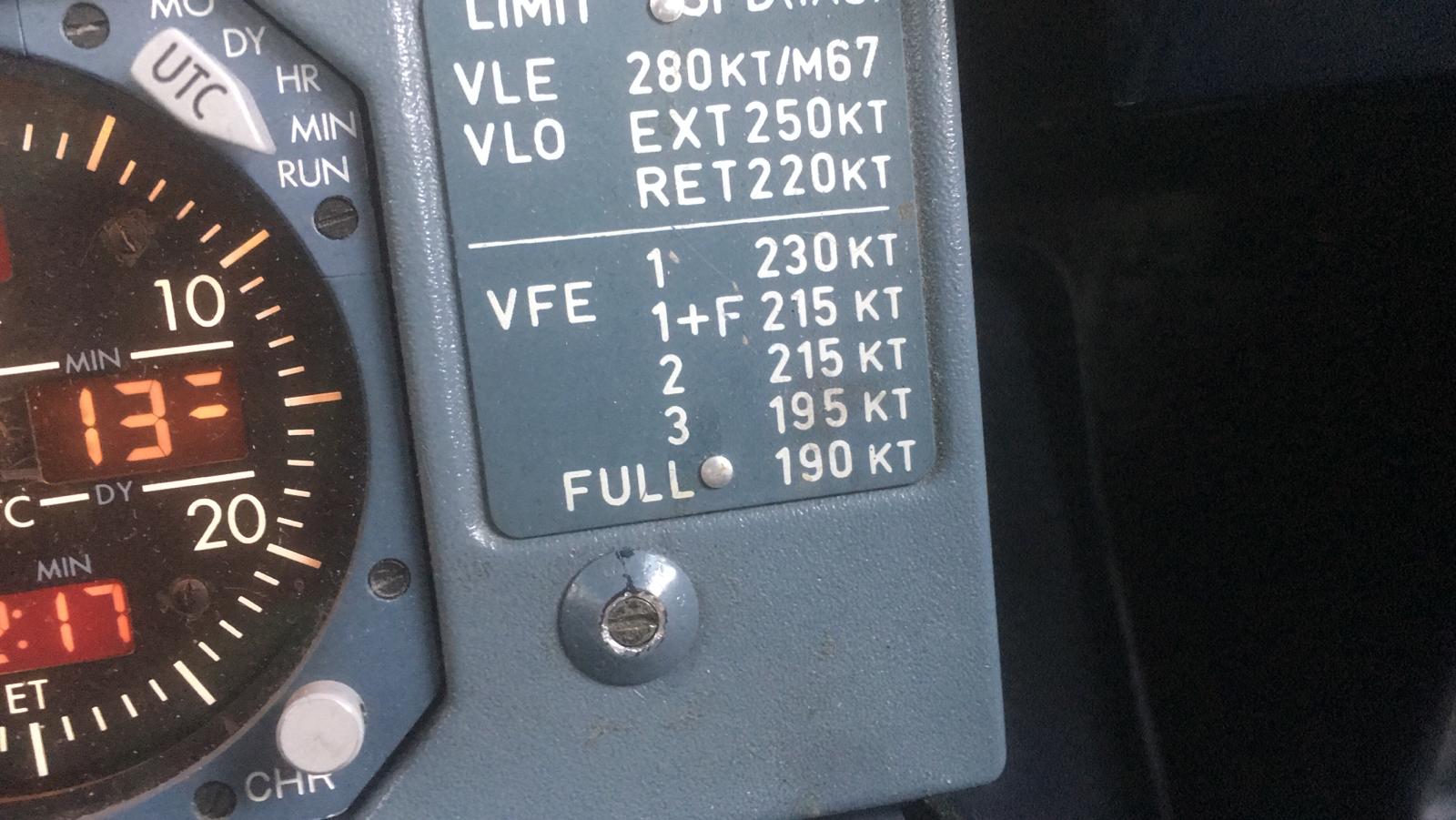

    @Dirty can the pilot overspend the flaps in the airbus or the computer doesn’t let you do it ?
    1.)
    If yes, did you experienced a situation where the aircraft is shaking a bit in this case ?

    I'm pretty sure in most modern aircraft extending the flaps at speeds well above the limiting speed (VFE), the SFCC (Slat Flap Control Computer) will not execute the command. You can move the lever, but nothing will happen until speed is below VFE.
    If the flaps are already extended (e.g. on Takeoff) and you increase the speed beyond VFE, there is an "auto flap retraction function" that will retract the flaps 1 step for you.

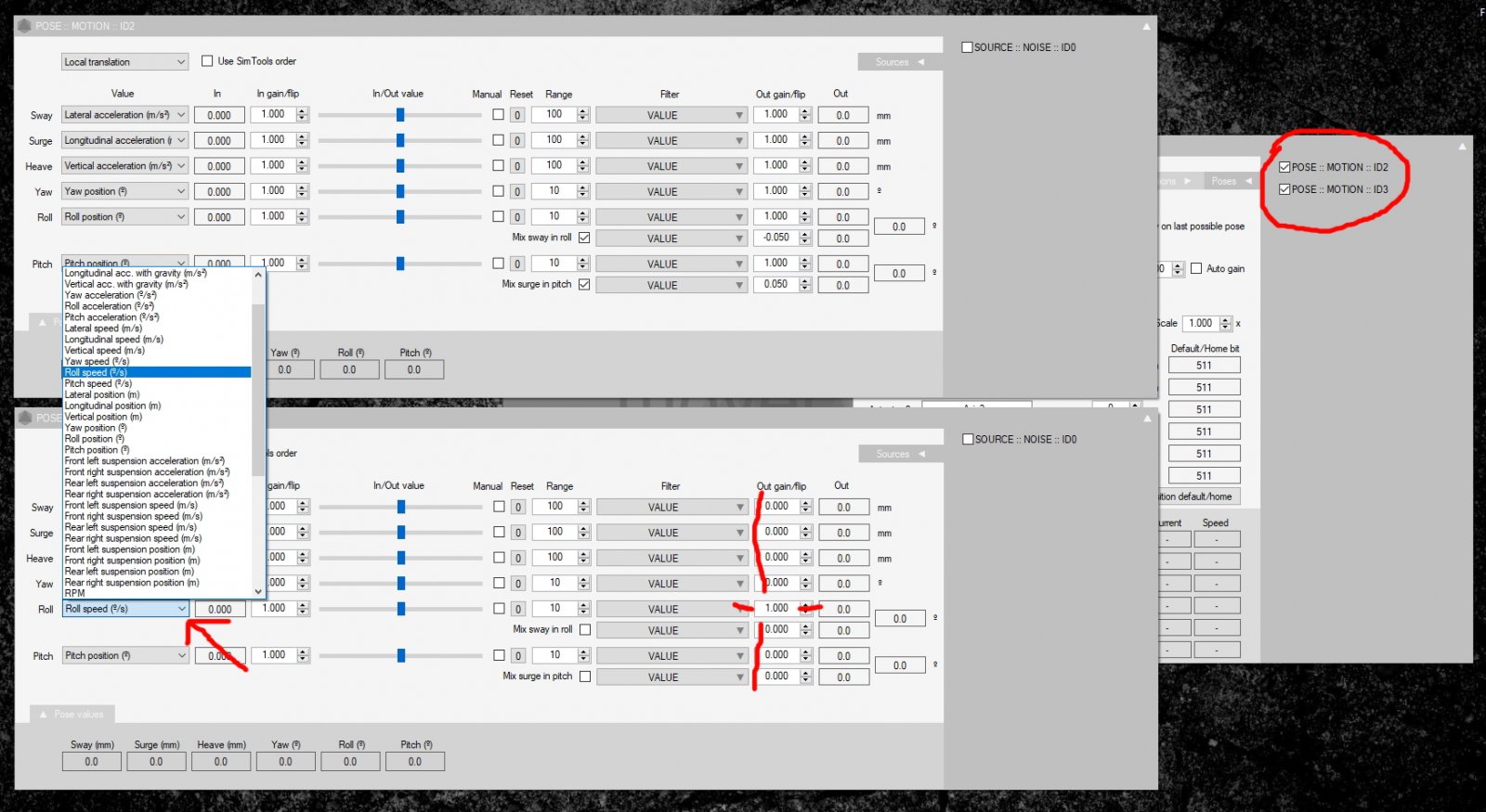

    programmed roll speed in roll axis as you proposed and that's perfect ! Like supposed roll world inclinaison didn't give the information for a bump ( you know , i speak about the brim painted white / red on the race track ) . Using the roll speed the feeling is really great , it's like the real car when you jump on the brim !
    Thx

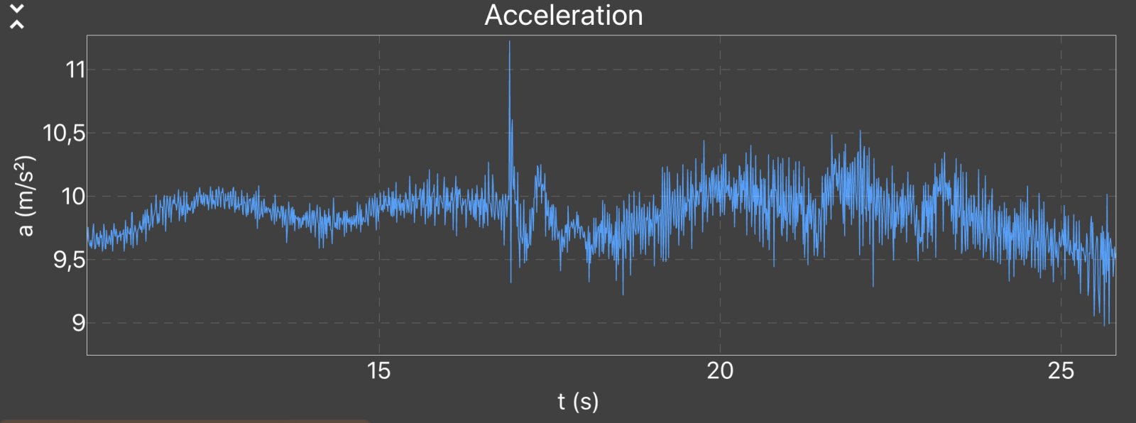

    Just recorded the RL landing gear drop kick and additional vibrations on A320 from third row.

    I have felt it thousands of times, but it's nice to see the data :)
    If you want to model this, here's what I'd consider:For gear extension, it is really about the moment when the gear uplock releases and for a split second it feels like dropping a bomb. The rest is barely noticeable, but THAT moment is very noticeable. It's a positive vertical (upwards) acceleration. The graphic shows that really nice.
    On retraction you feel almost nothing except a very faint humming. But here's the thing: The nosewheel does not have brakes! So it will retract into the gearwell while spinning at ~ 150kts. On A320s it will just keep spinning for maybe a minute or so. After 10-15 seconds it will reach a frequency that matches the resonance frequency of the gear strut and THEN you will feel the nosewheel shimmy under your butt for about another 10-15 seconds. Newer jets are not so bad, but in the older ones I actually thought it might as well be an uncontained engine failure.
    Dirty :)

    That graphic shows a lot more actually!!
    A few seconds before the spike the gear doors open (jitter increases) then the gear strut unlocks (spike) but it is almost immediately caught by the hydraulic actuators (downward acceleration). Then another 2 seconds later the gear strut enters the air stream and creates a lot more jitter.
    It's a pleasure to analyse this data!

    If you still have the data of the longitudinal acceleration, you should see drag increase right when the gear enters the air stream. :)
