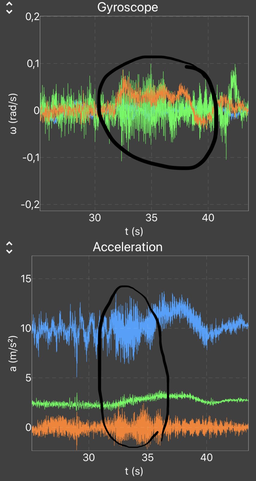

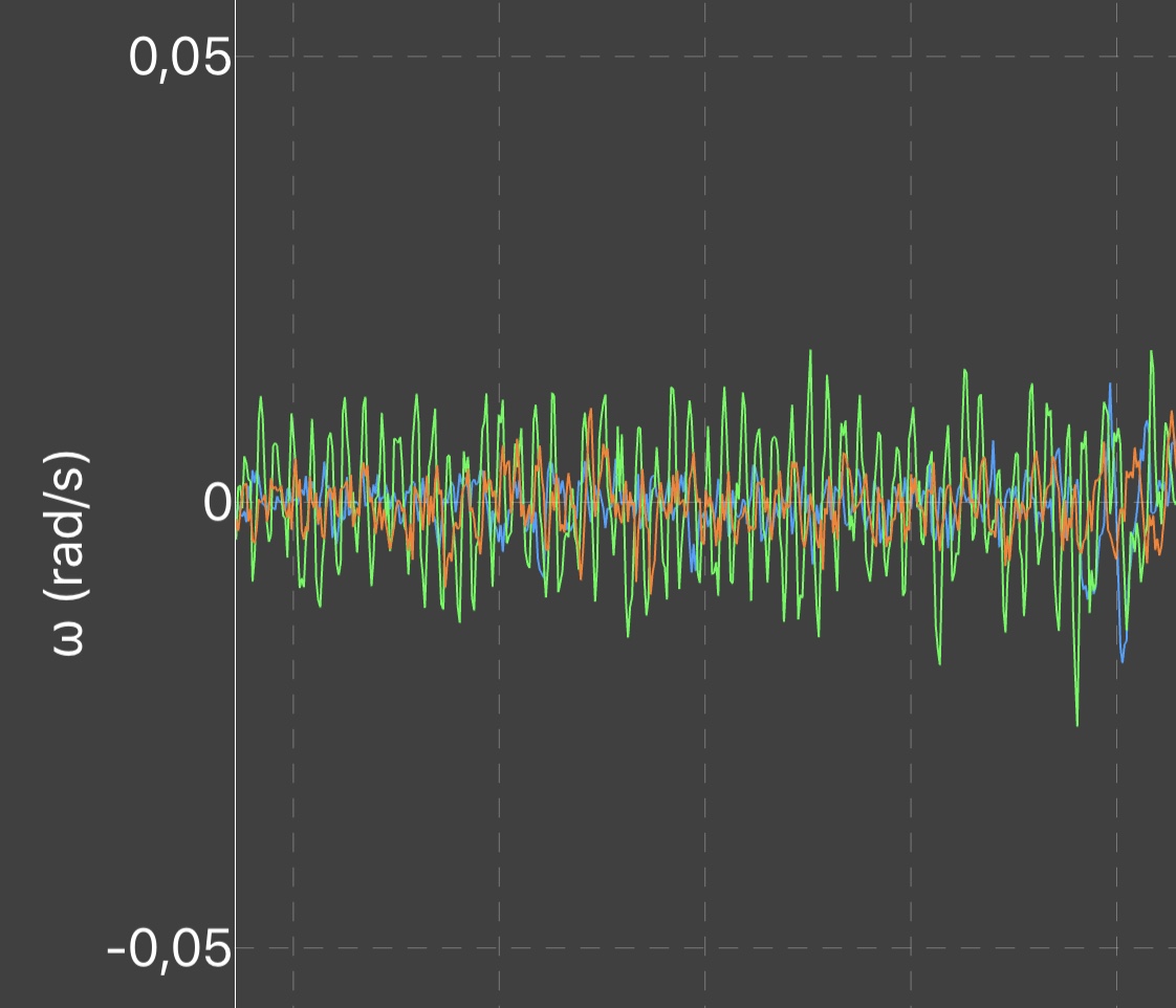

    Look what’s happening when the wheels are leaving the ground. Instead of reducing the shakes due to runway rumble, it gets even worse.
    I’ve noticed it almost every time on A320. I’ve never felt it on 737NG
    First I was thinking it was due to unbalanced pneumatics but now, when you start talking about front wheel shimmy it could be rather that.
    Please notice the orange gyro, that’s the moment where the front wheel leaves the ground.
    At this moment the shakes gets substantially bigger and faster... crazy

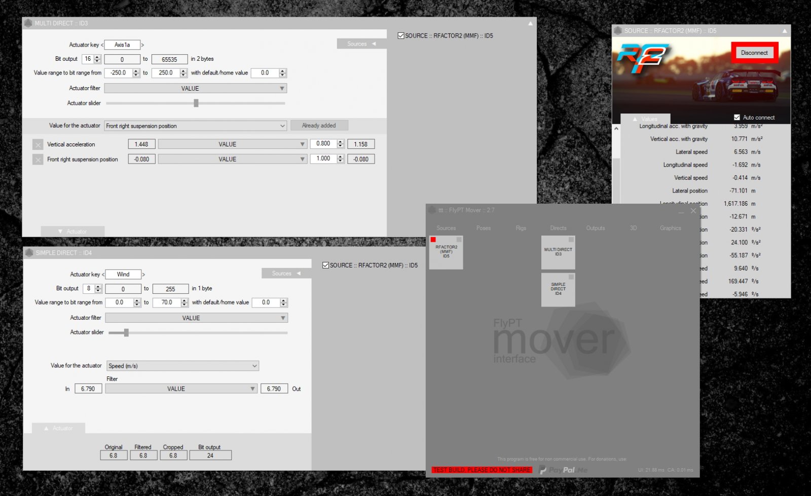

    But one of them is solved and now this works:
    It's the new Direct Modules.
    A simple one like we already have, and a multi direct, that allows any mixing of values.
    So you can now generate the actuators you want with the composition of values you want.

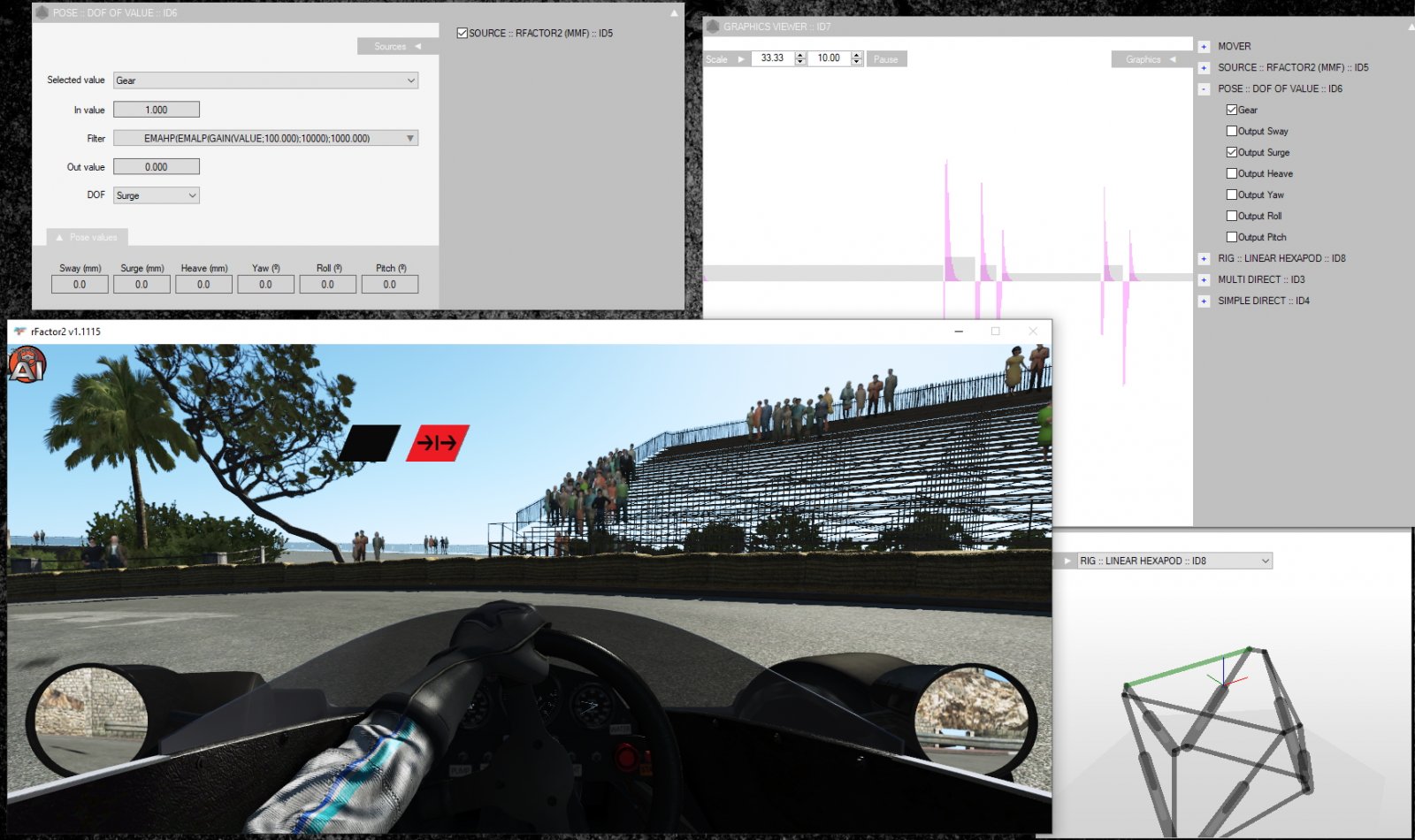

    Also a new pose module: DOF FROM VALUE
    It's a DOF from a value.
    In the picture we are generating surge from gear change by using the shown filter.
    We can achieve this with the pose from motion already, but just for one value it's faster to use this module.
