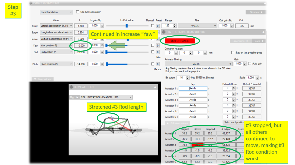

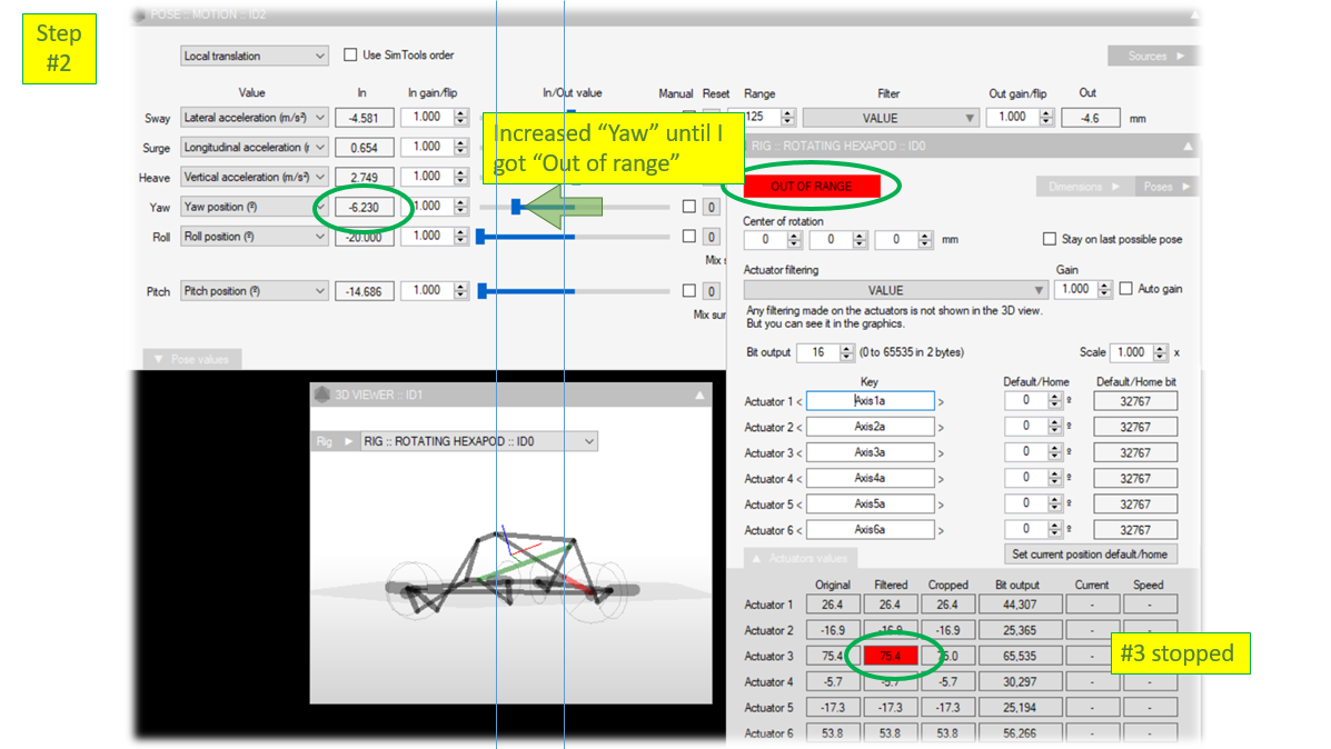

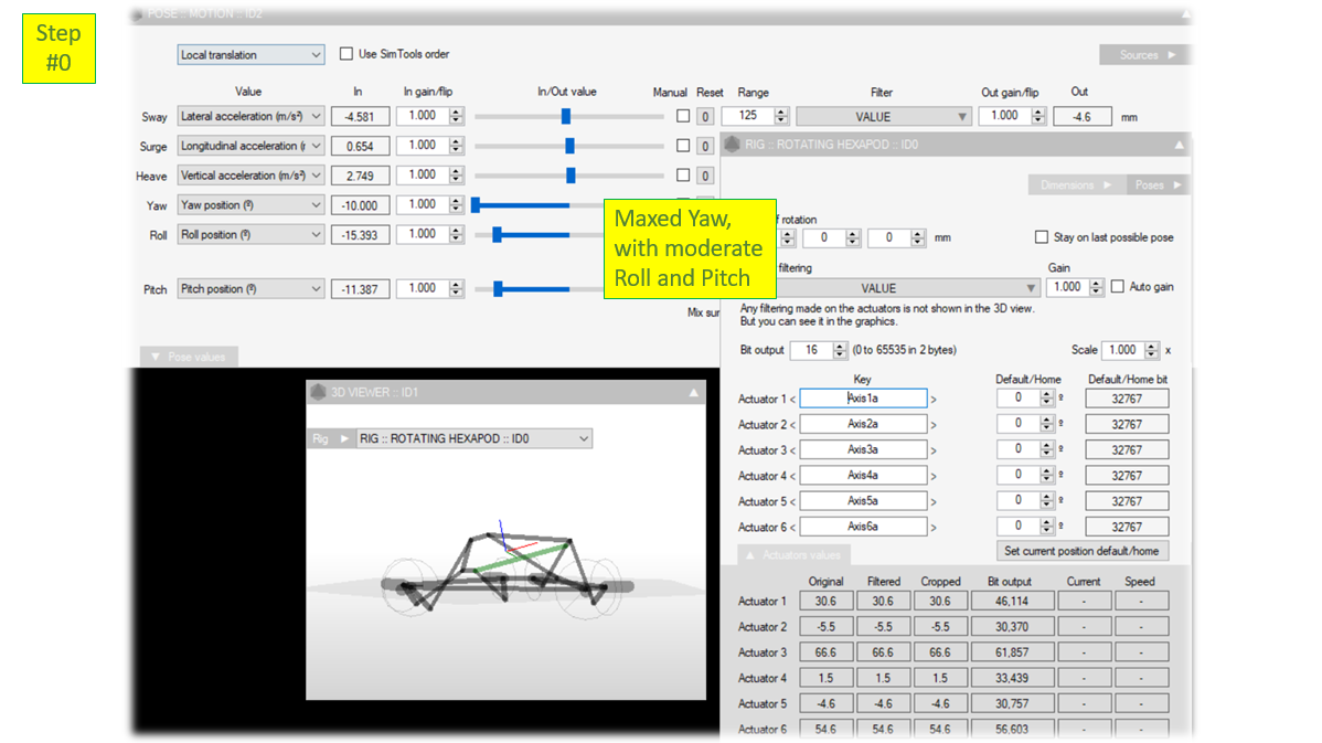

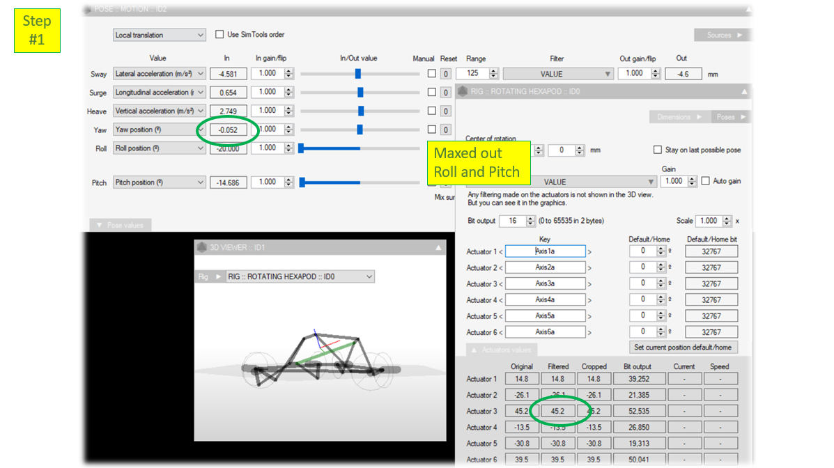

  14. Mark Pattison
    Mark Pattison New Member
    Nov 26, 2019
    19
    Engineer
    Michigan
    267Coins
    +9 / 0 / -0

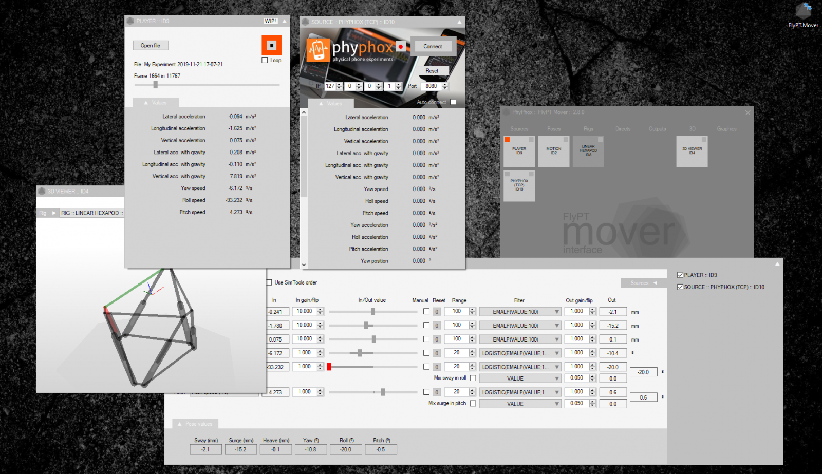

    I'm very new to all this, so please forgive me if this question is ignorant or wrong...
    First of all, I'm amazed by your software... WOW. I'm looking forward to growing my knowledge in it.
    Questions...
    If one of the actuators goes "OUT OF RANGE" from source value changes, the software stops that actuator's movement, which is good. But if source values continue to change that are making the range issue worst, shouldn't all the other actuators also have their movements constrained/stopped?
    Perhaps I'm missing something. Is there a way to allow a "Motion" (ie. Yaw) to move its full range when it can (no range issues), but when other source value changes create a range issue, all 6DOF are constrained/stopped, until source values not longer create a range issue?
    See images below for example...
    From the 3D viewer and Rig window values, if I continue to increase the situation that caused the "OUT OF RANGE" (Step #2→4: maxed Roll & Pitch, then adding more and more Yaw), it stops the actuator with the range issue, but continues to move the other actuators that worsen the range issue. And from the 3D reviewer, it actually looks like it "stretches" that actuator's rod length (while constraining/holding the Crank). I put vertical lines in Step #3 and Step #4, so you can see how it seems to stretch the Rod length while the other actuators and cranks continue to move.
    ____________
    Best regards,
    Mark

  16. pmvcda
    pmvcda aka FlyPT
    Nov 3, 2010
    2,296
    Portugal
    16,036Coins
    +2,746 / 18 / -0

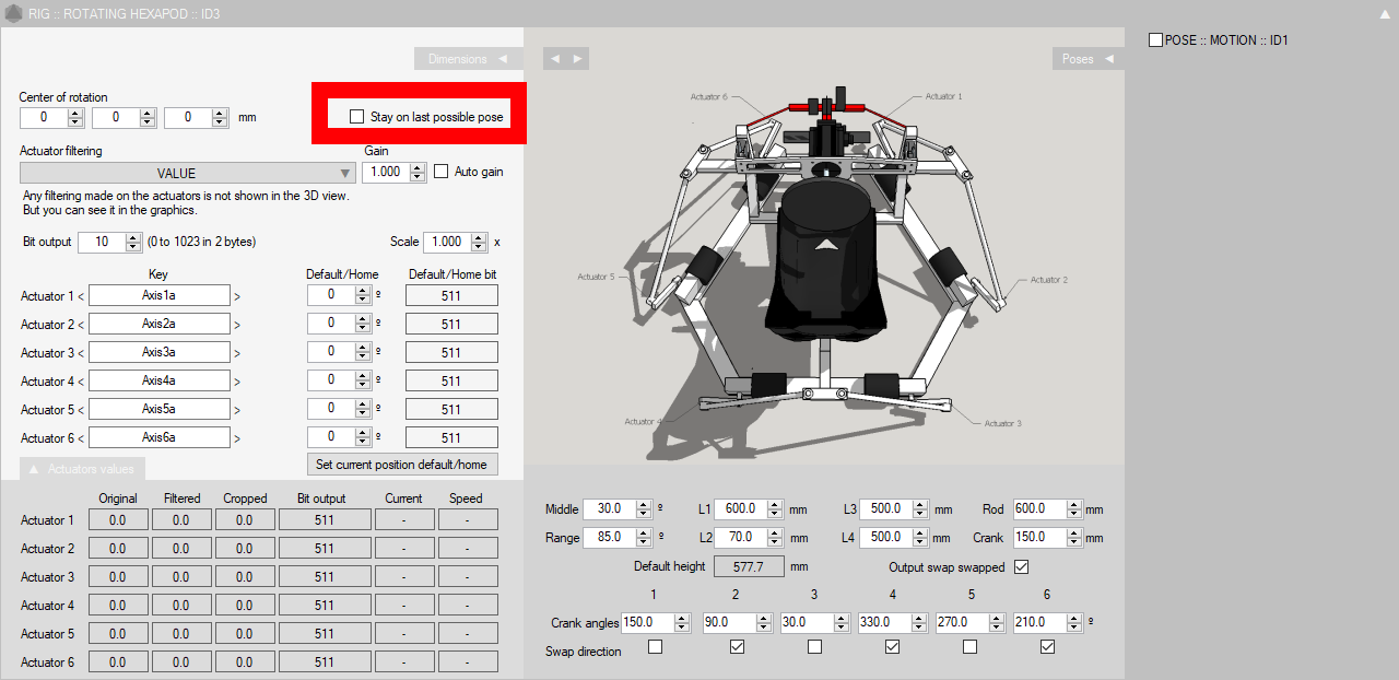

    Hi Mark,
    If you go to the rig window:
    You have the stay in last possible pose checkbox.
    If you check it, the rig stops in the last possible pose and moves only if you go back to a possible pose.
    Unchecked is the default state. So actuators move while they can. But 3D representation doesn't match the rig pose.
    Edit:
    Forgot to say that in rotating rigs you have two type of out of range in calculations:
    -Out of the angles you defined as limits
    -And impossible position, where the arms length can't generate the requested position
    Colors in arms changes according to that
