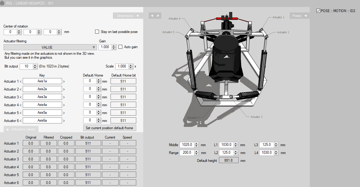

    Can you show me the rig window?

    Doesn't really show much at the minute bt i do see values change, its almost as if the actuators are in a test loop like a sine wave

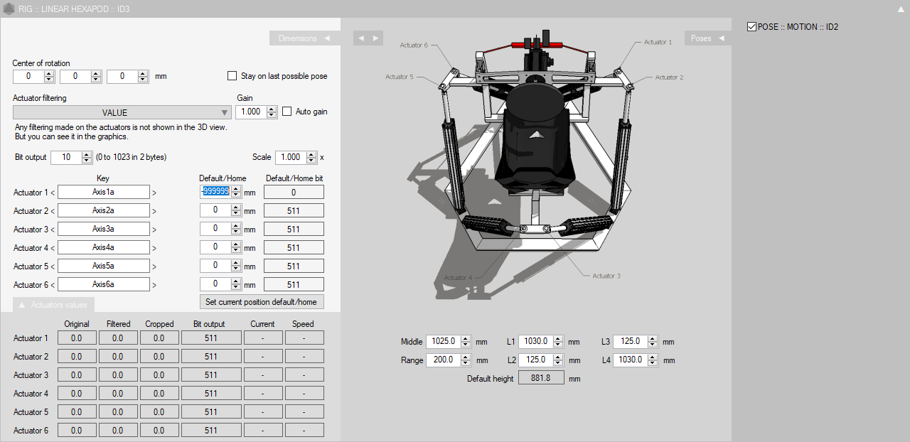

    Sorry, saw your question, Saturday, i think. But I forgot about it.
    So you need position zero at minimum stroke (like @SilentChill , saw your post in discord)?
    To make the rig start at that position, put the default actuators position on the rig with a low value.
    Something like -999999 to ensure it uses the lowest possible value.
    Put the 6 actuators with that value (like the one in blue).
    Also be sure to use the correct range and middle value to have the actuator at the minimum.
    For now, I think it's the only way to achieve it.

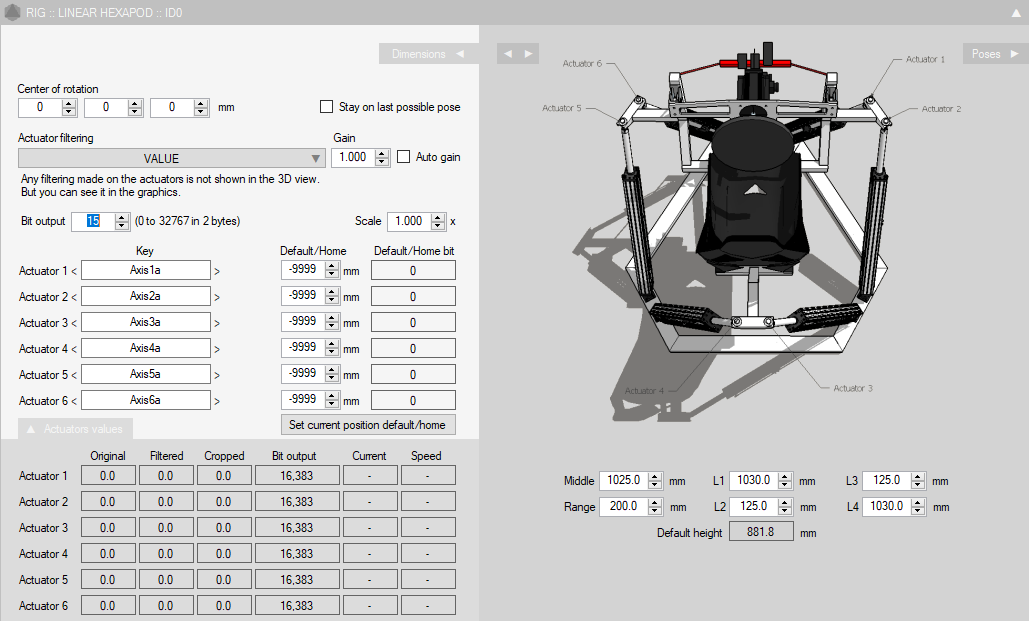

    Can you post your setup file here please?
    That's strange. Something is missing.

    Use 15 in the bit output of the rig
    What is the range of your actuator?

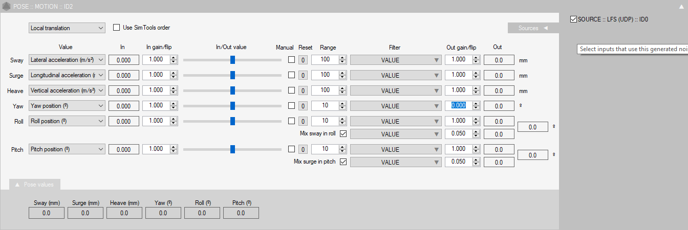

    Besides the 15 in bit, put zero in the gain for yaw (blue field):
    It might be getting rotations changes.

    Try to disable the lfs source and move just the heave slider.
    Put 100 in the range of the actuator (on the rig)
    Put 200 in the heave range (on the pose)
    When you move the slider, can you put the actuator in a specific position?
