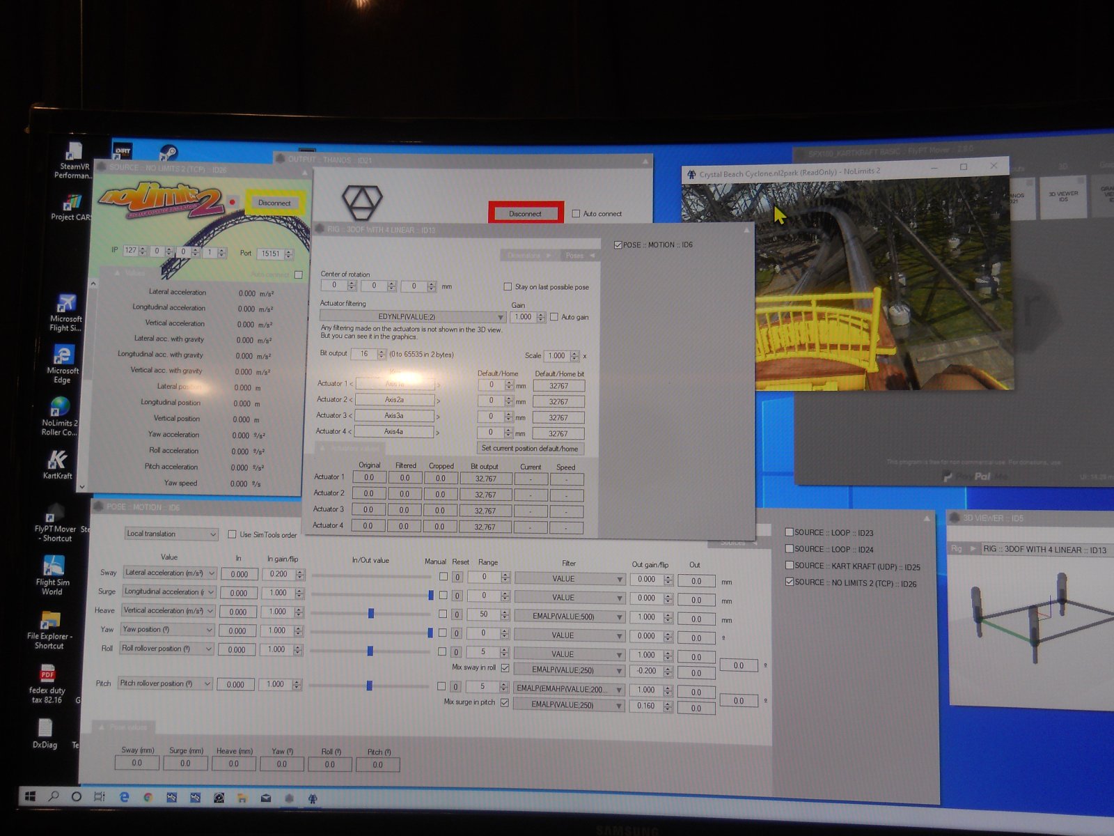

    Hi @pmvcda im having cant see the wood for the trees moment , working with kartkraft on my 4DOF sim and making good progress , just bought No Limits 2 full version and thought id try that in VR mode with the platform .. I may have missed it and if so can i ask you or any other member to point me to the post page, but cant seem to see how to set up Communication to Mover ref IP config data and port number settings ?
    i have the mover NO LIMITS 2 source module selected and can see the IP address data but as this is a Steam version im not immediately seeing how i can set up NL2 to match the settings in mover
    i looked at Readme file supplied with Mover but dont think i saw No Limits in there ?
    Ran No Limits 2 and Opened Mover module Pressed Connect but no data being updated in Source module ? Cheers
  11. wannabeaflyer2
    Jun 12, 2015
    724
    london uk
    8,362Coins
    +958 / 7 / -0
    Ok i found a reference to this in post page 28 or thereabouts but i think its Simtools related, what im hoping for a direct Connection module to No Limits 2 if that's possible ( still not got off my butt regarding getting confortable with using Simtools : -( ) sorry guys
  12. pmvcda
    pmvcda aka FlyPT
    Nov 3, 2010
    2,296
    Portugal
    16,036Coins
    +2,746 / 18 / -0
    Hi, not at home right now, but when starting no limits (demo doesn't work), do you see a message of the telemetry server?
    Try to put your pc ip instead of the default one.
  13. wannabeaflyer2
    Jun 12, 2015
    724
    london uk
    8,362Coins
    +958 / 7 / -0
    Hi @pmvcda no rush Good buddy , theres other stuff in life that needs doing so can wait , no problem .. just for background info ,
    Selected CMD in dos window to run IPCONFIG and system reported my IP address Ok
    Opened Mover No Limits source Module and changed the default IP to match my system IP , Left the Default Port as 15151 and ran No Limits 2 ( Full version) but still not seeing any data when simulation is running ... like i said , no rush you'll answer when you can , so im happy with that :) Cheers
    Opp's forgot to mention did not see message referring to telemetry Server anywhere on screen display ( but message in No limits 2 title bar said read only ??

    Really sorry for taking so much time.
    With so many games, forgot about what is needed here.
    You need to go to the launch options in steam and start nolimits with --telemetry --telemetryport=15151
  15. wannabeaflyer2
    Jun 12, 2015
    724
    london uk
    8,362Coins
    +958 / 7 / -0
    All sorted now thanks for the fix , i now have motion on three simulation programs , your a busy guyn and still find time to get our issues sorted , im just saying big thanks for getting me up and running again ..., Tuning time now LOL Cheers @pmvcda

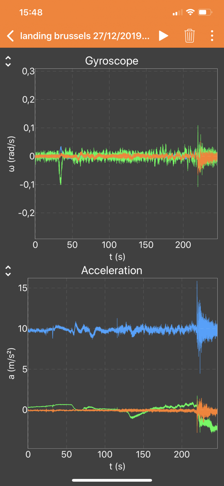

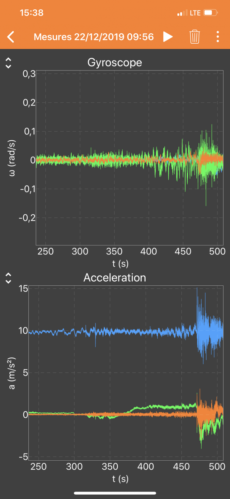

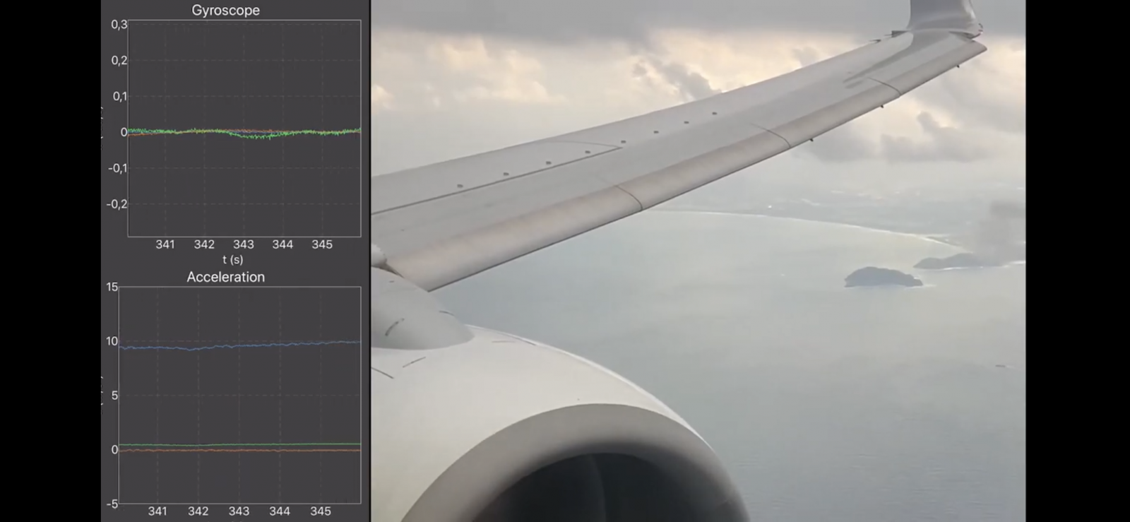

    @pmvcda
    I think I was wrong willing to construct flaps and gear noise in relation to air speed.
    While in theory it makes sense to make it smaller as the air speed decreases, in reality, I am observing quite steady noise amount.
    Please observe the noise increasing in the descent phase as flaps and gear are getting deployed.
  18. hexpod
    hexpod http://heXpod.xyz
    Apr 18, 2016
    1,228
    berlin
    7,900Coins
    +381 / 5 / -0
    DC motor, 6DOF
    @pmvcda , @Dirty has mentioned a Perlin noise as something which could be a suitable solution (better than a simple sine) to reach more realistic effect for flaps, speedbrakes or landing gear noise.
    What do you think about it ?
  19. hexpod
    Apr 18, 2016
    1,228
    berlin
    7,900Coins
    +381 / 5 / -0
    DC motor, 6DOF

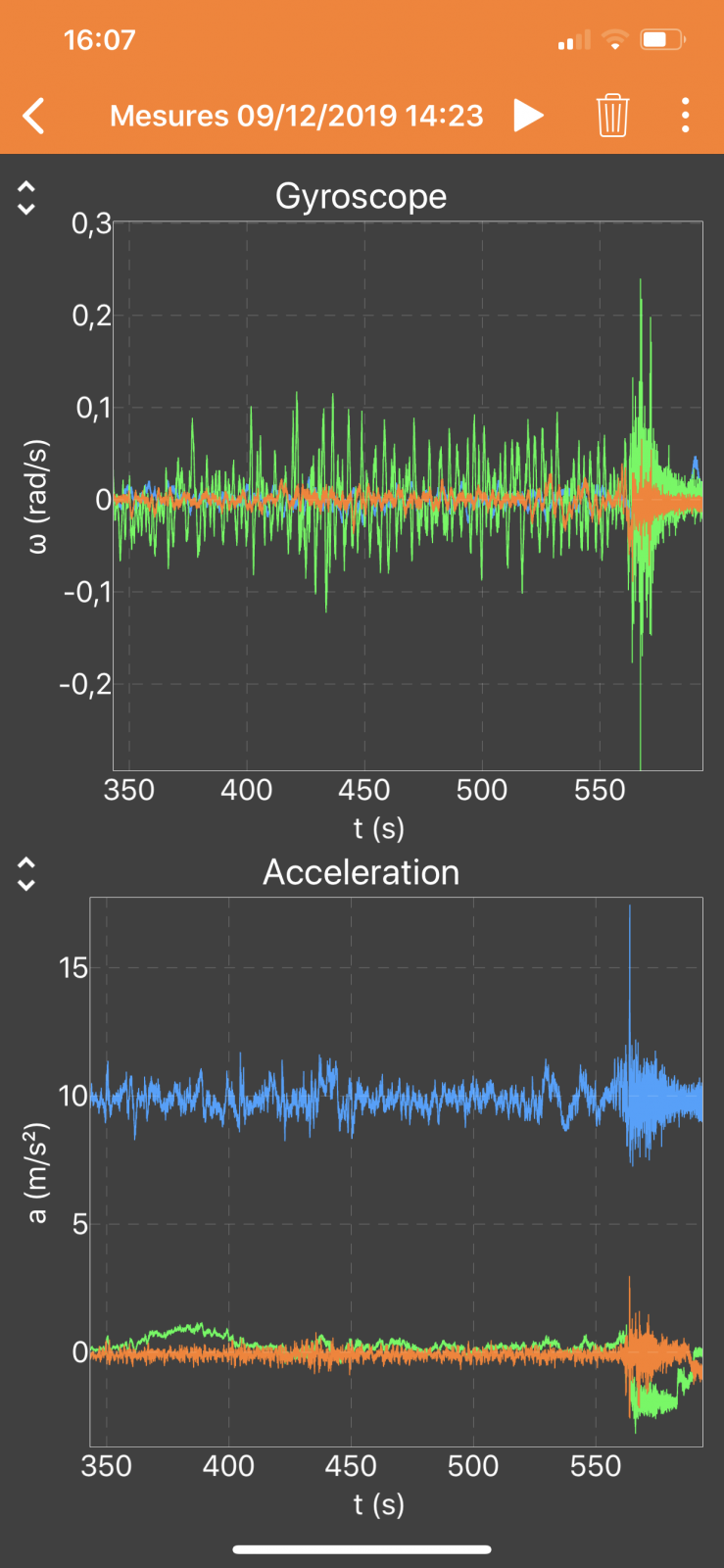

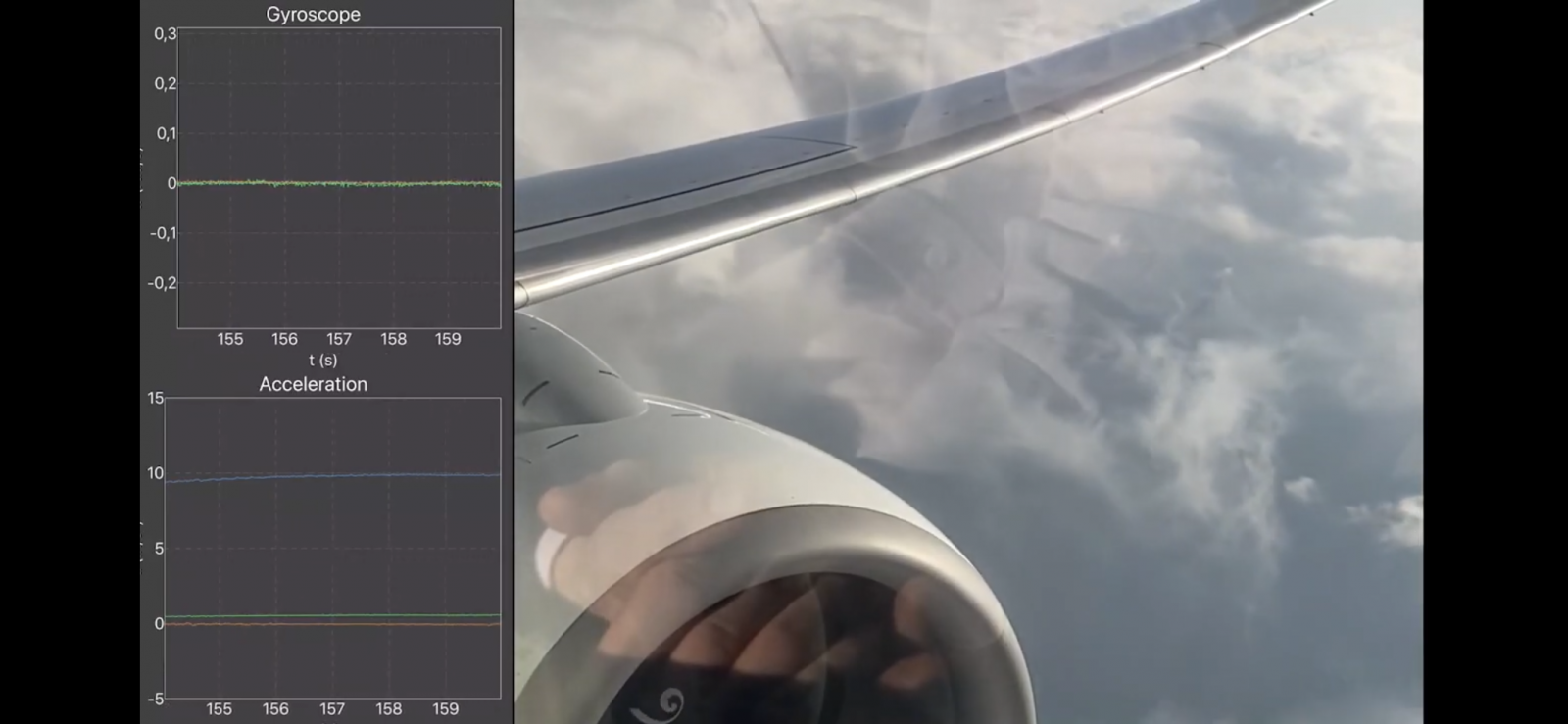

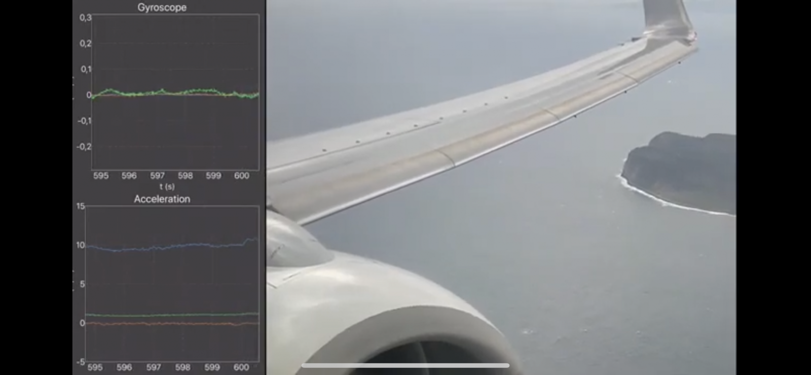

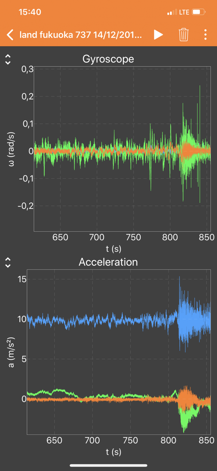

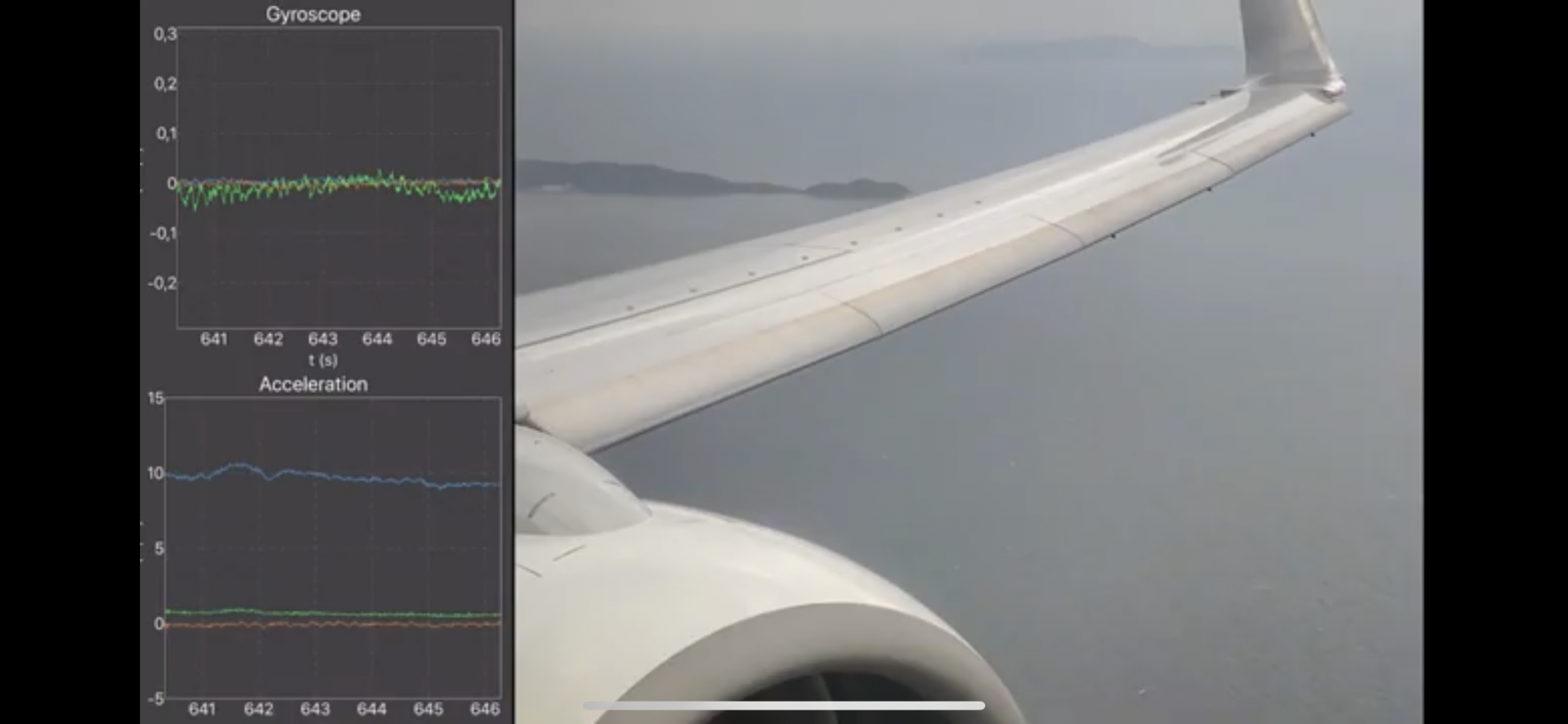

    Posting here some so called “short finals” which means more or less last 200s before touch down. @Dirty please correct me if the terminology is wrong.
    Two Embraer 190 and two B737 experiences.
    While in Embraer you will notice very distinctive noise increase while landing gear goes down, in Boeing example the moment is less obvious probably due to more turbulent atmosphere on the day.
    Feel free to comment.
    Here is Embraer :
    Here is Boeing :
  20. SeatTime
    2,572
    +2,854 / 40 / -0
    Is this noise/vibration something that you will pump into a transducer (buttkicker etc), or will you try to have your actuators reproduce this?
