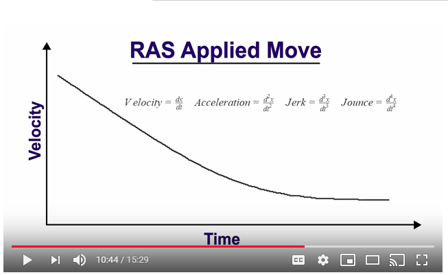

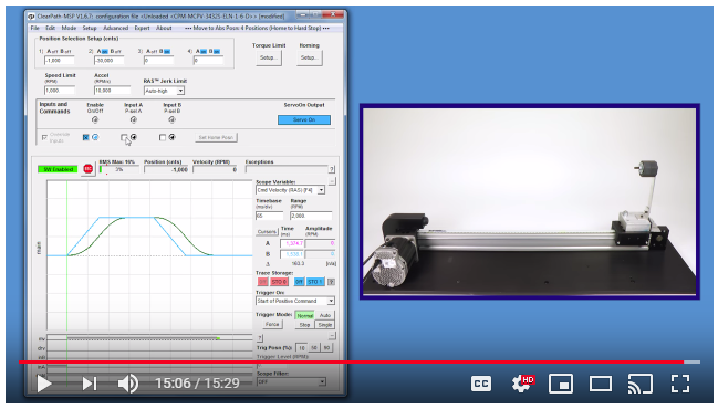

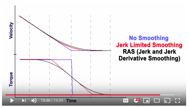

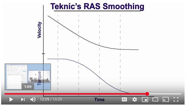

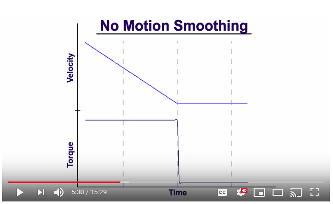

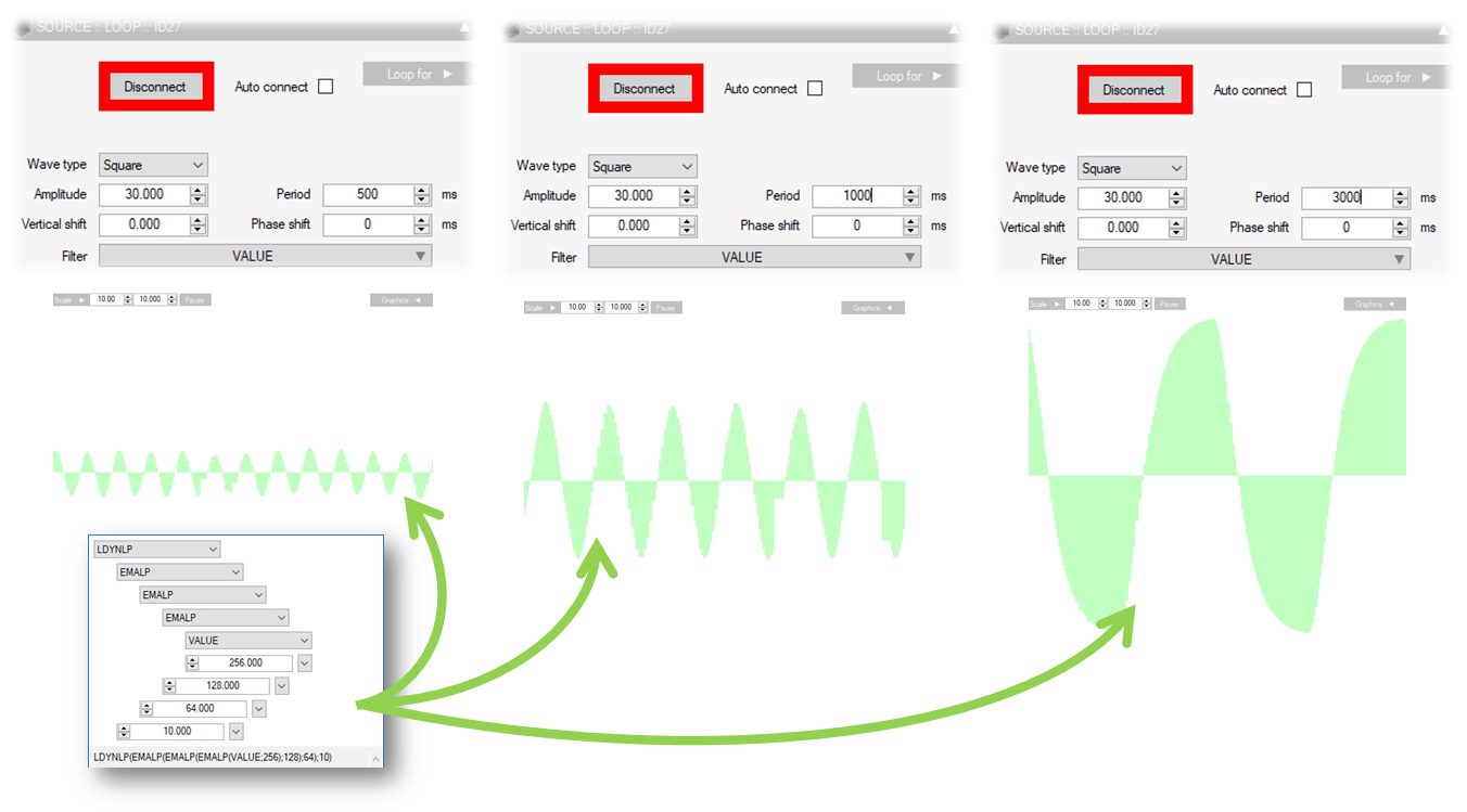

    Hello FlyPT,
    First, your software is amazing... Once I'm done with building my rig, I'll be making a good donation.
    I'd like to echo what @hexpod stated, but it could be I just don't know enough of your software on how to do this... ClearPath calls it "RAS" (Regressive Auto Spline)... Video LINK
    • The idea is to smooth motion from exiting a poss and finishing a poss, and the transitions (changes is velocity/torque and/or direction).
    Could you give examples on how to do this with your software? -- Or perhaps add it eventually to your software if it's not fully addressed yet?
    Again, perhaps your software can already do something like this, and if so, please give a few examples. The test would be to put the servo on a table (sitting freely, not bolted down), run it through a few rapid scenarios without it bouncing around too badly... This would translation to easy on your rigs (especially if you have monitors that are attached, which causes a long moment arm, like the weight on the arm in the video).

    I am on clearpath and I am combining both RAS about 40ms and Mover LPF.
    If you want to “round” more the “entry curve”, you can put several LPF in cascade. Name for this is second order (two in a row) or third order (three LPF in a row)
    Cheers

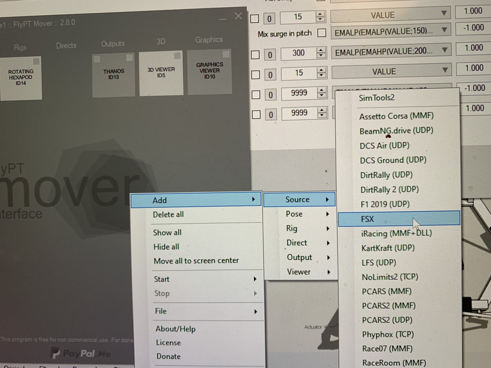

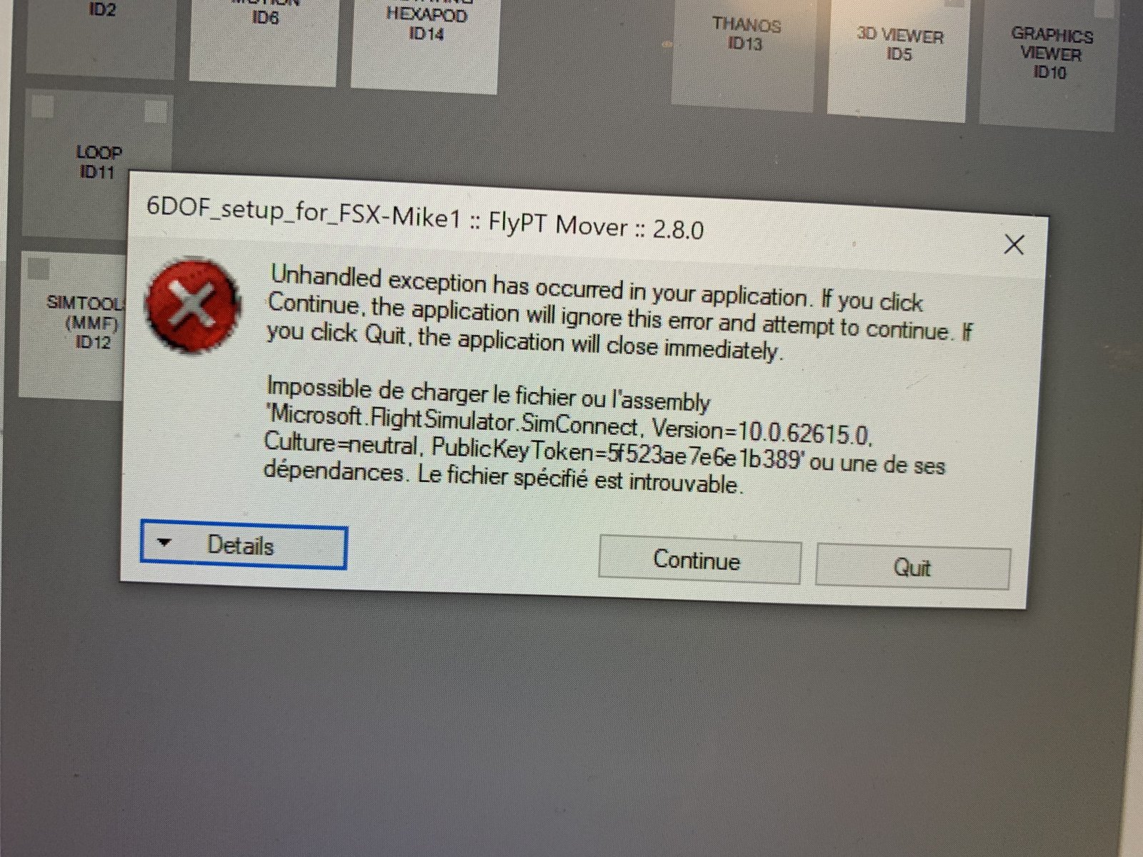

    Hi @pmvcda
    I am getting an error while trying to open FSX source for P3D
    I there a specific additional manipulation to be done or it should open out of the box ?
    4C91A8A4-B934-4D16-A356-CC3413C2899E.jpeg CD694EE8-EE58-49AD-B50A-8DA169978AA6.jpeg

    I don’t have the game installed, maybe that’s the problem.
  11. pmvcda
    pmvcda aka FlyPT
    Nov 3, 2010
    2,254
    Portugal
    15,794Coins
    +2,698 / 17 / -0
    @hexpod
    FSX is not working...
    Have feedback from others saying the same.
    I made something on my old laptop for it to work, but I may have Alzheimer....
    Good news is that I'm now working on a dll for FSX, that allows us to use Mover in 64 bits. And that one works, while my first iteration in managed code is not working on my new laptop...
    Please wait for 2.9 to test FSX

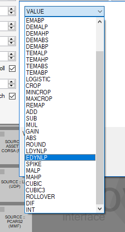

    Some of the new filters:
    MALP = Median average of a specified number of samples
    MAHP = High pass with median average
    CUBIC = Cubic function of type: y=ax^3+bx^2+cx+d
    CUBIC3 = Cubic funcyion of type: y=ax^3
    ROLLOVER = Roll inside a specified range
    DIF = Diferential
    INT = Integration
    Might allow to play a bit more...

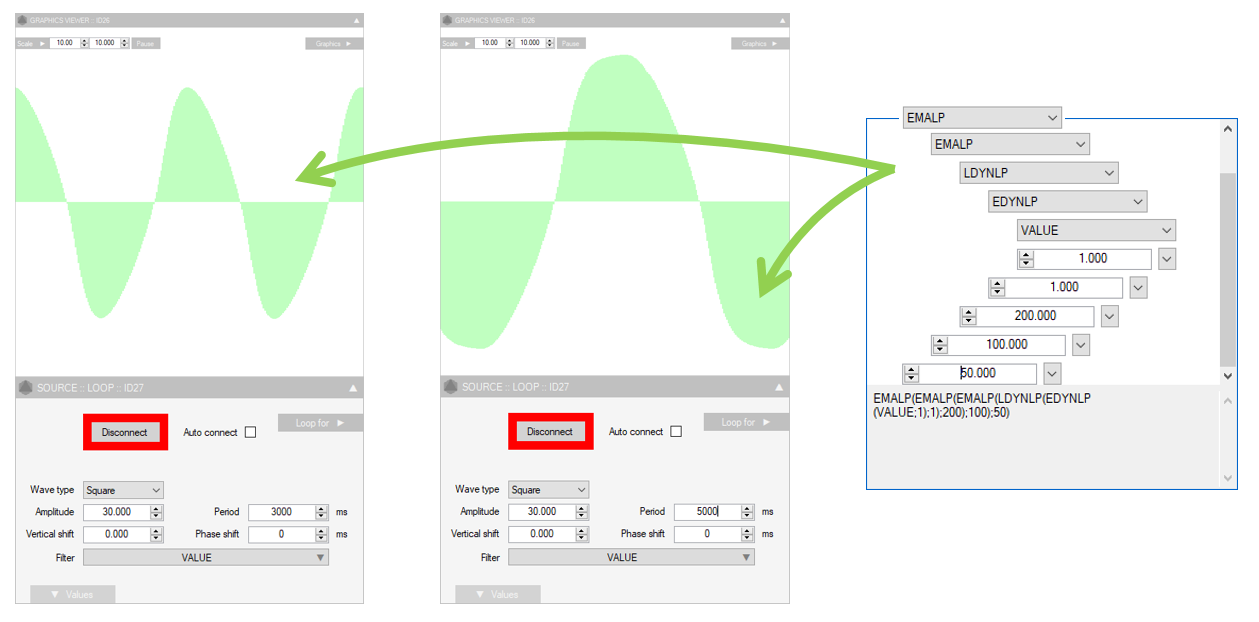

  13. Mark Pattison
    Mark Pattison New Member
    Nov 26, 2019
    19
    Engineer
    Michigan
    267Coins
    +9 / 0 / -0
  14. Mark Pattison
    Nov 26, 2019
    19
    Engineer
    Michigan
    267Coins
    +9 / 0 / -0
    oops.... part of my image got misaligned, sorry.
    This should be better...

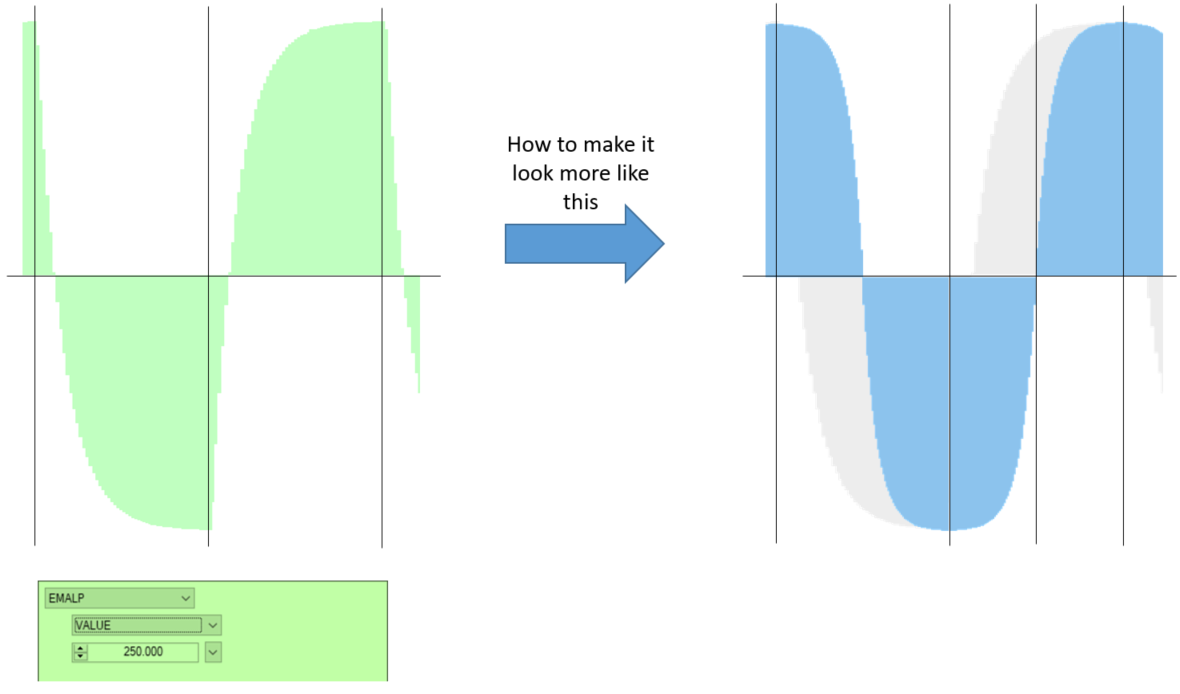

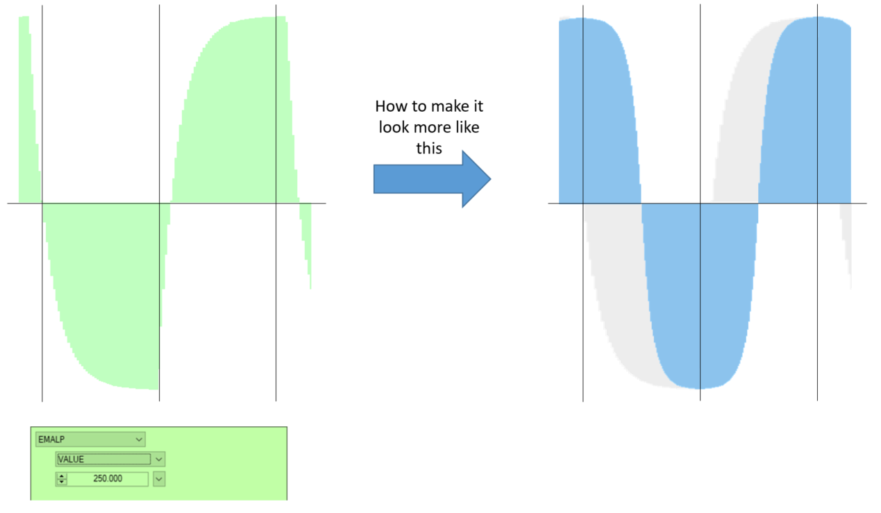

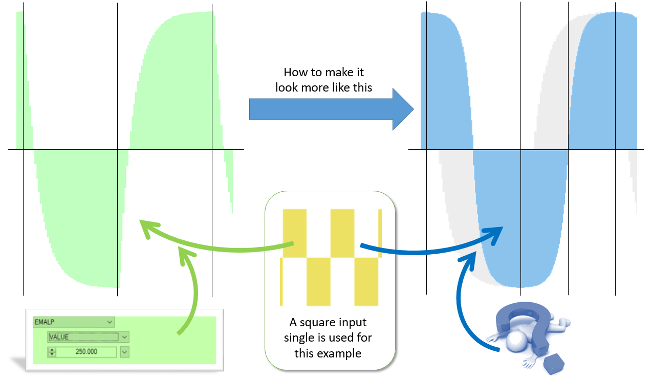

  15. Mark Pattison
    Nov 26, 2019
    19
    Engineer
    Michigan
    267Coins
    +9 / 0 / -0

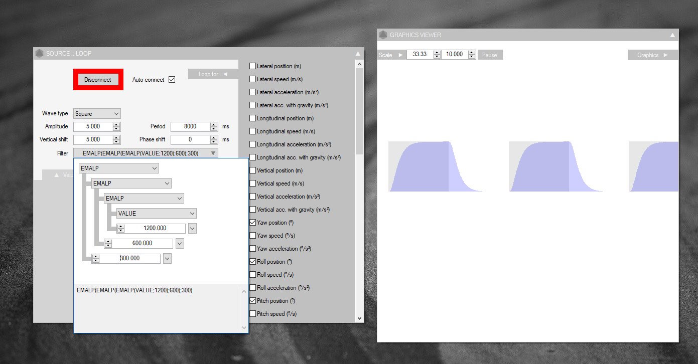

    Forget to mention the input...
  16. pmvcda
    pmvcda aka FlyPT
    Nov 3, 2010
    2,254
    Portugal
    15,794Coins
    +2,698 / 17 / -0
    Yes, I understood, that's something I also want to add and it's missing.
    The best you can do now is this:
    But the more you increase for exit smoothing, the more you loose in entry.

    If you do, it should be a great value to many... In the mean time, I'm playing around with the LDYNLP filter to help reduce the initial acceleration...
  18. Mark Pattison
    Nov 26, 2019
    19
    Engineer
    Michigan
    267Coins
    +9 / 0 / -0
    Getting a little closer....

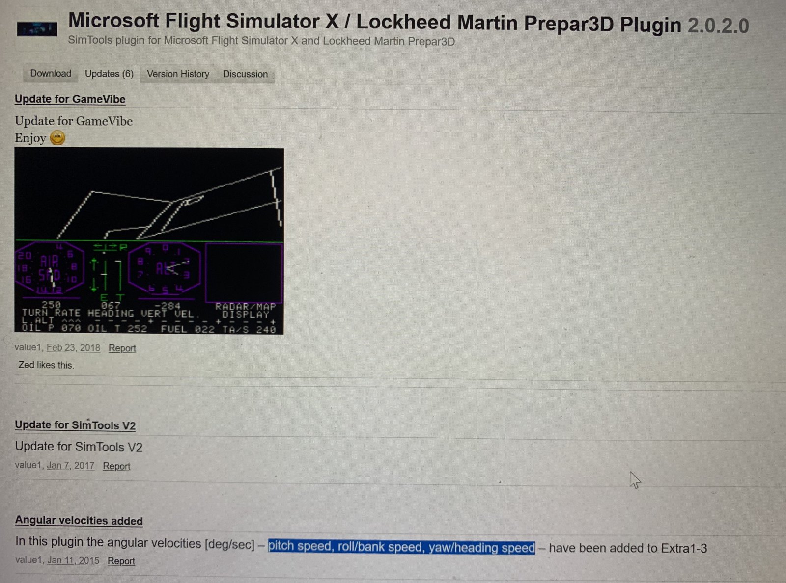

  19. hexpod
    hexpod http://heXpod.xyz
    Apr 18, 2016
    1,221
    berlin
    7,858Coins
    +377 / 5 / -0
    DC motor, 6DOF

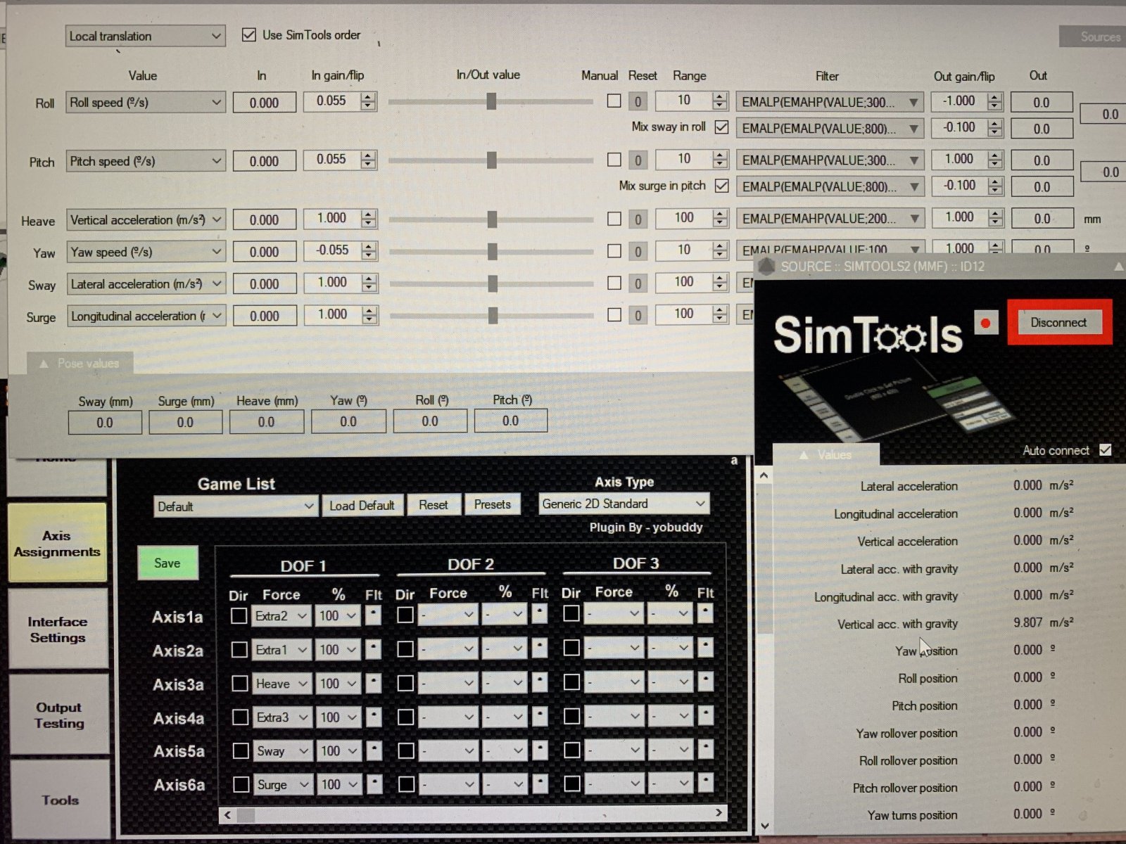

    Apparently we have angular rates coming from P3D
    Waiting for native P3D support, what is the correct „game engine / mover“ setup to let through
    3accels /3 angular velocities ?
    I have strange values coming into Simtools MMF mover‘s module
    What DOF1 column order has to be chosen to get the P3D velocities from Simtools extras, correctly mapped in mover ?
    Thank you

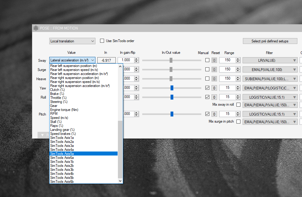

  20. pmvcda
    pmvcda aka FlyPT
    Nov 3, 2010
    2,254
    Portugal
    15,794Coins
    +2,698 / 17 / -0
    Sorry for late reply,
    The correct order is to use this in SimTools:
    Axis1a = Sway
    Axis2a=Surge
    Axis3a=Heave
    Axis4a=Yaw
    Axis5a=Roll
    Axis6a=Pitch
    But you can also select in Mover the Simtools axis instead of accelerations/rotations.
    So if you have sway in axis 5, in Mover select:
    But in this lat example, the received values are scaled to a range -10 and 10, while in the first example they come in a range of -100 to 100 and angles are remapped to degrees.
    Simply put, go with the first solution, the second one allows you to receive the extras in the b axis if you want to.
