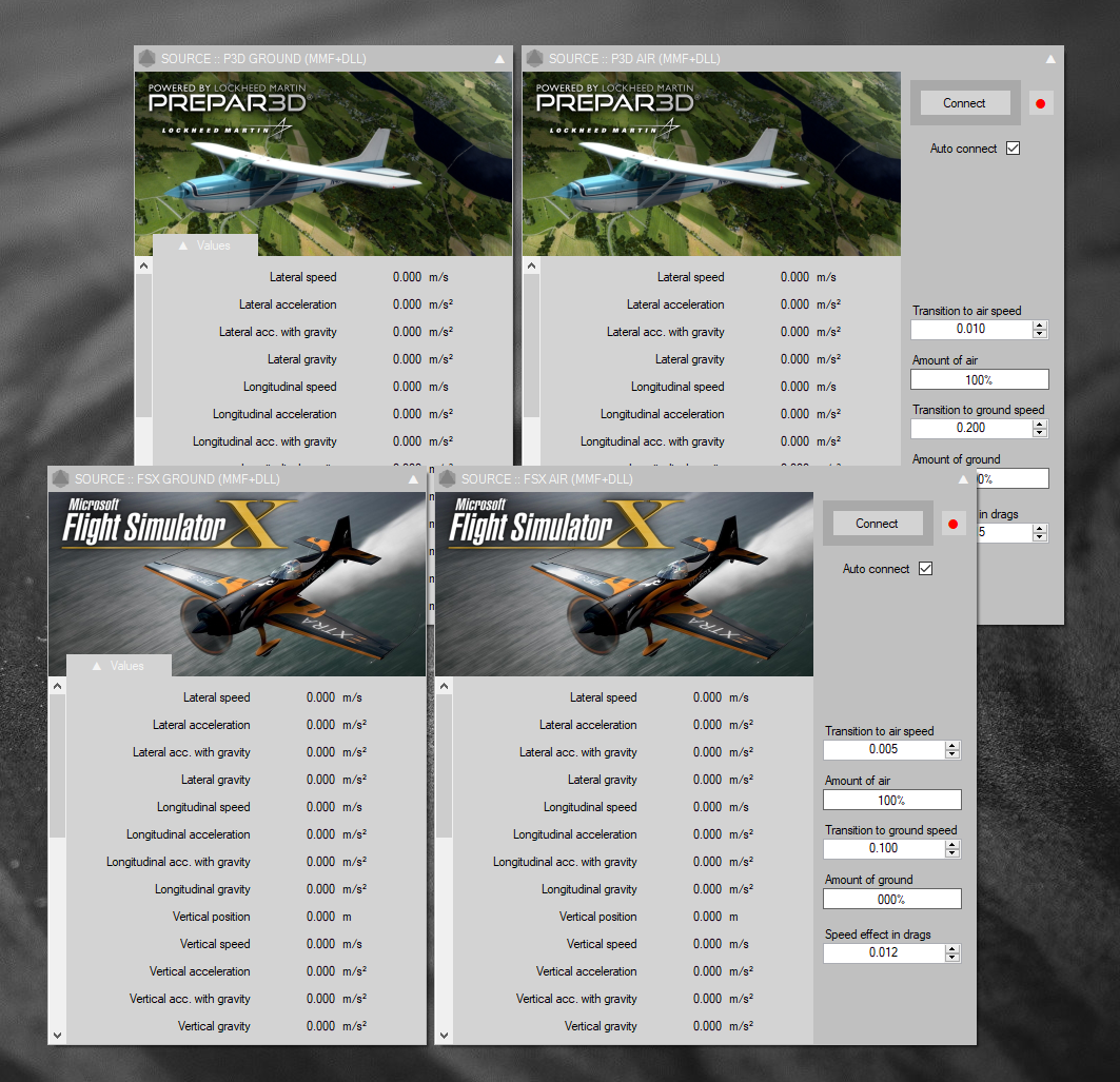

    I have the P3D and FSX sources almost ready.
    I will send it for testing, to see if the connection is ok.
    Maybe today.
    It will avoid all this confusion.
    But I will take a better look at using SimTools as a source later.

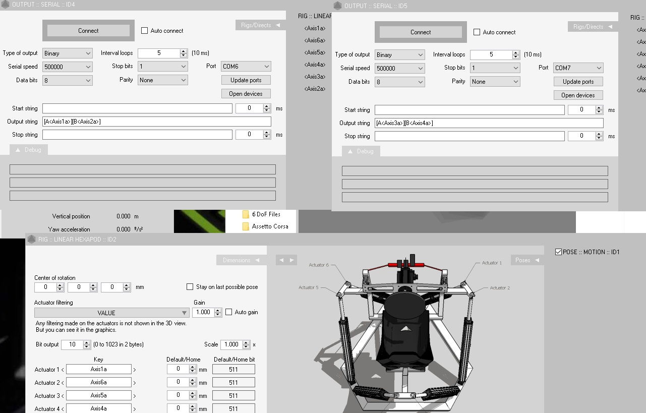

    i see u have made some games with built in support in FLyPT mover... does that mean i have to un-patch the simtools plug in on those games?

    searching threads.
    i am having trouble with the output modules.
    when i add a serial output module, i having trouble wih the syntax for output string.
    when i type [1<Axis1a>][2<Axis2a>] as i did in simtools, i get no response...
    when i typed [A<Axis1a>][B<Axis2a>] i had a adverse motion...
    with arduino/sabertooth.. what should be the output string?
    need help @pmvcda @Pierre Lalancette
    ***update***
    looks like working...
    syntax is [A<Axis1a>][B<Axis2a>] for arduino #1
    but i cant seem to get arduino #2 to respond to flypt mover..
    calling it a night..
    regardless of arduinos, when i watch the hexapod in 3d view, i see that the actuators go beyond limits and turns red, even though i am not driving fast in Live for speed...
    i am thinking i have some module not correctly configured...

    I have three Arduinos , axis 1-6
    [A<Axis1a>][B<Axis2a>] (output 1)
    [A<Axis3a>][B<Axis4a>](output 2)
    [A<Axis5a>][B<Axis6a>](output 3)

    by the way, any idea why the hexapod model in the 3d viewer always seems to be close to high position? its like its so easy for the pose to go out of limits..

    Can you share your setup file?
    You might be using acceleration with gravity and no filter
    Or, I see you have 10 bit output in the rig.
    Are you sure that's your bit output

    i justed used values that i used for simtools..
    ill take a screenshot later when i get home. i didnt setup any filters or anything, i just looked at your 1st post, and try to follow adding each module.. im just doing my first test, just to get something to move lolol
    wowoww.. your work for FSX integration looking amazing!
    i have DCS and Xplane. i just like to get nolimits and LiveForSpeed working before messing with anything else...
