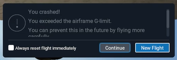

  8. Mark Pattison
    Mark Pattison New Member
    Nov 26, 2019
    19
    Engineer
    Michigan
    267Coins
    +9 / 0 / -0
    @FlyPT,
    I was thinking to add a 7th port to Thanos' controller (perhaps for belt tightener).
    Can your software support 7 ports?
    Also, with X-Plane (when doing a full aileron roll) and I max. out the airframe G-limit, damaging the plane and lose all and any control...
    In this scenario all outputs to the ports go insanely violent. This might be what happens in real life, but it could easily break the rig/gear boxes/etc. from the sudden jumps in positions... from "out-of-range" to "with-in-range" on the opposite side of the range limits. See video below for the sudden jumps (top left corner of the video).
    I know you can hit one of the three switches in the rig...
    ...but perhaps you can't hit them quick enough before the violent shake-up of the rig.
    Is there a way to recognize "You crashed" in X-Plane from the source and shut down all bit outputs to the controller?

  9. pmvcda
    pmvcda aka FlyPT
    Nov 3, 2010
    2,296
    Portugal
    16,036Coins
    +2,746 / 18 / -0
    You can have how many ports you want.
    If you look at the Thanos output, you see you can add more actuators, but for that you have to define them by adding another rig or a direct output.
    For example for the belt, you could add a direct from the longitudinal acceleration. This defines a new actuator that you can then use in the extra outputs of the Thanos output module.
    For the crashes, I can see if we have something, but you can also use a crash filter to remove violent movements from the rig in the rig module.
    In the rig filter, try yo use a EDYNLP(VALUE;4) filter and see what happens.

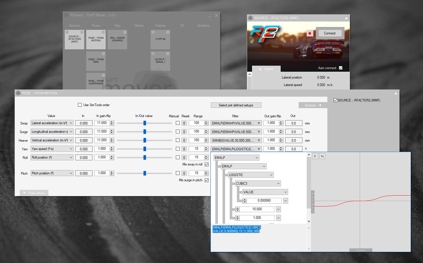

    Sorry for the lack of news, but taking all the free time to work in the 2.9 version.
    Had some problems, already solved, and I wanted to give some news, so here's a new feature:
    Filters have now a graphic to show the result.
    Horizontally we have the value we want to filter, and vertically, the result. Or simply Input / output.
    The idea of the graphic is to help visualize the result, and you can zoom and move it. Also shows the corresponding values in the cursor position.
    Only problem in those graphics, is that we can't show time/sample dependant filters, but I'm adding a little feature to help with that visualisation.
    Sorry for the delay, but I want next version to be easier to use and will include a simplified motion module besides this one (that will become the advanced one).
    Here's an example of the new traction loss filter in the advanced module:
    The graphic based in a cubic, generates a dead zone, the horizontal section in the middle.
    The cubic followed by a logistic, limits the values to a specific range (15º) shown in the graphic as the outside horizontal lines.
