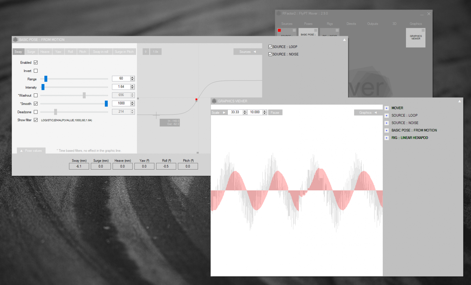

    Working on the basic pose from motion...
    Not organised!
    So like I said before, red dot is the output value after temporal filters like low pass, high pass...
    Gray dot is the value without those filters.
    There's no way to show a line with those filters, because the result depends on how fat we change values.
    But this gives already a good help, I hope :think

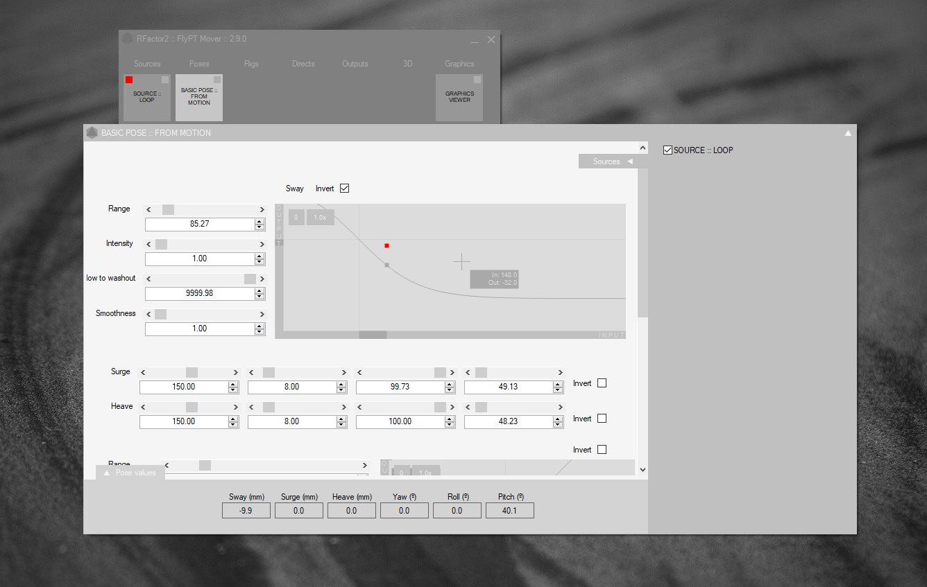

    New basic pose almost done!
    Only missing a button to convert it to advanced pose (advanced to basic is not possible)

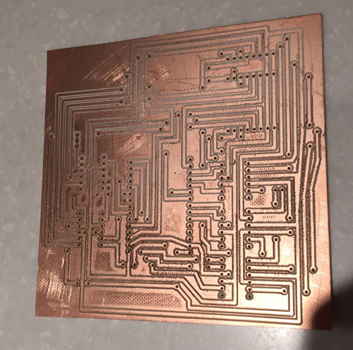

    Keep up the great work. can't wait to try Mover 2.9. I setup a couple of ESP32 with your code the other day and they all connected and seem to work flawlessly. Now I'm milling out some circuit boards (single sided so flying wires everywhere!) to get the level converters done.

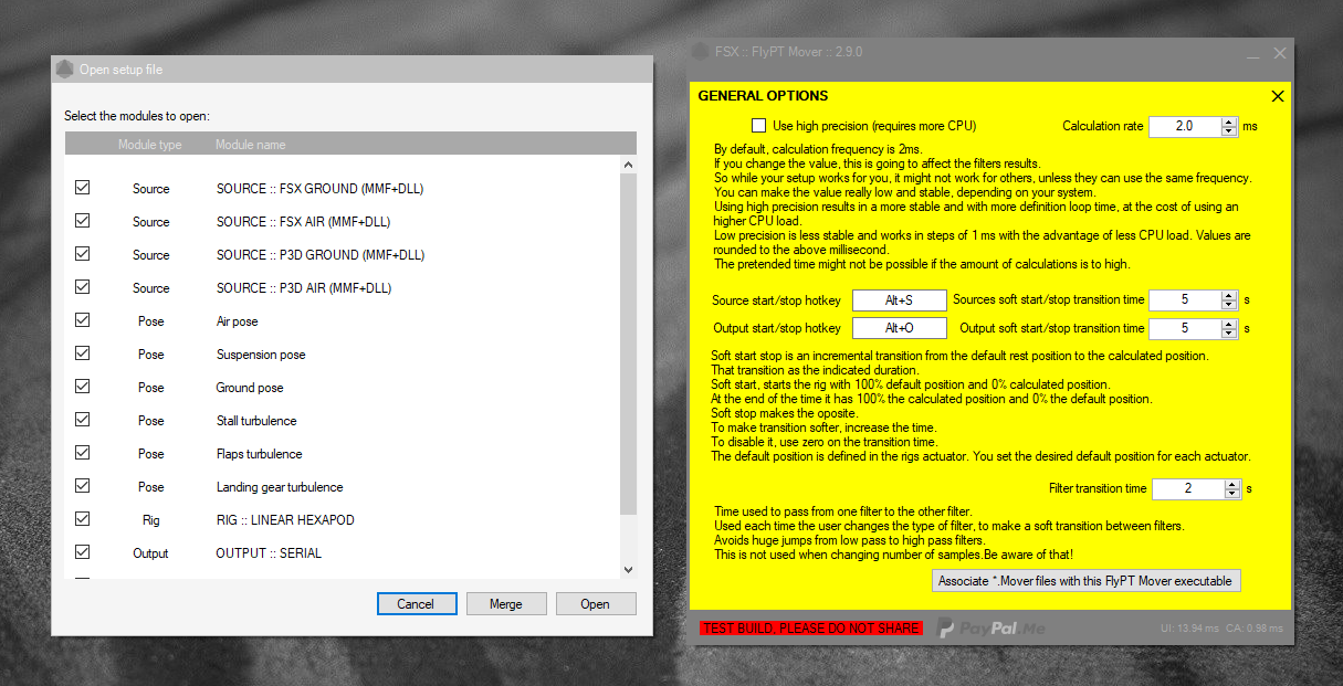

    Seems there's no progress... But I'm all over it:
    For 2.9, we can now:
    - Select the modules we want to open/merge
    - Associate the *.Mover file to the Mover executable
    - Select shortcuts to start/stop outputs and sources
    - Also checks for outputs connected to ensure we don't change profiles with them connected

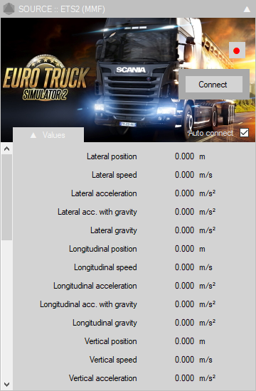

    Hi, thank's.
    For RBR, we have to search for memory hooks. It takes so much time, can't promise to make it soon.
    If anyone has it and wants to share, it will be fast to add RBR.
    Meanwhile, I added ETS2 (and AMTS) for 2.9:

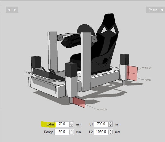

    I am testing flypt.
    what is "extra" on the image?
    Thank you for your help
