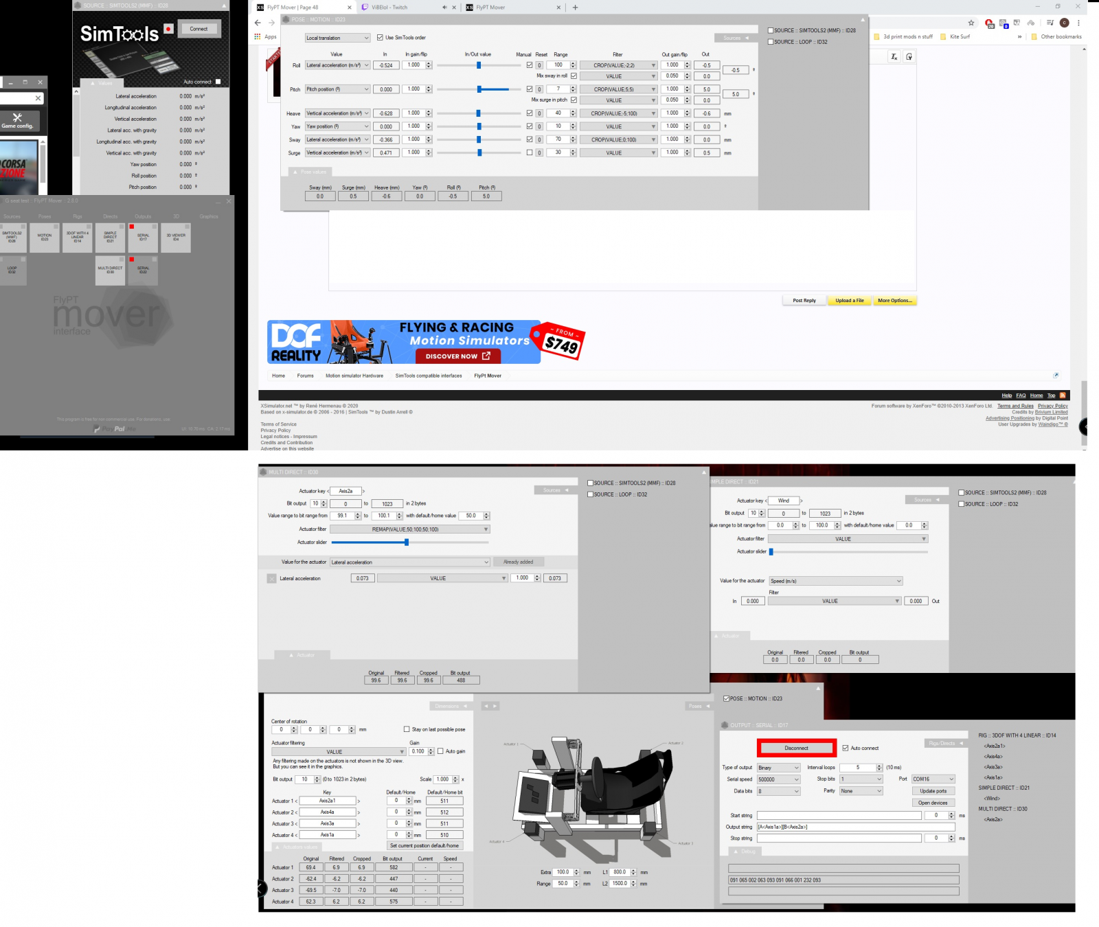

    If you look at my heave its cropped at -5:100 so it wont go any lower. I cant use the range as it limits both directions and it just dont work at all when you press the mix button to get surge/sway to work. As you can see the 3d view does nothing also even though the values are changing.
    I thought of using 2 poses and limit the opposite way for the two as i need the left flaps to raise but dont go lower than 0 and the same on the right. -100:0 on one and 0:100 on the other as it acts both ways. Thats what i just started setting up but i wont have chance to test until morning. With a range of only 250 (shitty res) or so ill need to use the 8 bit and change my HW to have the midpoint around 30 instead as it limits top to 255 and not 512 like it is in Simtools.
    As for ABS (in cars) , ive never felt that in the motion on Simtools but it could also be my resolution. I just saw there was an variable for it in the filters
    Quick explanation of flaps
    Bottoms flaps:
    Surge moves up on brake and down on acceleration but limited to a max range. Heave should still work over it (when surge is bottomed out) and have more range
    Heave: Up and down
    Sway: Each side up but not go below 30 so you still have range for surge and heave . In essence when one flap is up in a turn the other sits at 30
    Top flaps the same but surge will work the opposite way
    On a side note traction loss will also be mixed with sway so you have a feeling of grip, in simtools they cancel each other out so they work in combination. You fine tune it in tuning center
    Here's a pic of all the settings. Im just using wiper motors, 2 bottom and 2 back + a belt tensioneer. Im just testing things here. 99-100 was from 10 bit

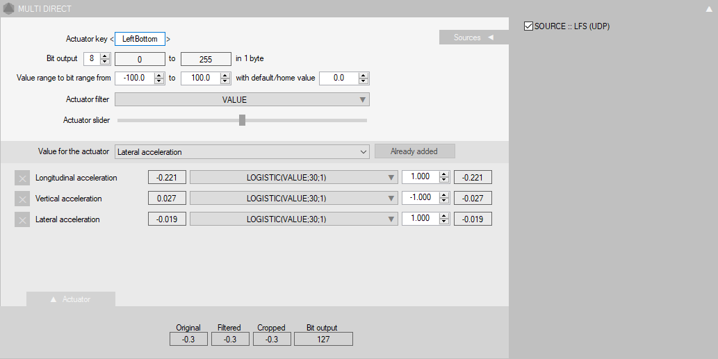

    So let me see, you have 4 paddles.
    2 in the back and two in the bottom.
    the 4 are independent and each has it's own motor.
    You are using 8bits resolution right?
    Like I said, use the multi direct:
    One for each paddle.
    It creates an actuator for each one. Put the bit you are using.
    The value range, I put between -100 and 100 (it's just for visualisation). 2.8 has a bug here, but use this values and you have no problem.
    Then I added the accelerations I want to affect the paddle.
    That logistic filter makes the value stay inside the -30 to 30 range with soft limits.
    The extra parameter is like a gain. but keeping the value in the limit.
    So I'm assigning 30 to each of the accelerations, the sum is less than 100, so it never clips.
    If you want to use long. acceleration in the 0 to 30 range , you need to use a filter like:
    ADD(LOGISTIC(VALUE;15;1);15)
    The value varies between -15 and 15, then you add 15 to make it between 0 and 30.
    If you want to inverse the result you can change the gain and put -1 like I have in vertical acceleration.
    Or use -1 instead of in the logistic.
    This is just an example. Values are not the best for sure.

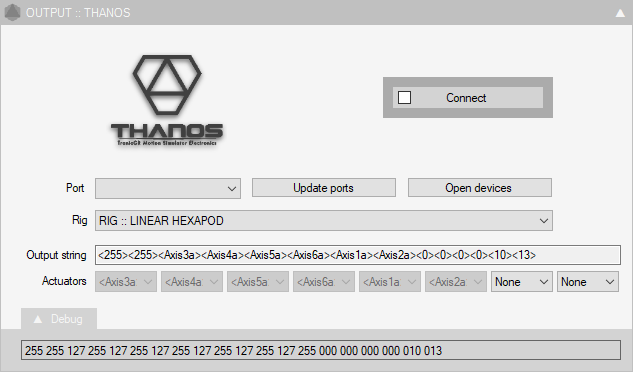

    Hey @pmvcda Loving the software you've created and what it can do. Its a masterpiece!! Now i'm finally up to testing my own rig with it and having some trouble identifying my axis.
    I have a 6dof linear rig with Thanos controller. i can connect to the rig and do the loop poses. But the software thinks actuator 4 & 5 is the front when its actually 6 & 1. my motors are wired up like your diagram. So actuator 1 is front Right. Doesn't matter what order i change the axis string the loop surge still thinks the front is actuator 4 & 5. Is there anything i'm doing wrong? When i test heave up and down the actuators all move in the right direction and the rig goes the correct way. Its almost like the change in the axis isn't being accepted. The string changes though when i change the order. weird.
    Any help would be appreciated
    Cheers, Chris
    EDIT: for now im just rotating my motor cables around 2 actuators to line up with the 3d viewer haha

    Are you using the Thanos output?
    If so, connect the actuators in the Thanos order.
    In the rig images you have the order I use, that's #1 the front right actuator, increasing to the right, so #6 is the front left.
    Thanos uses #1 for the actuator at the right back
    So in blue is the order I use, in black the Thanos output order.
    To use Thanos output, connect the actuators (physically) in that order to the Thanos controller.
    If you notice, the order on the string of the Thanos output is not sequential because it replaces the #1 with #3 and so on:
    The problem here is that the Thanos controller is waiting for the axis in that order and Mover computes them in another order.
    So the simplest solution is to change the order sent to the Thanos controller.
