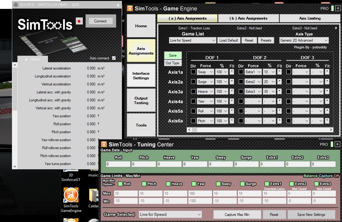

    Hello everybody,
    I'm facing some troubles connecting the source SymTools 2 to SymTools. When I click on "connect" nothing happens but its works fine with "Assetto Corsa" and "LFS" sources.
    Am forgotting something?
    Thank you all

  13. Marco Annunziata
    Dec 2, 2019
    130
    919Coins
    +19 / 0 / -0

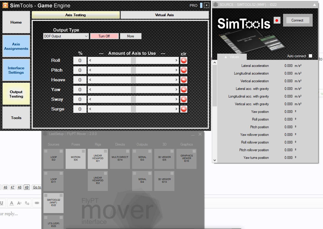

    Thank you for the answer but something escapes me. I have download the Simtools plugin and I can connect the FlyPT to SimTool Game Engine Like in the picture linked below:
    https://www.xsimulator.net/community/attachments/sem-nome-jpg.63630/
    My doubt is how to connect the Source connector to SimTool like in link below
    https://www.xsimulator.net/community/attachments/sem-nome-jpg.63632/
    If I push the Connect button it doesn't become "Connected" like in the picture

    Did you make the axis assignment?
  15. Marco Annunziata
    Dec 2, 2019
    130
    919Coins
    +19 / 0 / -0
    Yes I did, please take a look to the attachment below
  16. pmvcda
    pmvcda aka FlyPT
    Nov 3, 2010
    2,280
    Portugal
    15,950Coins
    +2,733 / 18 / -0
    That's strange.
    You are in 2.8 right?
  17. Marco Annunziata
    Dec 2, 2019
    130
    919Coins
    +19 / 0 / -0
    Yes, correct 2.8.0
