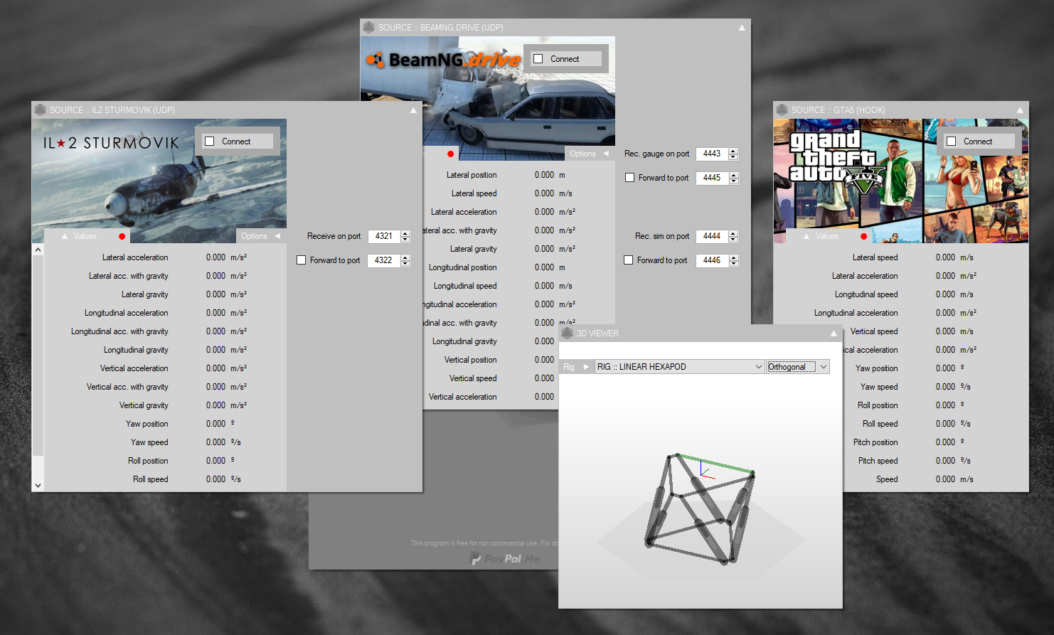

    FlyPT Mover 2.9.3

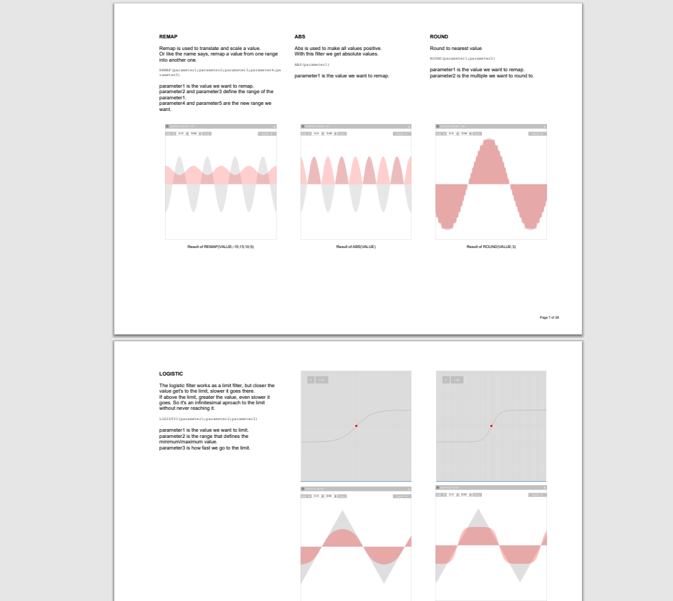

    Pages of the filter manual:
    So, I didn't achieve all the objectives for this version.
    But knowing most of you are at home (or should be), and considering the current build state, I think I can share it with everyone.
    WARNING!
    I'm really sorry, but old setups are not compatible with this version.
    You can try to open them, but most of the fields wont be filled.
    This was needed to simplify code and make updates simpler.
    KNOWN PROBLEMS
    - Sources that access shared memory (MMF), are slow when trying to connect with auto connect.
    This affects calculation time. So it's recommended to use just the source you want or if you are using multiple sources in the setup,
    don't enable auto connect in the sources you are not using.

    FILTERS
    - Optimised filter transition, with smaller footprint in calculations.
    - New basic filtering system (simplified, but in it's first step).
    - New graphic of input/output to help visualize filtering results.
    - New/Changed filters:
    INT = Integration, for example to calculate speed from acceleration or position from speed.
    DIF = Differentiation, for example calculate speed from position or acceleration from speed.

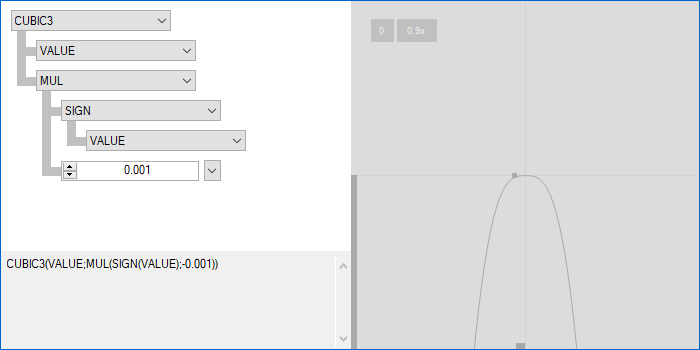

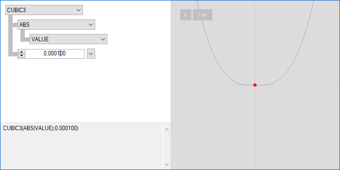

    CUBIC = Cubic expression of type y = a*x^3 + b*x^2 + c*x + d (for testing purposes).
    CUBIC3 = Cubic expression of type y = a*x^3, good to use in traction loss.
    MALP = Median average low pass (not exponential), similar to EMALP, but uses more memory.
    MAHP = Median average high pass (not exponential), similar to EMAHP, but uses more memory.
    SPIKE = EDYNLP They are the same. It's the preferred filter to remove spikes.
    MINCROP = Remove everything under a certain value.
    MAXCROP = Remove everything above a certain value.
    ROLLOVER = Rollover filter to roll between -value and +value, where value is specified by user. This replaces the rollover input values
    NOISE = Generates noise based on the received value (amplitude) with a specified update frequency based on calculation rate.
    EDYNLP = SPIKE Now with two parameters, first is from wich value we start filtering.
    ROUND = To round a value.

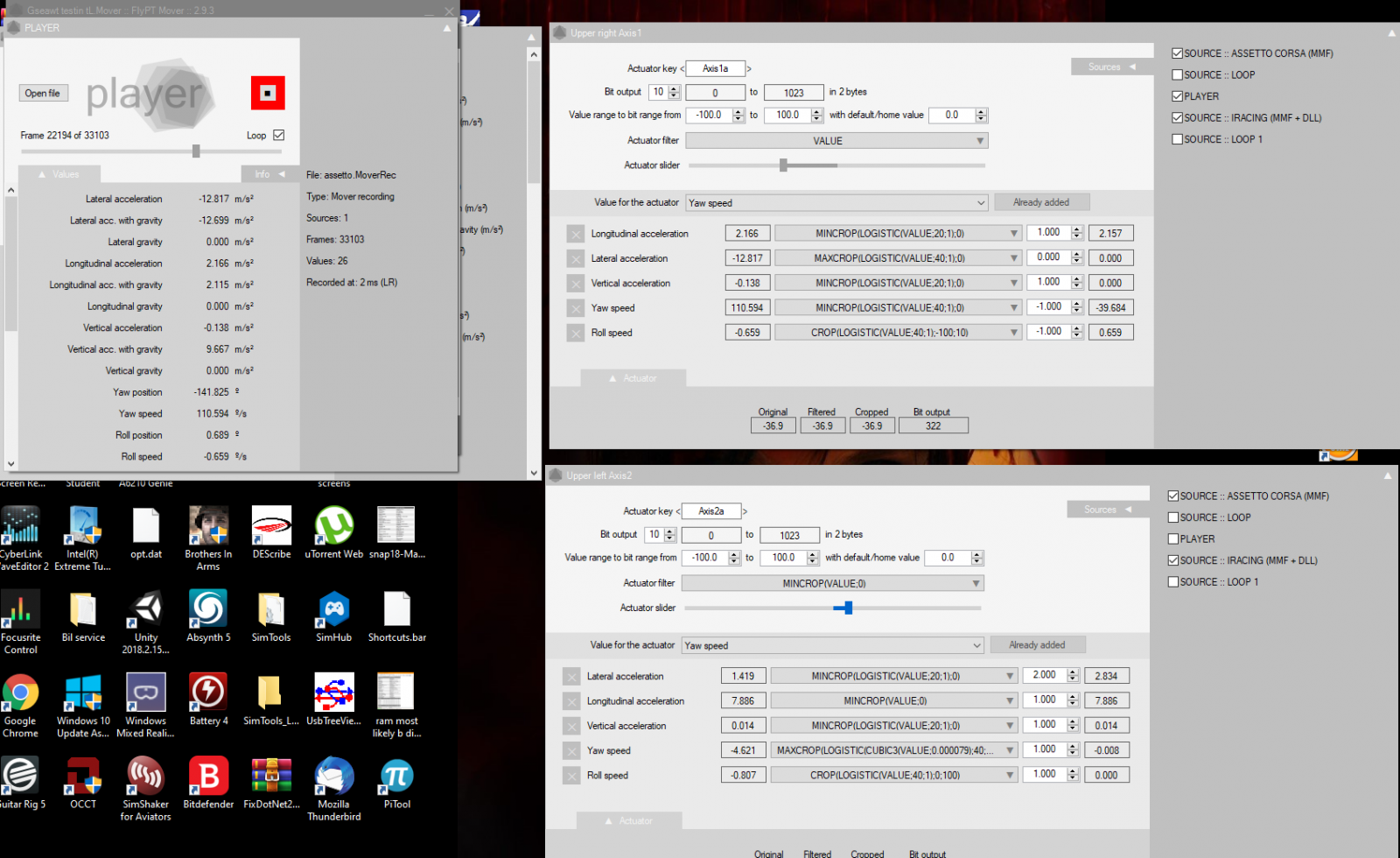

    - We can now record multi sources (like aircraft's with sources for ground and air).
    - Player can play multi sources.
    - Player can play zip files generated by PhyPhox. It can play with just one of the streams or all three streams supported (please see manual).

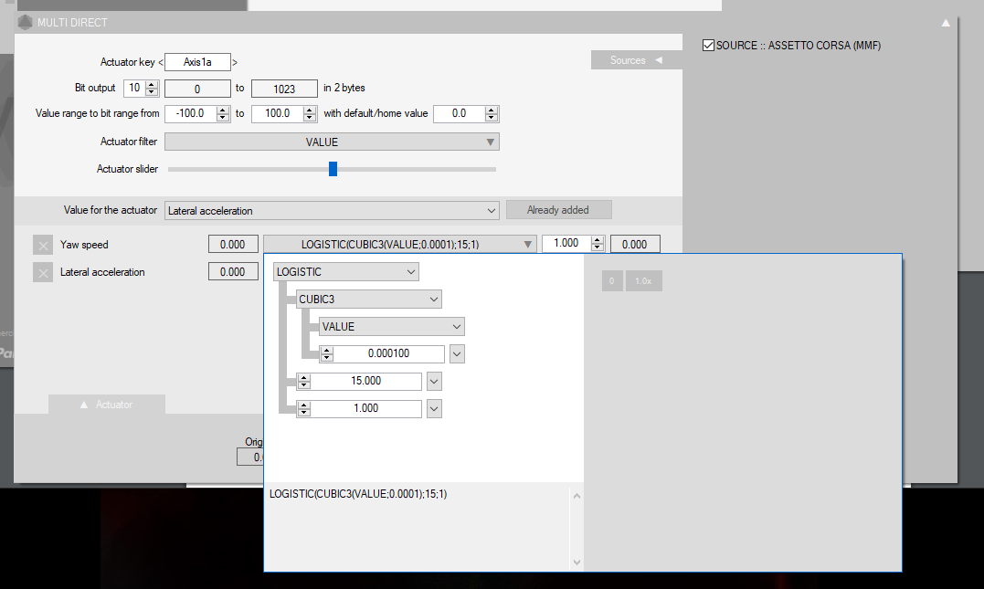

    Fantastic! I see in Multi direct (Direct works) there is no graphic curve on the filters to visualize whats happening but pose from motion or direct works fine so i can use those to visualize it and then transfer it. For lateral acceleration is does work in multi direct but not long vert roll acc and yaw speed. Not tried any others. Actuator filter also works. Really hope this can be fixed soon as its a great help
    It would also be amazing in a future version if you could copy and paste the directs as i need to input the same values x4-5. As far as i know this is not possible now without editing the. mover file

    Good idea,
    I'm adding a duplicate to the modules (that allow duplication).
    The graphic problem is an easy fix. Don't know how I missed this.

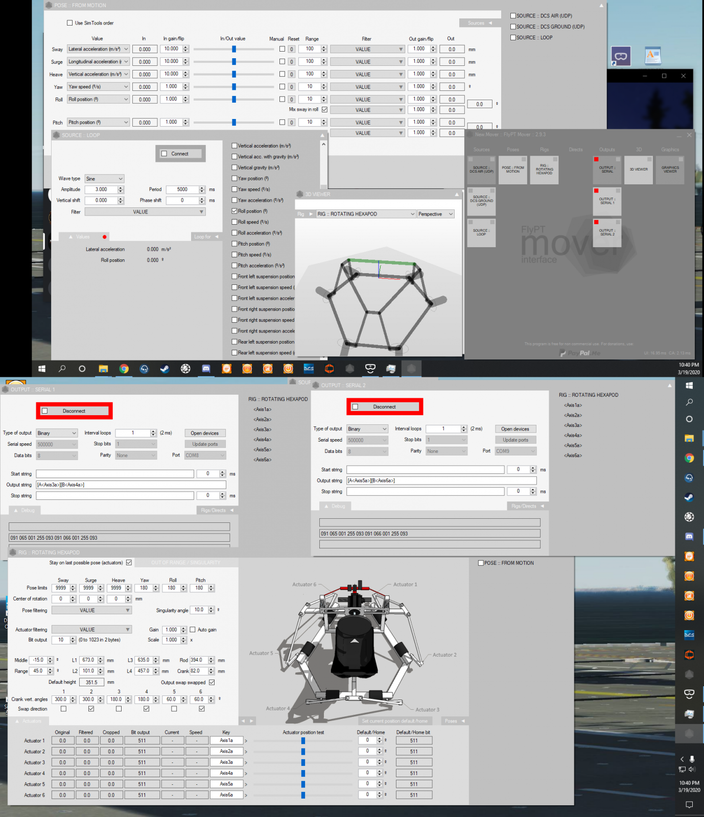

    Im having another issue. Its related to the traction loss. And just a disclaimer i have some working memory issues that makes it very hard for me to keep 2 (if i look at one page and then another any rule i need to remember from the first is gone) things in my head at the same time where normal people can do 3-4 easily. So i apologize if im off but ive spent 4 hours trying to get this to work and figuring out how to explain it.
    Input number from games turning the same way
    lateral acc positive
    Yaw speed negative.
    What i need is for traction loss/yaw speed to go negative but not positive and not go below 0
    If i add a min crop filter i wont go below 0 but it will still give positive values when you turn the other way.
    To explain another way.
    Flaps one goes up with sway and TL counteracts it. However TL wont reduce the flaps below 0 as its cropped there. also it should not add any positive value on top of sway when you turn the other way TL now gives positive numbers
    If i use the Loop and they both have positive values at the same time i can invert one channel and they will directly counteract each other. Then i min crop one channel and max crop the other. This is essentially what i want. You can also see when i add the Cubic3 filter the deadzone will have its desired effect. So that leads me to conclude that if Yaw speed was reversed in the game plugins it would work just fine.
    Here's with it looped and how it should be. As you can see Yaw still dipps it below and the workaround is the global filter which i would very much prefer not to use as it interferes with my other forces that are allowed negative.
    Here's a video with other values the player from AC and you can see when it turns the other way and suddenly adds a lot to the axis.
    Im guessing its not much i can do about it but any insight is welcome. For a normal single motor traction loss this is a none issue but if combine with other forces it becomes an issue.

    In the cubic you can use a negative number to invert it.
    Maybe use the SIGN and MUL filters.
    SIGN gives you -1 ou +1 depending on the value being negative or positive.
    MUL multiplies a value with another one.
    Problem here is that for you to increase the dead zone, the field needs more zeros. I can add them to all the numbers.
    Maybe better to use ABS:
    Or force it zero for negative numbers:
    Take a look at the cubic also. That might also help:
    But honestly, I have some difficulty understanding your problem. That's something I need to look better.
    While doing this, I noted there's a bug that identifies some strings has invalid filters while they are valid...

    No worries its a tricky one. Ive actually tried all those combinations. You can set the crop either on top or in the cubic filter, it dosent actually make any difference. In fact just ignore the cubic and everything except crop, it dont actually make any difference to what i need to achieve. That is without the workaround. Ill be repeating myself a bit here but hopefully it will help it all make sense.
    What happens is that since i need to invert both channels (Yaw gives negative and Sway/lateral positive in a right turn) for them to work opposite and essentially cancel each other out. If both gave positive i'd just invert one channel and put Max crop on one and Min crop on the other.
    To summarize
    This is just 1 flap in the Gseat, namely Axis 1
    The main issue is that Yaw TL will take my bit output below 512 if i use a min crop. This is what i need for the forces to cancel each other out and depending on the numbers and gain and dead zone Yaw (TL) will do less than Lateral (Sway). Thing is i cant have it go under 512 and thats what i use the global Min crop for.
    Using Max crop on yaw instead of reducing the axis it will allow it add cause its now allowed to use positive numbers.Then it will max out the axis
    Using Min crop on yaw will make it reduce the axis but since it dosent actually have a Crop to stop it at 0 or 512 bit output it will just got to 200 bit output. Adding global Min crop will fix that issue.
    So, like mentioned if Both Lateral acc and Yaw speed had the same direction of force. That is both have positive values in a left turn this would most likely be fixed. Of course that would require you to rewrite every plugin and although its probably just switching a sign i dont know if its needed for other things. Also it really is a minor but a bit of an annoying issue haha. It took me a while to figure it out. There's no rush though, im sure there are lots of other great things for you to do first
    Its also really hard to see because it works just fine if you use a loop since it will give positive values to both so the only real way to test it properly is from running a recording of the game.
    On a side note i absolutely love the software and its so nice to be able to just Sub a tiny bit if i need to tune my axis instead of crawling into small spaces and doing it on the HW for a 1mm change.
    Here's a pic without the global crop:

    You can invert the values received by replacing VALUE with GAIN(VALUE;-1) or MUL(VALUE;-1) (they are the same)
    I can add an input gain besides the output one to make it easier, like we have in the pose from motion.
    But this is just a fast answer, I'm going to look better at the problem.
