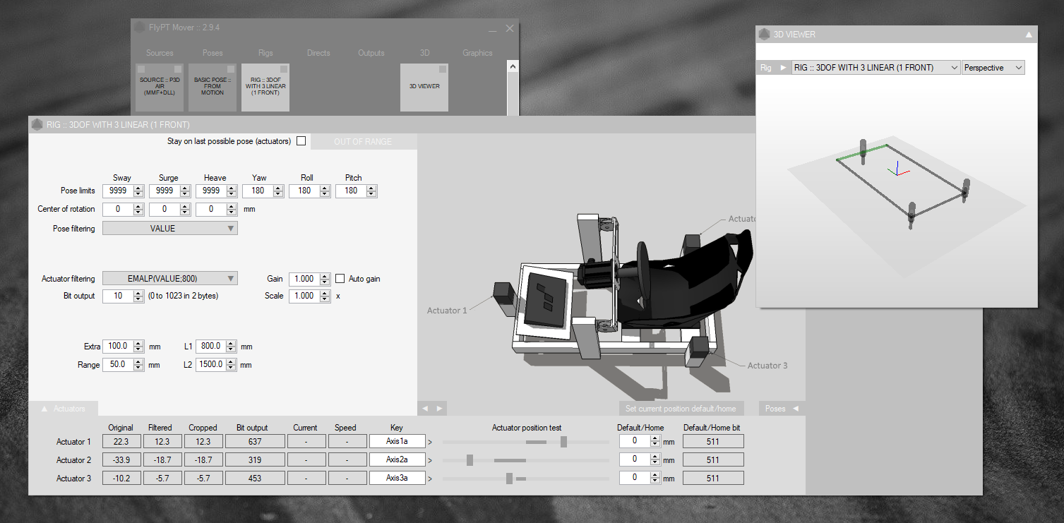

    So in your case it should be range=180 to map the entire bit range and make the angles match, supposing you have maximum bit output at 360º of the sensor.
    But the middle is more an hardware setting. You should have the middle of the sensor in your middle angle.
    To limit the rotation to 110º, you can use scale or keep the 180 and apply a crop filter in the actuators filters.
    The idea is to make the calculated angle match the reality.
    Thought you had it adjusted.
    Maybe I'm confusing everything. I'm a bit tired today... :confused:

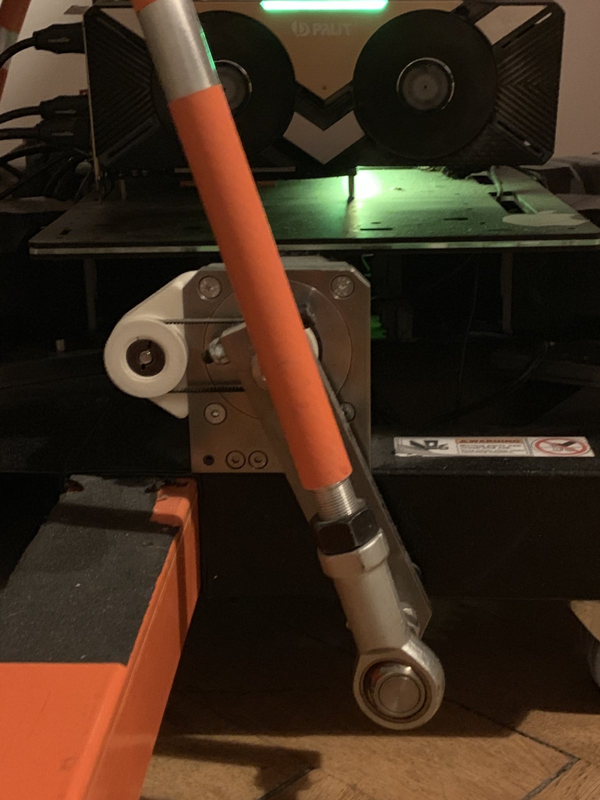

    No, you are perfectly right !
    180 range and 1x scaling is the correct setting for 360 sensors and NOT 90-110 range and 0,5x scaling like I had previously.
    That’s why I got confused and wasn’t able to set the home position properly.
    I like 180deg. range where the kinematic “out of pose” is limiting the platform sending it where it should be without any limitation. :)
    The accuracy less than 1deg. on rotary levers makes really pleasure. It’s like it should be - bravo.

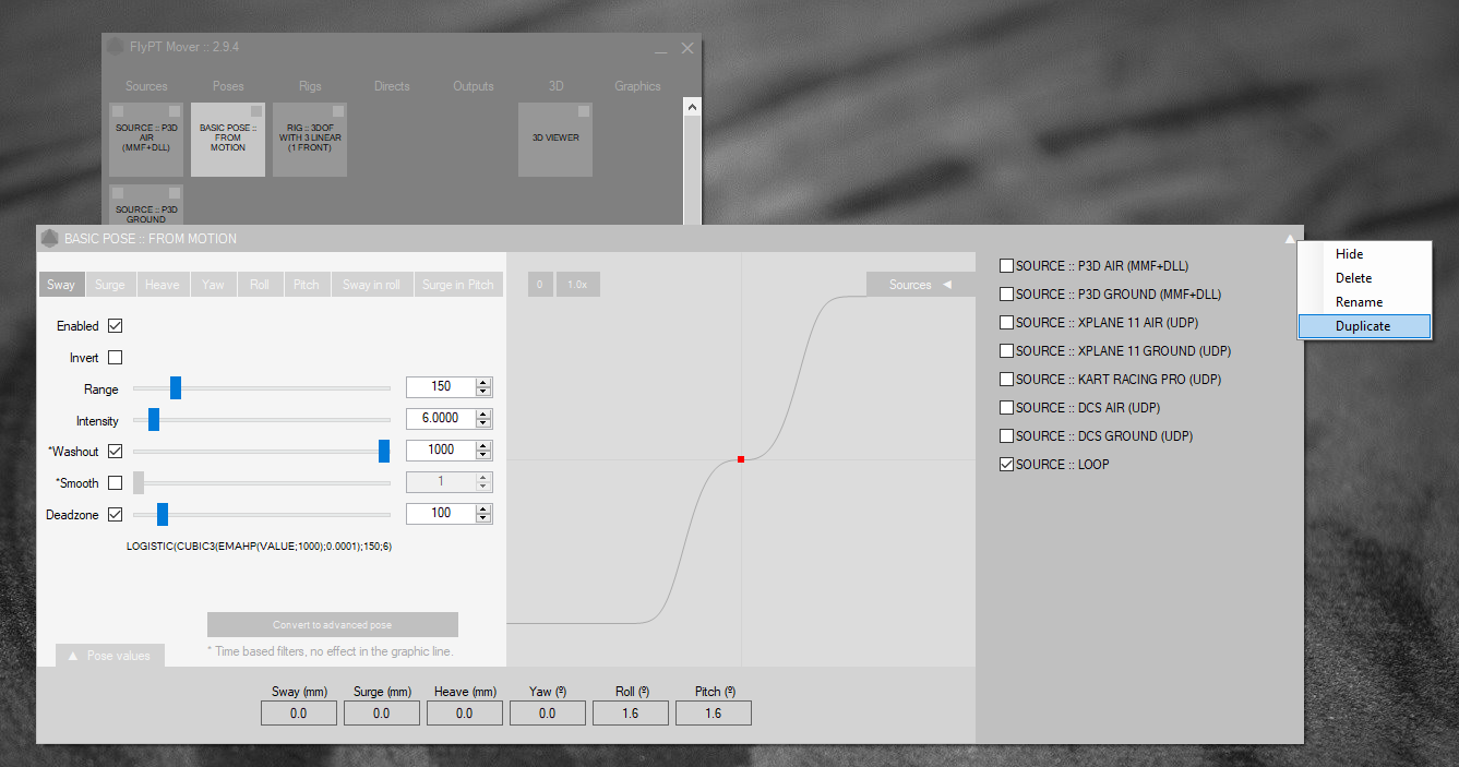

    Some small corrections and changes:
    - In/out graphic is now updating in:
    Multi direct module
    Loop source module
    Loop noise module
    - Using singularity angle of zero disables singularity test.
    - Sliders to move actuators in the rig module:
    Affected by the actuator filter when sliding with the mouse (be careful with the filters)
    Filtered value now shows on the slider
    - It's now possible to duplicate modules. Press the top right arrow in the module and select duplicate.
    If there's no duplicate, it's because we can't have more than one module of that type.
    - Allows more zoom in the orthogonal projection.
    Download in the first post !

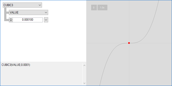

    I don't know what you are using now, but now, I'm using yaw speed as data source for traction loss with the cubic filter. Something like:

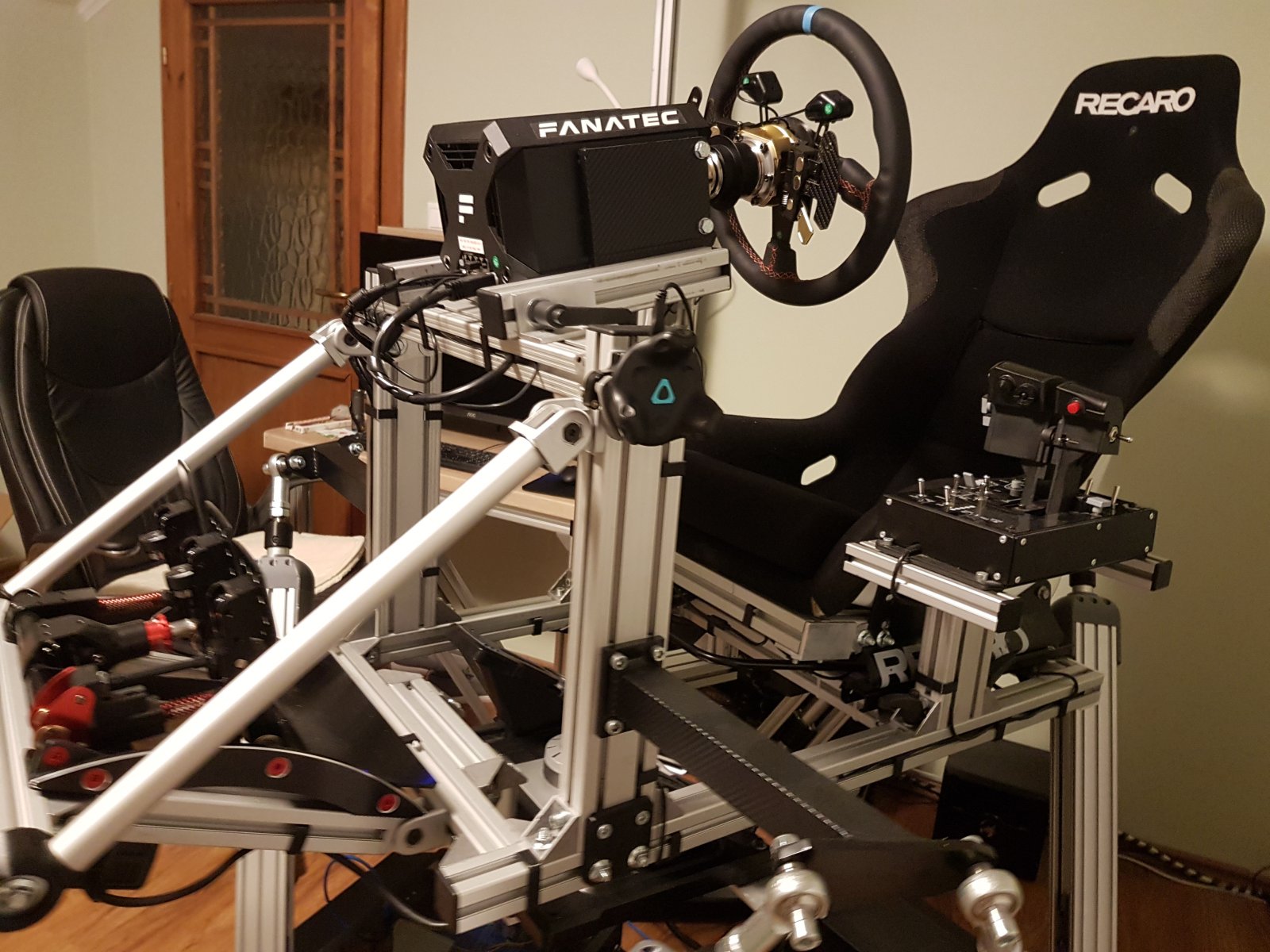

    This is my reference tracker on side of the rig:

    Could you share how you got motion compensation working please?
    I tried last weekend and couldnt get it oriented properly.
    I have been following the VR motion comp thread for a while but I must have missed it and I thought we collectively didnt have a solution.
    My efforts so far have been :
    Turn on motion comp in Pitool using a regular hand controller. Im using 5k+.
    This would do the motion comp no problem but the world would be rotated 90degs on the x or y axis and maybe some other translation.
    I then tried to used advanced settings to perform a world offset before turning on motion comp but advanced settings only allowed offset in 4dof and it was missing the axis I needed to compensate for the rotation i needed.
    I tried to orient the controller a number of ways before turning on the motion comp but it doesnt work this way.
    I also tried reset view in steam menu but you can't aim the controller at the button while motion comp is on.
    Then I went looking for a reset view in game with a keyboard press but mysteriously it would stop working when motion comp is on.
    I tried this while in Elite Dangerous but yet to try again in other games.
    I'd appreciate a brief on the steps you went through to get it working.
