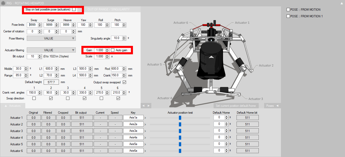

    Hello everybody,
    Sorry if this is a bit off topic, but hopefully someone can help me with a small problem I have been having:
    I've built a 6DOF with linear actuators with 57BLF03 motors and BLDC-8015A drivers controlled by 3 arduinos running SMC3 - and it is all working well. I'm using FlyPTs' mover software (which is great!) and playing mostly iRacing, Dirt Rally and X-Plane11.
    The problem i am having is related to sway+roll when the rig is moving quickly from one side to the other (when driving through a chicane for example). During these turns the actuators are running at their maximum speed, but because some of the actuators have less distance to travel, they are reaching their final position before the others, and this causes the rig to twist suddenly (yaw) as it reaches the end of the sway+roll pose. The actuators speeds are all equal ( I have tested this by using a heave loop in mover), but I think my problem relates to the actuator speed not being fast enough? (I'm using SFU1204 ballscrews, with 3000rpm motors, so only have 200mm per second of travel speed).
    My question is this:- has anyone else had this "yaw motion" problem? Is there any way that i can control the actuators to make them all arrive at the final pose position at the same time? Or is it possible to use some feature in Mover to make an actuator slow down as it reaches its target (or maybe the PID setting in the SMC3 Arduino code?)
    Any help would be greatly appreciated.

    Your problem is the range.
    Yaw happens because some actuators reached the limit, and others keep moving.
    You have to implement filters that fit your range.
    Or to keep the current filters, you have to scale them down with gain.
    Do it in the rig module by enabling Auto Gain or changing the gain manually.
    What this does, is lower the gain each time the rig goes out of range. (so you should disable it when you reach a value you find good)
    On the top, you have an option, to stop the rig if she enters in out of range state.
    Out of range happens if any of the actuators has no range to accomplish the pose you want.
    But then, the rig stops moving while you are out of range.
    Besides gain, you can act on the actuators by using a filter like LOGISTIC, to slow them near the limit, or limit the poses ranges.
    You can also use filters in the pose values, although current usage is not the ideal because of the scale difference between rotations and linear poses.

    1:
    Pose limits has nothing to do with the actuators.
    Everywhere in Mover, travel=2 x range. (because zero is the middle travel usually, so we have -range and +range)
    Pose limits are to limit the final rig movement. If you don't want the rig to pitch more than 15º, you put in pitch 15º.
    You now ask why is that in the rig if we have it in the pose modules?
    That's because you can use more than one module and the pose movement is the sum of the modules you use. So in the rig you limit it in the rig, in the poses, you limit it for the poses.
    You can say, that the suspension pose can use only 10º and the motion pose another 10º.
    But that goes beyond the 15º you want in the rig. So setting it in the rig, avoids anything above 15º in case it happens between the two poses.
    The default values are big. That way, there's no limits defined by default.

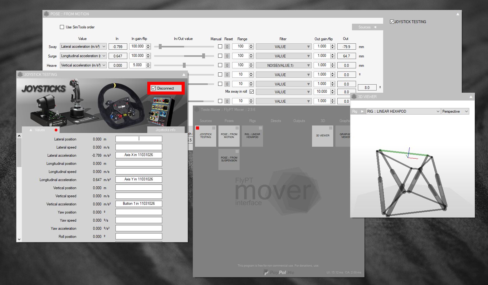

    For Thanos board don’t waste Time . In fact it’s just where you click with the mouse !
    If you click in the checkbox it has no effect but into the red rectangle it works ! It seems to be just where you click the problem !

    The checkbox is the auto connect, wanted to reduce it to a minimum...

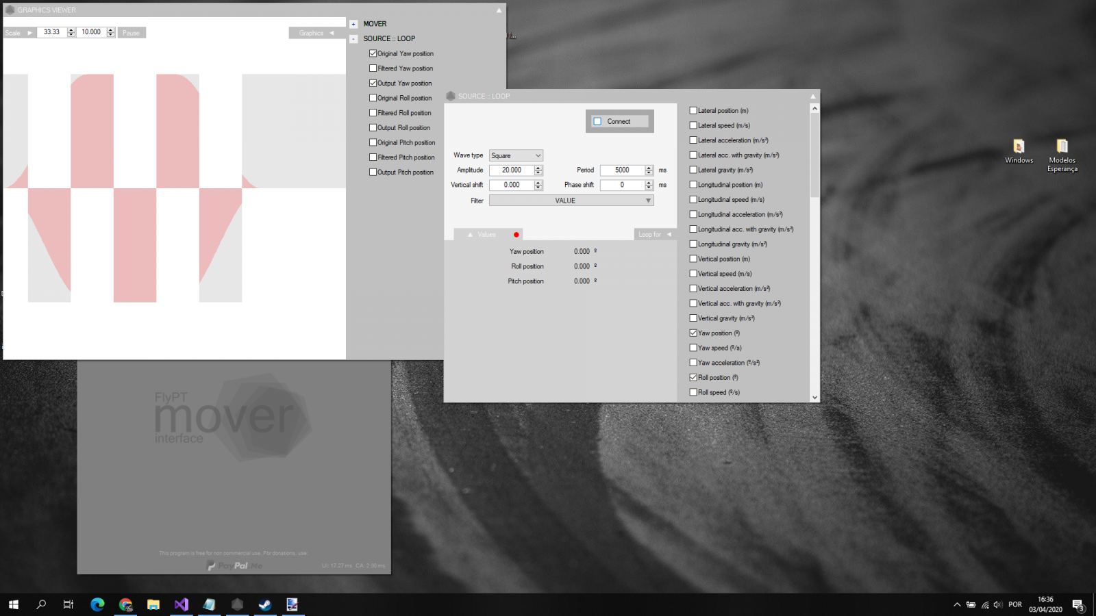

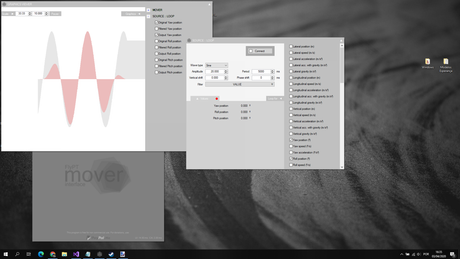

    Coming soon:
    You can generate any value with the joysticks.
    For example, I use Button 1 to create noise in Heave.
    A good application could be vibration when firing in IL2 (missing in the telemetry).
    Still WIP!
    Also to remind that support for AMS2 exists through the PCARS2 source (MMF or UDP).
    Should work unless they change something in the release.

    I like where your heading on joysticks as a source.
    Could I suggest a feature on your roadmap? Im sure you have a long road map of features.
    The wishlist feature is to allow additional serial outputs that are triggered by a joystick press or a keyboard shortcut.
    It would be a single shot output that connects to ports, runs the command, then closes the ports. Like a momentary switch for outputs.
    A bit different to the current outputs which uses the keyboard press as an on and off switch for the outputs.
    Im thinking of 3 separate lines of commands with a wait time at the end of each line so we can put a delay in the sequence if required.
    This is for some of us that need to send serial commands just once per evening session such as initialising and homing operations.
    Its also desirable to send position commands before starting games.
    Just a wish list item, no pressure.
    Love your Work.

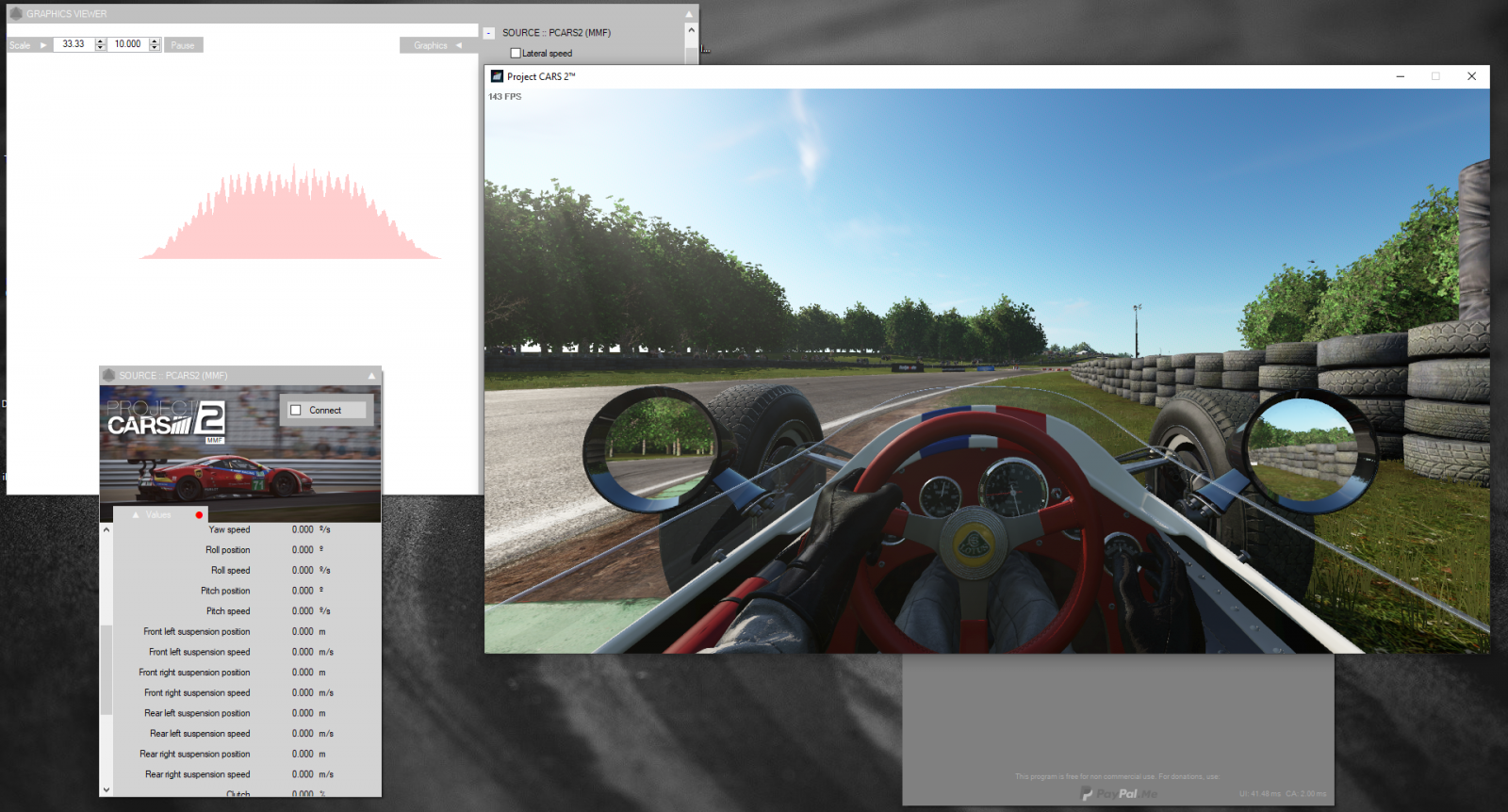

    OK, joysticks seems to be working.
    Dedicated some time (to much) to solve the connect/disconnect source transition.
    Ended having to rewrite that part of the code.
    I think it's now working OK, but need people to test it after releasing the new version (maybe today).
    I could not test all the variants. Sorry.
    Example in PCARS2:
    A start/stop with vertical acceleration (with gravity).
    Loops should have it solved also, unless we use square waves, that come with huge jumps already:
