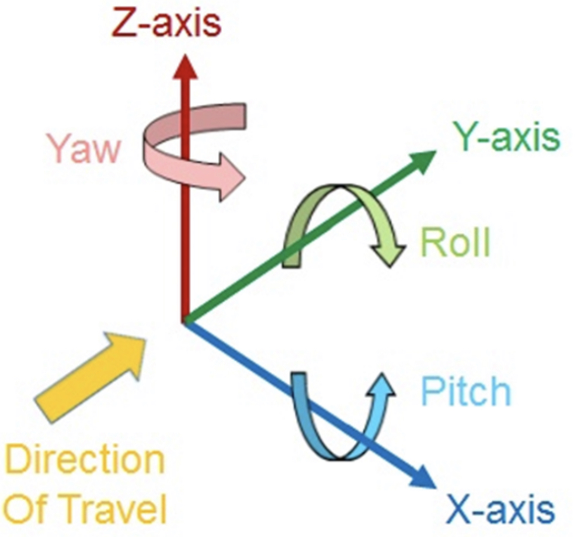

    @hexpod yes as far as I know Pitch is the only thing reversed.. Youre saying to put a - in front of what value? Sorry for the complete newb question but I learn by doing not listening :(

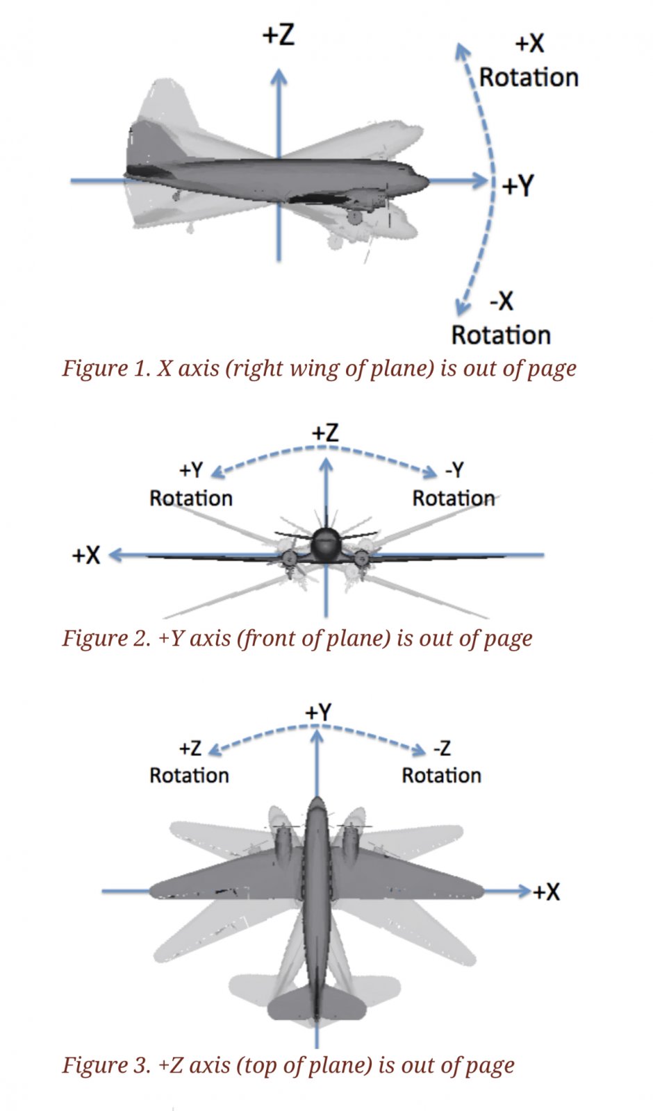

    Very strange.
    If you use front as rear, roll surge and sway should also be inverted.
    Could you post your config file and a picture of the hardware?

    @hexpod... Which way should the rig tilt on - roll and -sway? As of now the rig tilts to the left when negative and sway goes to the left as well when negative. Surge is to the rear when negative also.

    @hexpod ... GOT IT! For anyone looking to reverse their direction all you have to do is put a - in front of the (OUT Gain/Flip) which is in the first post of this thread!!
    After reading it over again I noticed it and BOOM done! :)

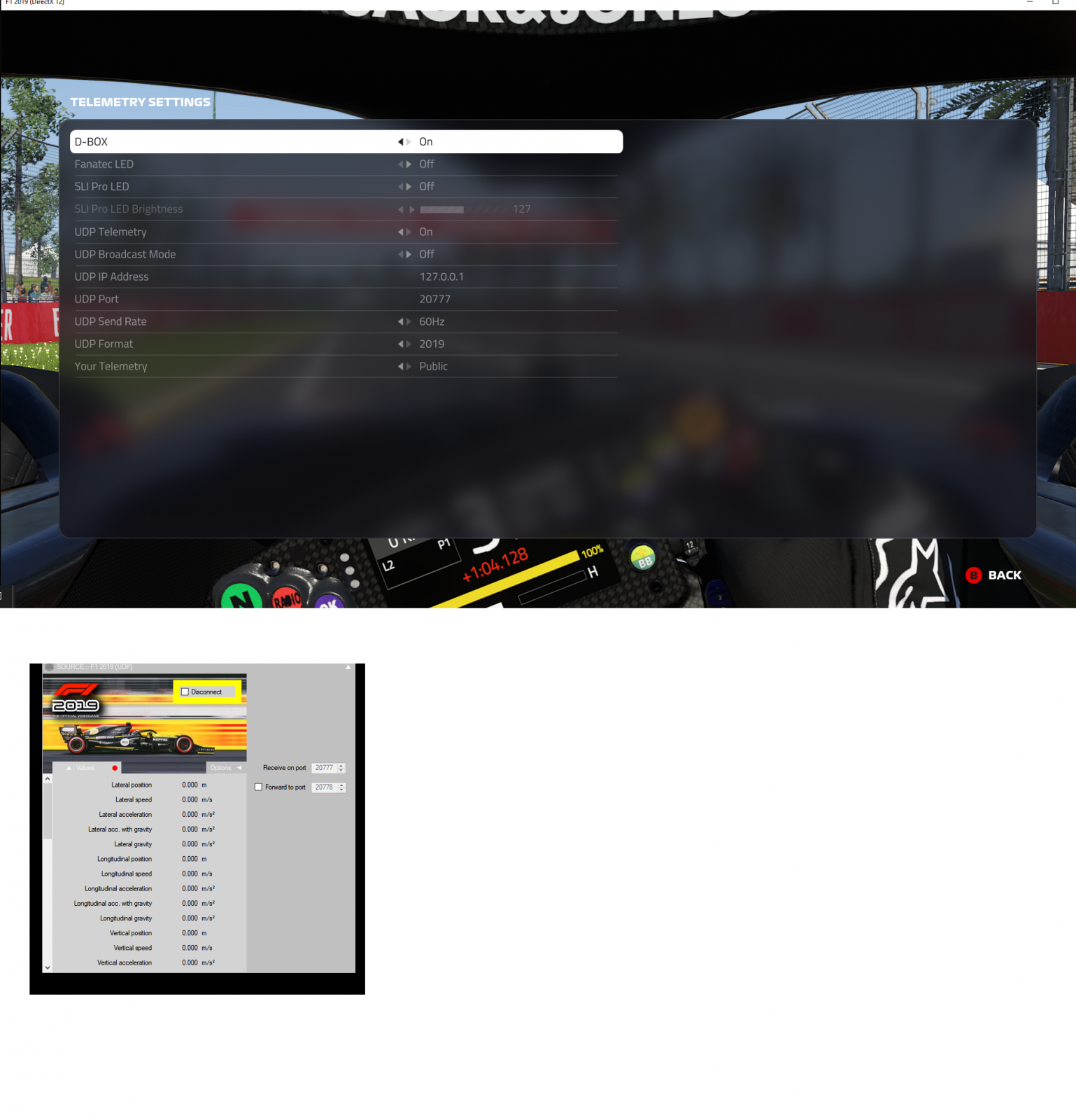

    Having some issues with the F1 2019 plugin. Not receiving any telemetry in the plugin but Simhub works fine for my buttkickers. Tried all in game settings
    Nvm, Simhub was in the way
    Edit. Seems to not work right. Im getting a lot of spikes in lateral acceleration etc and while i get long/vert/Lat accel with gravity and have only those enable the spikes will move my flaps but with gravity does not. Trough simtools it works fine. Maybe cause its using legacy mode and Mover 2019

    Here's a recording of the F1 2019 inputs im getting.

    Ok, seems i jumped the gun a little. The issue seems to be when the game is in 1920 window mode the telemetry is completely whack. In fullscreen and window 5760x1080 its fine. Its not that surprising given this game is riddled with bugs.

    Ok so ive tested single screen without nvidia surround. Does not work in full screen or windowed.
    Turned back to 5760 full screen and windowed and it worked fine. Getting all values of later acc and lateral acc with gravity etc. Thankfully i only play with triples.
    1920x1080
    Tried to hide all, no change.
    Tried to minimize, no change.
    Tried to keep it under the game window no change.

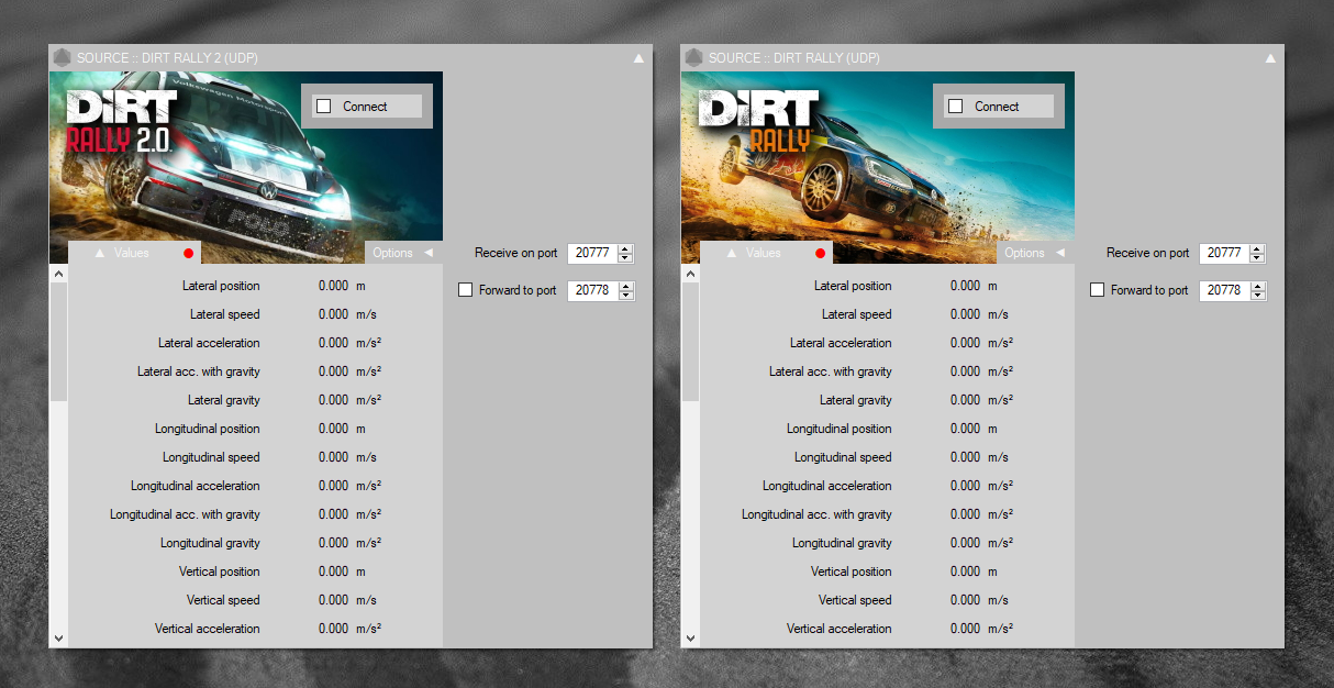

    Hi, FlyPt is juste a dream ! Its a very nice sort !!
    i have a question. Whats the process to make a New source for a game that simtools and FlyPt not make today (dirt rallye 2 (not 2.0 just 2 ;) )
    Thanks everyone !!

    For now it's closed, it has to be me, code is not stable enough to make plugins.
    And, I'm not thinking of plugins, I want to make it easier to use ;)
    But what do you want, Dirt Rally 2 not 2.0? What is that?
    Dirt Rally is already included in Mover, for version 1 and 2:
