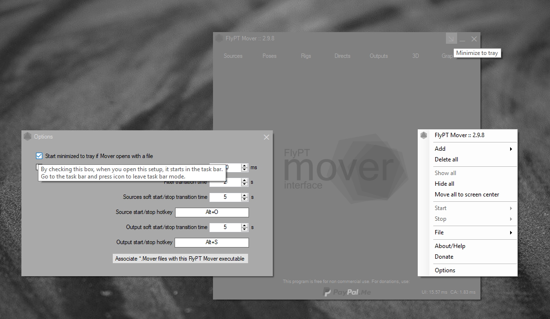

    Changes:
    - Solved bug in hotkeys, setup was lost.
    - Added sources manual (big) with sources setup.
    - Added minimize to task bar.
    We can now set the setup files to start minimised in the task bar for a cleaner desktop.
    If you are happy with your setup, you just need to use the hotkeys to start/stop outputs.

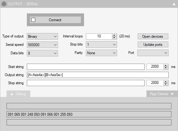

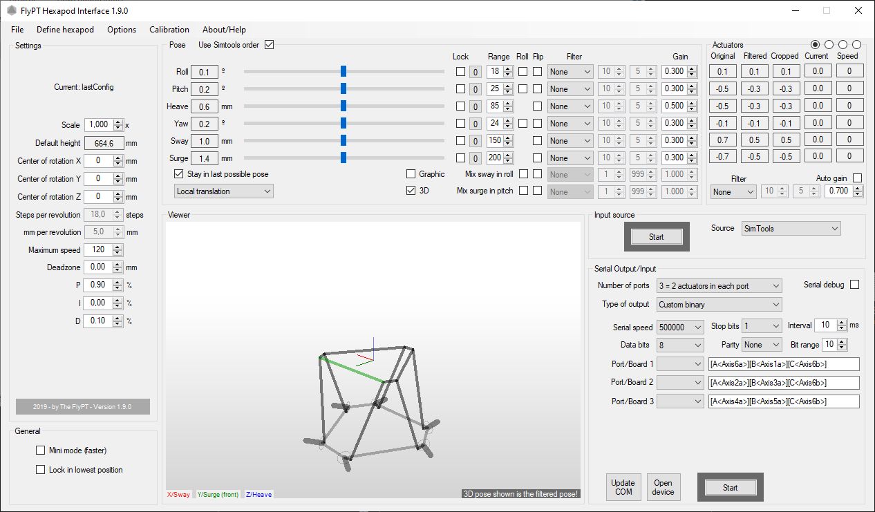

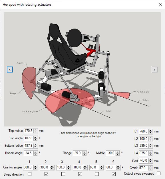

    Hi
    i got the rig running with FlyPT Mover, but everything runs in wrong direction.
    If i turn the heave slider to the left in FlyPT-Hexapod the rig is moving down
    If i turn the heave slider to the left in FlyPT-Mover the rig is moving up.
    But both use the same settings.

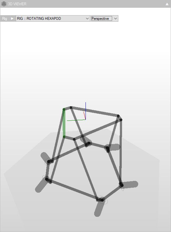

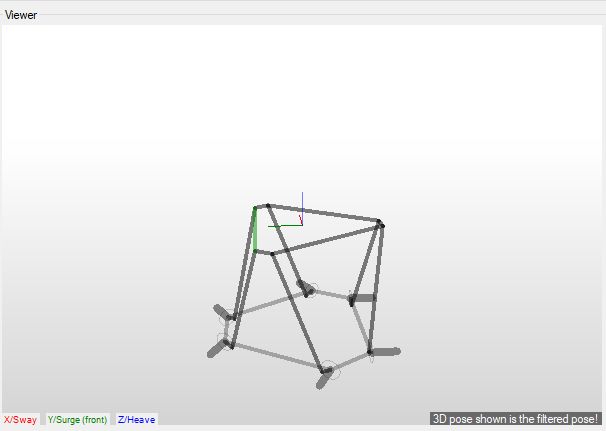

    3d looks also the same and shows the correct movement.
    It goes up in Hexapod and Mover by slide to the left.
    Here are my settings:
    FlyPT-Hexapod:
    71673 71672
    FlyPT-Mover:
    71671 71674
    When i use "output swap swapped" it moves "yaw" instead of "heave".
    @pmvcda Can you help me please?
    Peer

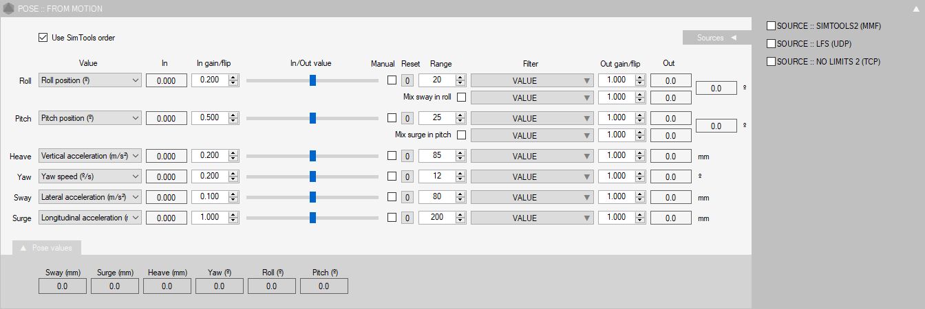

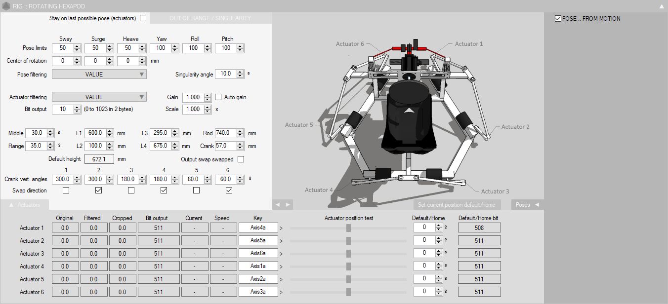

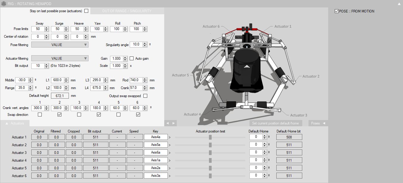

    Hi
    Here are my mover settings:
    Thanks in advance
    Peer

    I will look at it tonight (I'm out), but are you saying it goes in the right direction In the 3d view?
    Did you inverted values in the old program by using the checboxes?
    Looks like you have inverted actuators.
    You could try to put gain - 1.0 in the rig, next to the actuators filters and see if this solves the problem.
  10. C1500
    C1500 Active Member
    Nov 19, 2018
    165
    1,120Coins
    +86 / 1 / -0
    AC motor, 6DOF
    Yes, the 3d-grafic shows the right movement but the rid is inverted
    This are my hexapod settings in which the rig moves correct.
    There is no "inverted" checkbox activ

    No, I mean in the main window of the old program. Next to the sliders.
    And try the gain - 1.0 next to the actuators filters in the rig module of Mover.
  12. C1500
    C1500 Active Member
    Nov 19, 2018
    165
    1,120Coins
    +86 / 1 / -0
    AC motor, 6DOF
    No, there is no "inverted" checkbox
    When i chang to -1.000 in Gain, i get the following movements:
    Roll slide left -> my head moves to the right
    Pitch slide left -> my head moves to the front
    Heave slide left -> my rig moves up
    It´s just like the 3d view
    Short Update 19:12:
    With -1.000 in gain, the sliders work correct.
    But LFS is inverted now but works OK witch 1.000 in gain
