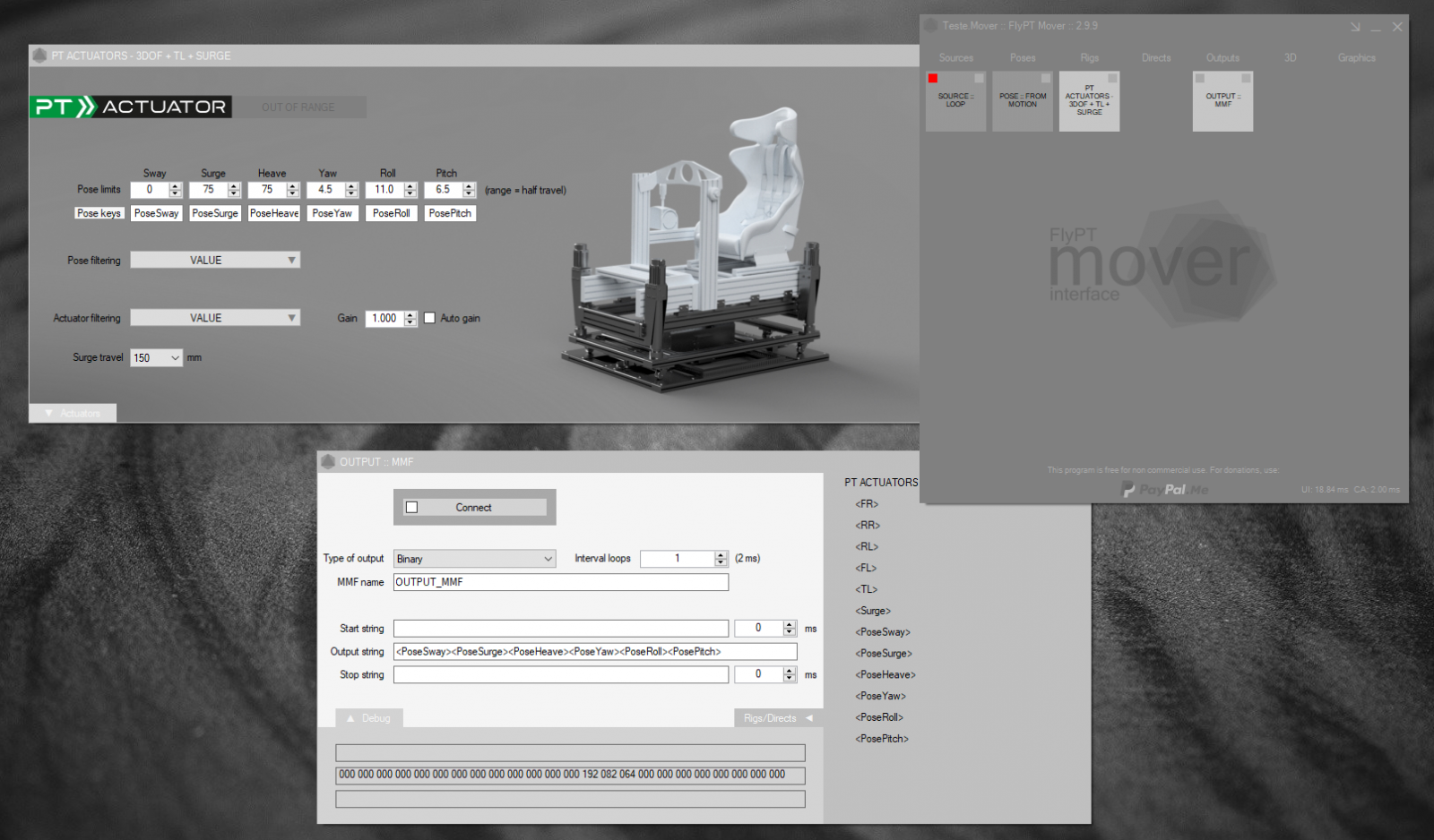

    New/Changed:
    - Added pose values to the outputs.
    This allows the output of the the pose in double precision for test trials in motion compensation or to send it to hardware that takes care of motion/actuator calculation.
    The new PT Actuators rig module outputting it's pose to a memory mapped file

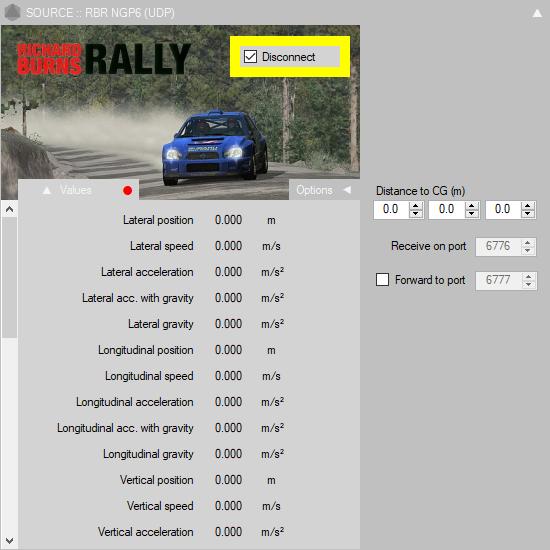

    - Added RBR source accessing UDP generated in NGP6 (http://www.ly-racing.de/viewtopic.php?t=8840).

    The new RBR source with the CG correction visible.

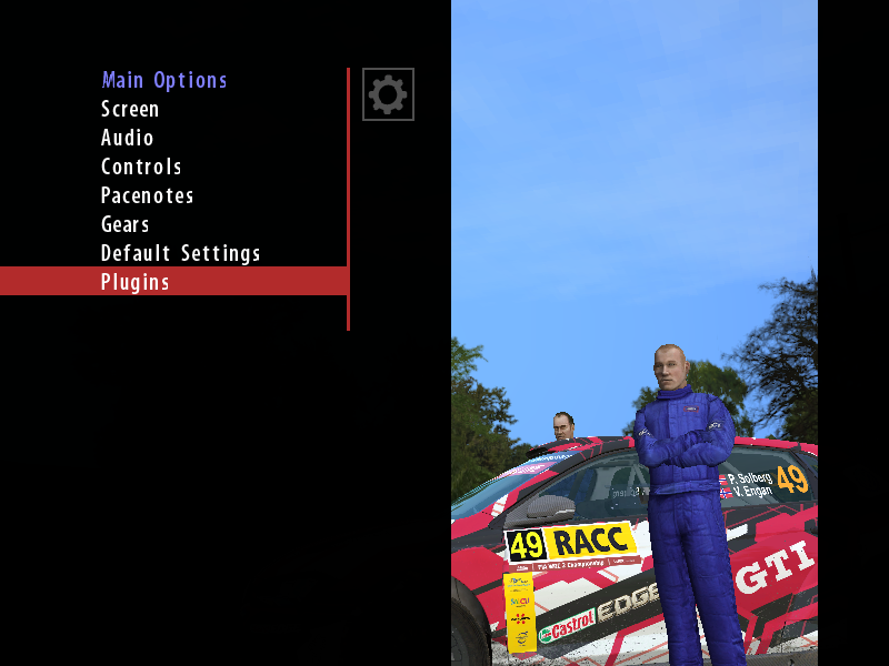

  3. OneDadz
    OneDadz New Member
    Feb 24, 2020
    12
    87Coins
    impossible to connect to RBR, I don't understand :(

  6. OneDadz
    OneDadz New Member
    Feb 24, 2020
    12
    87Coins
    I updated the NGP, I think I have done the trick, I don't understand. I made several attempts, I am lost.

  9. pmvcda
    pmvcda aka FlyPT
    Nov 3, 2010
    2,296
    Portugal
    16,036Coins
    +2,746 / 18 / -0
    I will look at it tomorrow.
    But I just installed rbr followed by the latest ngp mod.
    I think the udp was automatically enabled.
    But it's so many things that I might be forgetting something.

    @OneDadz
    Do you have udp enabled in the NGP options (should be by default)?
  12. OneDadz
    OneDadz New Member
    Feb 24, 2020
    12
    87Coins
    I don't understand, the plugin does not appear in the rbr menu. Thank you, I will have to solve this problem.

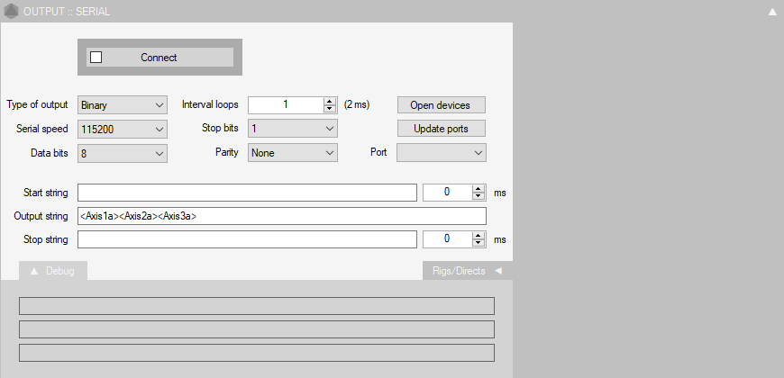

  13. OneDadz
    OneDadz New Member
    Feb 24, 2020
    12
    87Coins
    Hi @aka FlyPT,
    I have settled my concern, that's it. On the other hand I very often have this error displayed.
    On Dirt after about 30 minutes, and on RBR, a few minutes.
  14. pmvcda
    pmvcda aka FlyPT
    Nov 3, 2010
    2,296
    Portugal
    16,036Coins
    +2,746 / 18 / -0
    @OneDadz , what controller are you using?
    You might need to increase the interval you send data to the hardware (reduce rate).
    You can do it by increasing the interval loops. Next to it is the interval at which we send data, it's a multiple of the calculation rate.
    If you have a Thanos or ESP32, they are fast and can handle the 2 ms, but other solutions, usually work with 10 ms.

  16. Gabor Pittner
    Gabor Pittner Active Member
    Oct 25, 2018
    203
    Szekesfehervar Hungary
    1,396Coins
    +89 / 0 / -0
    After the 2.9.9 mover is released, I get more often the same error that @OneDadz posted. Especially when I pushed the start/stop output hotkey.
    I changed the USB cables, and changed the ESP32 board too. But my biggest problem is that all ESP32 boards have the same hardware ID and COM ports are swapped sometimes. Im sure this caused the main problem with serial data communikation.
    However Yesterday I found a solution how to change ESP32 board serial ID to get a uniqe ID. After it windows could reserve COM port all uniqe ESP32 board. And yesterday afternoon I haven't got any error for about one hour.
    I will test it more....

  20. Gabor Pittner
    Oct 25, 2018
    203
    1,396Coins
    +89 / 0 / -0
    Yesterday I've been gaming for about 3 hours. To get in and out of the seat I used start/stop output hotkey without an error at all. Im sure I used it more than 50 times.
    After about 2hours I got a serial error and lost one of esp32 board, and mover freezed. At that time I was going strait on the road, didn't push a button, only the throttle pedal, I even can not guess what happened on that strait after 2 hours gaming...
    My output serial baud rate was 921600, and internal loops was 2ms. I increased it to 4ms and played more half an hour without an error...
    I hope it works.
