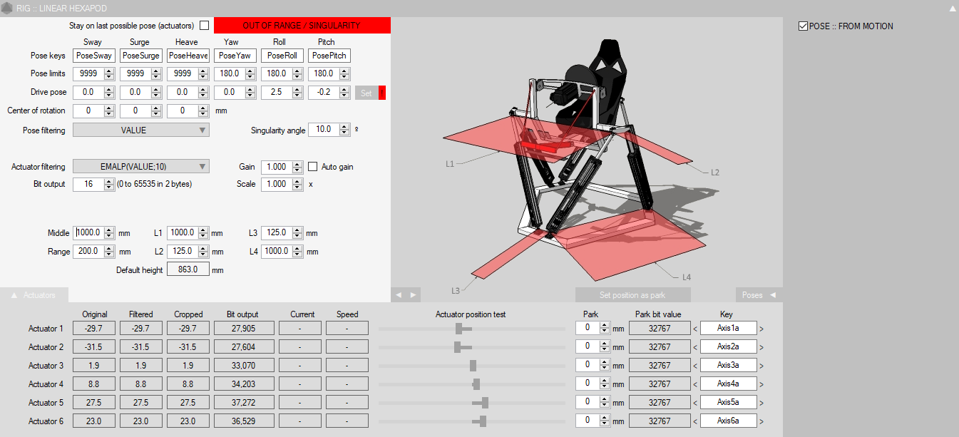

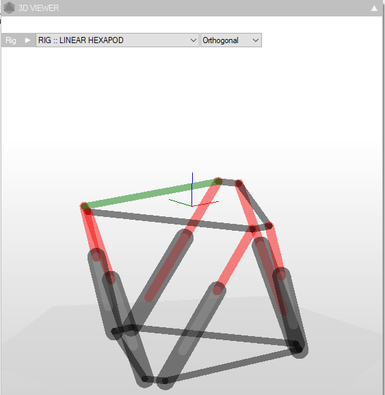

    I'm getting myself familiar with the mover software. Amazing stuff! However I run into 2 issues:
    • a warning next to "set". I can click it, or change drive pose values but no difference. What does it mean/what am I doing wrong?
    • I get the warning "out of range/singularity" when I try to use any filter with any value. All actuators however are around zero in both cases, and the angle is definitely above 10 degrees. But the 3D picture is also weird: the red rods are different on 4 actuators.
    I read trough all 63 pages to avoid asking stupid/repetitive questions but unfortunately no answers. Help appreciated!

    Drive pose is the default rig position.
    If you want to set a position for Formula cars, you can put the rig in that position and press set to make it the default position.
    Or you can have a more upright position for standard cars.
    All movement is made around that default position.
    The problem is that if you press set with the rig connected, the rig is going to jump, that red ! is just a warning for that, but badly explained.
    Use the set, with the rig disconnected, or be ready for a jump!

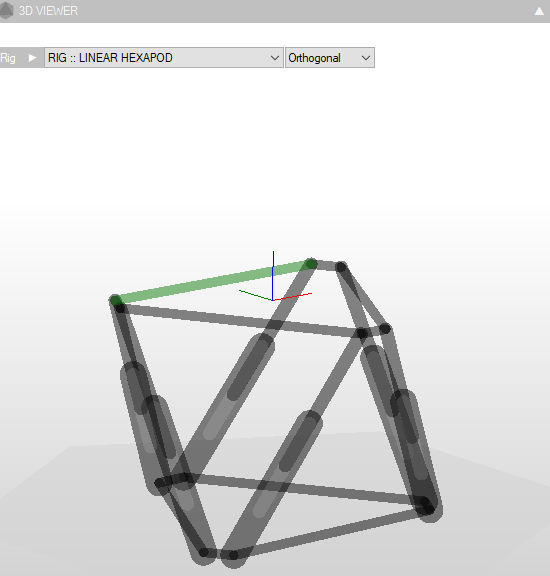

    There's two warnings, singularity and out of range.
    Singularity happens if top platform is on the same plane of actuators.
    Out of range if the requested position is not allowed by the actuators range.
    The alert works for both, this does not mean it's a singularity problem, should be the out of range.
    Yes, this needs work. Sorry.
    And I find it really strange that you get out of range with those values. Been testing your measures and it works here.
    Can you share the setup please.
    Are you trying a recorded setup from the samples?

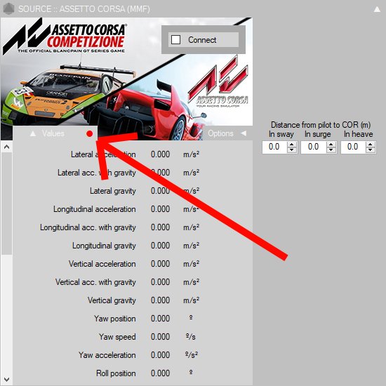

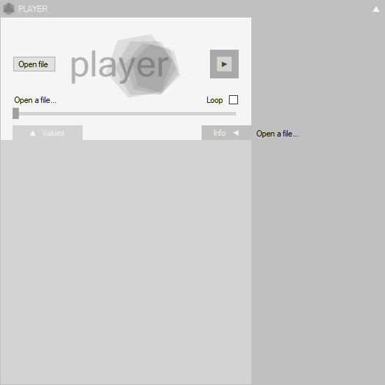

    In Mover, you can record the motion received from the game.
    But you are not going to have video.
    But that's in my plans...
    To record the motion press the red circle button:
    You can replay the recorder file in the player source:

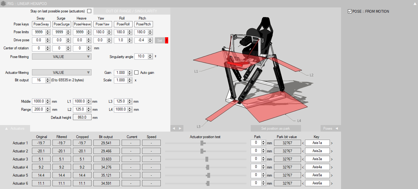

    No worries, I can increase the singularity angle and see it becoming red in case of exceeding that value. So I can see if its an angle problem or out of range problem.

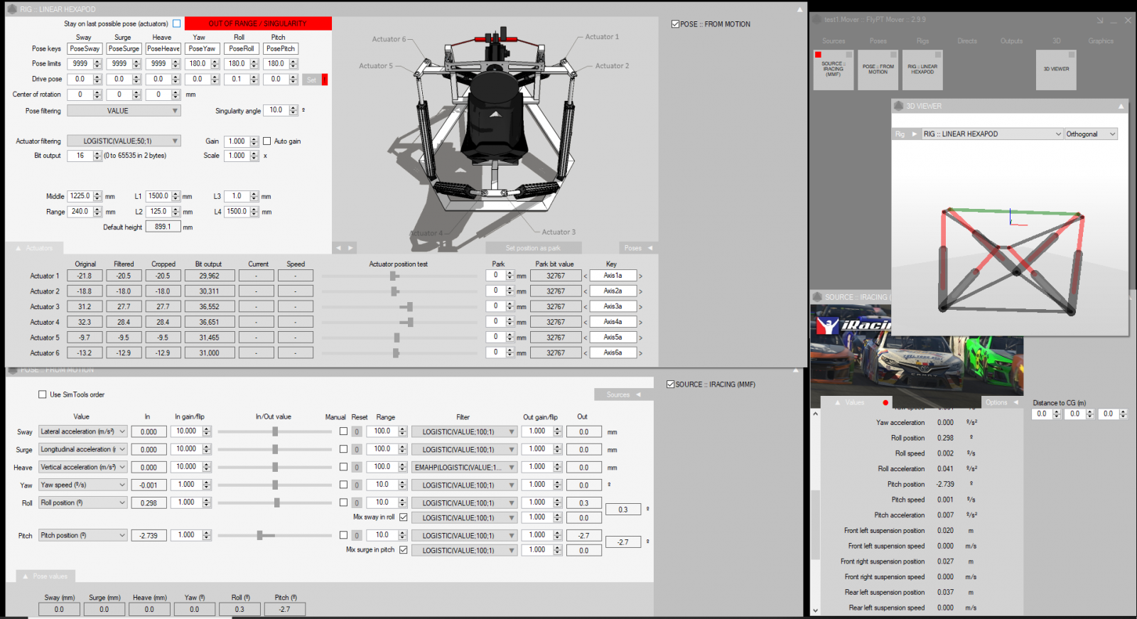

    What I did: i opened the program for the first time, add source iracing, add pose from motion, add rig linear hexapod, put in rig dimensions. That's it. No changes at all, it works immediately. So far so good. But the moment I add a filtering on the actuators (in rig screen!) it gives the error on almost all filters, although the system seems to remain more or less functional. Actuator values remain within range, and no red indicators on those values. 3D representation also looks weird. Regardless of rig dimensions this issue remains.
    It now do the filtering in the pose screen, since it allows me to filter for all the dof's individually. That works fine so far. Does that seem a logical approach to you @pmvcda ? That also poses the questions (pun not intended:) why should actuator filtering be used anyway? I'm using the thanos controller which also has some filtering options to reduce jitter and stuff.
    See screenshots and config file. Hope this helps you, and us. As far as I'm concerned, no rush.

    Actuator filtering is there for rigs without filtering.
    That's my case.
    You can also make it faster in Mover than going to the hardware controller.
    It's there for who wants to use it, but remember, actuator filtering doesn't show in the 3D viewer.
    Pose filtering shows in the viewer.
    I'm going to take a look at your setup.
    I had someone else complaining with a similar problem. It seems to me that old setups might be causing the problem in more recent Mover versions. Might be the case of the setups I put in the download.
    That would be a strange issue :think, but possible.
    The other cause might be the actuators filters.
    Avoid using a filter in the actuator. Use filters in the pose.
    Like I said, actuators filters don't show in the rig, so the fact of getting red actuators might be related to some wrong code in the actuators filters.
    (it was one of the changes I made lately)
    If we get under the singularity angle (minimum angle we allow between platform and actuator), we get the out of range/singularity alarm, but the angle field goes red also.

    ok thanks, makes sense. I will avoid actuator filtering. Btw, I didnt ever use a previous version and I didnt base the setup on an example.
