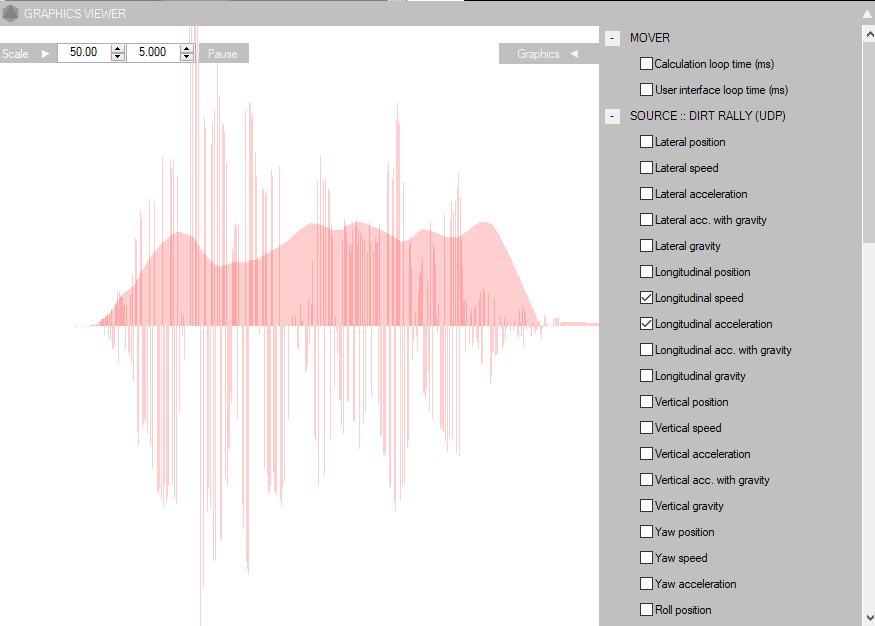

    Hello Everybody,
    I've been using Mover on a Win7 PC since October last year and it is a great piece of software! (thanks FlyPT)
    I've setup a new PC running windows 10, and finished installing Mover (2.9.9) + driving sims (iracing, Dirt Rally 1 + 2, Project Cars 2). Everything is working ok except for the Surge and Sway in Dirt Rally 1. The telemetry is being received as a source in Mover on UDP 20777 and is ok for pitch, roll, yaw and heave, but the Surge and Sway accelerations look like they are corrupted. The image below shows the Longitudinal speed and Longitudinal accelerations. The acceleration data just looks like random noise and doesn't seem to relate to the changing longitudinal speed. The problem is the same in both full screen and windowed mode.
    Does anyone know what could be causing this problem?
    [EDIT: Solved this problem - seems to be that UDP telemetry can become unstable if the game screen FPS is too high. Looks like the accelerations for surge and sway are at the end of the UDP packet and weren't getting transmitted correctly. Increasing the graphics options in Dirt Rally to reduce the overall FPS has solved this problem. This may also be the reason that some users have reported telemetry being unstable when using games in windowed mode.]

    HI,
    Was it running well in win7?
    Some accelerations are calculated by Mover and that can be the reason. Seems the timer is causing troubles.
    Try using a MALP filter on the acceleration, maybe with a value of 300 or more to get it better.
    I'm going to verify it, but I had it smooth on my side from what I remember.
    Another cause can be the cor value in the source, please verify if it's all at zero.

    It was running ok in Win7. Had to use EMALP with about 300 to smooth it out in win7, but it was working ok. With the new installation on Win 10, the data seems to so scattered across +ve and -ve values that even with filter applied the accelerations just seem to shake the rig at random. Dirt Rally 2 is working well - the problem only seems to be in Dirt Rally 1. I have checked all the obvious things, reinstalled Dirt Rally, created a new setup in Mover, checked the hardware_settings_config.xml file, tried different UDP ports, used older versions of mover - I just cant seem to identify the problem!
    One thing that did seem strange, the Distance to CG seems to amplify the problem. Normally I leave the Distance to CG = zero for all 3 directions in all the game sources, but with Dirt Rally 1 if I leave the values at zero, the surge and sway values stay at zero during the game (all the other telemetry is ok). If i put in a small value in the Distance to CG as per the image below, I get some data received for surge and sway, but the data seems wrong.
