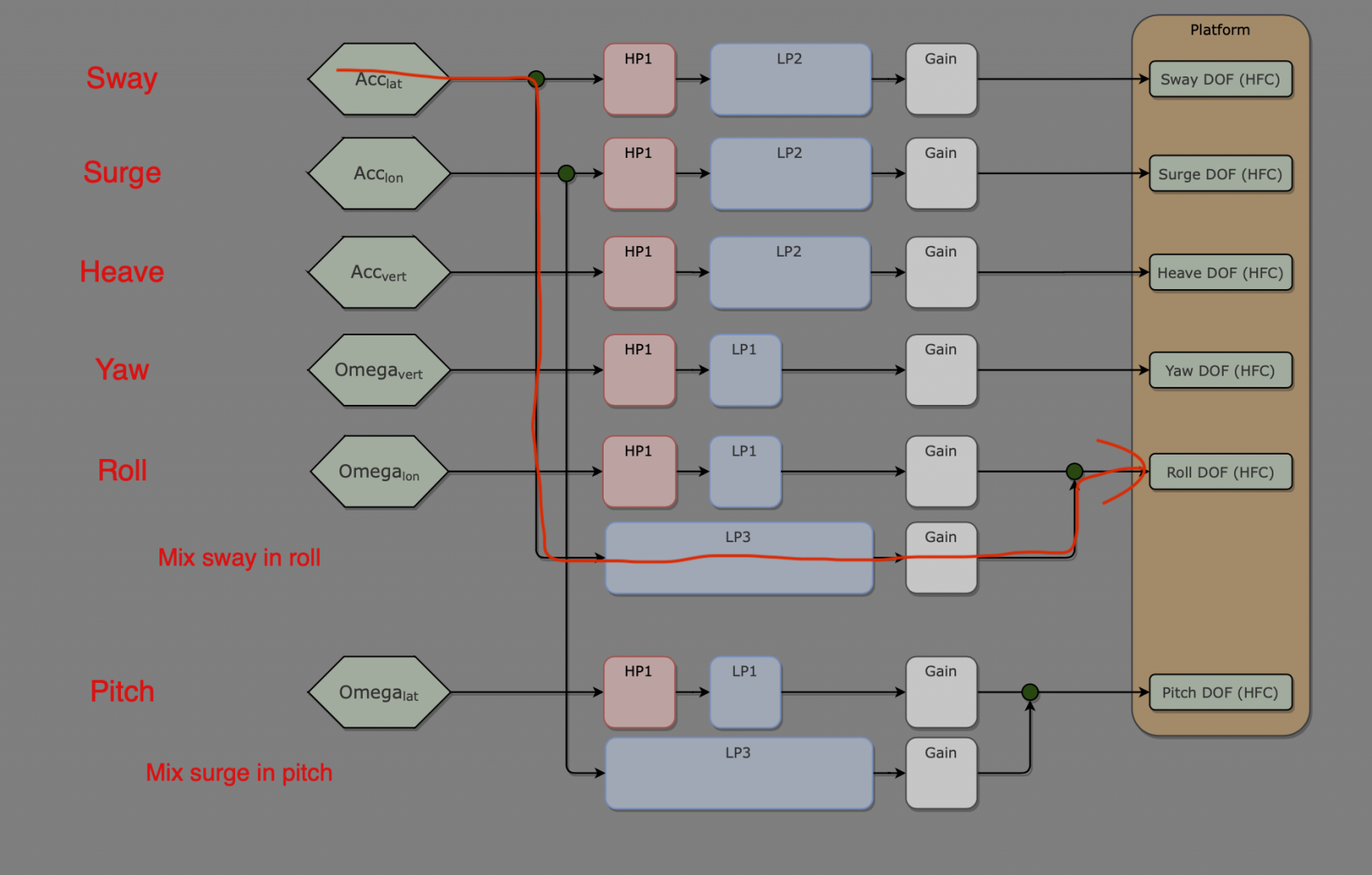

    I'm into combat flight sim and interested in aerobatics so I'll actually be tuning my sim for this situation as well. Between really good G-systems, and large heave travel (over 1 meter), I think I'll be able to get good results without needing any special features to support it though. It does make me wish I was going to have actual pitch motion available though. This is the first thing that made me regret that I won't.
  10. Dirty
    Oct 15, 2017
    746
    All the way up front.
    7,981Coins
    +890 / 3 / -0
    Hey :)
    I don't see knife edge missing :) Knife edge flight is just a very very very very un-coordinated flight and it will lead to the rig being tilted to one side with the simulator pilot "hanging" in there.
    Here's the same image I posted earlier
    The continuous lateral acceleration will NOT be filtered out, because it never goes through a HP filter. :thumbs

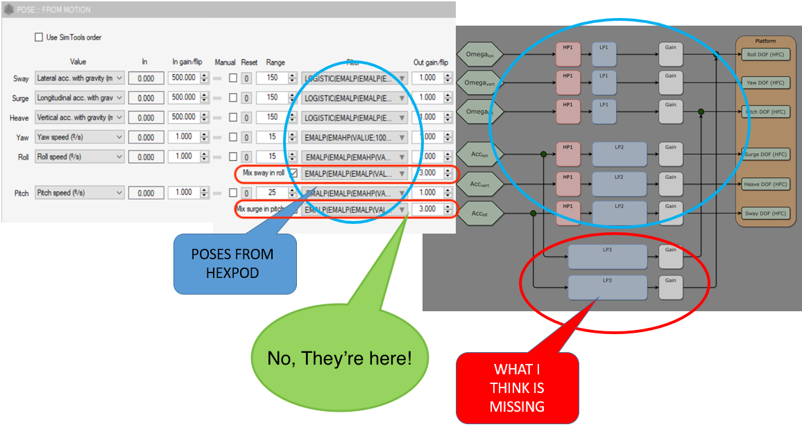

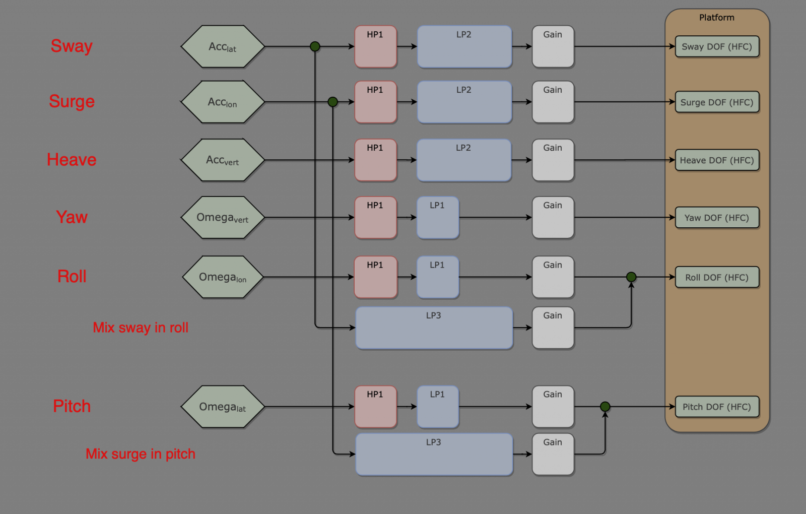

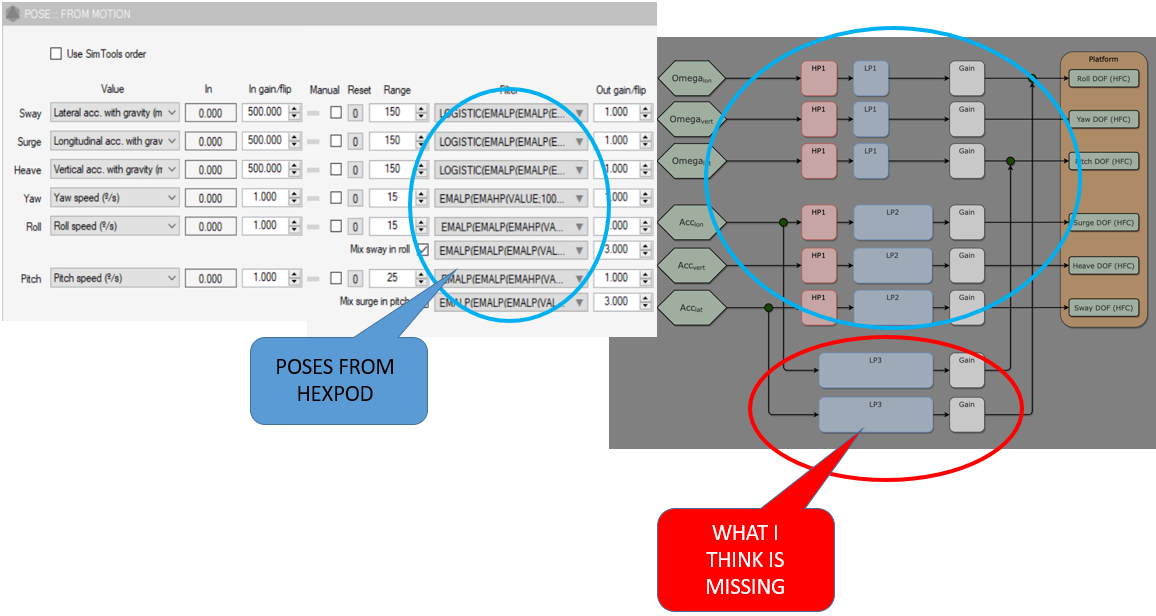

  11. Dirty
    Oct 15, 2017
    746
    7,981Coins
    +890 / 3 / -0
    Give me a minute and I will re-arrange the flow chart to match the Mover UI. Take this for now:
  12. Dirty
    Oct 15, 2017
    746
    7,981Coins
    +890 / 3 / -0
    Here's the flowchart re-arranged to match the Mover UI:
    You can see, it's all there.

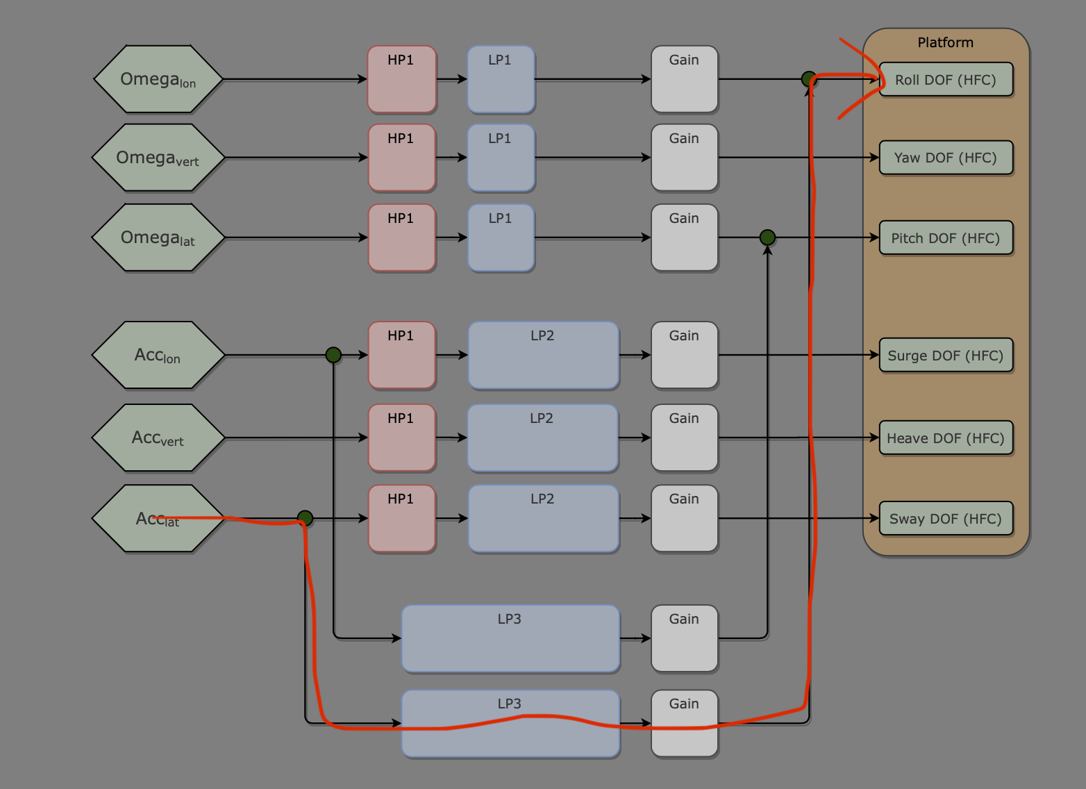

  17. Trip Rodriguez
    Trip Rodriguez VR Pilot
    May 8, 2016
    683
    Lake Ariel, Pennsylvania
    3,978Coins
    +331 / 7 / -0
    @pmvcda and @Dirty
    Re: @Trigen
    I figured out what Trigen is getting at, and it is interesting. It's an aerobatics type situation.
    You are flying knife-edge and the motion sim is working well giving you a continuous sway cue. Then you pull the stick straight back for a LONG sustained 4G turn, maintaining your 90 degree bank throughout.
    What happens?
    The problem is this: The 1G sway acceleration for the 90 degree bank remains as it should, but the 4G heave acceleration that should now exist was only momentary.
    Now you would expect to be feeling the crushing 4G heave acceleration and not even be aware of the sway acceleration that is still there, but because the sim is incapable of providing that heave cue you are left with the strongest force being sway which feels very, very wrong!
    It's a problem caused by the physical limitations of a motion platform, not by any flaw in the cueing logic. Trigen is looking for a way to cheat to cover up this glaring defect in the motion simulation during air-show type maneuvers. A pure pitch/heave acceleration is not in any way opposite a sway acceleration, so the sway cue remains at full strength
    IMO the thing to do is work on ways to add strength to the sustained heave cue (G-seat and motion sim pitch), and after getting as much as possible out of that, decrease the strength of the motion sim roll for sway cue until the balance is acceptable. Your' sway cue in knife edge flight will be weaker than you'd like but at least it's correct.
    Aerobatics is probably the #1 most difficult thing for a motion sim to do well. Before you guys started at solving these various problems it was absolutely awful! Trust me, I tried!
    PS- What @Trigen is asking for is a feature that will allow him to link heave and sway so that as heave acceleration levels increase (away from neutral (1G) in either direction), motion cues for sway are proportionately decreased (toward neutral from either direction). I know just enough about programming to know that providing this would likely be FAR more work than a non-programmer would expect. Also that every feature no matter how simple can cause bugs that seem totally unrelated in future updates. Further complicating the possible usefulness of this special feature, it would need to have a 2G "dead zone" from -1 to +1, because heave's "neutral" reading is 1G when flying straight and level, negative 1G when inverted, and zero when flying knife-edge.
    If the feature could be added experimentally without too much effort, I think it would be worth a try. I just worry about over-burdening our generally unpaid programmers who are already working very hard for us constantly improving things and fixing bugs.
