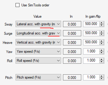

    I think the problem is the missing vertical cue that make the lateral cue stick out unrealistically. And you want to dial down the lateral cue to have it "match" the vertical cue? Is that correct?
    You could add a harness tension system to increase the vertical load, or you have to accept this as an edge case that a 6DOF Stewart type platform will have to live with.

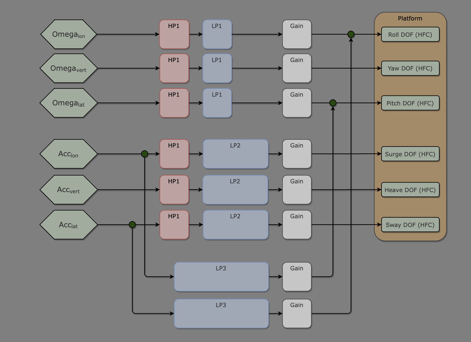

    I find all this very interesting and would like to know in detail how to setup those HP an LP filters correctly in mover. Or maybe there is already another thread which explains which values/filter types to use and how those values should be related to each other? In other words, what's essential and what could be adapted "to taste"? Also, if this is the generally agreed consensus of a correct motion cueing it would be very nice to be available as a starting point in mover, because right now when you click "Add->Pose->From motion" or "Add->Pose->Basic from motion" you get different default telemetry values/filters

    Applying a properly constructed classical washout or derivative is valid ONLY under specific conditions :
    1. Accelerations have to contain gravity component
    2. Rotations velocities have to be available
    It might be important to point as it’s not necessarily the case in all titles.
    Once you have an access to those, it’s really super simple. You really don’t have to think about specific scenario, whatever you do, the force vector will be applied correctly across heave/surge/sway.
    Last thing to mention is that you can use gravity to simulate sustainable lateral or longitudinal accel up to 0.5G, (don’t use HPF for this) BUT you CANNOT do anything for heave what concerns Stuart platforms therefore additional pressure systems (Especially for heave) make sense.
    I also highly advise to apply a logistic function as it can dramatically increase your workspace like I did in a quick Cessna profile for xplane you can find above.
    Have fun - cheers

    Wouldn't it be possible to calculate those values from the "standard" ones (euler angles + accel without g)? Angular velocities by using first derivative (spatial) and "accel+g" by adding g to the acceleration vector (rotated correctly)? My understanding was that mover already does this for certain titles?

    That’s what mover is doing on some titles. A good example is Il2 Sturmovik where the gravity was added. Dcs and xplane have it natively.

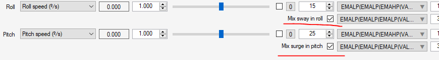

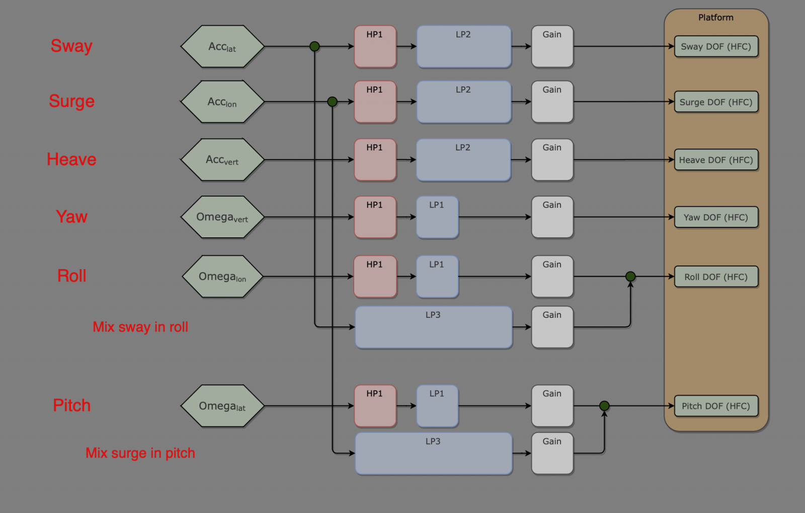

    Okay, I believe I got it now... I think :grin
    In hexpod's setup, everything uses the EMAHP (HP1 shown in image below) filter to return the In/Out values to zero, with the exception of the mixed in sway and surge into roll and pitch. This is perfect for accelerations and rate of change.
    Rhetorical Question:
    You're holding a stable climb rate and stable KIAS, so there is no acceleration or rate change. What pitches the aircraft upwards to simulate gravity vector?
    The Answer (I think): The simulated "orientation/positional (°)" values for Pitch and Roll are coming from... It's subtle but from within those Sway and Surge accelerations. That's because they include that little word... GRAVITY. Then if you mix those Sway and Surge accelerations into Pitch and Roll (without EMAHP filter), the rig will position to simulate the gravity vector using Pitch and Roll... It was an EUREKA moment for me ! ! !
    @Dirty
    Your image was perfect and really helped out a lot, thanks for sharing...

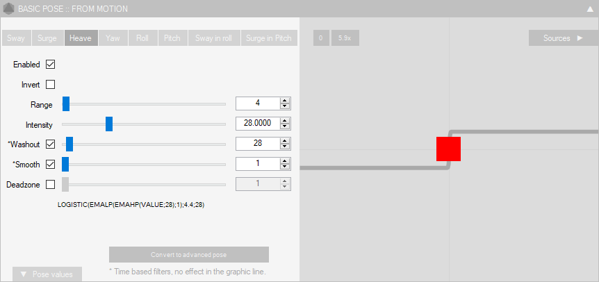

    I did this profile quick and simple.
    If I recall well, I selected this window to act ONLY for ground. That means it’s triggering off when the wheels are lifting from the ground.
    As I use pretty high gains and a relatively big amount of smoothing for heave in the main window, this small addition is here to compensate the runway roughness. It is tuned with a smallest possible smoothing value and it’s cropped to act with a minimum of amplitude so it doesn’t destroy the landing effect.
    Bravo for the Eureka ! Indeed, orientation (through gravity vector) and body accelerations once combined together, gives you a proper cueing.
    You have to make your reverence to Albert, as he made gravity and acceleration equivalent. :)
