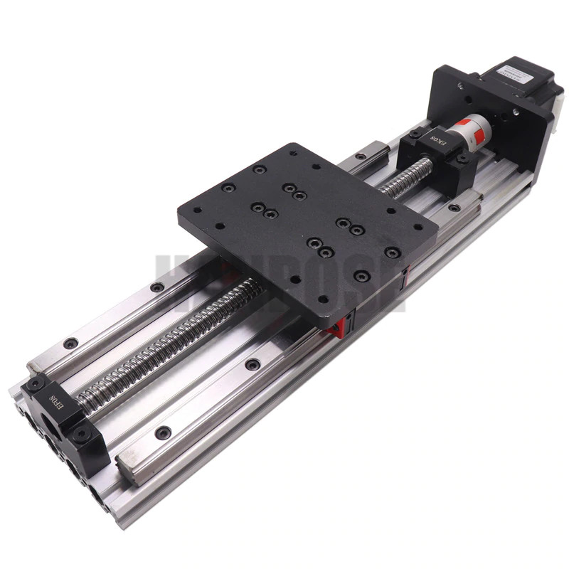

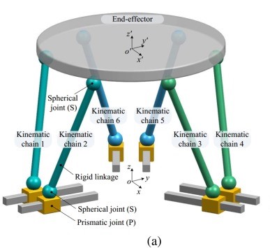

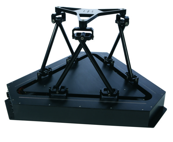

    I recently came across these alternate 6dof geometries:
    Would it be possible to support those geometries in mover? I like the fact that they use fixed length rods and linear slides that are fixed to the base and therefore don't have to move themselves and also contribute to the weight of the base. Also one could use some variant of this very common linear slide design as actuator

    Yes, I also looked at them.
    It's easy to add.
    The problem with them is that you get an extra joint like you have in rotating rigs, but they allow for a compact solution

    Are you sure? A linear actuator that is used in a "standard" stewart platform is also a prismatic joint.

    These are considered close to the rotary actuators because of the joint that has different "rod" speed depending on the angle...

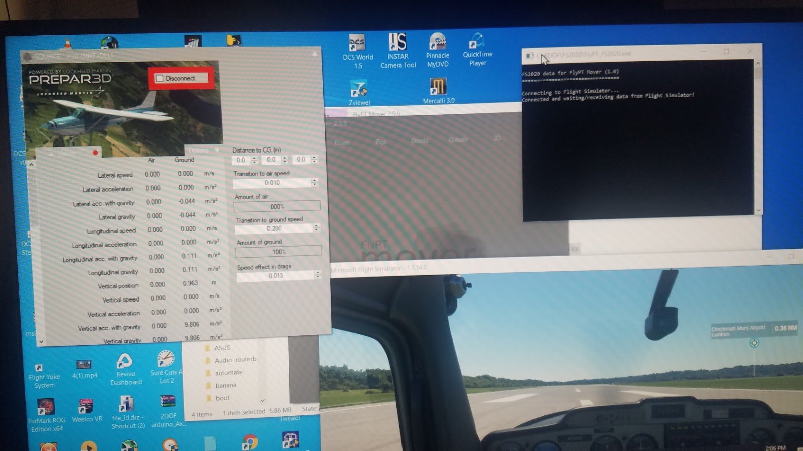

    Hi.. I am a brand new user of Mover. I am trying to get FS2020 motion. I have Mover controlling my 3dof rig but I am not getting any output from Mover when running Fs2020. I have added the P3D module. Do I need a working copy of P3D installed on the computer for this to work??

    I do not have P3D on my PC and FS2020 is working with Mover.
    Did you start your flight before starting Pmvcda's connection program?

    Like @Historiker says, follow the order:
    - Start flight
    - Start FlyPT FS2020 .exe
    - Now you can connect in Mover (with P3D)
    In the same location of the FlyPT FS2020.exe, you need to have the Simconnect.dll
    It works well, specially now that the simconnect bug was solved (fps problems), but received data has strange values.
    It's good, but for who takes it deeper, data is completely flawed in terms of physics, like getting a constant acceleration with the plane parked in the ground.

    I believe I have not set up mover correctly yet as I can see some data on the source screen but no motion output.
    sorry for the poor screen shot but the print screen would not capture all the windows.
