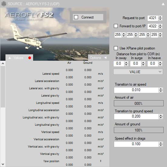

    Mover 3.3.2 ALPHA
    - We can now select the IP to output data by UDP.
    Default is 255.255.255.255, that sends it to all networks and IP's connected to the PC.
    - Think I solved the noLimits2 disconnects.
    - Added missing Aerofly FS2 dll to the download.
    To setup Aerofly FS2, just copy the "FlyPT_AeroflyFS2_UDP.dll" to the folder "...\Documents\Aerofly FS 2\external_dll\"

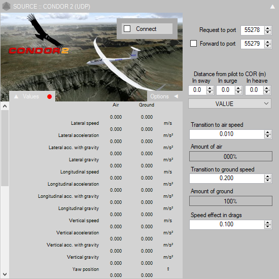

    - To use Condor 2, you need to edit the setup file.
    Go to the folder: "...\Condor2\Settings\"
    And edit the file "UDP.ini" to match the following:
    [General]
    Enabled=1
    [Connection]
    Host=127.0.0.1
    Port=55278
    [Misc]
    SendIntervalMs=1
    ExtendedData=1
    ExtendedData1=1
    LogToFile=1

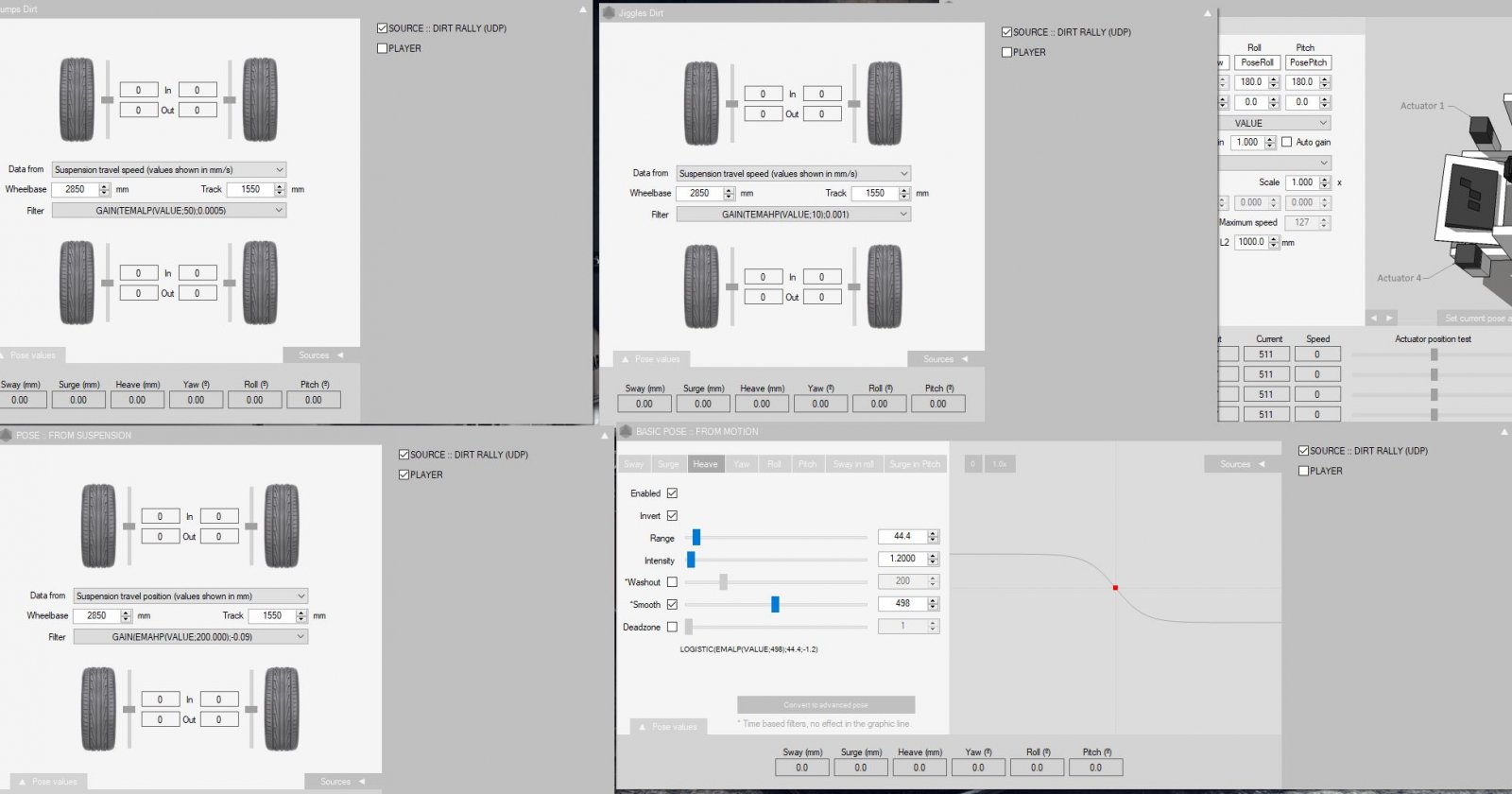

    So a question, i think have a pretty good motion profile for Dirt Rally 1, based on a sfx-100 platform. The one thing that kind of bugs me is that the motion feels a bit "Stepped" or choppy when going over jumps (full extension and compression). I'm sure it's to do with the filters that I'm using (I grabbed parts of profiles and combined them into mine). How would I be able to eliminate this choppy/sticky motion. Here are the different poses that I'm using along with filters. Also attaching my profile. Can someone help me tweak it?

    Changed my heave filter to EMALP(EMAHP(VALUE;220);150.000), also closed down most of the pose windows and it's much better. Do the windows being open have an effect on the motion?

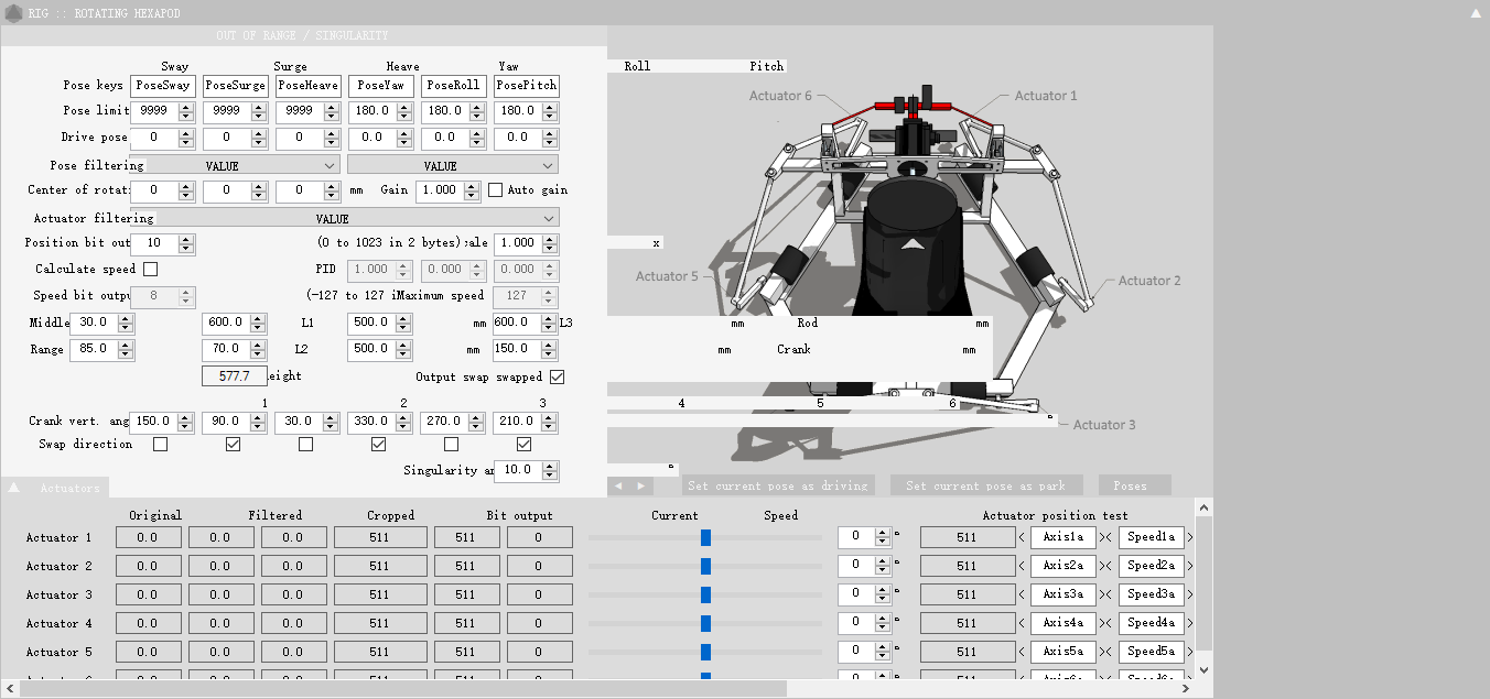

    I noticed you added IP address to OUTPUT::UDP, but not (yet) added a Bit input field (that you now renamed in the RIG modules as "Position bit output):
    BTW, in 3.3.2 I also noticed this funny behaviour that when I change the value the name changes back to how it was before:
    (both screenshots from the very same RIG::ROTATING HEXAPOD module window)

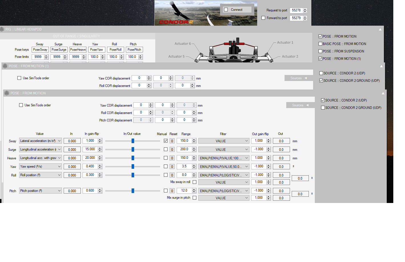

    Hello ,
    For the moment with Condor2 AIR (UDP) ( version 3.3.2 ) seem goes well with Port=55278 and with Yaw speed ( Thanks Pedro) ! :thumbs
    Now I try to set up * Ground* ( I'm not sure if it's like that *set up* :think ) but , when I put a new Pose from motion for Condor 2 Ground ( UDP) , my Rig Bug . I need a new Port= ????? to switch motion on the ground ? If Yes , is it ;55279 ?
    - IF I want suspension on the ground, the source ( surface ) stay at 6.00 and don't move .
    Pic with my set up !!
    Thanks !!!

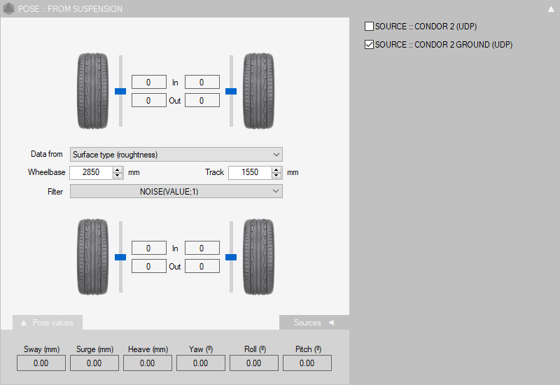

    Wow what a mess... Sorry
    You open the condor source one time.
    That source shows 2x in the pose, one for ground and one for air
    Now you can define a pose for air and one for ground.
    I don't think it's worth for Condor2.
    To get the ground contact vibration, use a suspension module. Attach to it the ground pose.
    You get the surface type. Now add a NOISE filter:
    Now, you get vibration with an amplitude that depends on the ground value and speed (speed=0 no vibration)
    Play a bit with the filter. I did not make tests in Condor.
    Don't forget to add the suspension pose to the rig
    Some considerations:
    -Select surface type!
    -The noise depends on the surface type value. If 10, it generated movements with an amplitude of 10.
    -Some games don't have the values ordered. We can get 10 for clean asphalt and 2 for grass.
    So I had to reorder them in the sources. If you find strange results, please report, I might have to reorder it. Some games can have up to 20 ground types
