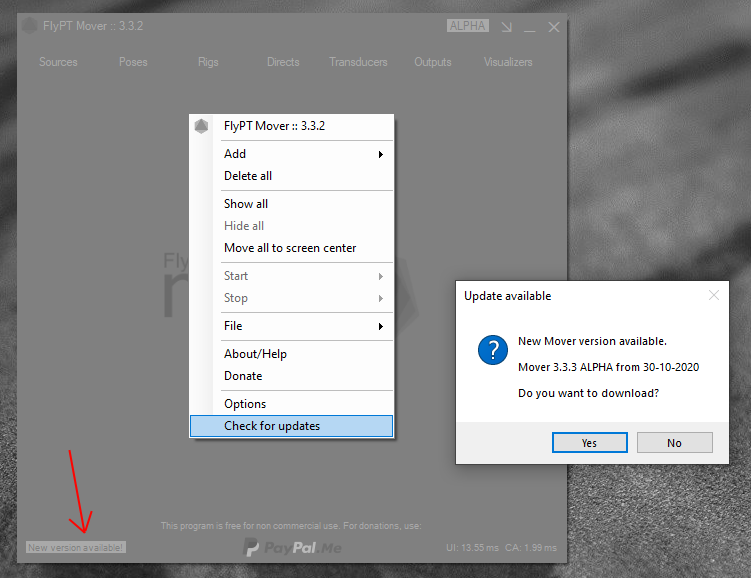

    - Mover now detects if there's a new version available
    You can go to the menu and look for an update or if connected to the internet you get a warning:

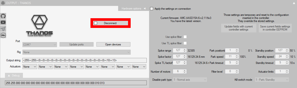

    -Updated Thanos output module:
    We can now work with the hardware settings.
    The module tests the firmware and checks for a new one.

    +2,733 / 18 / -0
    You have to update the firmware to get that info

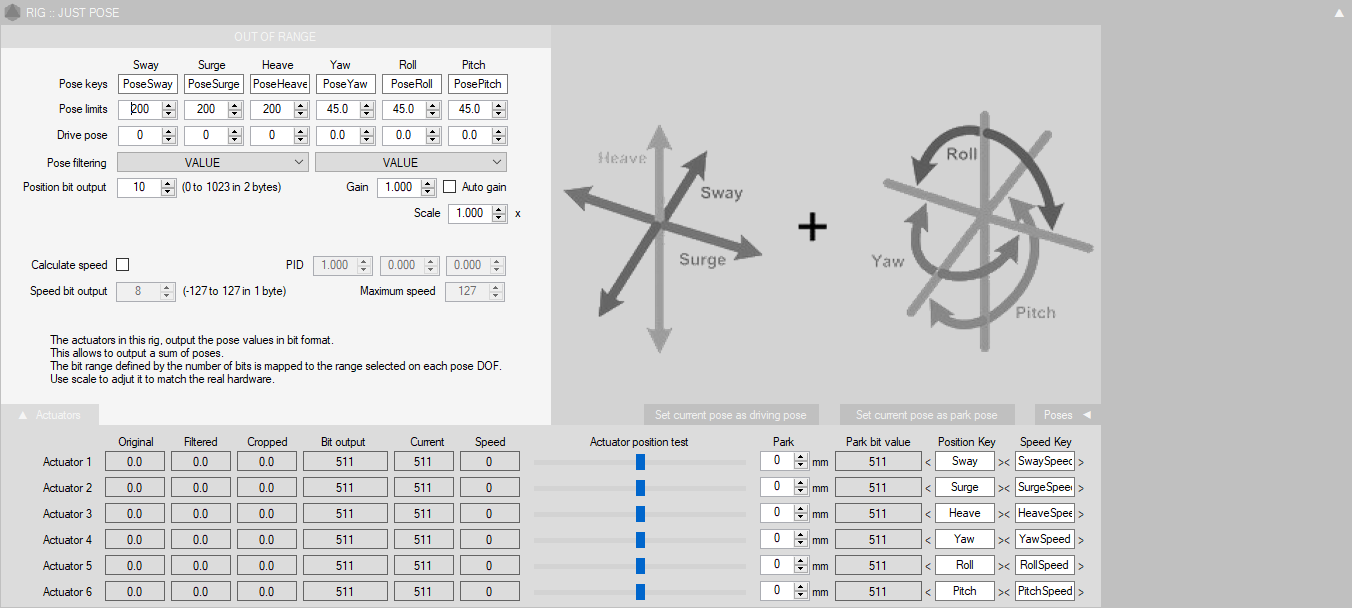

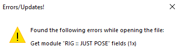

    1001 THANKS for adding the RIG::JUST POSE module to 3.3.3. It's just what I had imagined! I feel like I am now VERY close to make my rig completely work with Mover. I have one, hopefully last :rolleyes:, problem.
    With all the settings required to make my rig understand the output stream, all 6 axis work exactly as expected, BUT ONLY with negative "original" values. So all movements in the rig are limited from middle (resting pose) to only ONE side.
    I really hope this is a dummy question with an easy answer and no need for your programming action. I attach my settings. When you move sliders the values in the output stream change from (close to) Zero to 127 and then rest there (while "original" values become positive). I say "close to Zero" because I had to reduce scale value a little bit to 0.95.
    I do not think there is a connection to the error msg that I get when opening my settings? mover 3.3.3 opening error.png
    Thanks for looking into this!

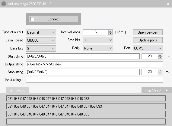

    My program for control 6 stepper motors with Arduino Mega 2560. For free use. But if You want https://www.paypal.me/VirtualFly. Answer any question. Comatible with FlyPT! You can connect one controller to six motors, or 6 controllers to six separately

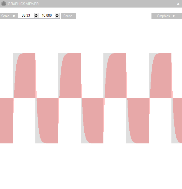

    What I don't like is how hard the platform drives into its positions. I would like the platform to slow down before it reaches a commanded position. I can use filters to accelerate smoothly, to slow down before the limits of travel, but I haven't found out how to slow it down when approaching the commanded position.
    I guess I would need some kind of moving average that is pretty closely synced to the speed of the motors. It needs to react quickly, slope according to motor speed and then flatten towards the needed pose. What field would I use to enter the filter? "pose filtering"? "actuator filtering"? And what filter or combination of filters would I use to accomplish this?
  15. pmvcda
    pmvcda aka FlyPT
    Nov 3, 2010
    2,280
    Portugal
    15,950Coins
    +2,733 / 18 / -0
    Try using the EMALP(VALUE;200) in the actuators filter of the rig. That's an exponential moving average.
    Here's the result in a sudden value change:
    You can see it "curving" before reaching destination, But this softens the signal and you start loosing detail.
    Maybe it needs a better PID setup on the rig controller. But if you have a DOF reality, you can't do anything at that level (I think). So try the actuators filters.

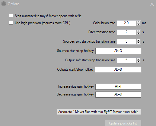

    A workaround, could be to use a joystick button or keyboard key to start / stop the sources.
    You can set it in the options:
    By default it's alt+o (I swapped the letters lol)
    Click on the field, to make it yellow, and then press the button you want to use.
    Can do the same but for the rig, but with the Thanos one, better use the source because of the parking feature in Thanos controller.
