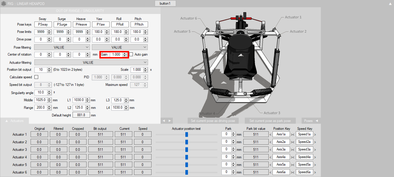

    my goal is to have a potentiometer on rig or wheel, that would allow to to quickly set gain between 0 to 100%.
    it's not necessary, as I can use buttons... just a capricious wish ;)

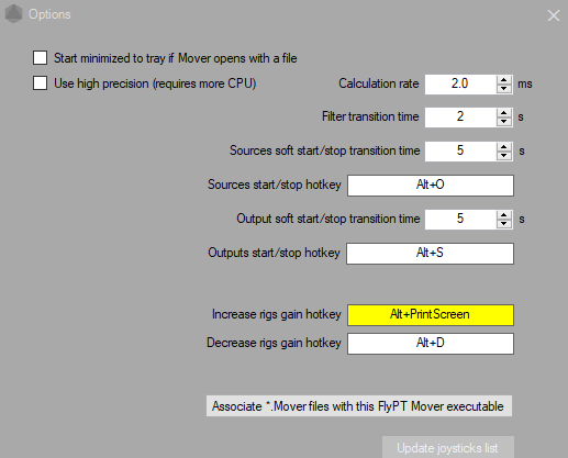

    Just assign a rotary joystick button in options.
    Rotate to right in increase and left in decrease.
    If you are using a wheel, they have those buttons, at least the latest ones.
    Edit:
    Click in the field (turns yellow) to increase and rotate the button.
    Next click on the decrease and rotate left
    The same fields accepts keyboard keys or joystick buttons

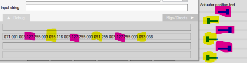

    I think my controller (rig's firmware) does handle that correctly ─ it works well with SimTools. The problem is, the values never exceed 127. To illustrate:
    But if that is a current limitation with Speed keys, I just wait. Or, with your information on the use of keys, I may try Position key.

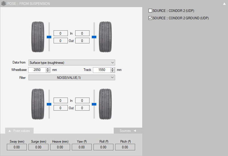

    Suspension with noise filter = Succes !!! Bravo .. I use that with Condor2 and Project Car2 .
    Thanks !!!:thumbs

    In the Mover menu, go to the options.
    In the lowest position you have a button that assigns the files with *.Mover extension to Mover.
    Press it.
    Now you just need to double click the setup files to open them.
    I recommend you to do one file for each setup and open them that way.
    You can also merge files and choose just some of the modules. That's a good way to get the rig data again without the need to fill everything again.
