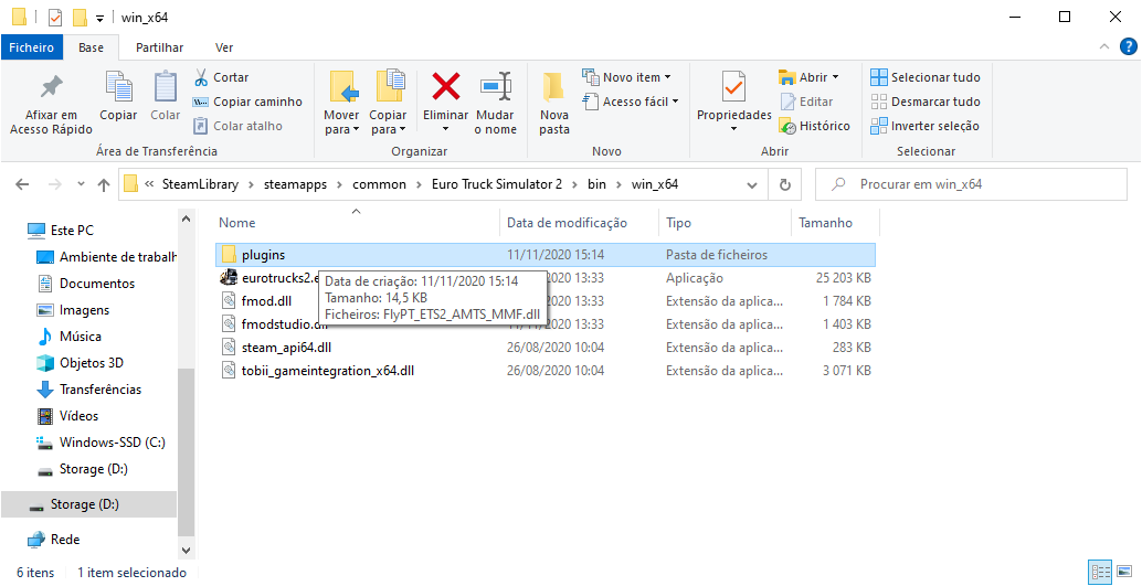

    You need to copy the dll included in the download, inside the sources files folders.
    The go to this game folder:
    Create the folder plugins if the folder does not exist
    And copy the file FlyPT_ETS2_AMTS_MMF.dll inside that plugins folder. Remember, this works only on 64 bits version of ETS2 (who uses the 32bit on those days...)
    Don't know how I missed this source in the manual...

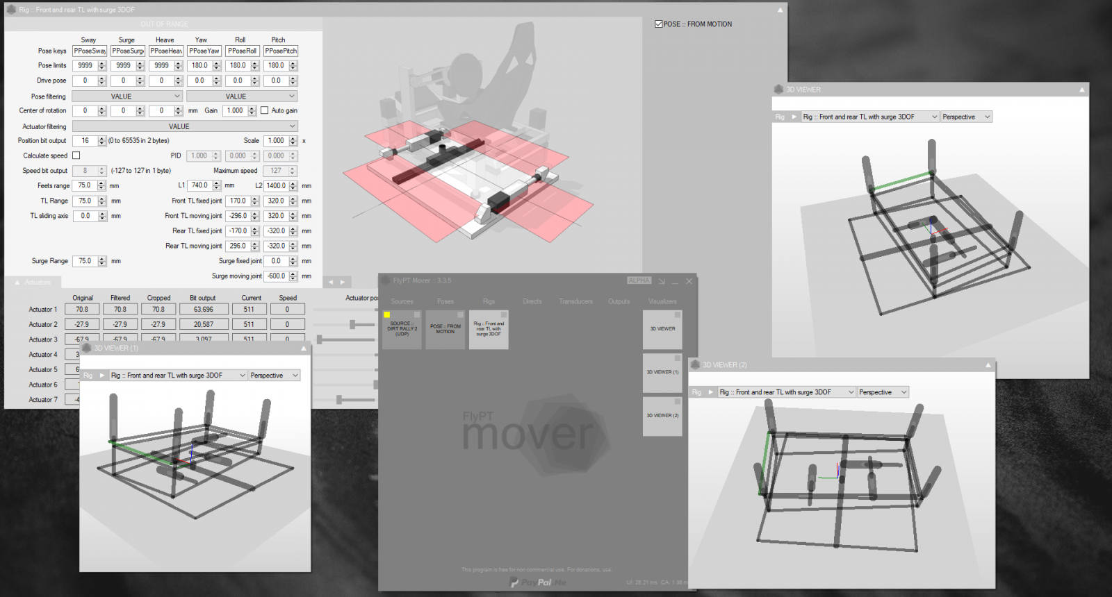

    FlyPT Mover 3.3.5 ALPHA
    Go to first post to download it or use the menu in previous version.
    -Hopefully, corrected some bugs on the Thanos output.
    -Added some images and updated the 2 x traction loss rig (sfx100 type).
    It's a 6DOF rig.
    Still WIP, but calculations seem correct now:
    Attention, all movement was thought for motion cueing.
    So if you have some yaw, introducing sway generates some surge to compensate and create real sway.
    In my opinion, 7 actuators to get limited motion on a 6dof, doesn't seem the ideal. But it has the advantage of space... Maybe.
    Corrected some other bugs.
