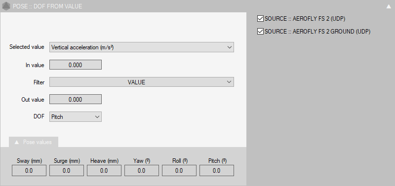

    @Avee I figured out what you mean, using a Pose: DoF From Value with longitudinal acceleration set to the Pitch DoF (filtered) does indeed work. Huge thanks for the tip.
    However, that is a work around. In rig settings for a two actuator setup we should be able to set these there. Perhaps it should be a rig "5DoF with 2 actuators" :) It would be far easier to adjust motion from the pose from motion window rather than having four separate windows to deal with.
    Again, thanks for the tip.

    @Historiker , no problem at all.
    Can you show me the SimTools mixing you are using on the rig?
    I never had a 2DOF rig, and the idea I have for the "conventional" 2DOF rig, is that you have only two 2DOF, in this case just roll and pitch.
    Other dof's are locked in the rig, because they don't exist in the rig, and that could cause problems on motion compensation, 3D previews....
    Now, in the pose from motion, you are able to use roll , pitch, surge and sway, with the mixing.
    That is the correct way to do it in Mover.
    Your problem is with heave.
    That's a "fake" cue, and can't be added in the motion cueing alghorithm.
    So like @Avee says, you need to add a pose: "DOF from value"
    Then add it to the rig module
    There's no other way to do it and to keep the use of VR compensation.
    Using directs, works just like SimTools, and you loose the pose info.
    I know, to much windows. Maybe I could replace that module with one where you can add multiple effects.
    I think I will do it.

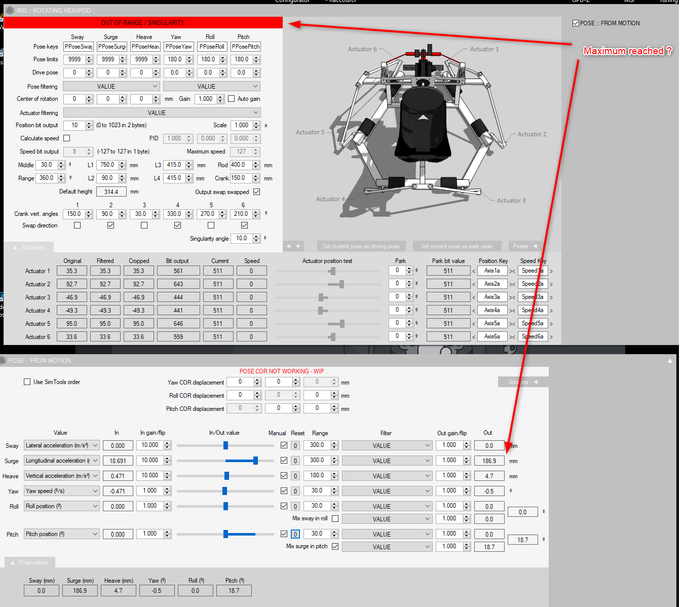

    I discovered FlyPT this weekend and it's a great tool.
    Also I wanted to know if there was a way to know the maximum value of the angles or displacement reached before being out of limit reached we manually move the cursors?
    see picture:

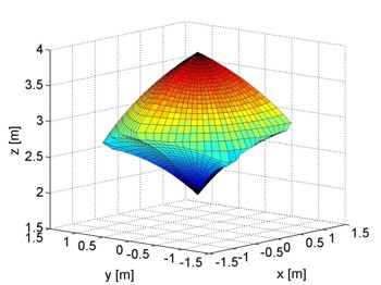

    It depends on the combination of angles.
    If you have 10º in pitch, the limits for all the other dof's change.
    This is specially the case of hexapods.
    What you can see, is witch actuator got out of range in the 3D view.
    EDIT:
    Here's a figure showing the limits of a hexapod.
    Just translations...
  13. coyote
    coyote Member
    Nov 20, 2014
    58
    France - Yonne
    679Coins
    +72 / 1 / -0
    You're Right, It depend on the combination of angles.
    So if i don't change the others , i would have liked to know the max position reached.
    To do this, I move the cursor and look again when the limit is reached to then note the value.

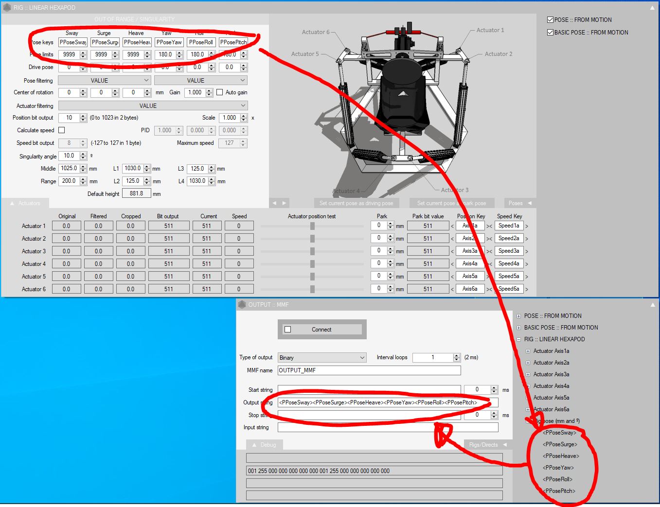

    Hi fanch64
    Can you please explane a bit more about "naming convention" of the Virtual Tracker?
    Maybe with a screenshot?
    I´ve testet it with "<PoseSway><PoseSurge><PoseHeave><PoseYaw><PoseRoll><PosePitch>" and it looks ok for me.
    Thanks in advance
    Peer
  15. fanch64
    fanch64 New Member
    Sep 26, 2011
    10
    mechatronics
    Macaye, france
    36Coins
    +9 / 0 / -0
    if it ain't broke, don't fix it!
    ok, with versions prior 3.3.4 Pose keys for rig were named PoseSway...
    now, default name is PPoseSway...
    if you imported a .Mover file created with an old version, naming is still the old way.
    watever you name them, they have to be unique, and consistent between rig and output.
    see on screenshot:

    Hi @fanch64
    Thanks a lot for clearing. Yes, I used a old config.
    Maybe I should make a new config with the new version of Mover.
    kind regards
