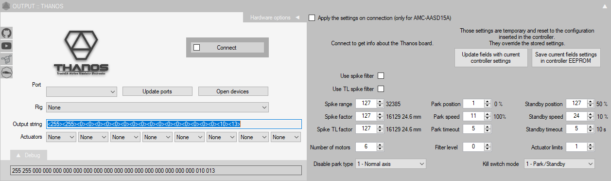

    Hi FlyPT
    I noticed a "special feature" of the mover. (Version 3.3.5)
    No matter what I set in the mover under "range", it seems to take the values from the AMC-AASD15A.
    If I set 100mm in AMC and 200mm in mover range the rig moves only 100mm
    If I set 300mm in AMC and 100mm in mover range it will be 300mm and the centre position is 150mm
    Is that right or do I get something wrong?
    EDIT: i know that range is in both directions of the middel position
    So stroke schould be 1/2 range.
    Which values are used in mover from the AMC-AASD15A?
    Can you please clearify this for me?
    Another point I noticed with the "disconnect".
    After pressing disconnect the rig will move down to the parking position as expected.
    But then it goes to the stndyby position which is set in the AMC, and immediately back to the park position of the AMC.
    So the rig goes down - up - down.
    Is that normal?

    With the Thanos AMC AASD, don't use the park feature of Mover.
    The Thanos board goes to park when she stops receiving data after some time. But goes to park from the neutral position.
    Mover to park the rig needs to send positions to the rig, to perform that movement.
    So what is happening, is that Mover parks the rig, then it disconnects the communication with the board. Since the board is no longer receiving data she starts the park procedure. But, she moves to the neutral position before parking.
    So to solve it, or Thanos makes a parking procedure starting from where the actuators are or you disable the park in Mover by setting the park position to zeros and let the board do the parking.
    The feature...

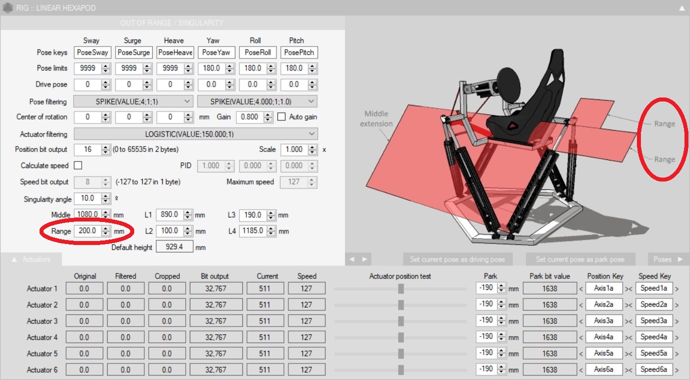

    Hi
    No, I mean the range at rig-menu
    Should´t it be nearly the half of the stroke length in the AMC AASD15A?
    In my case, changing the range has no effect on the movement behaviour of the rig
    Or is it only used to calculate the possible movement?
    What kind of influence has a change in the range value?
    Sorry for my stu*** questions...

    I'm writing some actuator info on the manual. Let me get some of the stuff.
    When we specify a bit range, usually we have the bit range mapped to the travel of the actuator.
    So if we have a controller receiving up to 16 bits, it usually means that at bit 0, we are at travel 0 and at the maximum value of 16 bits we are at full actuator travel.
    Well, this is the most usual, but might not be always like this. But that's up to scale to adjust it...
    Ok, now imagine your actuator travel is 500mm, then you have 0mm for bit 0 and 500mm for maximum value in 16 bits.
    Like you say, range is half the travel, so we have range of 250mm.
    But the important here is that the maximum value for 16 bits is 65536, this means you have 65536/500 steps of resolution for each mm.
    The actuators controllers want the steps, not the mm for speed reasons. But we want the mm for understanding.
    So when you set the range you are defining the multiplier needed to convert mm to steps.
    You also have scale, because some actuators might have the maximum travel at bit value 60000 instead of 65536, and then we need to adjust the multiplier with scale to match the real movement with the values in Mover.
    This is important for motion compensation, because we need those mm to make the motion compensation.
    Hope I could explain it.

    Thanks for your explanation
    Do I see it right, that the value "range" is only used for motion compensation and calculation of the graphic?
    So the AMC always gets the right bit value and calculates the length of the movement based on the stroke length?
    This would explain why the rig becomes much jerkier and faster with a larger stroke.
    It has to travel more distance in the same time.
    Hopefully I got it ;)
  7. pmvcda
    pmvcda aka FlyPT
    Nov 3, 2010
    2,280
    Portugal
    15,950Coins
    +2,733 / 18 / -0
    It's used in all the calculations.
    We use the filters to get a pose. She's defined in mm and º.
    We then calculate the actuators positions in mm if linear or º if rotating to achieve that pose.
    Before sending the data to the controller, the mm and º are converted to a bit value.
    That last transform is where we aplly the scale to adjust dimensions important for motion compensation, because we need to match the values of the pose in Mover to the real pose achieved by the rig.
    What the AMC receives is the bit position or "step" where we want the actuator, and then the AMC moves it to reach that location.

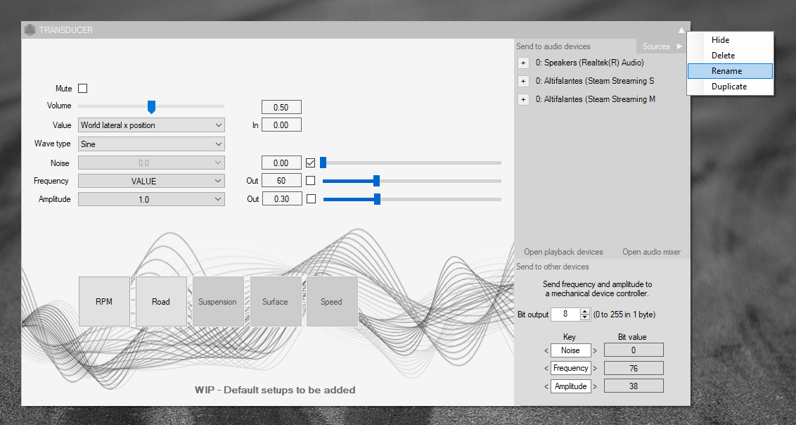

    I haven't forgotten about that yet, but I didn't finish fine tuning the transducers yet. When I get it done, I'll post my config for X-Plane 11, which will also have some useful settings for Dofreality H2 and P2 rigs.
    One thing that I would like to suggest: I like the "master volume" setting for the transducers, but I think it is in the wrong place. How about adding a gain setting in stead of just a checkbox to all sources in the right pane in the rig and transducer nodes? That way, it is no longer necessary to think of putting a gain filter in all pose formulas just for easy adjustment, and one can fine tune the cumulative effect gains all in one spot. That would make it more comfortable to quickly adjust a configuration to a different vehicle or game.
    And one thing I can't find that seems to be missing is the possibility to rename each node with a meaningful name, so it is easy to see which box does what.

    Like the idea for the gain.
    You can rename the modules. Here:

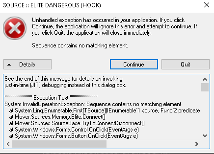

    i trying to use 3.3.5 Alpha with Elite Dangerous. also on 3.3.4 but getting an error as soon as i start the source
    this is wat i get:

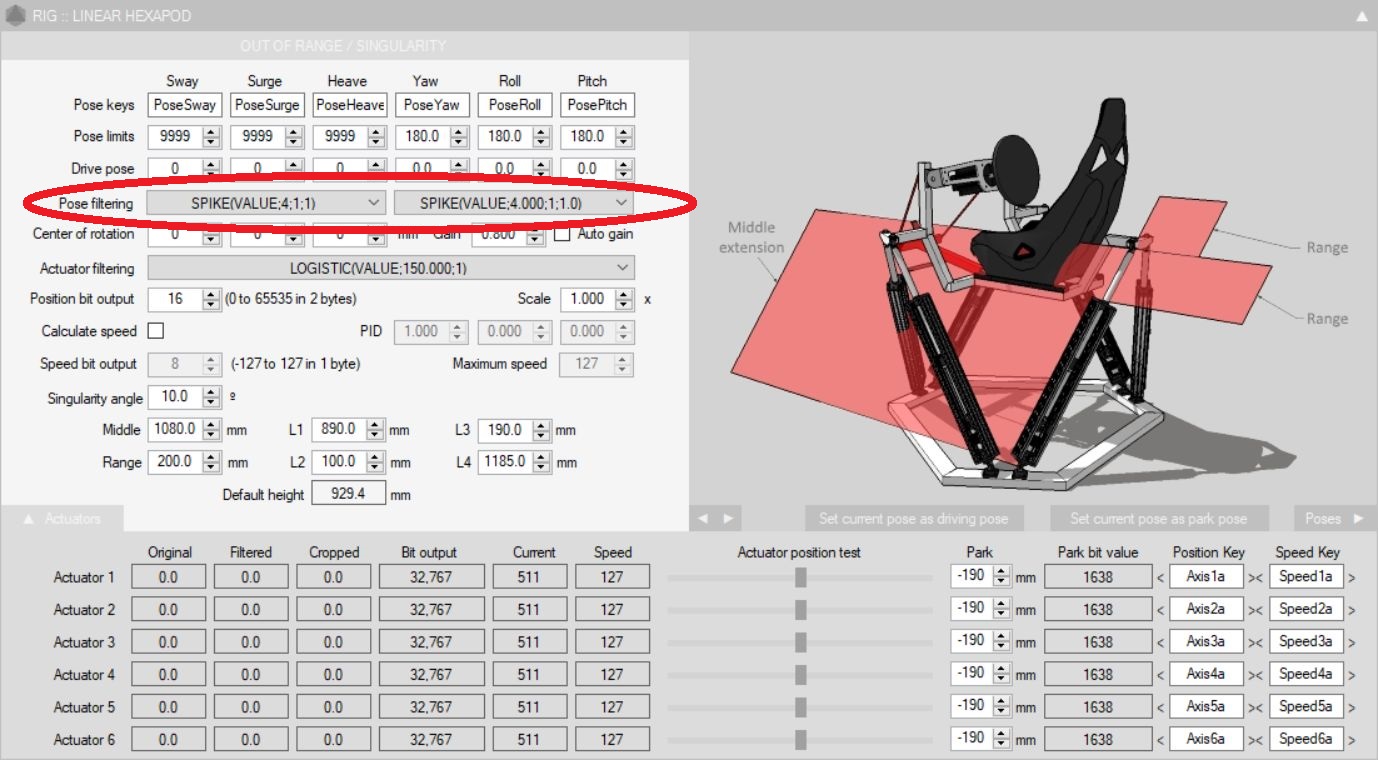

    Hi
    I use both spike filters.
    As you can see in the rig settings i use also spike in "Pose filtering"
    Hopefully the settings are OK ;)
    Could it be to much filtering? I will try to use only on of the spike filters.
    Maybe that would help.

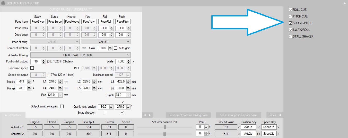

    Hey Pedro. Still finding FLYPT to have the most detailed movement. Compared to Simtools and SRS(seems muted). Thank you for the awesome software!!
    One question which I can't figure out as much as I play with all the filters. What filter would I apply to get rid of a "grainy" movement on say the Surge movement on a sfx100 rig? When the front or back dip down. The movement range I figured out, but the actual movement feels rough kind of like very little quick steps. same with Sway. Not very smooth. I'm guessing I'm not using the correct filters. A simple EMALP is to rough (or too slow with a lot of filtering). Hoping you have a suggestion.

    Try just with the Thanos spike filter. Might be enough, but it doesn't work the same way the spike filter in Mover.
    What you have there, is like not having filter, it's too light.

    That source might need an update already. I think the game has been updated in the mean time.
    But that error... I need to check the code.
    Thanks for the report.

    You are not the first one complaining about this. Maybe you could try with the MALP instead of EMALP.
    What game? AC/ACC?
  20. pmvcda
    pmvcda aka FlyPT
    Nov 3, 2010
    2,280
    Portugal
    15,950Coins
    +2,733 / 18 / -0
    Ok, I see.
    It's not easy in the current software. For the new 4.0, it's easy to do it.
    But 4.0 is going to take time. Really in early state.
    I will try to look at it better after the next release and see if I can fit it in without big changes.
    You know, currently, you touch something, it affects everywhere. So any changes need to be made carefully.
    That's why there are so many bugs right now.
