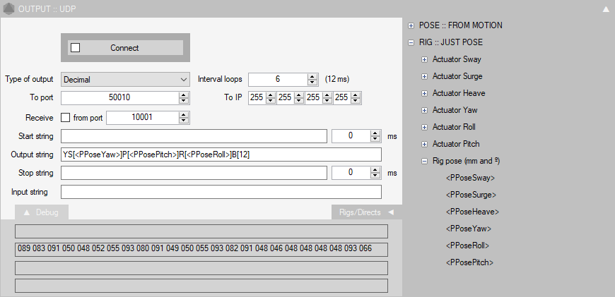

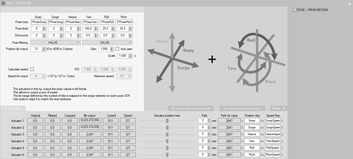

    Do the following:
    Add a just pose rig. This generates just the rotations, so I changed the limits of the pose to 0 in the linear dof's, and 25º for pitch/roll, 180º for yaw.
    Don't forget to put position bit to 12!
    Add a serial output with the following settings (got from the YawVR manual here):
    Attention to the decimal and the 6 to make updates @12ms.
    And change the IP to the IP of the YawVR.
    I'm still working on it, so the keys I show, might change name in the future.
    Should now work. Use a pose, that you need to choose in the rig (right column).
    Waiting for some feedback ;)
    EDIT!!!!
    This is wrong, the serial string should be: YS[<Yaw>]P[<Pitch>]R[<Roll>]B[12]

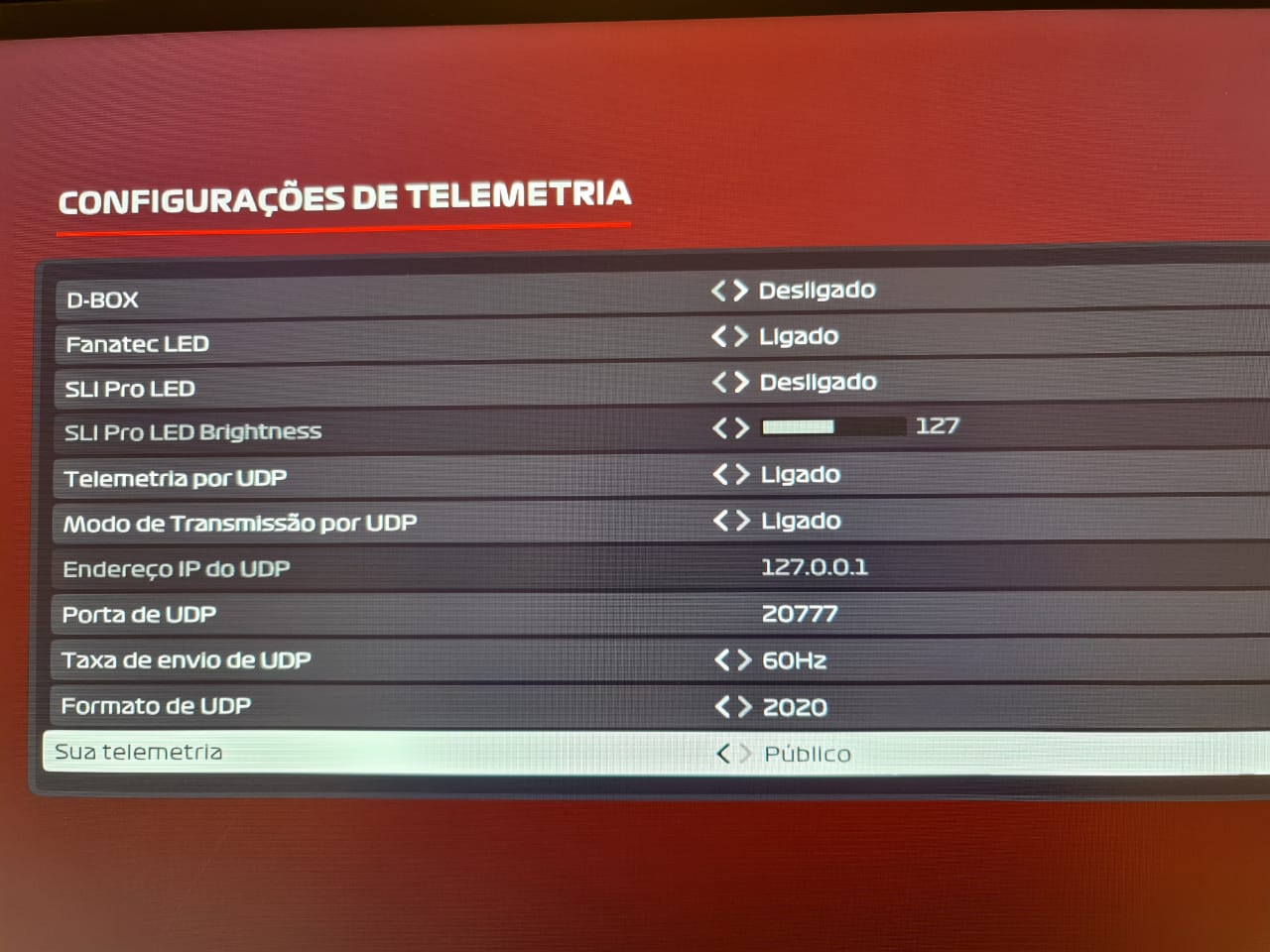

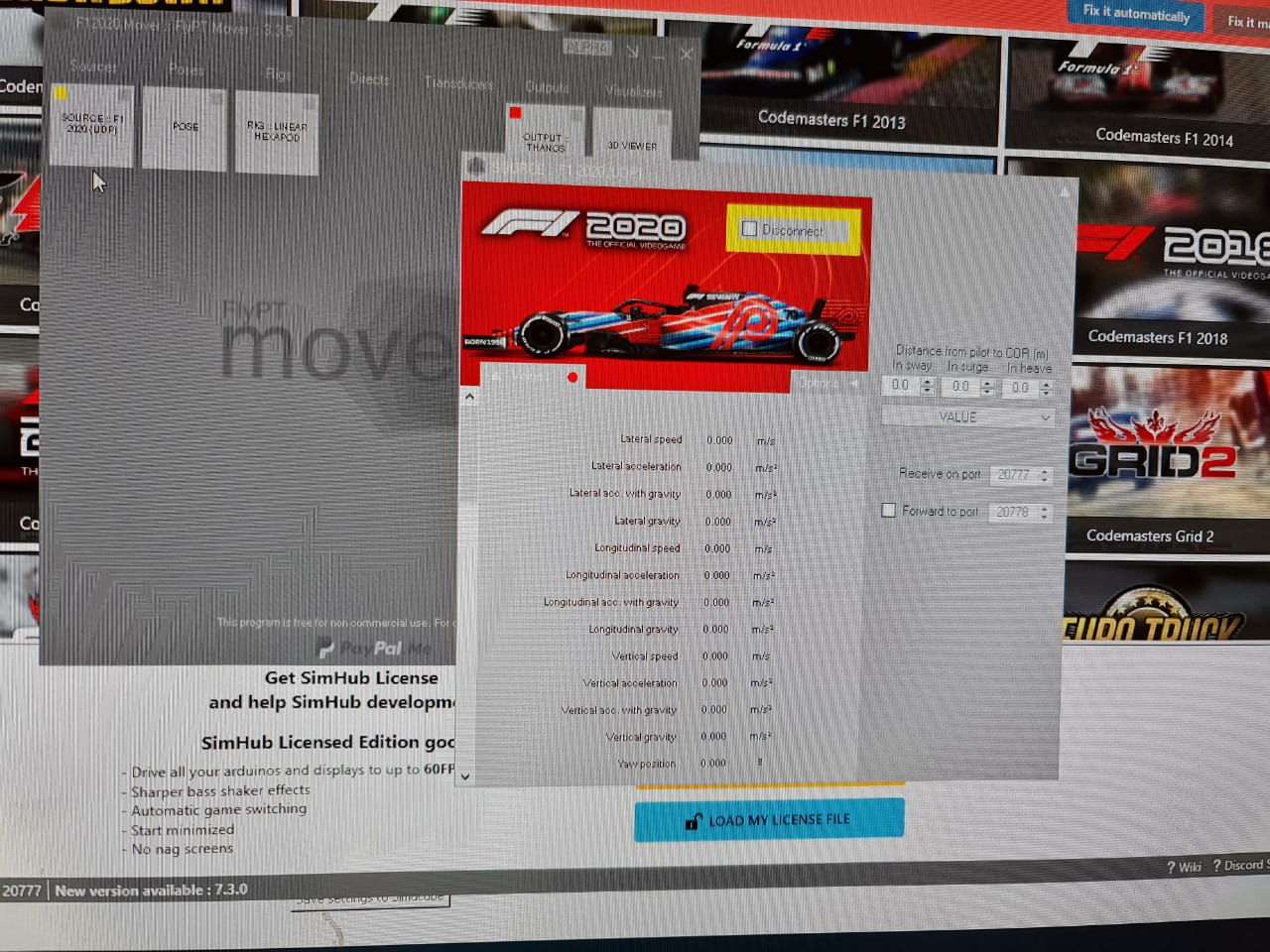

    Hello friends, I followed the instructions in the Manual, however the F12020 is not sending data or the platform is not receiving it. Did anyone go through something like that?

  18. mm982566
    mm982566 New Member
    Sep 22, 2017
    29
    US
    56Coins
    +10 / 0 / -0
    3DOF, 4DOF, 6DOF
    Hello, I see that you are using SIMHUB at the same time, UDP port cannot send data to two programs at the same time, so you can try to change the receive port of FLY to 20778, the forward port to 20777, and tick the box in front to change the port in F12020 to 20778, and the port in SIMHUB to 20777. Good luck to you.
