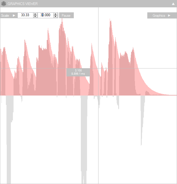

    So this is the result of considering only growing values with a basic washout (multiplier with .995):
    Not solving the issue... It's not so simple to make it.
    That's what I have right now.
    Acceleration, followed by releasing the pedal in DirtRally2 with acceleration
    If we put a slower washout, then that deceleration is completely ignored...

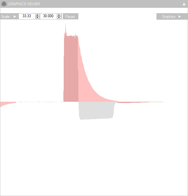

    Here with bigger washout:
    Here with some brakes and accelerations. Seems like a spike filter....
    Maybe we should try with a spike filter.

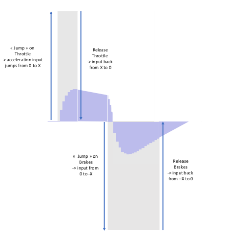

    Anyway, I believe the chart below that I provided earlier could be useful to help.
    Btw - sorry, another request - you could maybe add in the wave types in the source loop the wave that would be a square with pauses between positive and negative alternances, i.e. 0 for 250ms, X for 250ms, 0 for 250ms, -X for 250ms and so on.

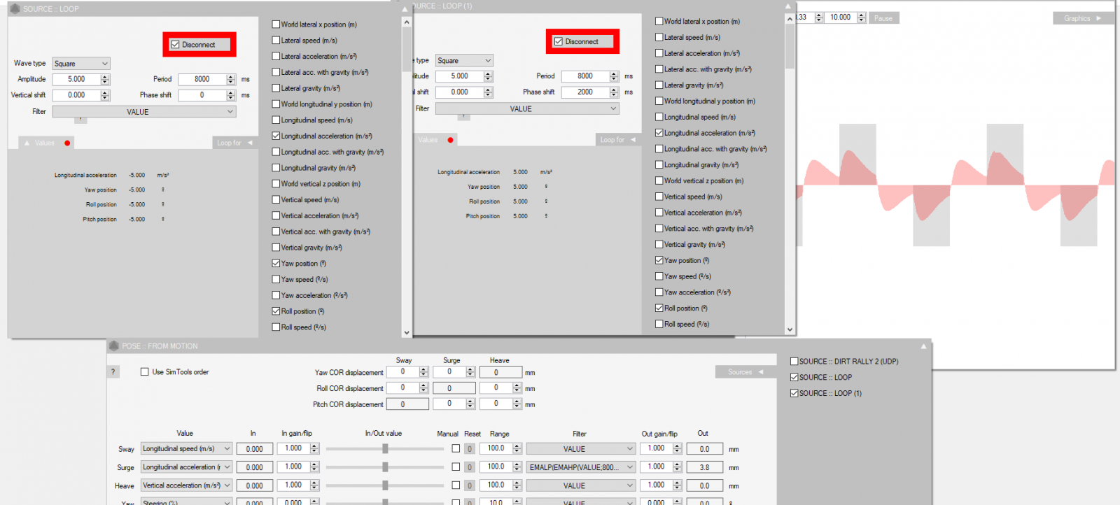

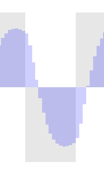

    You can achieve that wave with the superimposition of two:
    Add them in the pose
