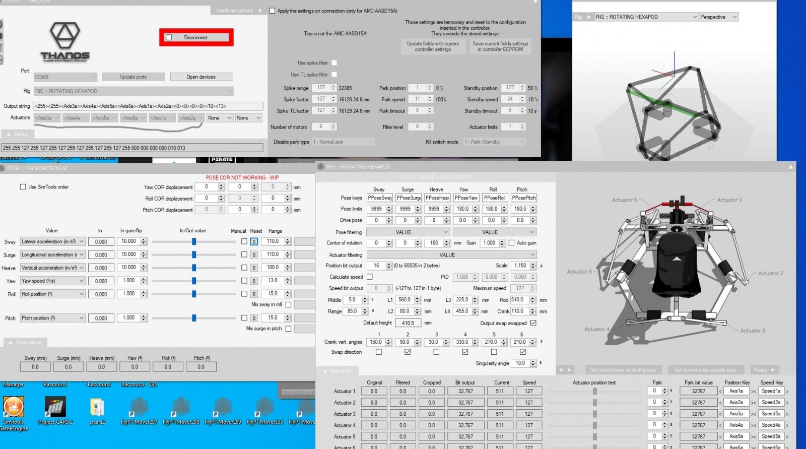

    As I said when I uncheck the mixing effects roll and pitch it’s like the box are always checked . The movements surge and sway are always mixed with pitch and roll whenever the mixing checkbox is choose or not .
    But anyway il will give a try as you ask for .
    For the Thanos amc setup could you give me back the axis order please ?

    You have two extra poses from value in the AC source.
    One for yaw and another for roll. They use speed values.
    And you mix them in the rig.
    Might be that causing the roll. But you have no pitch.
    What order are you using? Because I get people asking to change it many times.
    Mover uses actuator 1 has the first one at front and right, and increases in clock order.
    I will not change that. I use that logic for all rigs.
    Thanos uses first actuator has the one at rear left, and increases in clock order.
    It's a mess. You should connect the actuators to the controller, like Thanos says, and use the default order given by Mover (swaps actuators to match the Thanos order).
    I made some changes to accommodate the sfx100 based rigs that have 6dof. That might have caused a change in the Thanos output.
    Just tell me what is the order you used (I'm already confused with all this mess :confused:).
    This can be the cause to have a swap between roll/pitch or other mixes in DOF's.

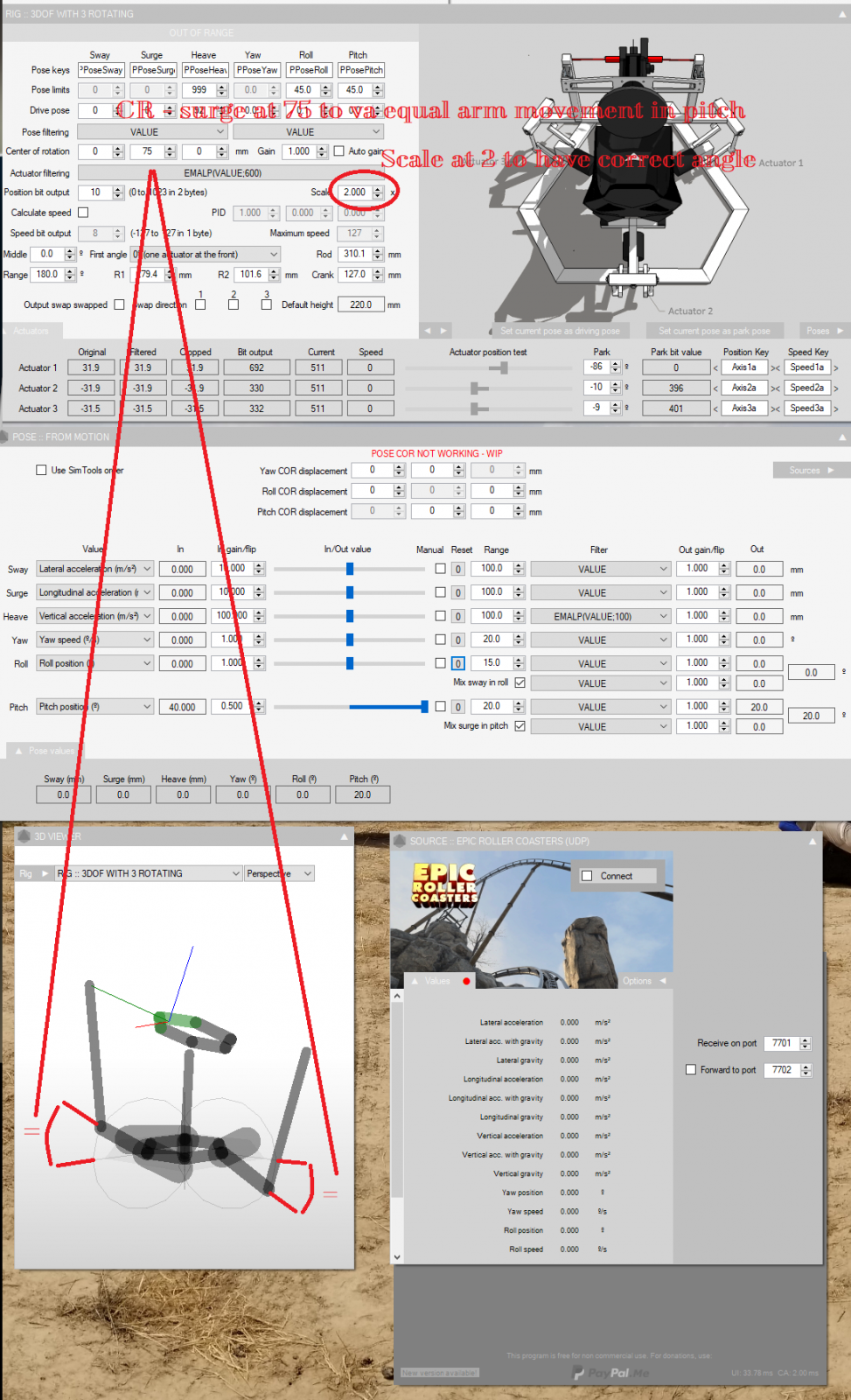

    I am new to your software, it works great well done,
    I use it with a 3DOF https://www.xsimulator.net/community/threads/marki-3dof-with-winch-sabertooth-2x60.15747/
    I noted some modifications to be made, but I understand that it may vary with the specification of the rig.
    it's up to you to see if you need to make some changes.
    for me I compensated with the scale and it is also correct
    In video=
    I tested the new version with epic roller coaster, I noticed that the heave is more easily playable with the gain compared to the previous version.
    thank you and keep up the good work

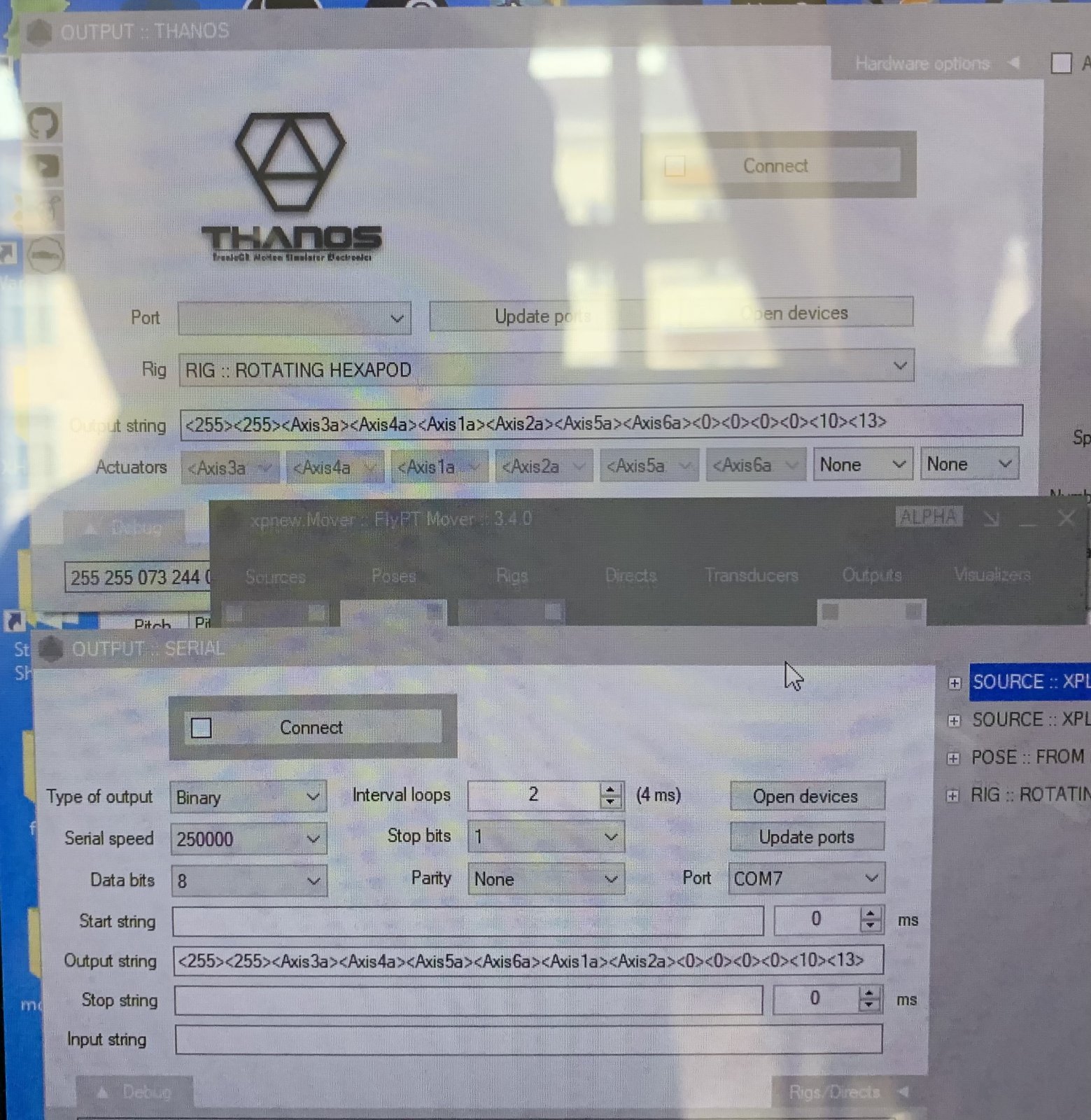

    ok tested and got it !
    With the release 3.4.0 the amc output string which is the same as the 3.3.5 . the actuators order in the string is the same (pics attached) . The problem was that with the 3.4.0 release the actuators order was not coresponding according the output string (4 actuators were being swapped 1 ,4,5 ,6 ) . As i can modify tthe order in the 3.4.0 release i put the right actuators order according the output string and voila c'était tout bon ahaha
    thanks fort your job and patience !
    for the pics below both are working because fort both output string and actuators order are the same

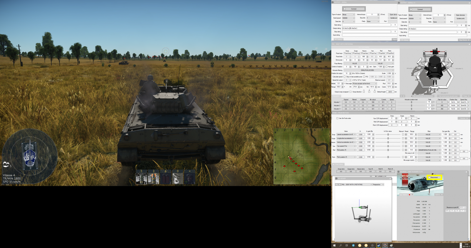

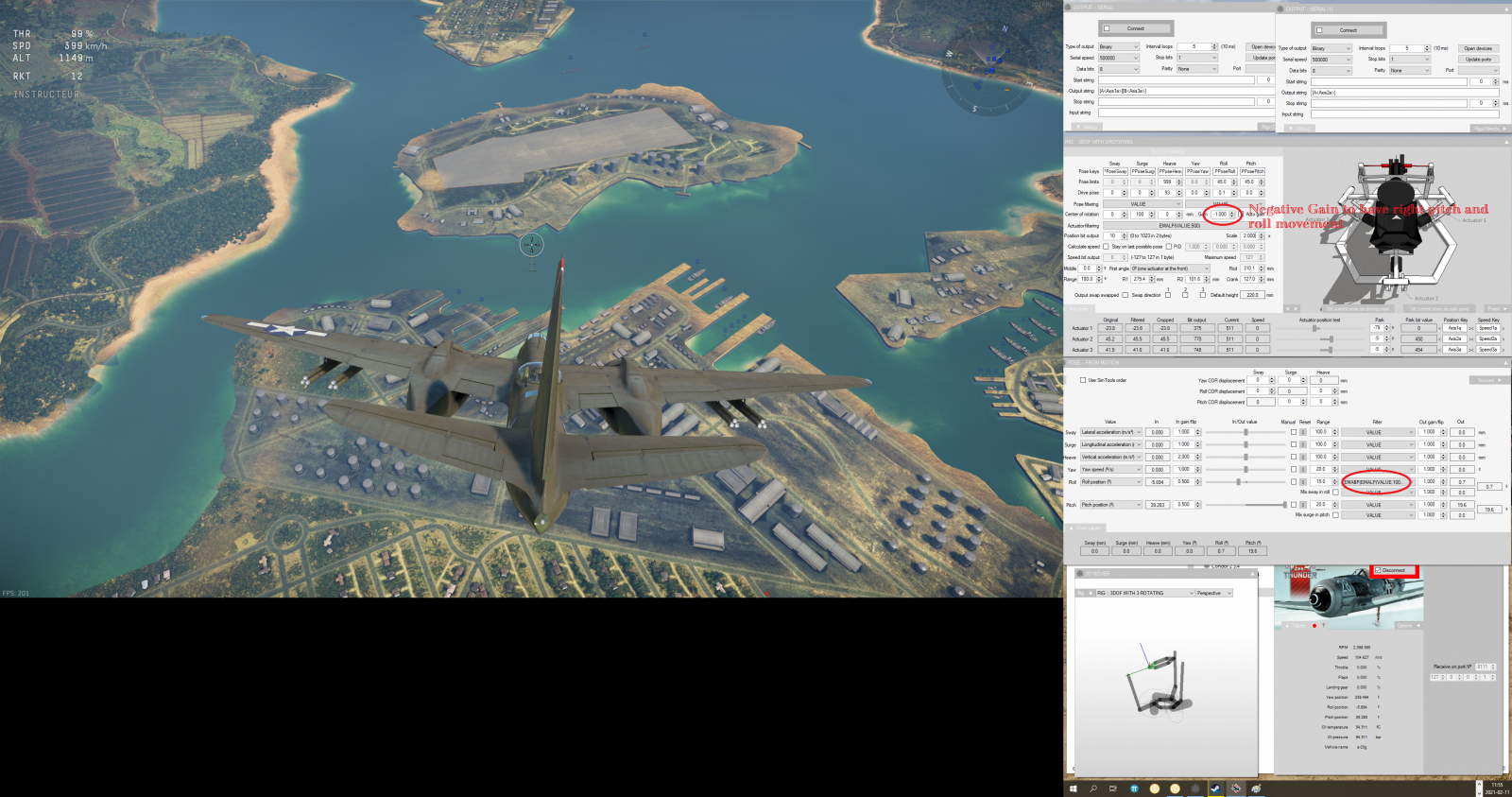

    hi it's me again,
    I tested warthunder and I have to put the gain in negative to have the right movement.
    I use the EMABP filter to simulate the roll effect well
    because when we roll at 45 deg to make a turn in a plane, the G force will sit us in the bench and if we close our eyes we would not say that we are leaning. with this filter when I start rolling, the rig will tilt in the right direction and then it will reposition itself horizontally. even if I keep my turn, it brings me closer to reality
    one thing that would be better is if we could use the G force for relative to the pilot to position the rig is that possible?
    and also I tried the mode with the tanks and the connection does not work

    @Marki ,
    Just took a look at you previous post.
    I see you are using a old version, please update to 3.4.0 at flyptmover.com
    There's some changes on that rig.
    I also corrected some errors now, but it will be for 3.4.1 (soon).
    War Thunder has no data for tanks, or if they have it's undocumented and I don't know how to get it..
    Relative to the CG correction, we have a problem. War Thunder, again, lacks data to calculate the correction.
    Only solution right now, is to use the correction on the pose (top of window) or in the rig module (but you are limited to 3DOF).
    This source needs a bit more of work. I can try to get some more data. Let me look at it better.
    Also, the pose module has no filters pré defined. You need to fill it. It's hard to give you something, because it depends on the rig and also on your expectations for motion.
    But EMALP(EMAHP()) give you return to zero similar to EMBP() . Maybe use this on the sway and surge accelerations mix and use EMALP(EMALP()) on roll and pitch.
    Not sure what works better on those rigs.

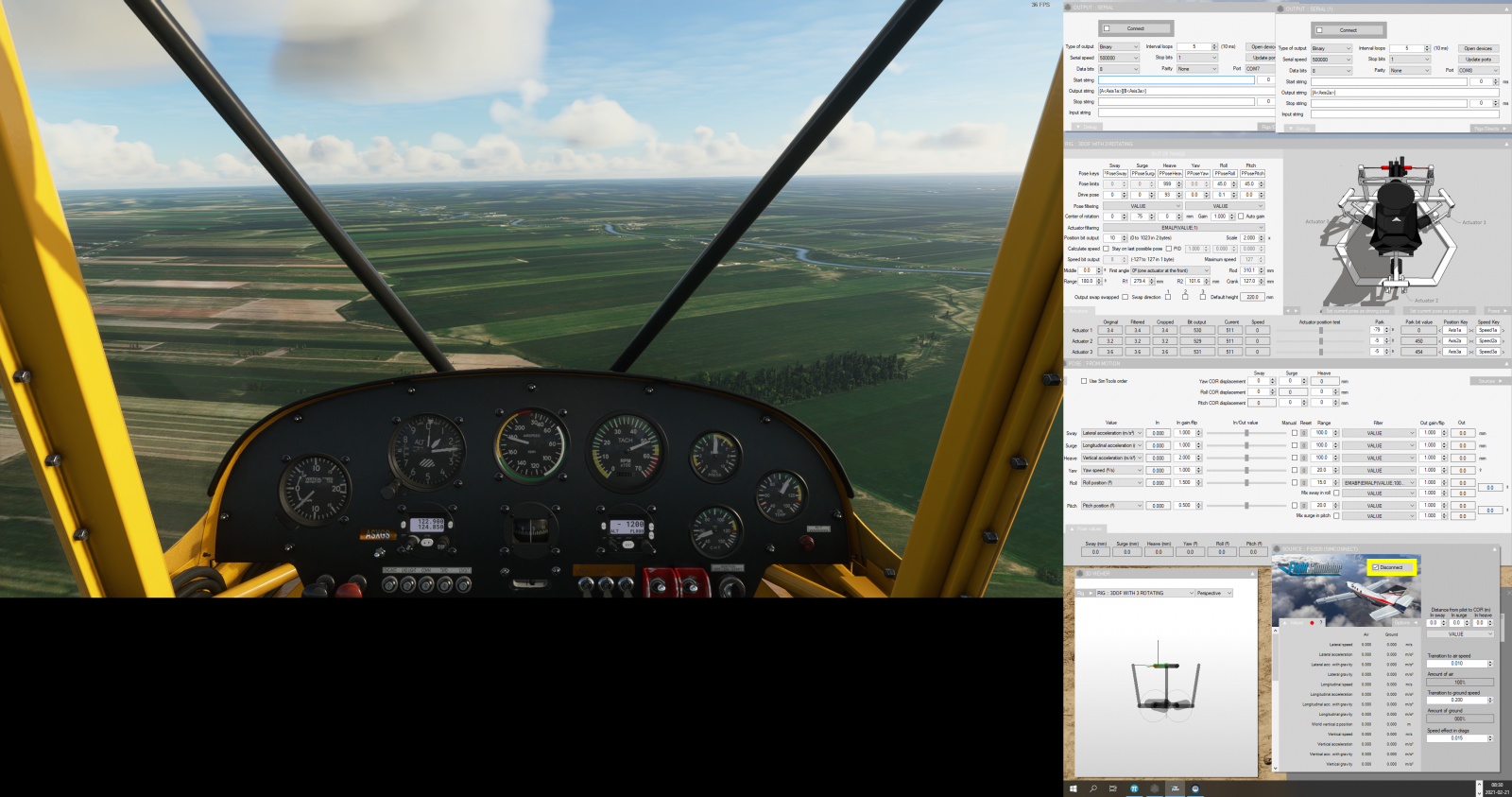

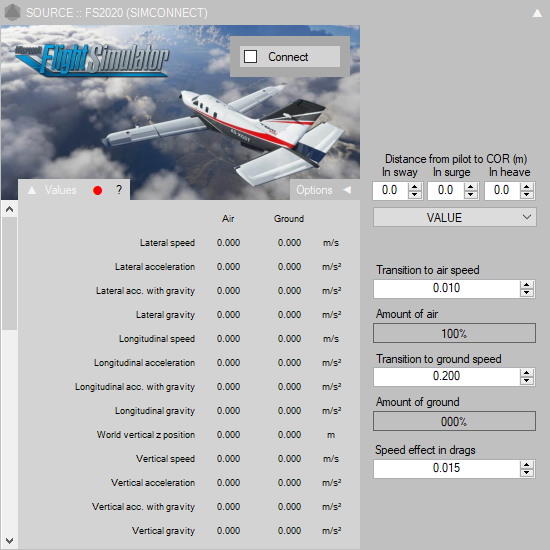

    Hi @pmvcda
    I can't connect Flight Simulator 2020,
    the source remains yellow.
    can you help me?

    @Marki and @Motion4Sim ,
    The new version doesn't need the extra executable.
    Just made a test, and I also have problems connecting.
    Going to look at it right away.

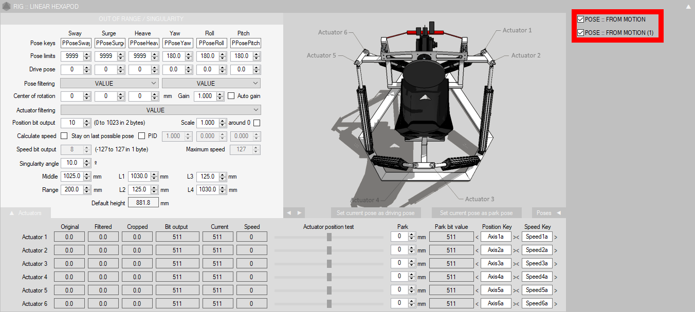

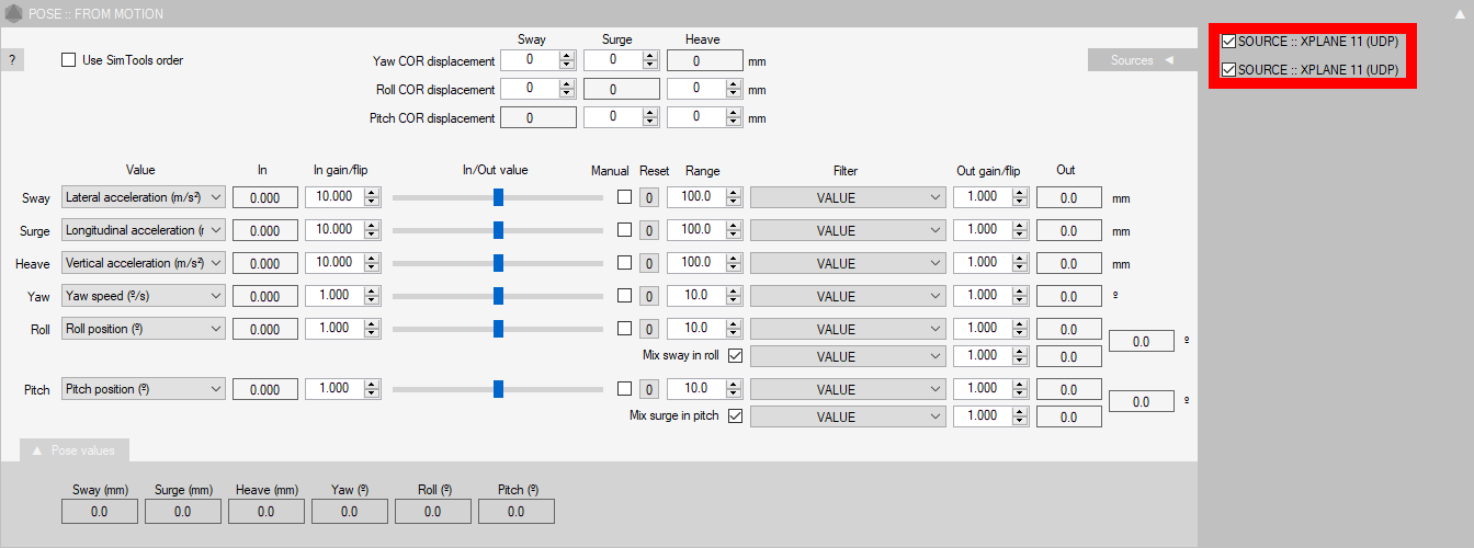

    looking for current X-Plane setup guidance on Alpha 3.4.0
    How do I balance the ground "feel" with the air "feel" in a single p[ose? Or do I need a pose for the ground data, and a seperate one for the air? I already have different poses for Heli and aeroplane.
    Has anyone got a default XPlane setup they could share for a 6DoF stewart platform?
  19. pmvcda
    pmvcda aka FlyPT
    Nov 3, 2010
    2,296
    Portugal
    16,036Coins
    +2,746 / 18 / -0
    To use both in one pose, you need to select them in the pose module.
    But to have different pose filters, you need to use 2 poses, one for each source and then select them in the rig:

    @Marki , relative to FS2020,
    Found the problem.
    I have a new release for tomorrow, with that solved and some extra bugs solved.
    It will also have new default setups for transducers.
    And a new custom UDP source that allows the user to feed mover with it's own data.
