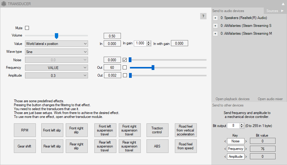

    - Corrected some bugs in the transducers:
    Also added a gain for the used value.
    Added some predefined filters, but they are WIP, nothing special.
    Remember amplitude and noise need an output between 0 and 1, so the graphic is scalled, moved and cropped (might look strange).
    Needs more work.

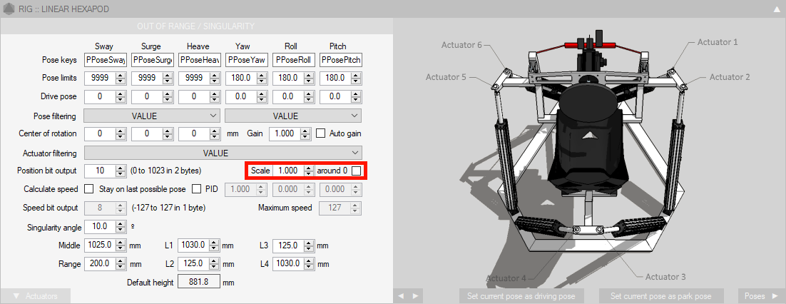

    - In the rigs, we can now set the scale to be made around zero instead of the actuator middle.
    So even with scale, we can keep bit value zero at the minimum, and adjust scale to match the maximum bit value of the actuator.

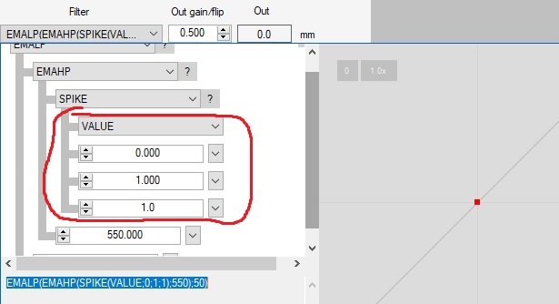

    Hey Friends. Can someone explane, how to use the Spikefilter? What Values do these three Fields represent?
    Much thanks.

  9. Bastiuscha

    ok thanks, halfway understood :)

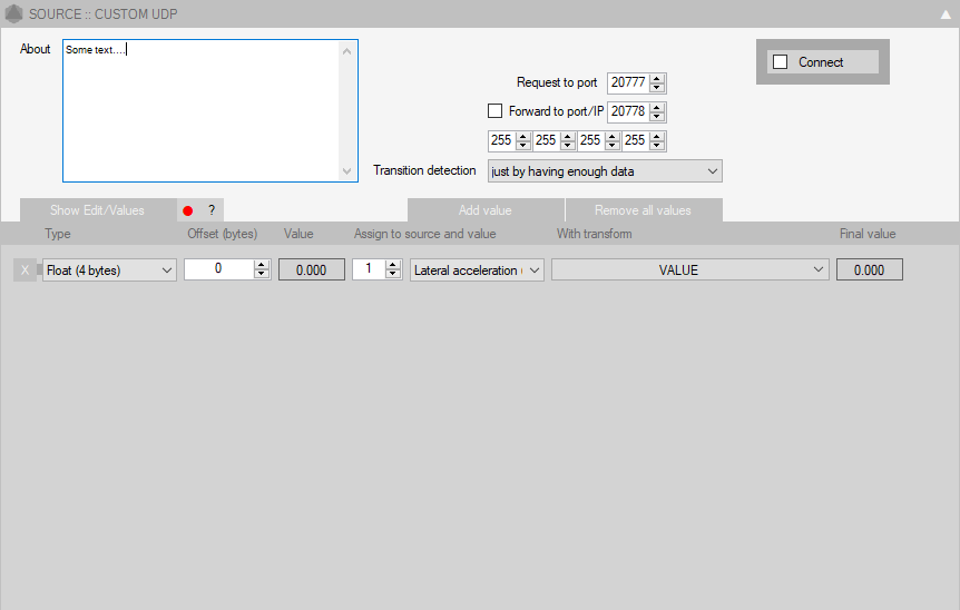

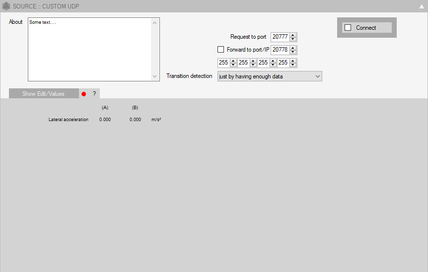

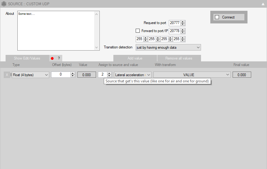

    Forgot to say that 4.3.1 now includes a custom UDP source:
    We can set the start byte position of the data we want to read and the type.
    You then assign it to a variable like lateral speed.
    You can also define up to 4 sources (like air and ground). So you can make this source a multi source.
    Pressing the "Show Edit/Values" button shows the values received like we see in other sources:
    notice the two columns for two sources (A) and (B).
    The filtering systems, allows you to perform operations on that value, like smoothing, or converting from radians to degrees.

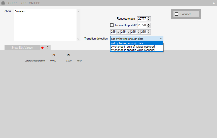

    You can also select the way Mover detects the existence of data to perform transitions between receiving and not receiving data:
    Just enough data means we are receiving the needed number of bytes to fill the selected values.
    By change in sum of selected values, means it is active if the sum of values change.
    By change in specific value, means we can select a specific value, like a clock to detect activity.
    The limit here is that you can't convert local to world coordinates or use up vector directions and compute the other ones.
    But it's intended use ids for those who are making a game or other software and they want to feed data to Mover.

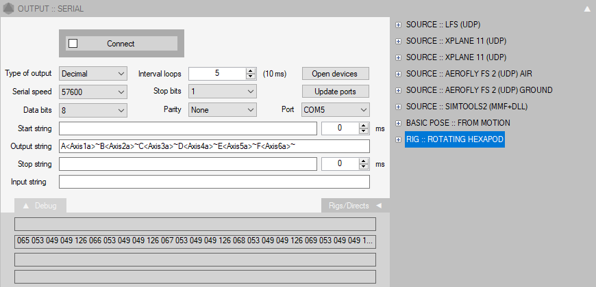

    I am back on this topic after almost 2 years without touching my 6DOF RC servo platform.
    I'm glad to see that the FlyPT Mover software is much more advanced and mature than it was at that time. It truly offers endless possibilities, congratulation @pmvcda for this master piece.
    I managed to make it work correctly except for the very last step: The serial output.

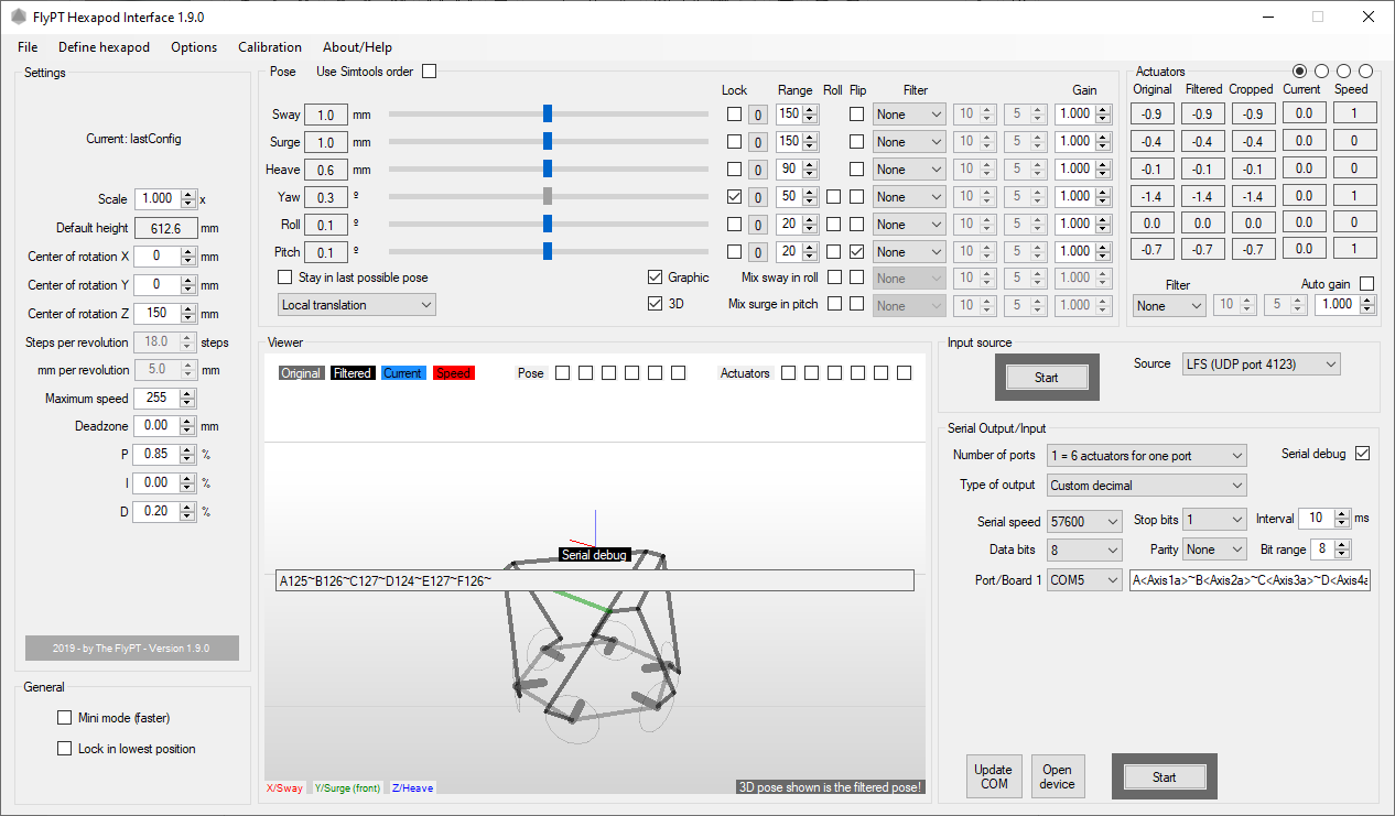

    Here is a screenshot of the previous version (FlyPT 1.9) I was using, and it is still working fine nowadays.
    Now, here is the current output serial configuration window (FlyPT Mover 3.4.1), as you can see, I replicated the previous configuration but the servo won't move (as they do with the previous version of FlyPT).
    One thing I notice it the difference in the debug lines of both versions, they are different, so I assume this is why the servo are responding to the first string (A125~B126~ ...) but not the the second one (065 053 049 126 ...)
    Any idea what am I doing wrong ?
    Thanks in advance.
    EDIT: I think I found where the issue is. In my Rig configuration, I set the "position bit output" to 8 when it was originally 10. And it seems to be working fine now. Does that make sense ?

    Yes, that's right.
    In the new Mover, you can output values in different bit ranges, so you need to set it in the rig module.
    By default it's setup to 10 bits.

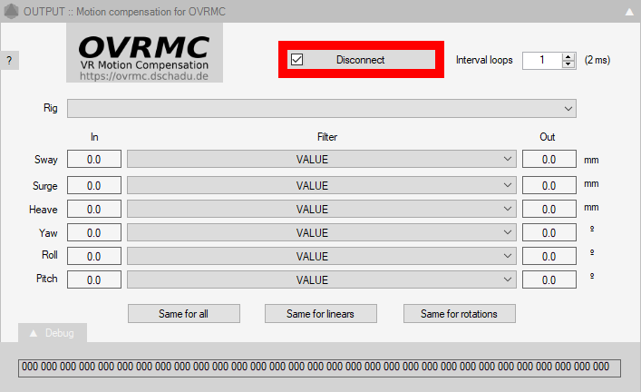

    You need to add the output for OVRMC in Mover:
    Don't forget to connect the output (should be red like the image), and select the rig in the drop down control.
