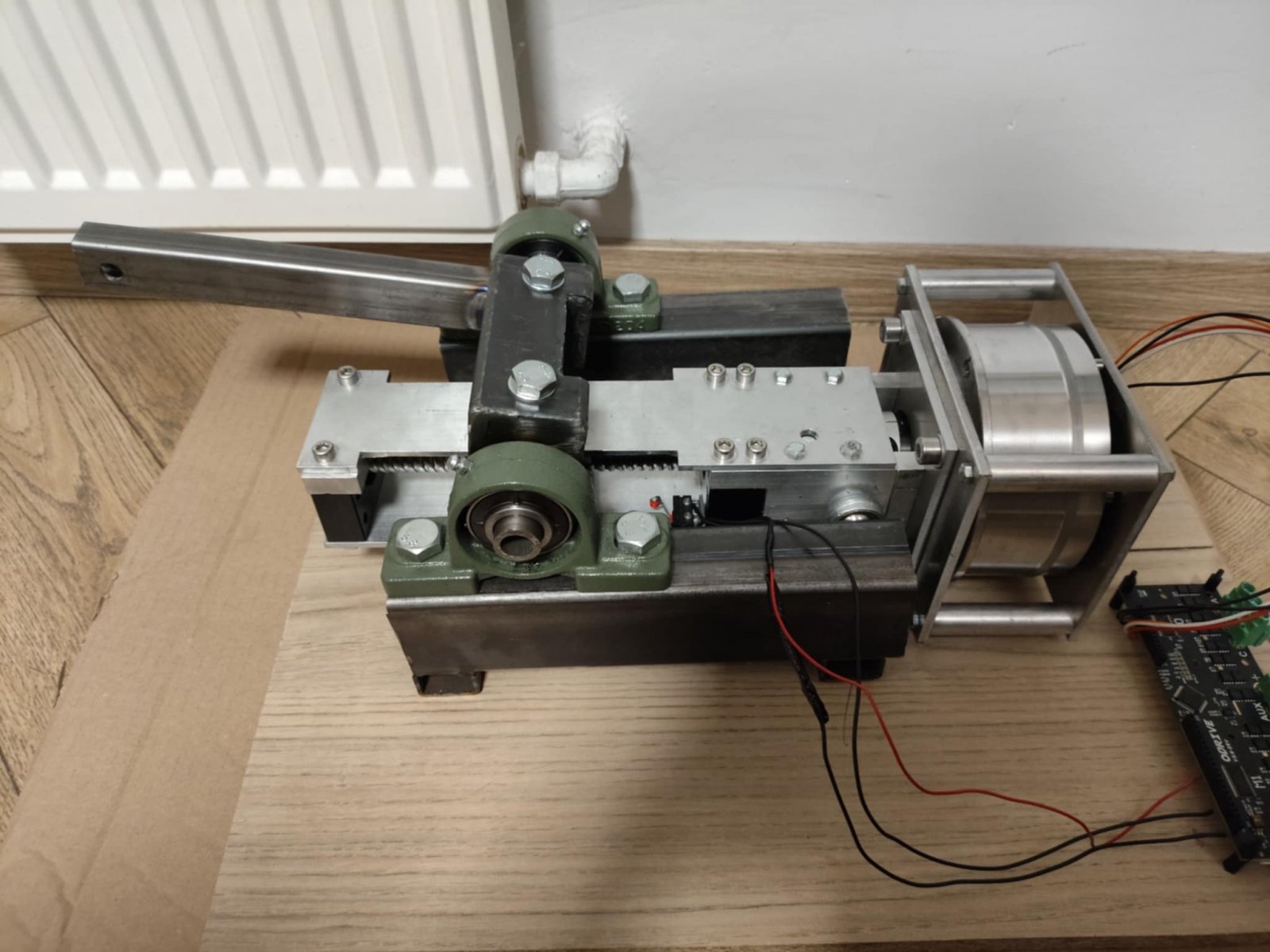

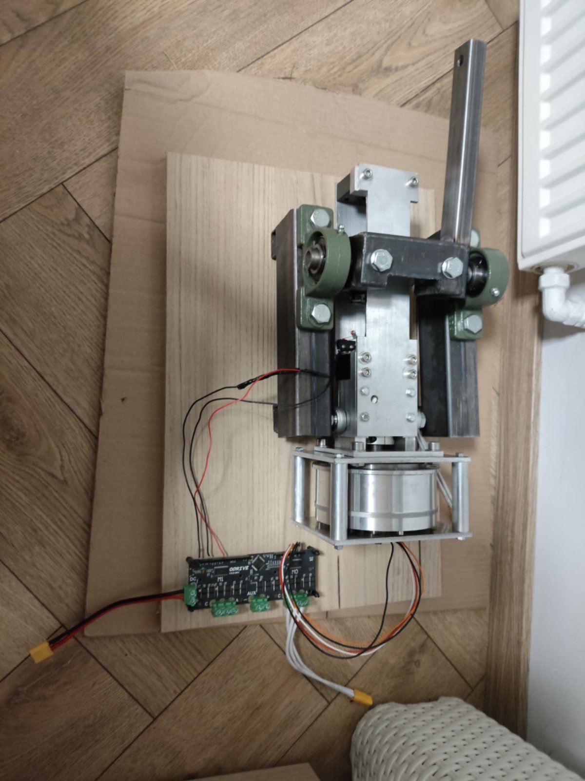

    Hi, I'm building 6DOF motion rig with hoverboard motor actuators. I've built first actuator for a try, and I'm stuck at connecting ODrive 3.6 with it. I managed to send data and it works in serial mode, but moves very erraticaly few rotations per time for small movement of slider. Sometimes it stops working completely, with no errors. I'm not sure what to type in serial window - p 0 <Axis1a><R0.A1.T><13> is it OK? I cannot find any tutorials, all of them are outdated. I don't understand what i need to type there, and "start", "stop" lines.
    I have ODrive 3.6 with firmware 0.5.6. Encoder is AMT10E2 with 20480 cpr. ODrive PID is configured.
    I have also built FFB stick (FFBeast firmware) and rudder with the same ODrive, encoder and motor, and it works perfectly.

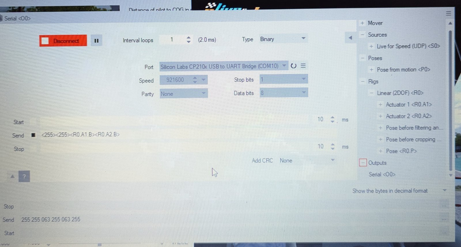

    Hi, I've been running Mover 3.6.0 beta for years with no issue. I'm now testing Mover 3.7.0.9. I've created a generic profile for testing.
    In 3.6.0, the connection button when clicked shows Starting and then Disconnect. Clicking again: Stopping, Connect.
    In 3.7.0.9, the button only ever shows Connect, Starting or Stopping. I'm trying to connect to
    FT232R USB UART and Silicon Labs CP210x USB to UART Bridge. It appear to fail to connect to any COM port on my PC. The VR motion compensation also only shows Starting and Stopping. Never connected or "Disconnect".
    I've set up the serial connections identically to 3.6.0.
    What could I be missing? Thanks!

    Adding any sources immediately breaks all serial port connections. Removing all sources immediately restores connections. Is that a bug or feature?
    [update] An added SingleWave module was preventing serial ports connections. Removing it restores connectivity.
    I had the occurrence of an instant reboot when clicking the Connect button for a serial connection. It hasn't reoccurred after the reboot. But haven't been stress testing it.
    I presume all these issues have been well-documented in these forums.

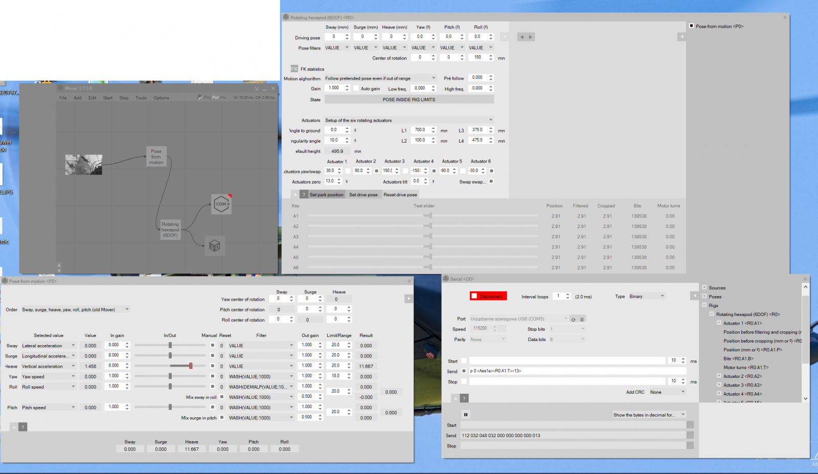

  8. Deleted member 38270
    I'm a fan of the FlyPt program.
    I have a stupid question.
    Can we use the amazing FlyPt to build an FFB joystick?
    Is it possible for an input parameter like Speed to cause the force on the motor to increase, not the position?
    Best regards,
    Tadek

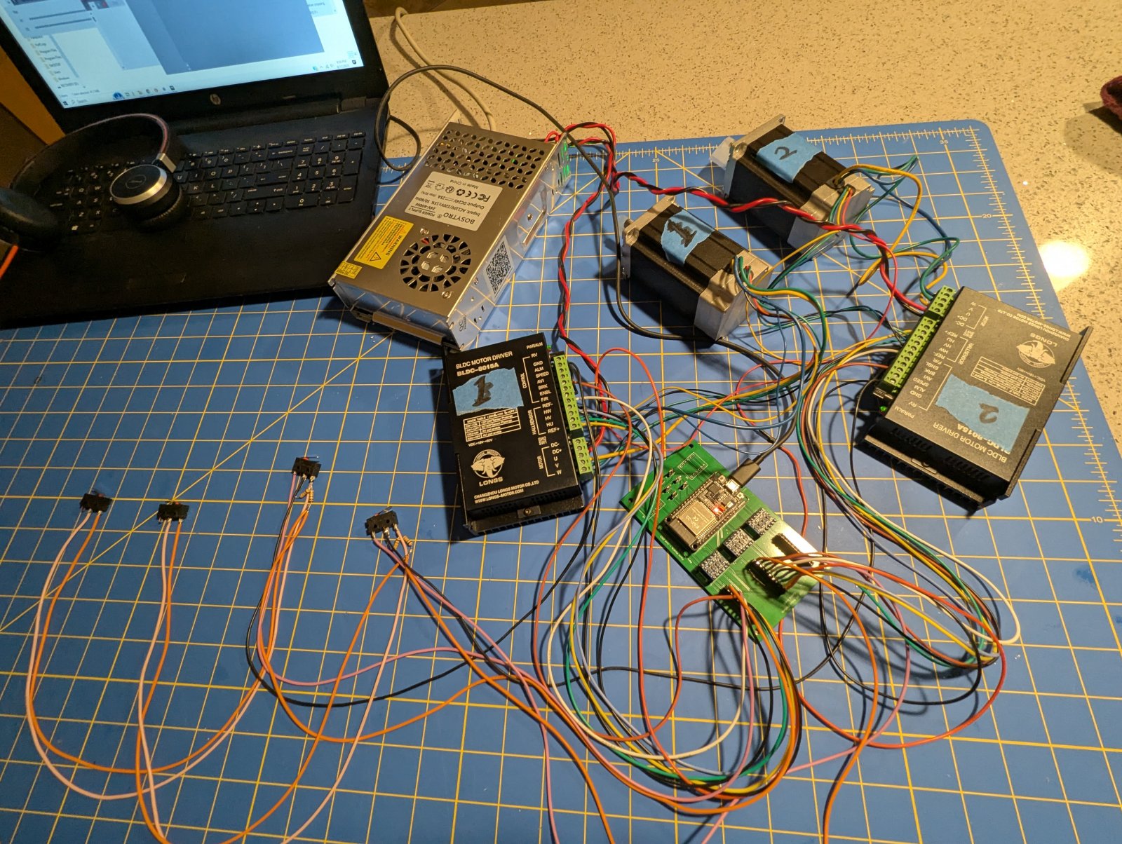

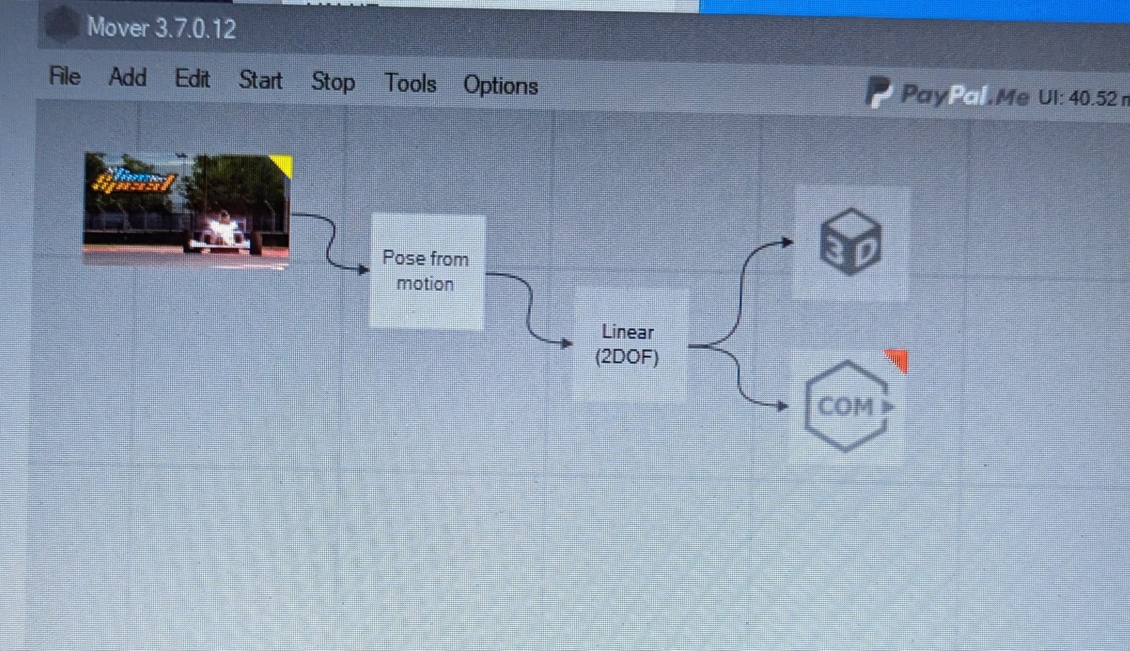

    Hi Guys, I am working on a 2DOF with DIY Actuators like @pmvcda design and ESP32 sketch at:
    https://www.xsimulator.net/community/threads/flypt-6dof-brushless-diy-actuators.10799/#post-139682
    I am currently bench testing the setup and can't seem to get the motors to turn. I setup FlyPT, and it reads the telemetry motion from LFS as I can see the 3D viewer movement. I have set up the string as per information in this thread and also changed bits to 15 for the actuators. Has anyone got this working with the ESP32 arduino sketch per Pedro's design with the newer version 3.7.09 of FlyPT? Any assistance is appreciated. Thanks!

    Everything ok, just to much work. Can't even come here to post the updates.
    Trying to make it more stable and I will post here when I can trust it more. Stay tunned. The updates should show automatically in the menu.
