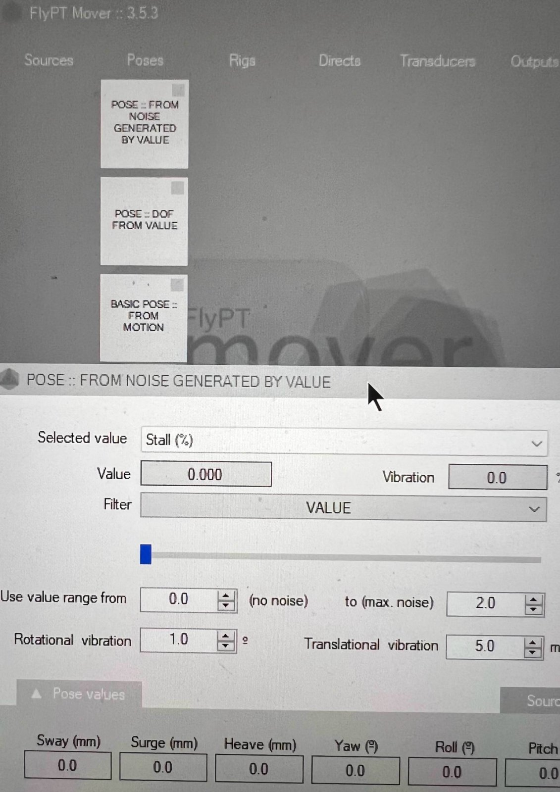

    It’s a nice try but I see only one parameter for noise effect. Do you know if we can make this noise slower to use for low RPM or Stall buffet effect ?

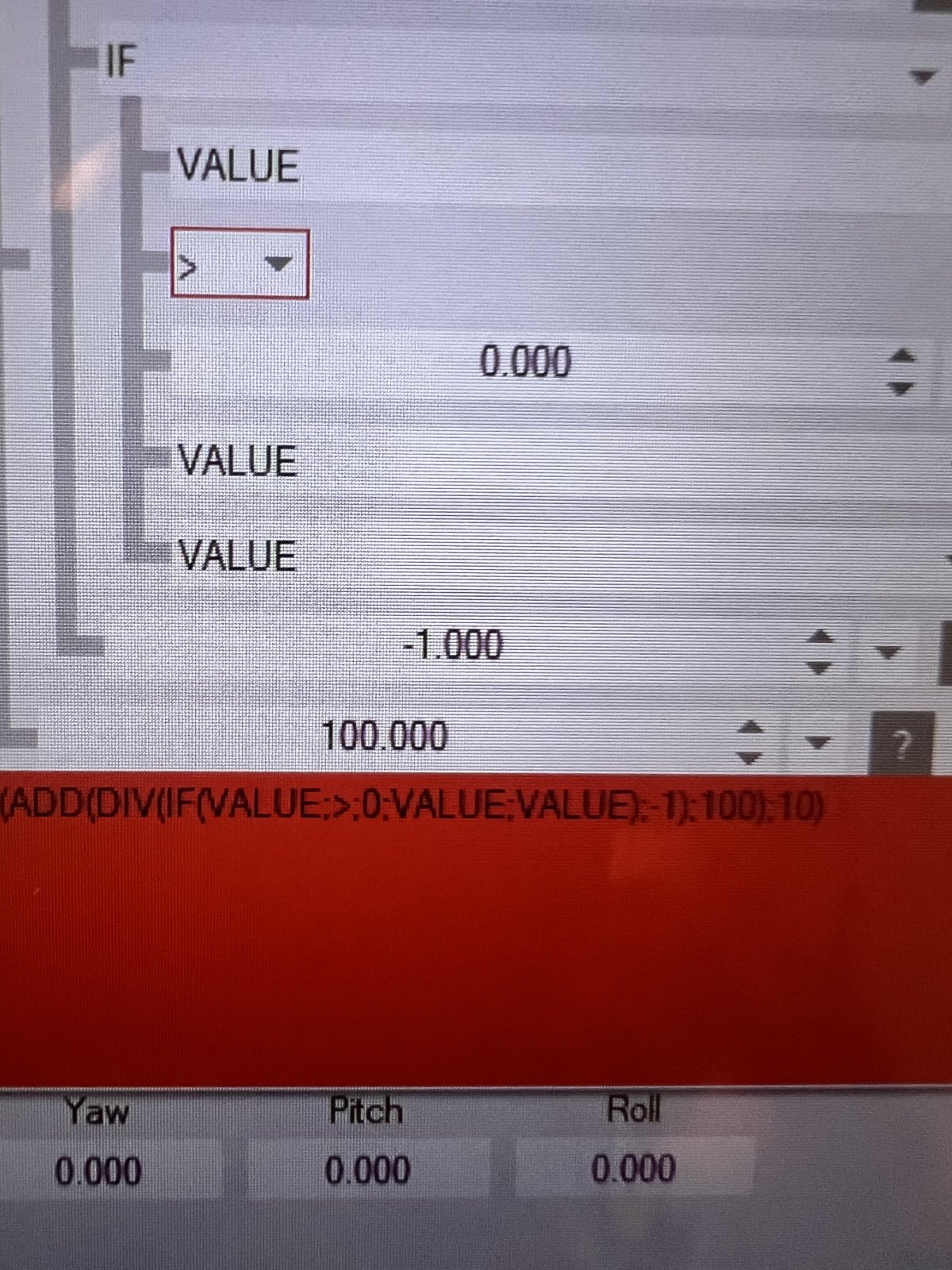

    Could someone explain why I do have a red color using everything else than = in the if condition ? Bug or Feature ?

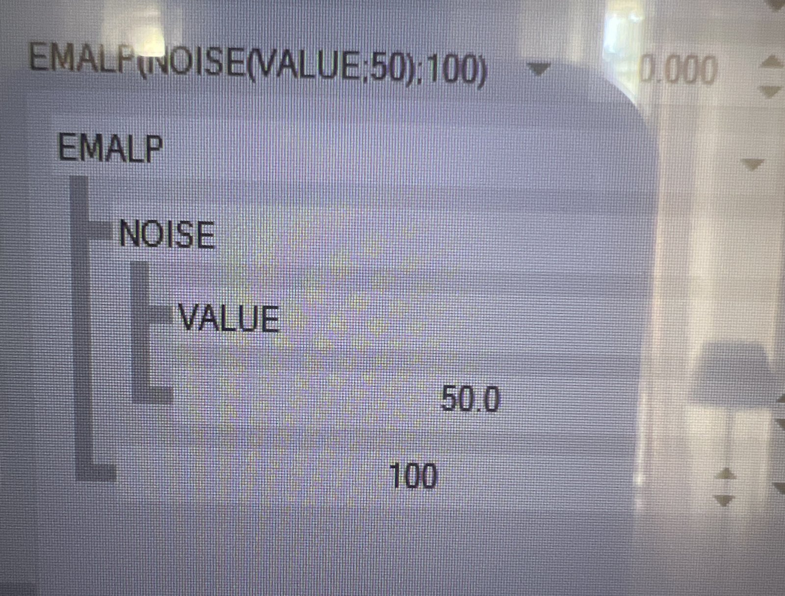

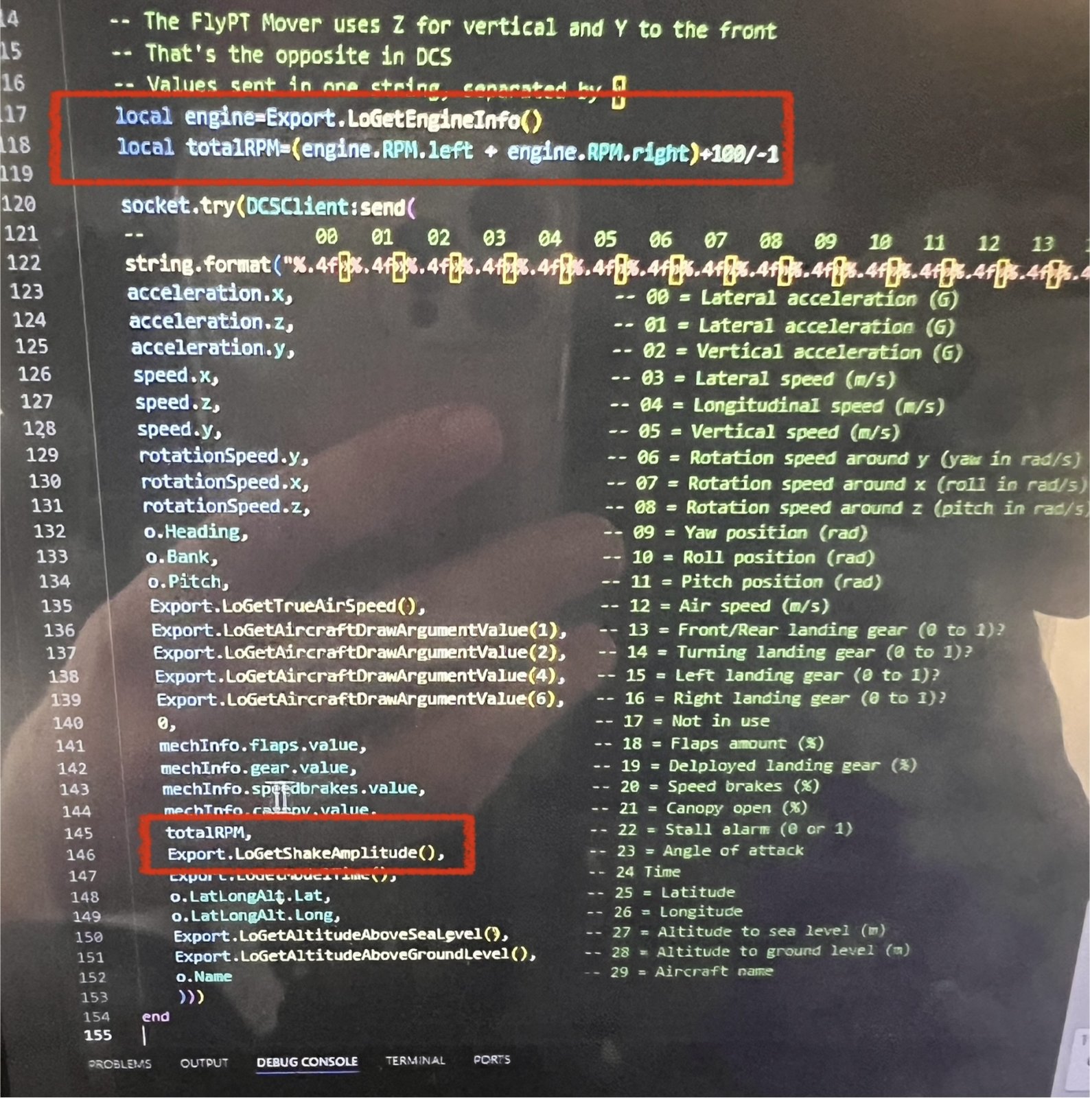

    DC motor, 6DOF
    Ok, After couple of hours I understood.
    It seems that the higher the value, the lower is the period of noise filter.
    In order to smooth the response you have to address the EMALP first:
    Concerning missing RPM and Stall buffet in DCS you can add following four lignes of code in Lua for Mover.
    Quick an dirty for the moment until someone will do it much better:
    “+100/-1” is here for the inversion of RPM shakes : Big at idle and decreasing with higher values.
    Hoping it will give motivation for eventual further improvements.
    Cheers - Hexpod

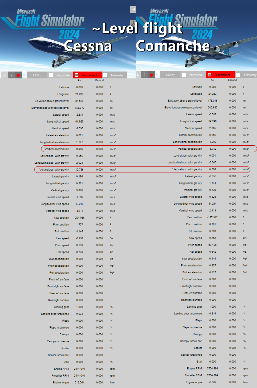

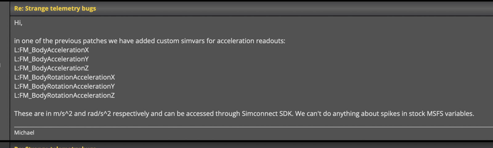

    Would it be possible to expose new variables from MSFS 2024 telemetry?
    I bought the A2A Piper Comanche plane, as it's supposed to have the best flight model for most realistic flight experience, but unluckily the developer has messed up the motion telemetry and especially heave is wrong. Maybe surge too.
    - instead of fixing the regular vertical acceleration data, they've added some custom variables, please see screenshot; if it were possible to listen to these, the motion might work.
    (whole discussion https://a2asimulations.com/forum/viewtopic.php?t=75857)

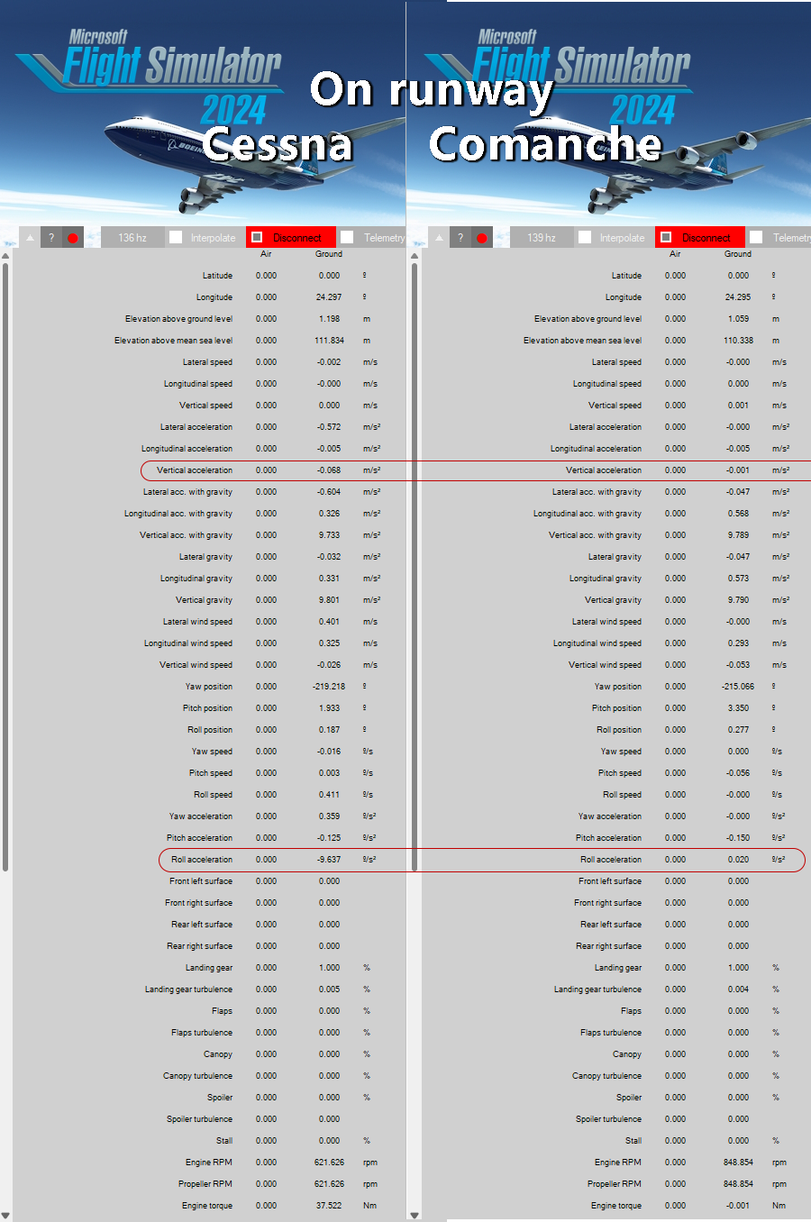

    I mean the A2A Comanche telemetry is off, not Asobo's as a whole: I attached two screenshots comparing the acceleration data on the runway, standing still, and in (almost) level flight (active pause).
    While on ground, the values seem to be close (except for roll accel.)
    In the air, things get messy.
    - Cessna: Vertical acc. w/ gravity ~ 9,81 m/s2 + 0,985 m/s2.
    - Comanche: Vertical acc. w/gravity = 0. And vertical acc = -9,732 m/s2
    So I was thinking if there's a way to include A2A's own FM variables, they might be correct. Alternatively, maybe I can try to make a custom mover profile for the Comanche and just add a constant 9,81 m/s2 value to the vertical acceleration in all situations, but I don't know if that is the correct thing to do, outside level flight..
