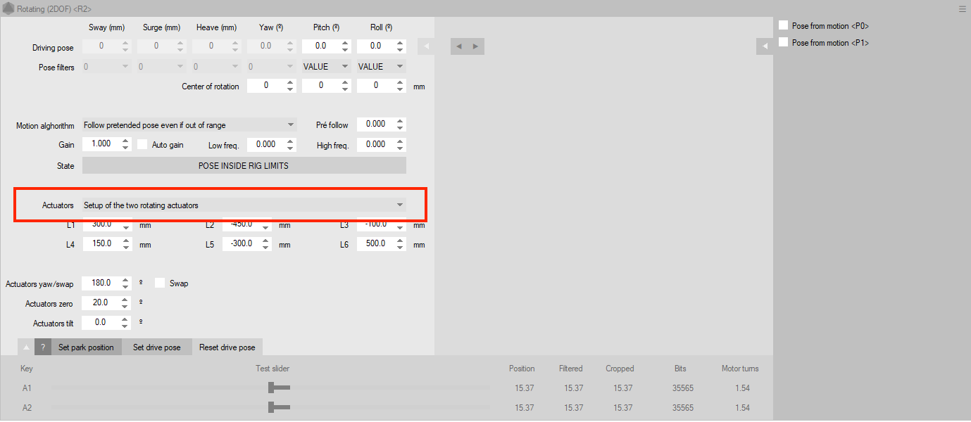

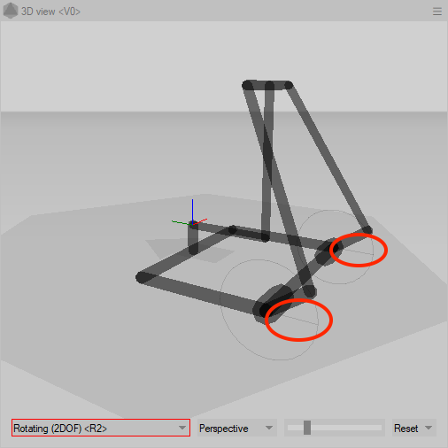

    Hello, and thank you for adding the 2 Dofs.
    There is, a priori, a bug, the connecting rods and the lever arms are reversed for me on the 3d viewer model, I did not want to go further by connecting my Rig.... and there is missing data from entry on the sizing of the Rig in question compared to the old version, or have they become useless? (dimensioning the length of the lever arm?).
  8. khairul nizam

  10. michel123

    Yes the rig moves well, but the connecting rod and the arm are reversed, my 6 cm lever arm is at the top and my connecting rod is at the bottom attached to the engine.
    I put the same dimensions in the L1, L2 etc. configuration, so before plugging in and going further I'm waiting to see if it's a real bug or if it's me who doesn't understand anything... ..
    I will try to take an image of the 2 rigs side by side to show.
  11. pmvcda
    pmvcda aka FlyPT
    Nov 3, 2010
    2,237
    Portugal
    15,702Coins
    +2,669 / 17 / -0
    Yes, there's some changes in the new Mover.
    Please show me your rig.
    Actuators have dedicated buttons to set the parameters:
    When you click there, you get a popup window to set the crank and rod sizes.
    You also set the minimum and maximum value of the actuator. For example if you want it to move from -90º to 90º, set those values.
    This was made to make the window lighter (other rig types with different actuators where crazy)
    IGNORE DEFAULT POSITION, it will be removed and does nothing
    In the main window you set rig specific parameters:
    The sizes of the rig like in the old Mover (L1 to L6)
    And where are the actuators. And here it's important to understand how rotating actuators are defined in Mover.
    When setting the actuator position/direction, Mover uses the crank as a reference.
    You set the position and direction of the crank for actuator position 0º (the range defined above in the actuator button is made around that direction)
    So you can define yaw of the crank, pitch/zero of the crank and roll/tilt of the crank.
    In the 2DOF rig, Mover automatically mirrors the actuators.
    If you want the actuator crank to the other side, try changing the yaw value.
    Maybe you have a huge range defined (180 by default) in the actuator and the rig automatically chooses the correct angle to achieve the position needed for the dimensions you defined and it goes to a strange position.
    With the circle theres a line showing the zero:
    Might be there a bug, but please try to achieve the correct position using this.
    Between the two Movers, there's changes that allowed setting any orientation to the actuator that where not possible before

    So actuator buttons define the actuator without taking into acount any position or direction (in direct module it's just this)
    Outside of that button in the rig module you define the actuator position/orientation in space to be calculated for a specific pose

  14. michel123
    michel123 Member
    Jan 12, 2024
    88
    cadre sncf
    lezignan-corbieres
    180Coins
    +37 / 0 / -0
    actually it was me who hadn't seen the selector for actuators!!!
    It works on the viewer, I find my rig, not yet tested in real life, but so indeed it is the rotation limits which give you the position limits, simpler and more logical indeed!
