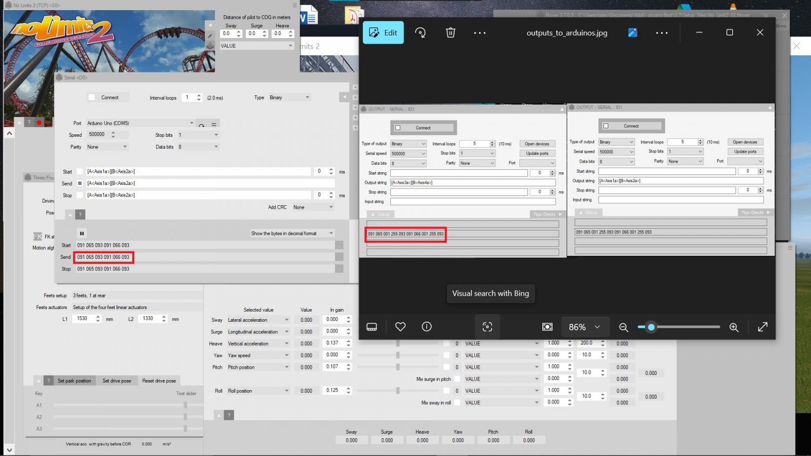

    Just in case you have not got around to testing this scenario yet. Cannot combine two rigs in a Mover. Trying to use Rigs.Rotating2DOF and Rigs.RotatingActuator with SMC3 serial output. The output string template of "[A<R0.A1.B>][B<R0.A2.B>][C<R1.A.B>]" will cause a link of R1 and O0 in the overview flow diagram as expected, but R1 variables are not added to the Rigs section of the O0 variables list and the "C[<R1.A.B>]" format results in "C[]" in the output string causing very confusing behavior in the Arduino and actuators.

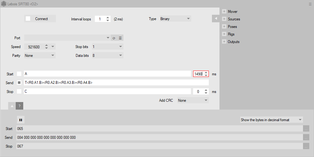

    Hello everyone. I was trying to make my new rig move with the new 3.7 mover but could not. Going back to another mover (3.53), it moved. Looking at the strings sent, there is a difference. Am I doing something wrong with the new Mover?
