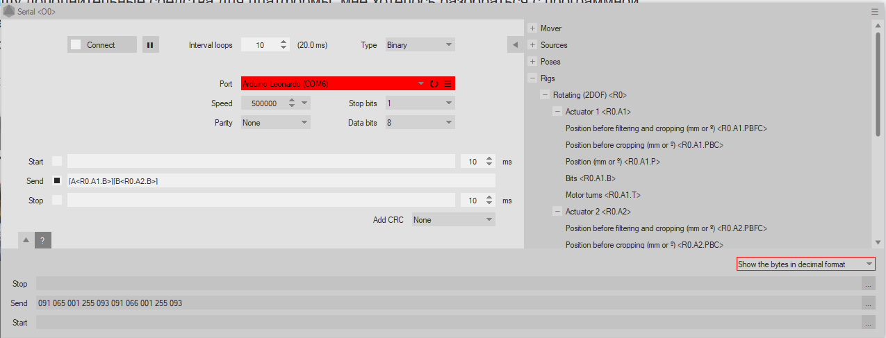

    I got something like this, but I'm not sure it's correct. It's just that your website says (example from the website): In the output string, use: "[A<Axis1a>][B<Axis2a>][C<Axis3a>]"
    But the program doesn't have those axes.
    Could you please tell me if I'm on the right track, as I don't really understand programming or code. upload_2025-11-6_23-28-47.png

    In Mover 3.5.2:
    In Mover 3.7.0.x:
    [A<R0.A1.B>][B<R0.A2.B>][C<R0.A3.B>]

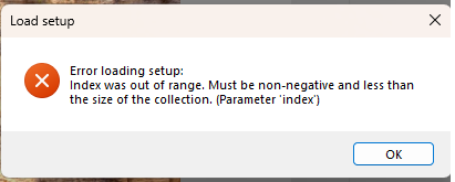

  7. PavelF
    PavelF New Member
    Sep 9, 2025
    29
    186Coins
    +12 / 0 / -0

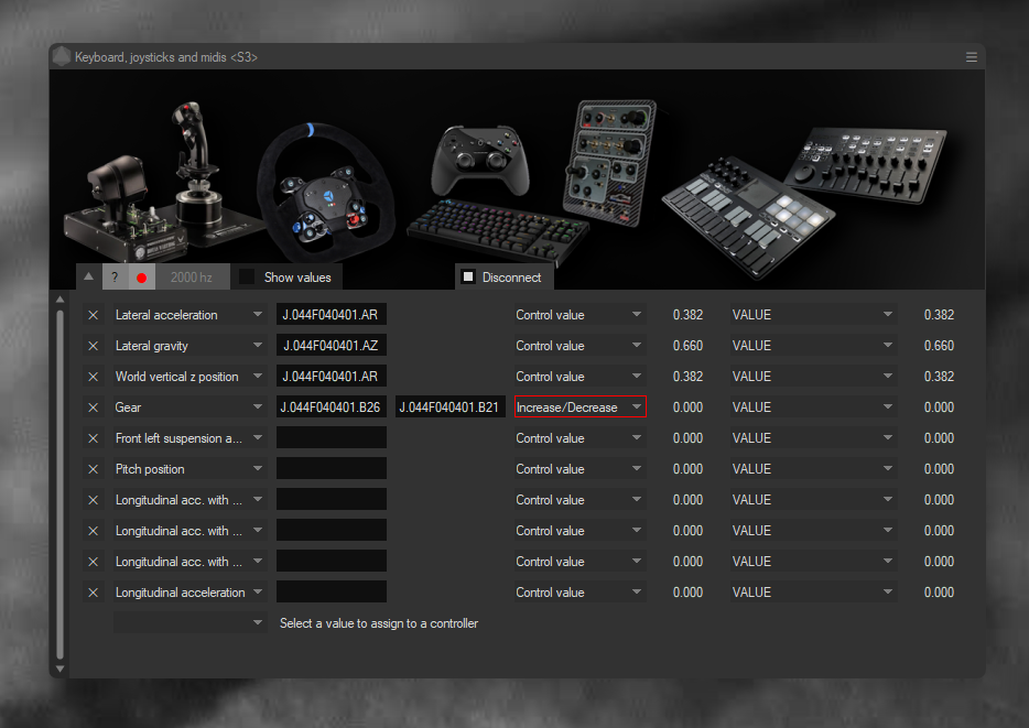

    Version .17
    Keys have been added to the "Keyboard..." module. The configuration has been saved. An error occurs when opening this configuration.

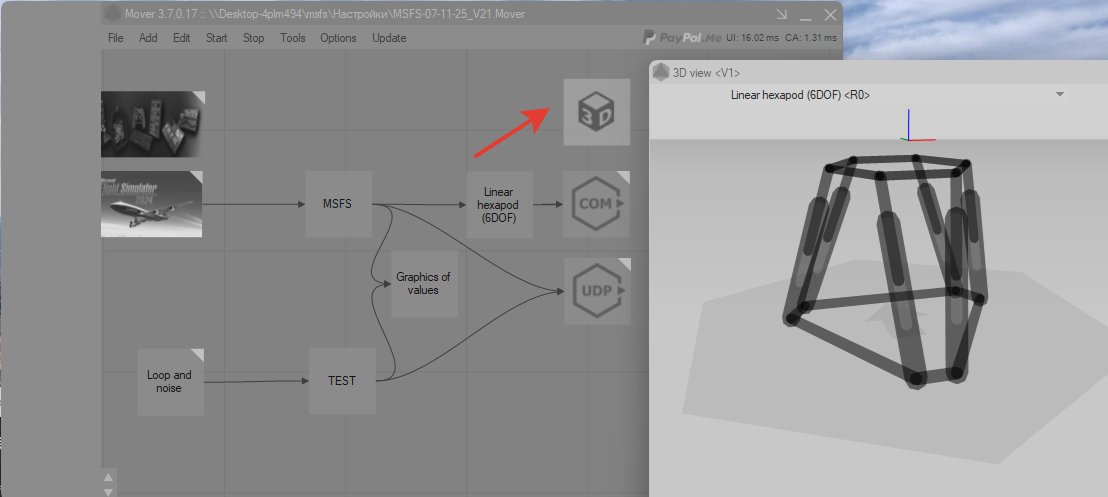

  9. PavelF
    PavelF New Member
    Sep 9, 2025
    29
    186Coins
    +12 / 0 / -0

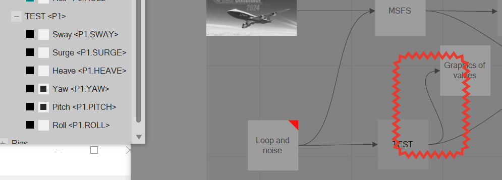

    Version .17
    We're displaying the graph. The arrow is there.
    We're removing the display of any element, and the arrow is gone.

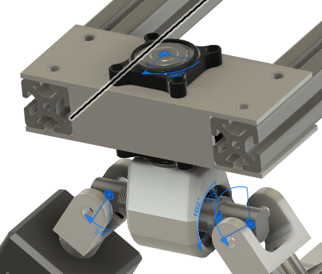

  10. Chris_Beeves
    May 31, 2019
    372
    2,145Coins
    +258 / 4 / -0

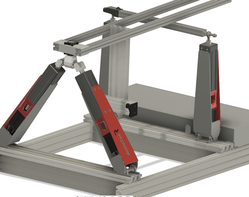

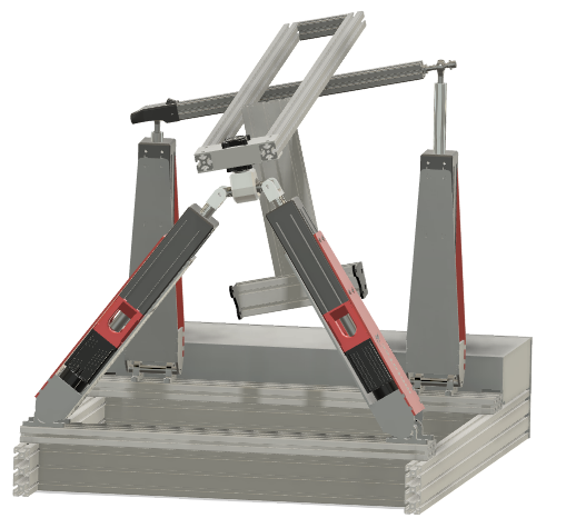

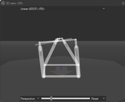

    I'm using the 4Dof Linear rig, and the front actuators lean. Is there any way to keep them from doing that? IRL they are only free to lean forward/back..
    Or is it just a visual thing, and the COR calculations won't be affected?
    Really interesting trying a completely new concept after years of Simtools.
    Also, the rear actuators IRL have no control over the roll, but the roll affects them too.
    Can I do anything about what actuators do what more like I would in Simtools?
  11. pmvcda
    pmvcda aka FlyPT
    Nov 3, 2010
    2,227
    Portugal
    15,641Coins
    +2,662 / 17 / -0
    In your rig, it's not moving front/back?
    Can you share some photos of the joints please.
  12. Chris_Beeves
    May 31, 2019
    372
    2,145Coins
    +258 / 4 / -0
    There are a few retail rigs that have similar layout. Not sure how they solved the over/under constrain in the design, but the joints should be similar on all of them.
    The front actuators are involved in pitch, heave and roll.
    The rear actuators are involved in pitch, heave and yaw (TL).

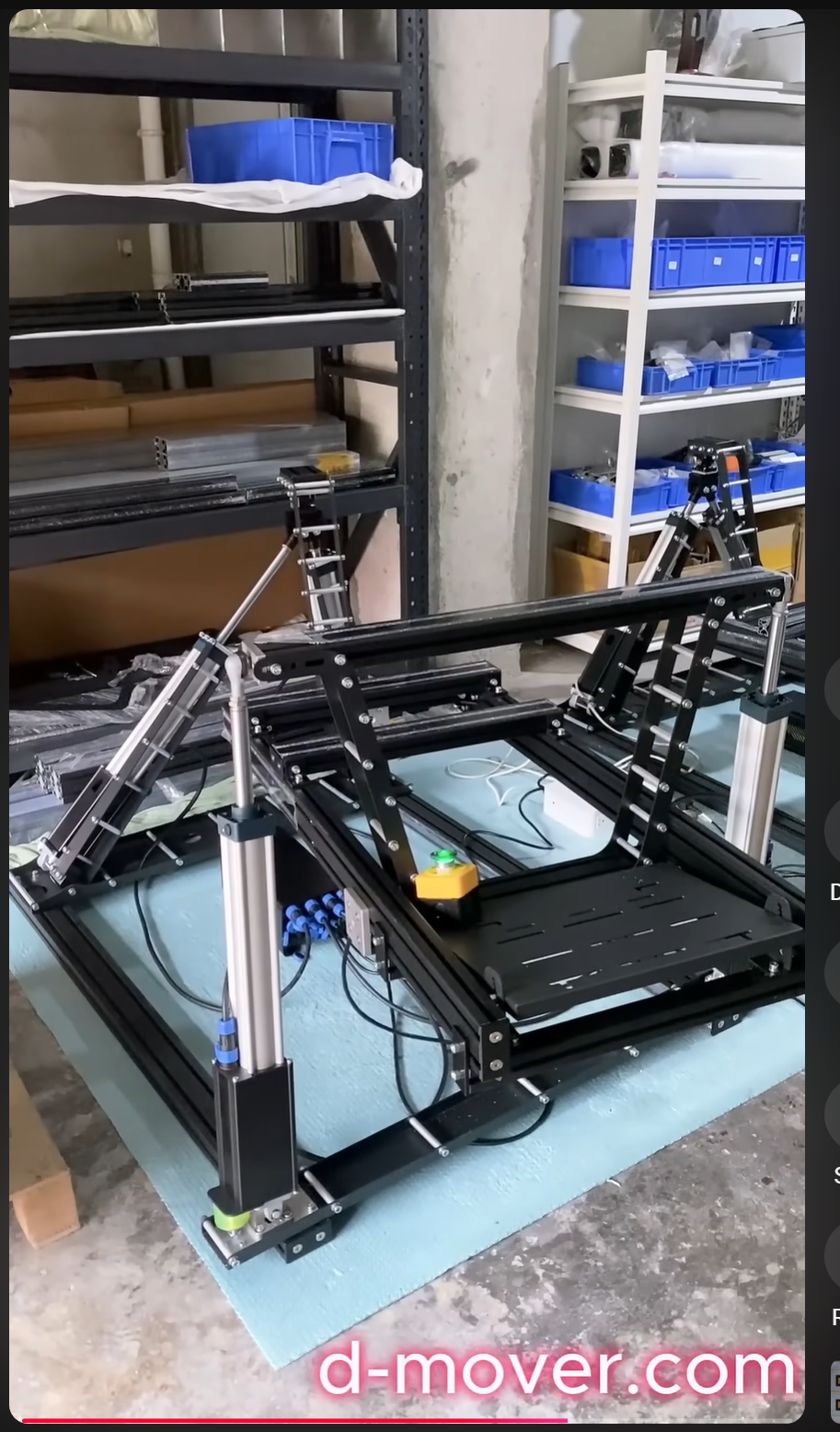

  13. pmvcda
    pmvcda aka FlyPT
    Nov 3, 2010
    2,227
    Portugal
    15,641Coins
    +2,662 / 17 / -0
    The base of the front ones can only go front and back? I mean, rotate around the sway axis
  14. pmvcda
    pmvcda aka FlyPT
    Nov 3, 2010
    2,227
    Portugal
    15,641Coins
    +2,662 / 17 / -0
    You have a slider at the front to compensate the distance change between rods right?
    I can add a rig like that, i thought it was like the one i added.
  15. Chris_Beeves
    May 31, 2019
    372
    2,145Coins
    +258 / 4 / -0
    Exactly. The top rod ends of the actuators can slide a little.
    I think all of the linear 4dof have the same behavior. The only difference is whether the have the elasticity on top like I have or in the bottom. You don’t have to add a rig specifically for mine, it’s better to make the current one more generic. As it is now, none of the 4dof linear rigs will behave right.
    Either you can allow the distance between the top front joints to change or allow the bottom to rotate a little around the surge axis, returning to center. Or maybe there’s a smart way to do it :thumbs
  16. pmvcda
    pmvcda aka FlyPT
    Nov 3, 2010
    2,227
    Portugal
    15,641Coins
    +2,662 / 17 / -0
    I wil do something. I thought yours was similar to this:
    https://www.youtube.com/shorts/Sa0zZfYh9Ps
  17. Chris_Beeves
    May 31, 2019
    372
    2,145Coins
    +258 / 4 / -0
    That’s exactly what I was trying to explain. Instead of having the sliding top they have rubber flex on the bottom. My rig and theirs move the same, you can see that the rear actuators do not work when the platform rolls.

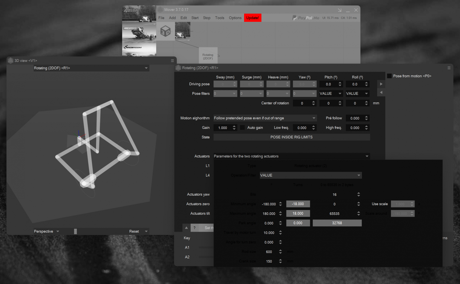

  18. lenidcamper
    lenidcamper New Member
    Dec 4, 2022
    14
    eastern Ontario, Canada
    64Coins
    3DOF, Arduino
    Version 3.7 is a significant step forward. Thanks for all the work Pedro.
    I am replicating a 3.5 rig and I have run into a few problems.
    I used Rotating Actuator 2DOF and Rotating Actuator (2x6DOF) to go from
    [A<Axis1a>][B<Axis2a>][C<Axis3a>] in Mover 3.5.2: to
    [A<R0.A1.B>][B<R0.A2.B>][C<R1.A.B>] in Mover 3.7.0.x:
    With sine wave test sources I am getting unusual serial output. The A and B channels are of the form A<#><#> or B<#><#> as expected.
    Channel C is of the form
    C'rapidly changing number or letter'<#>
    Is this a config problem or a bug in (2x6DOF) serialization?
    PS
    There a couple of persistence bugs
    Rotating Actuator 2DOF rig - actuator swap flags not persisted.
    - "Housing Joint" config not persisted
    - "Crank direction" config not persisted

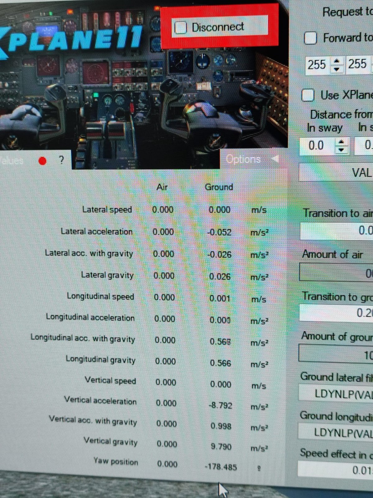

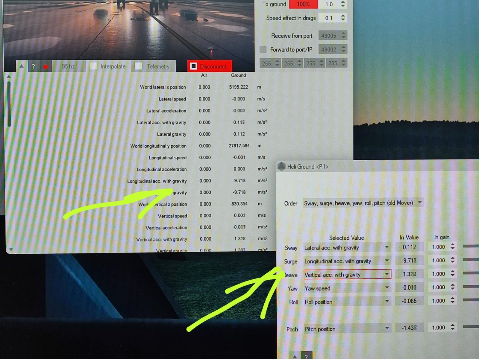

    I've just discovered a strange thing in the XPlane source.
    If I'm standing still on the ground I think the vertical acceleration with gravity should be close to 9.81m/s² and the longitudinal acceleration should be clode to zero. However, they are exchanged. I've cross-checked with the old Mover 3.5. There it's also not quite right but at least different.
    Vertical acceleration (without gravity) of 8.7m/s² is strange while standing on the ground. It could be that this is a bug of XPlane, but there must also be something wrong in Mover because V3.5 and V3.7 behave different.
