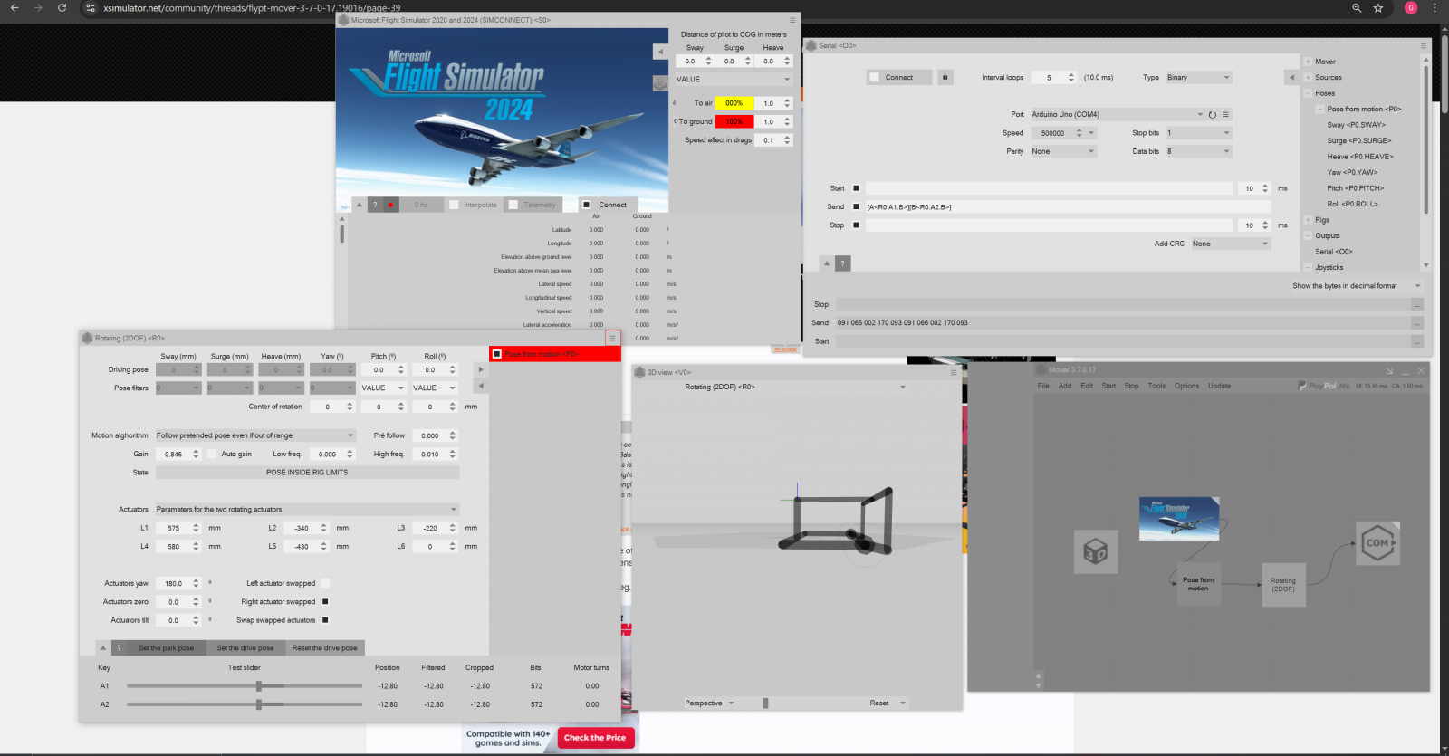

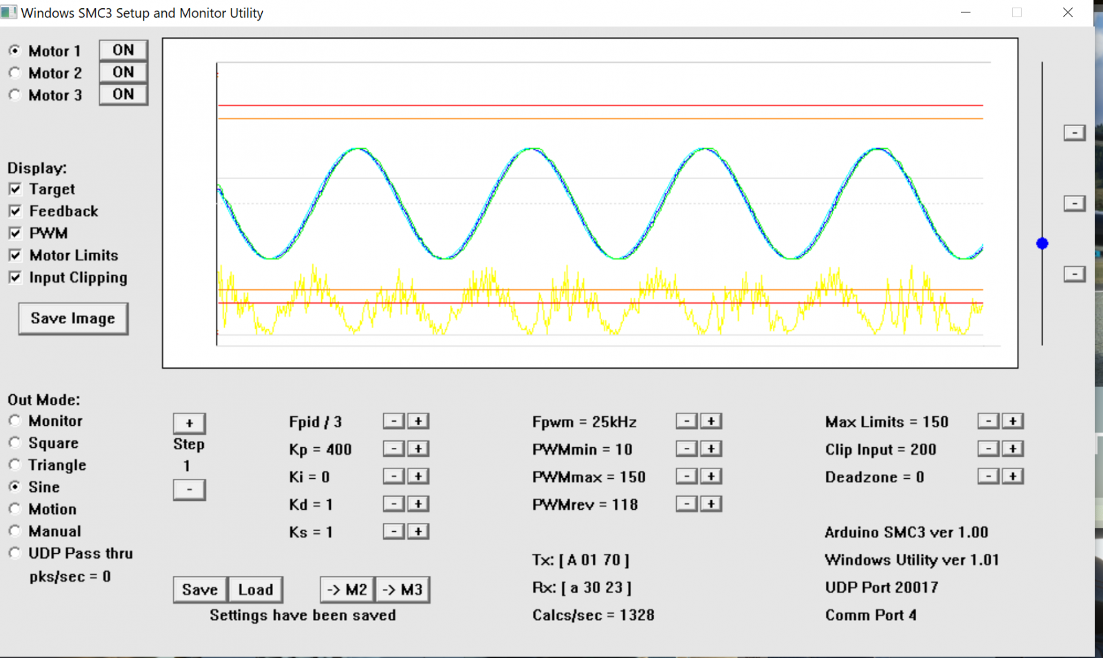

    hi guys, just finishing my 2dof for msfs2020, i have the motion running with FLYPT 3.7, but its way too aggressive. Can someone kindly help me with this so its smooth and not so aggressive? I am reading about filters etc, unfortunately not very good when it comes to software.
    i have screenshots of attached all my settings.

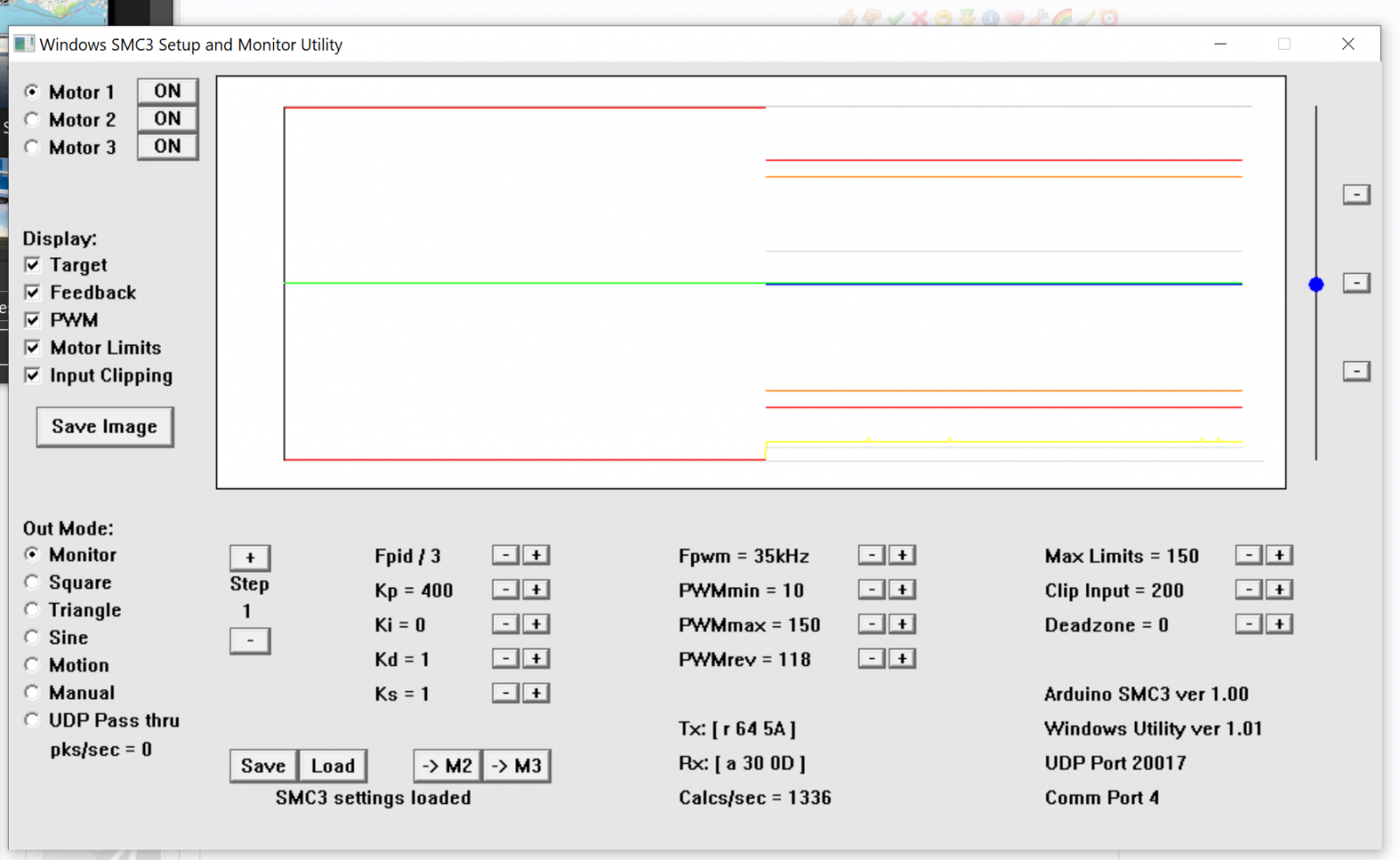

    Could you please try Fpwm at 25kHz and post a picture of SMC3 running the Sine test.

    here you go mate, i have turned down gains on flypt to 0.5 which seems to have helped a bit.
    any help is appritiated.
    22,023
    153,734Coins
    +11,148 / 57 / -2
    That looks pretty good in terms of the SMC3 side :thumbs
    FlyPT has a steep learning curve, and those who use it are way better placed to advise about refining settings.

    Thanks once again @noorbeast , i will look more into the links and resources you have provided, have made some progress, now it just shakes when arms get to max angles. I remeber readimg a thread about this issue, will do some research.

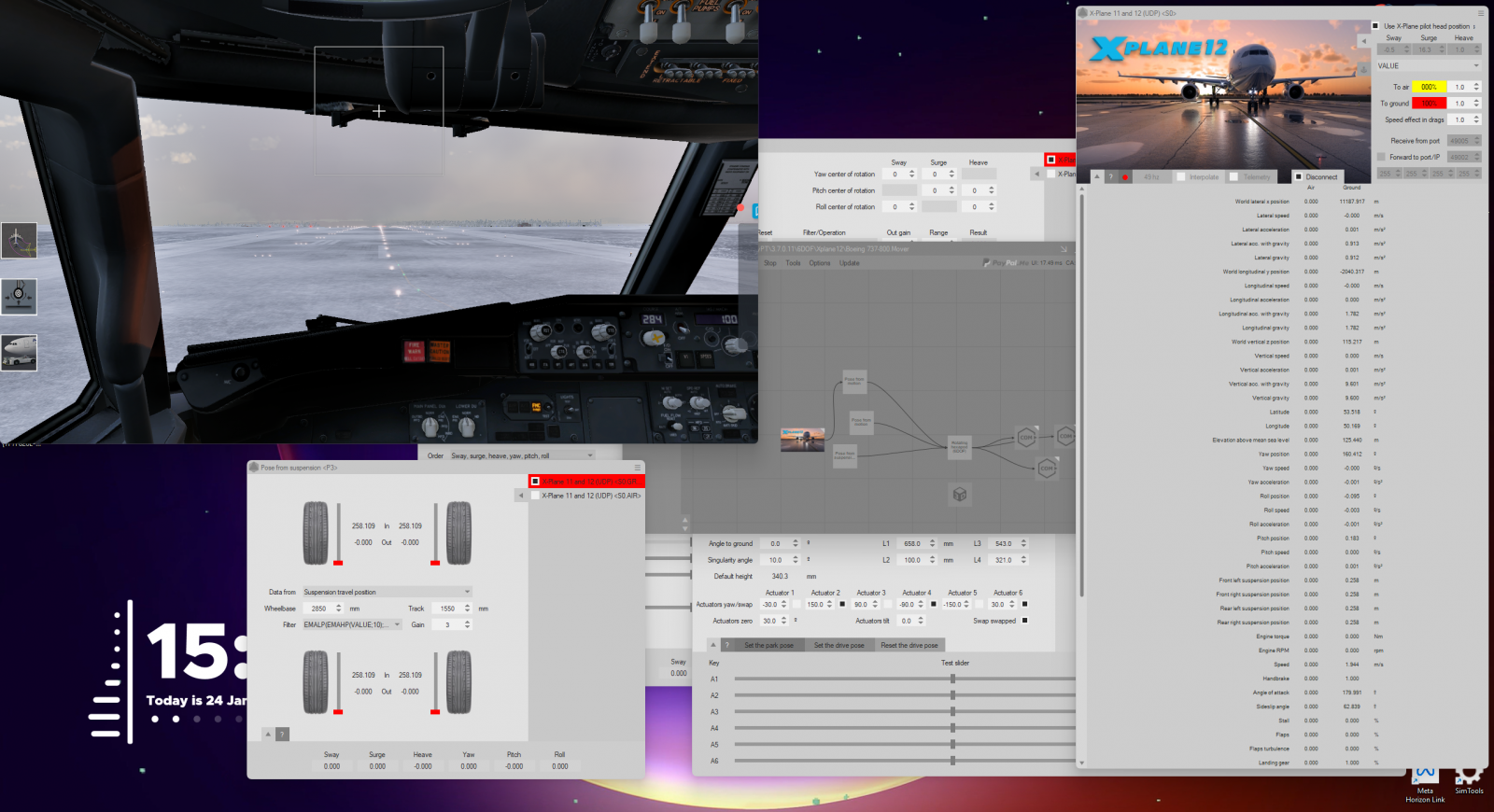

    Hi, @pmvcda! Please check the xplane12 plugin.
    1. The LONGITUDINAL data from the game is incorrect. The data refers to the surface of the earth, not the aircraft. If the aircraft is moving in a northward direction, the longitudinal data is correct, and the drilling rig moves accordingly. However, if the aircraft is rotated in the opposite direction, such as southward, the longitudinal data is displayed with a minus sign. The drilling rig experiences a deceleration effect instead of an acceleration effect.
    2. Pose from suspension does not work correctly. The aircraft is on the runway, but Pose from suspension shows abnormal values instead of zero.
    3. Pose from RPM stopped working in all games in the new version. As soon as I connect Pose from RPM to Sources, the Rig stops moving. If I disconnect Pose from RPM, the movement is restored 1.png 2.png 3.png

  8. Fors
    Fors New Member
    Sep 25, 2023
    8
    63Coins
    The plane accelerates on the runway, and everything works correctly. But if I turn the plane around and start accelerating on the runway in the opposite direction, the tilt axis will flip, and instead of an acceleration effect, I will get a braking effect. If I flip the axis, it won't help at all.

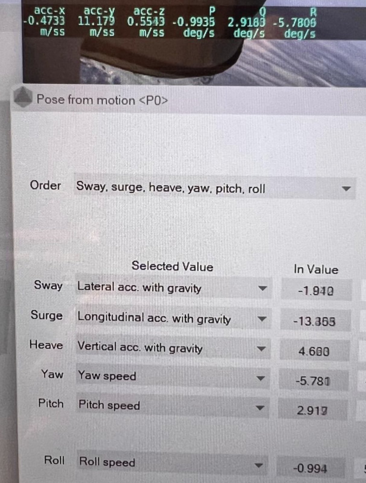

  10. hexpod
    hexpod http://heXpod.xyz
    Apr 18, 2016
    1,218
    berlin
    7,838Coins
    +376 / 5 / -0
    DC motor, 6DOF
    Check that motion platform stats fits 1:1 with Mover « in » values. (They natively have gravity component inside)
    Check in Mover for both - accel with and without gravity.
    One of those should match

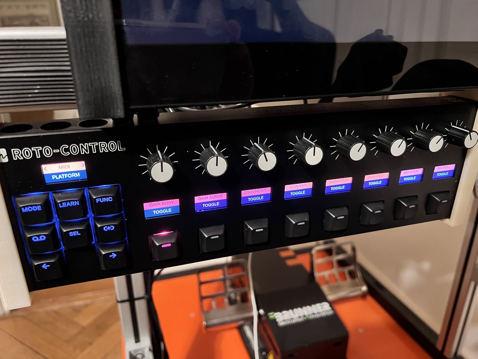

    Looking forward to separate DoF gain controls mapped on 14 bit motorized MIDI pots. Maybe even in full duplex if we are lucky.

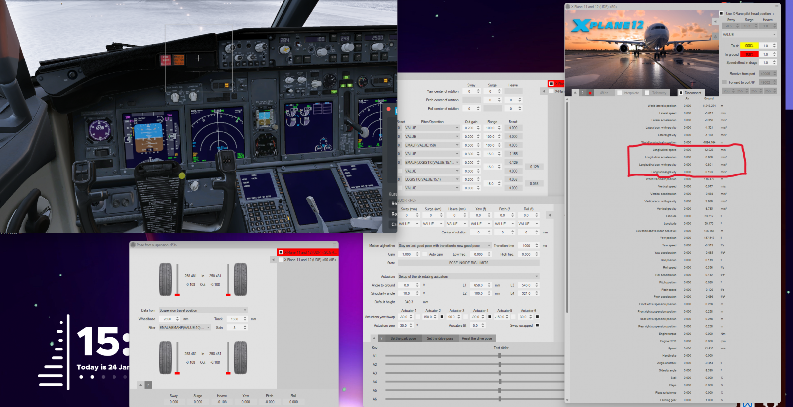

  17. Fors
    Fors New Member
    Sep 25, 2023
    8
    63Coins
    I've already tried changing it. It's the same thing. In the sourse window, you can see that the acceleration values coming from the game to the plugin are incorrect. In a specific direction of the aircraft in the game, the data is correct. When I turn the aircraft by +90/-90 degrees, the acceleration/deceleration effect disappears completely. When I turn the aircraft by 180 degrees, I get a deceleration effect instead of an acceleration effect. The incoming data from the game comes with a negative sign. The plugin doesn't understand that the aircraft is turning. It's as if the acceleration data belongs to the compass needle rather than the aircraft. This issue only occurs in Xplane. In other games, such as MSFS2024, everything works correctly. Xplane also functions properly with simtool.

    I checked while ago « with gravity ». Indeed they were not good. Maybe the gravity is add twice.
    Please check normal accels. and send similar screenshot:

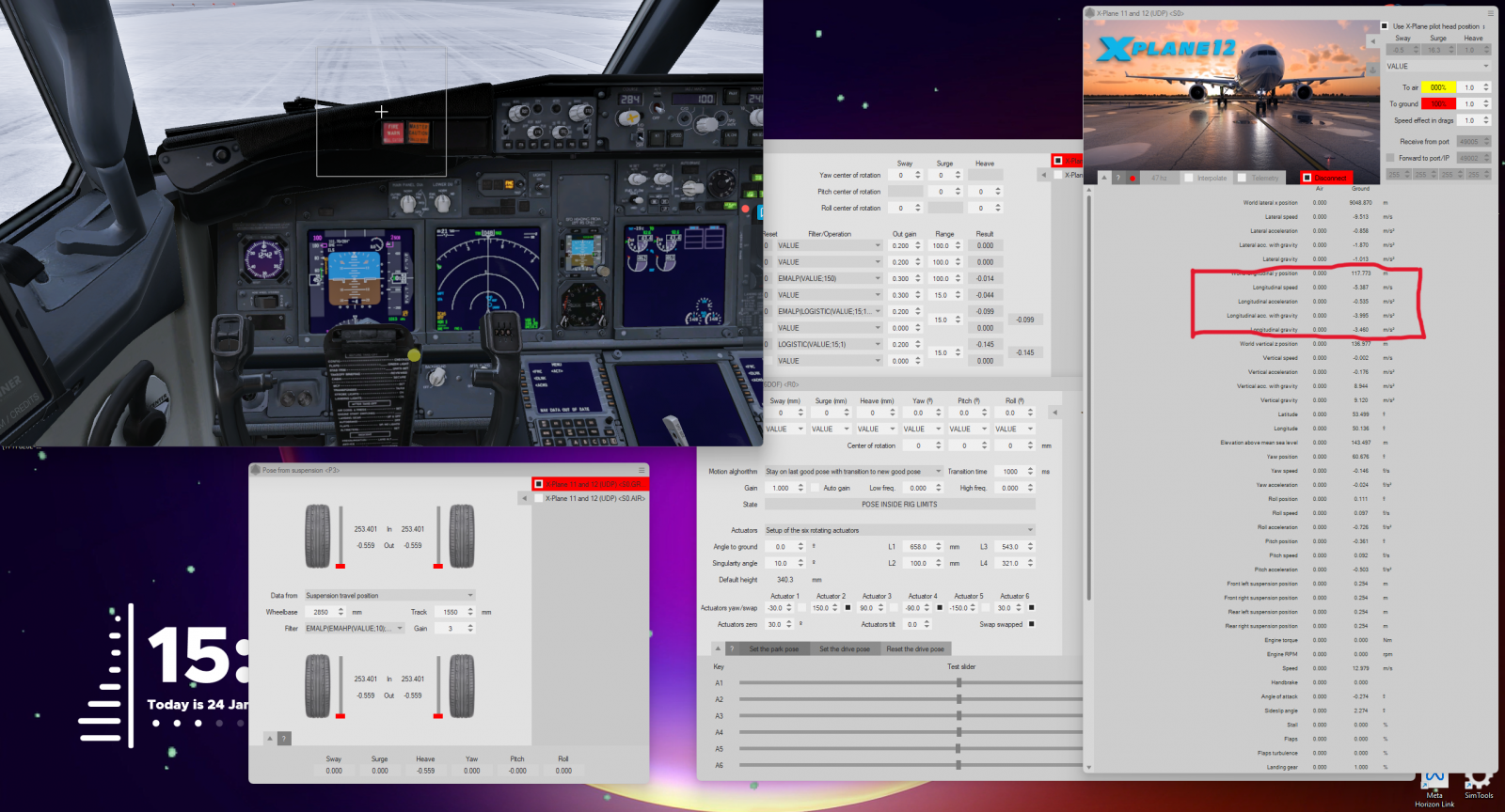

  19. Fors
    Fors New Member
    Sep 25, 2023
    8
    63Coins
    Is your plane on the ground or in the air? I'm having trouble with the data on the ground.
  20. hexpod
    Apr 18, 2016
    1,218
    berlin
    7,838Coins
    +376 / 5 / -0
    DC motor, 6DOF
    In air. In air or on ground it shouldn’t make any difference.
    Make sure you use vertical/longitudinal/lateral accel. without gravity and post superposed values like above.
    I am away from the rig and can’t remember if we have to choose with or without gravity in xplane.
