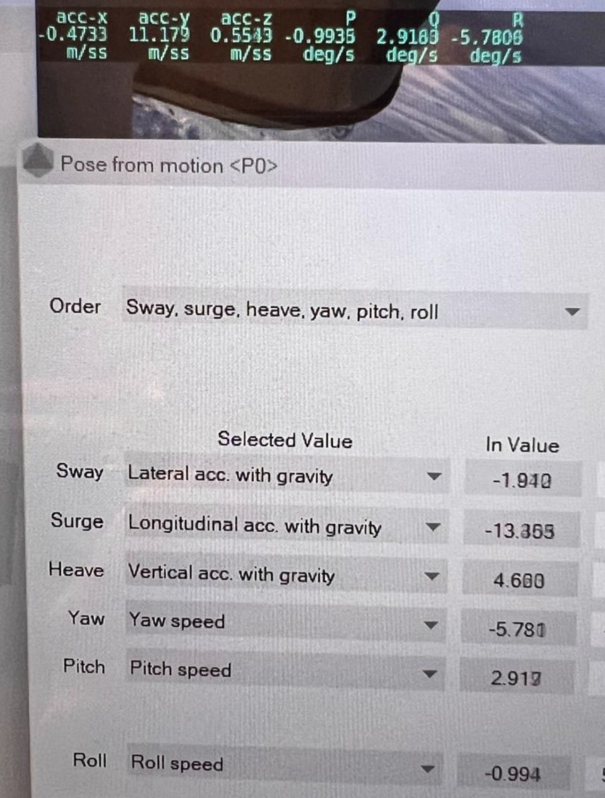

    Please check the acceleration/deceleration in different directions on the ground.
  2. Fors
    Fors New Member
    Sep 25, 2023
    8
    63Coins

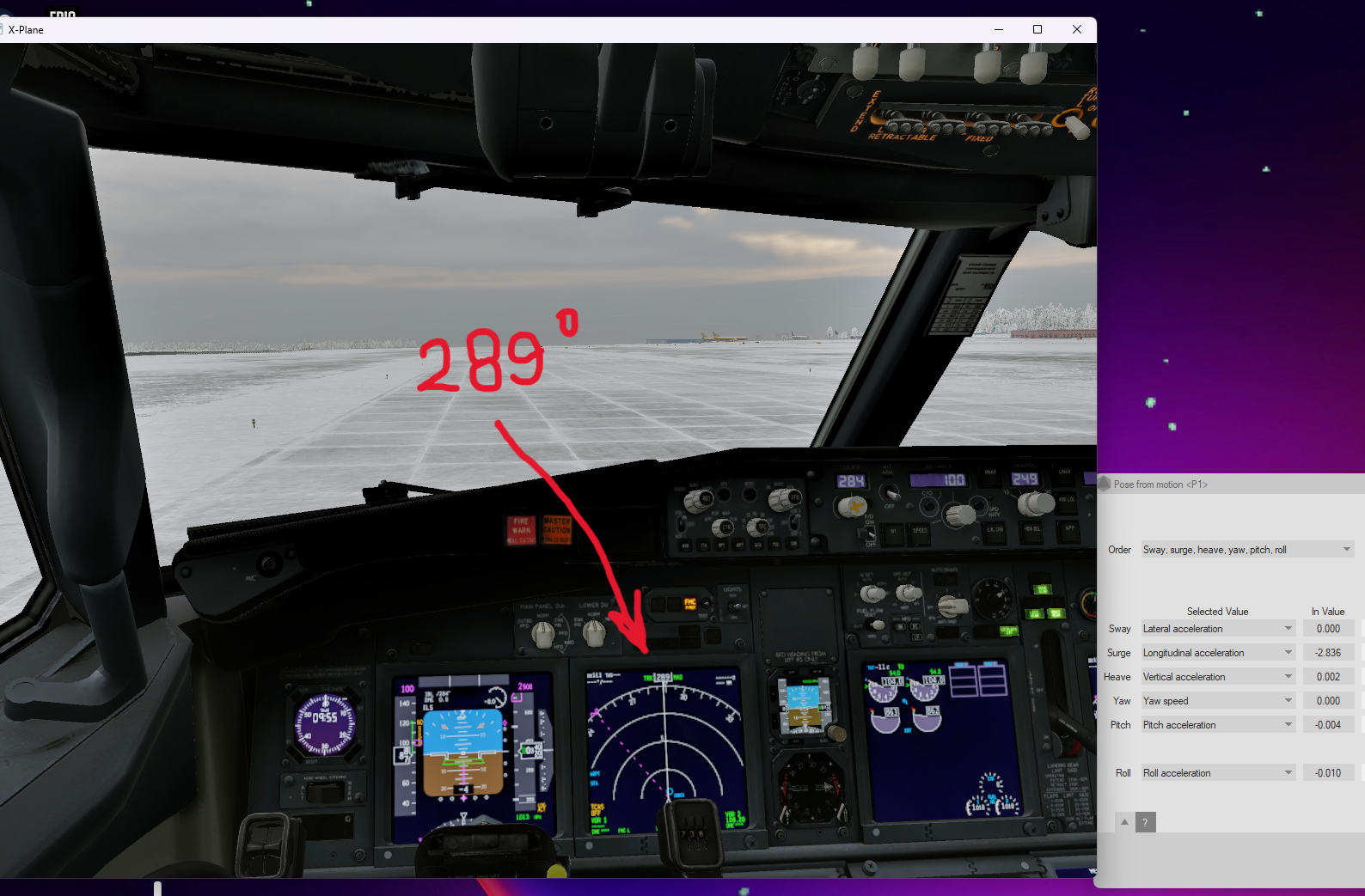

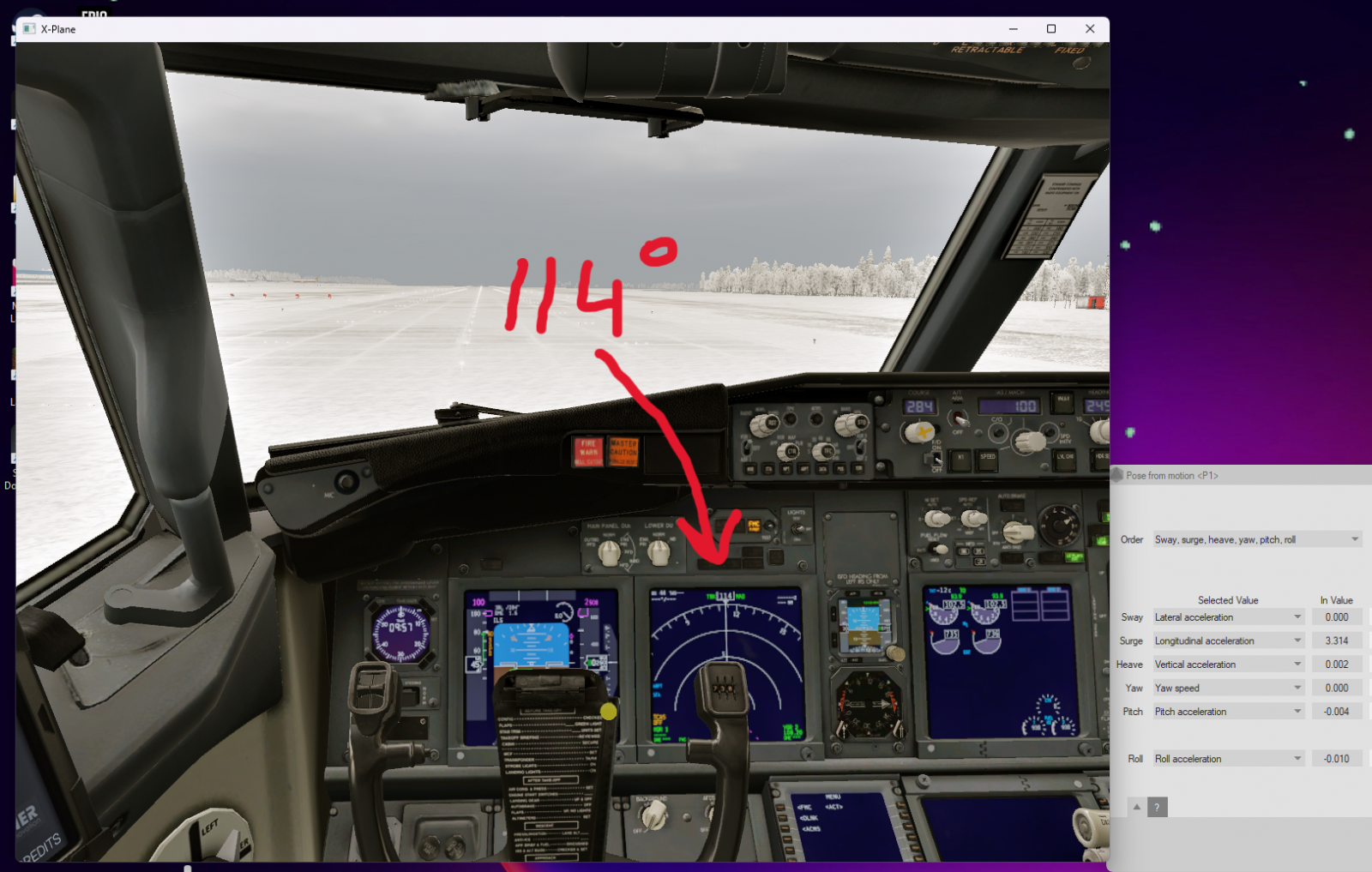

    screenshot 1 (longitudinal acceleration) heading 114 in value (3.314)
    screenshot 2 (longitudinal acceleration) heading 289 in value (-2.836)
    Why did the values become negative?

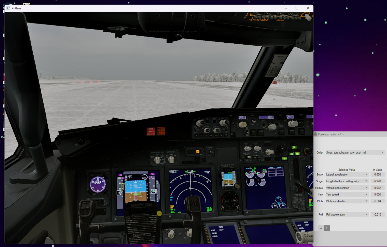

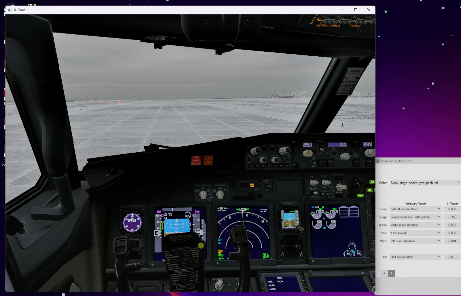

    screenshot 3 (longitudinal acc with gravity) heading 111 in value (6.920)
    screenshot 4 (longitudinal acc with gravity) heading 293 in value (-3.350)
    The same. Why do the acceleration values become negative when I turn the plane 180 degrees? 1.png 2.png 3.png 4.png

    Definitely a bug.
    Variables acc-x acc-y acc-z (had gravity as well as cor-correction included)
    @pmvcda they should be picked by Mover under “accel. with gravity” unaltered without any math. “y” seems to be vertical.

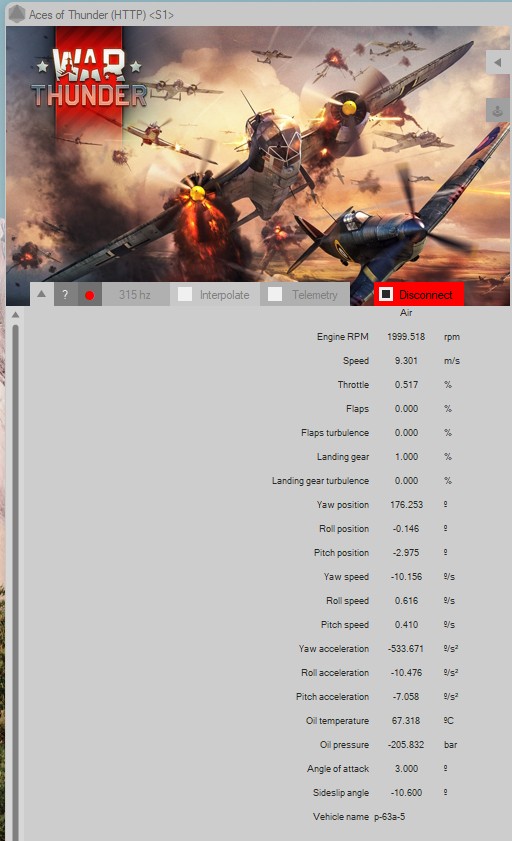

    This would be great! Especially if the War Thunder Source Module does not work with Aces of Thunder (which finally should be released in a couple of days, on February 3rd). Actually I hope telemetry support goes beyond the rudimentary data of WT!
    Gaijin finally abandoned the 'free to play' model, so just holler if you want us to buy you a copy! ;)
    EDIT: Can now confirm that the WT Source Module can be used for AoT (Aces of Thunder), too.
    Hey @pmvcda Pedro, is that another of your magic? Reading in the telemetry slots dynamically?
    After migrating my old WT profile to Mover 3.7.0.17 I see alot more data than before! For pitch, roll and yaw we now have not only speed, but also acceleration! Still missing are longitudinal and lateral acceleration and ─ most unfortunately ─ all Z-axis (Heave) data.
    Of the values shown in WT source module all but the ones for flap and gear turbulence seem to be filled with realtime data!

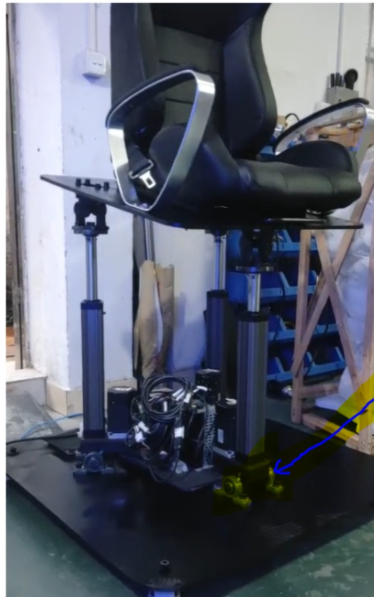

    Any one has any idea how I could control this kind of rig within FlyPT ?
    There are only 3 linear actuators mounted on a revolute joint (bearing)
