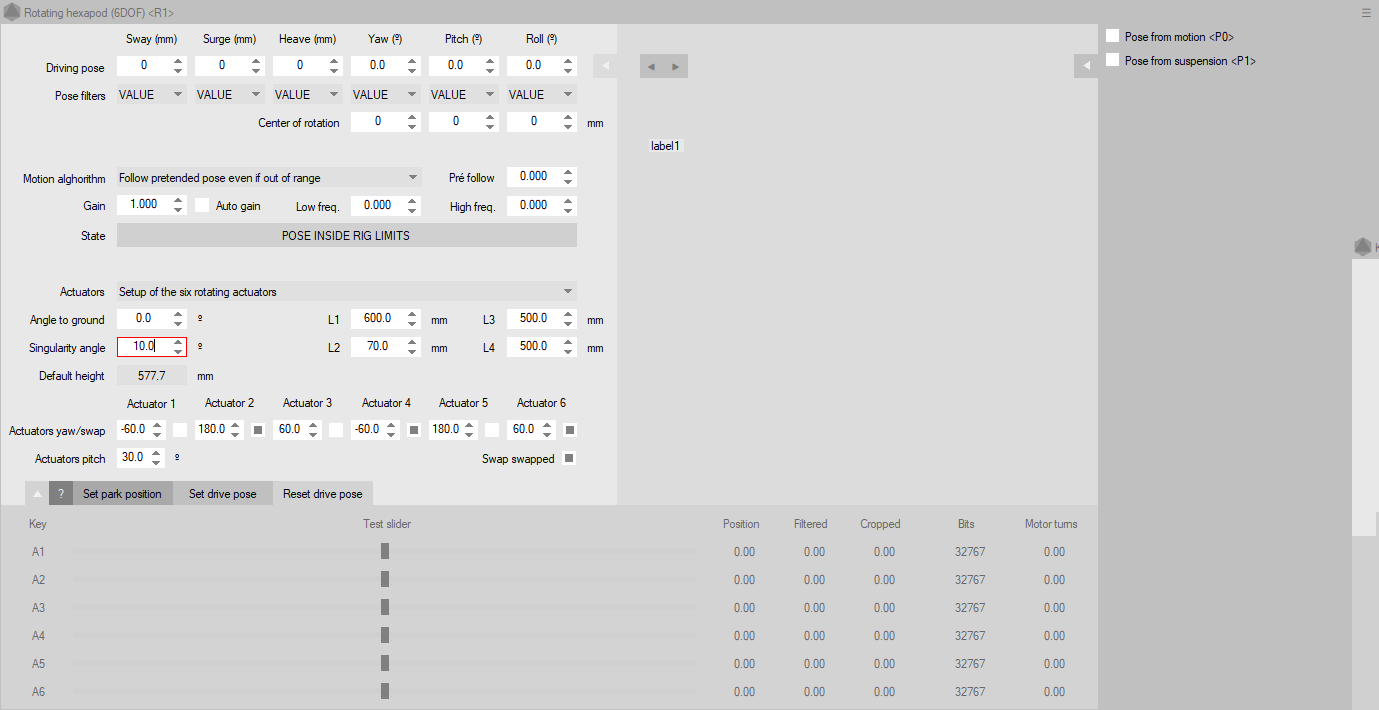

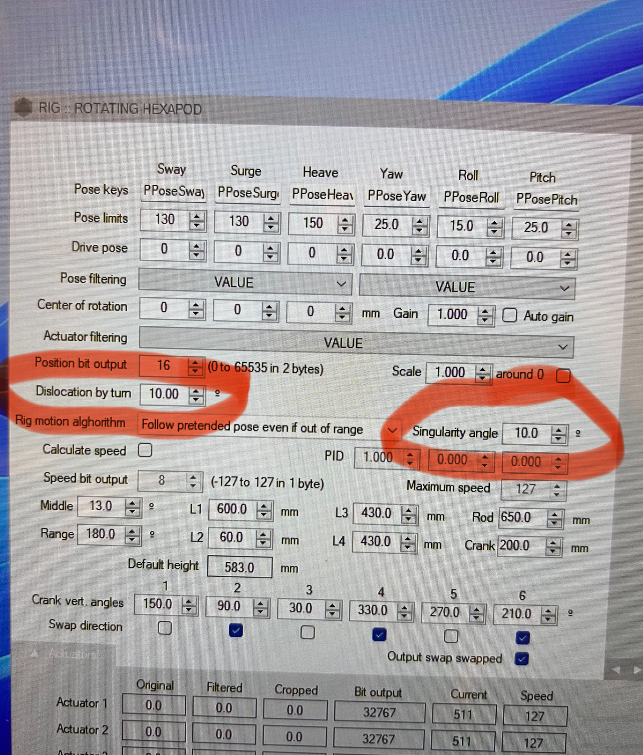

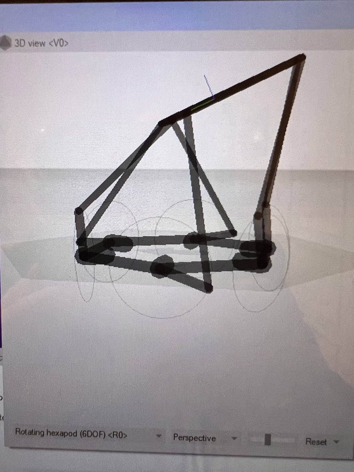

    The singularity is there:
    The one in red
    The pre-follow is a parameter for the follow pretended pose alghorithm.
    As you increase the value, the rig starts following the pretended position sooner.
    Use it with low values, 1 will stop moving the rig, or almost nothing.
    Better try than explain:
    Put 0.1 on the value
    Reset to 0 all pose sliders
    Move just yaw
    You can see the pretended position and the calculated one that goes behind the pretended
    With a value not zero you start getting behind sooner. This means you get more motion for bigger out of range values...
    Hope you understand what i mean.

    This looks like a scaler because from the beginning the assigned pose is not 100% followed. Interesting.
    concerning „stay on the last good, please look in the attached Beta. Maybe it will help you remember what you did
