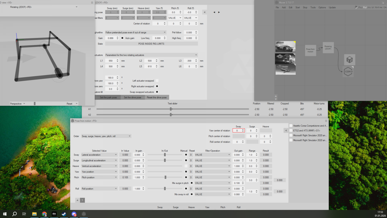

  2. hexpod
    hexpod http://heXpod.xyz
    Apr 18, 2016
    1,222
    berlin
    7,864Coins
    +378 / 5 / -0
    DC motor, 6DOF
    Important to understand - to tilt your platform, instead of angular positions, you should choose angular velocities (usually present in all titles acting only when you are torquing). What should tilt you platform is the gravity component (if not present natively in the game telemetry, you can add it in mover)
    Than selecting „mix surge in pitch“ and „mix sway in roll“- option should add and subtrac all the forces in a correct manner automatically.

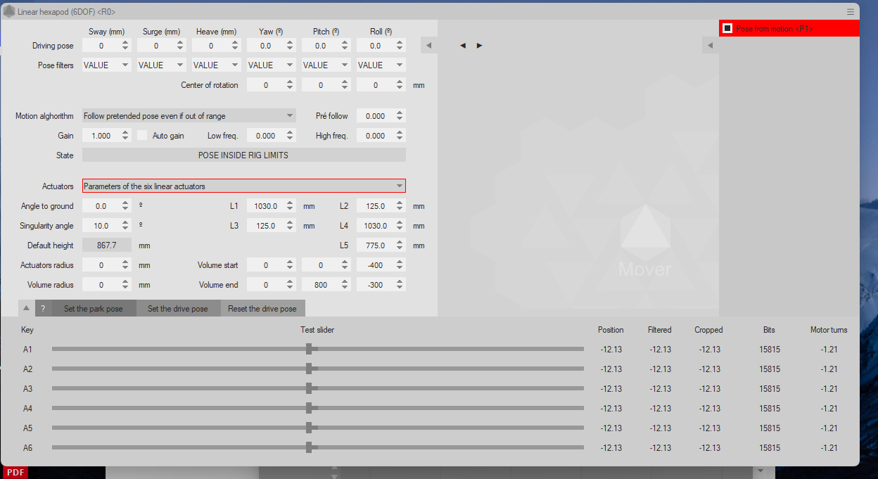

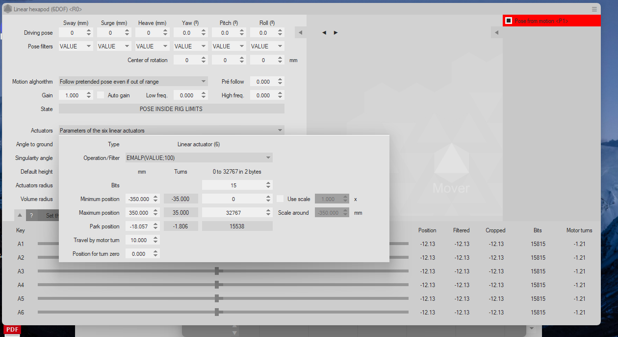

  4. Flymen
    May 19, 2018
    353
    Montreal, Canada
    2,491Coins
    +195 / 2 / -0
    DC motor, 6DOF
    @pmvcda
    After several attempts, I haven't succeeded with the new 3.7 program.
    I have almost the same setup as you on your Sim, though. 3.5 is still working very well, and I'd really like to have the chance to try the new one.
    If you see anything !!!!
    I have no communication with the outputs / esp32
    If you ever get the chance, I'll send you my program.
    Thanks again !:sos
  5. pmvcda
    pmvcda aka FlyPT
    Nov 3, 2010
    2,272
    Portugal
    15,902Coins
    +2,716 / 18 / -0
    Latelly I'm testing on another rig that uses UDP. From what I see, your settings are correct.
    I will try to test this weekend on the older rig.
    Do you get any motion? Nothing?
    Are the values updated in the send field?
    Send me the setup to test here (the old and the new one), but should be a bug on my side it it's working on the old Mover.
    The new Mover uses a new logic to generate the data sent to the hardware that is faster than the old one, so using the new one would give you less latency.

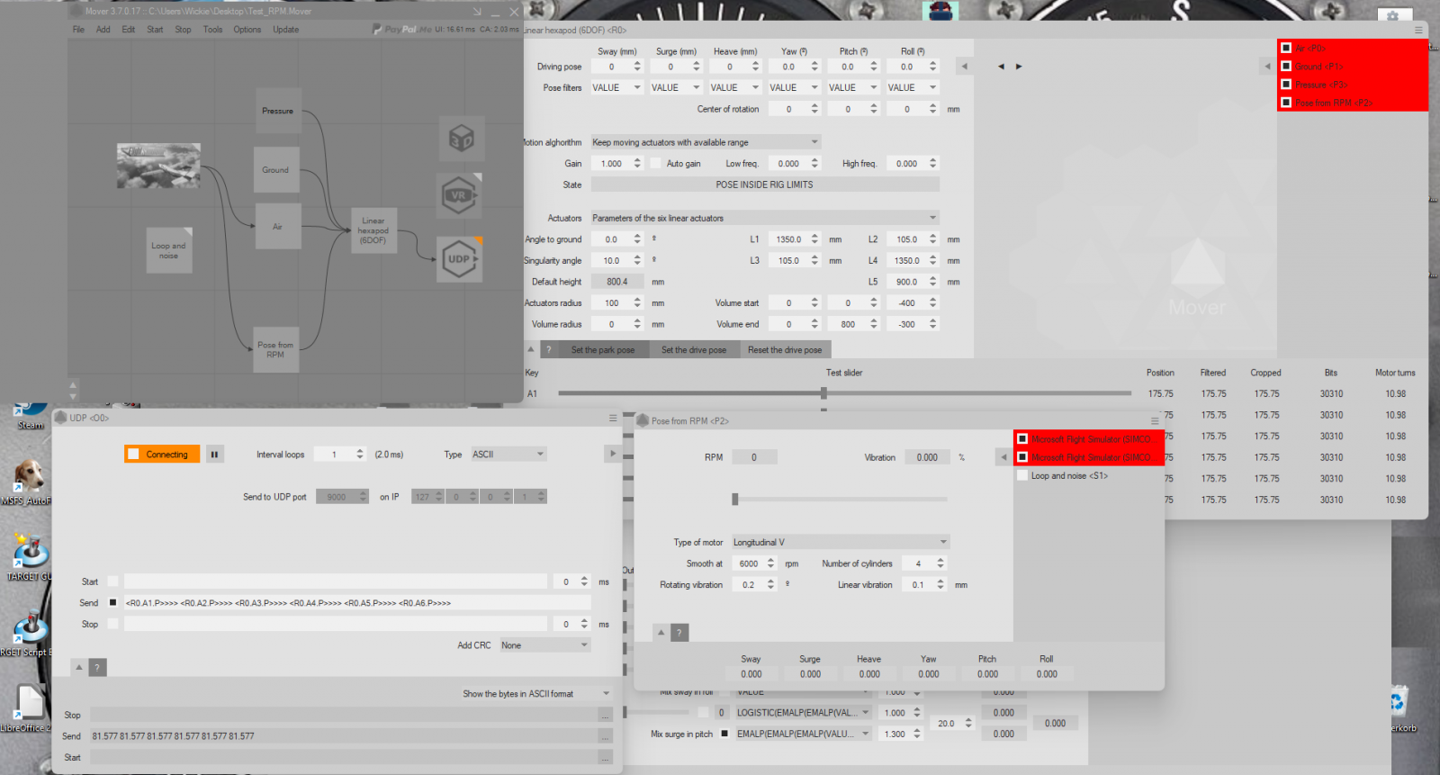

  6. PeterW
    PeterW alias Wickie
    Oct 21, 2018
    230
    Dipl. Ing. Mb (FH)
    1,767Coins
    +428 / 3 / -0
    Hi @pmvcda, I have a strange behaveour when I add a pose from rpm to my rig:
    When connecting the UDP output (for the CAN-bridge), the actuators start driving towards the middle position, but stop at around 80mm (from 175 mm to the middle-position). Then mover sticks and do not react anymore.
    Do you have an idea, why?? Maybe a bug? (Note: I can reproduce the behaveour with attached *.mover - files).
    Without the pose from rpm my rig is working great
    Thanks a lot !

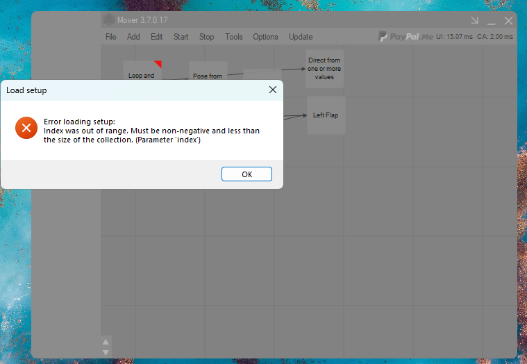

  8. Trigen
    Trigen Active Member
    Nov 25, 2018
    491
    2,892Coins
    +184 / 1 / -0
    2DOF, 3DOF, DC motor, Arduino
    Using any filter in Direct. 3.7.0.17 Not working :)
    Code:
    System.ArgumentOutOfRangeException: Index was out of range. Must be non-negative and less than the size of the collection. (Parameter 'index')
       at System.Collections.Generic.List`1.get_Item(Int32 index)
       at Mover.Directs.FromOneOrMoreValues.DIRFilterOperationChanged(Object sender, EventArgs e)
       at Mover.UI.DIR.<.ctor>b__31_1(Object s, EventArgs e)
       at Mover.UI.AFC.set_Text(String value)

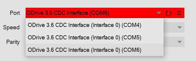

    Hi, I have a very annyoing issue with outputs when connecting to ODrives (I have 3 of them)
    Serial ports change their names every reconnection, or starting Mover app. Sometimes it adds "(Interface 0)" to the name and Mover cannot recognize port with previous name, so I have to select new one from the list 3 times. How to change the port name permanently? Is it Mover problem or Windows problem? Or maybe ODrive problem?
    Merry Christmas and Happy New Year !

    Hello, I encountered this problem while creating the platform. When I set the pitch to 3, the platform already touches the floor? How can I fix this? After watching your videos, I was surprised how you set the values to 20 and higher, but also 999 for acceleration. Can you explain how to do this?
    I've attached all the photos. 109036

    Can you tell me the video please.
    In the new Mover there's some internal changes in the Pose that might cause some problem. I will check.
    But when you speak of 20, 999 I'm not understanding what you mean. Wich values?
    From your other posts, I see you are using SMC3. Did you set the actuators correctlly? Is the pitch in the rig matching the pitch in Mover?

    Greetings to you and happy belated holidays
    Thanks for the reply, I was really looking forward to it, checking my email the whole time, etc.
    I'll send you a video soon with the exact settings and so on. I'm just at work right now... what a bad time, hahaha.
    When I wrote 20 and 999, I meant the results in the range column in the (Pose from motion) tab, specifically 20 in the Pitch and Roll window and 999 in Acceleration and Sway.

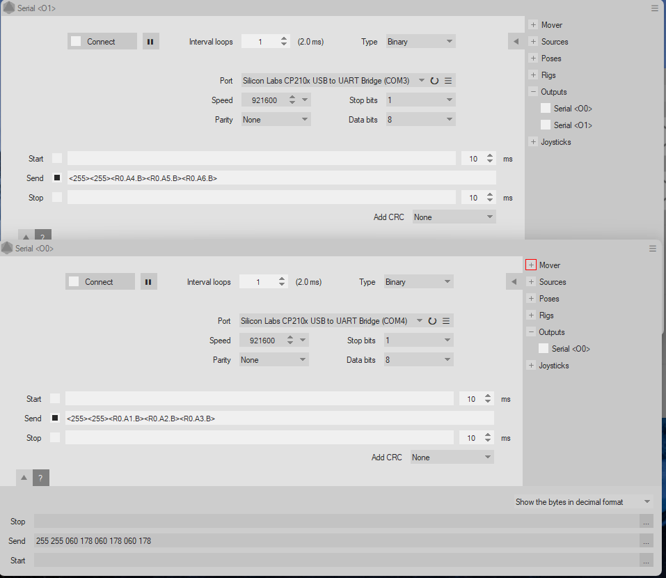

    If I connect an 8bit output serial to control an arduino to o-drive everything works fine using 3.7.0.17. The same setup in 3.5.3 does not work. The two attached mover files are one for Mover3.5.3 and the other for Mover3.7.0.17 I first assumed some weird serial port setting or something but tried both configs on a different computer with the same result. Mover3.7.0.17 correctly outputs 8 bit serial to a Nano R4 and Mover3.5.3 does not.
    Hopefully someone has seen similar and has a simple solution. My rig with Mover3.5.3 driving an M4S controller works perfectly otherwise.
    Something to do with how my Arduino is reading the data?
    I assume it's most likely a problem of mine, just not found it yet after lotta hours troubleshooting.

    Attached is what I get when trying to open a setup. As soon as a filter is added in my Lt Flap Direct the attached error occurs on opening setup:

    Same failure occurs if you make any change to the Direct, does not have to be a filter. Modify the gain and it'll error out.
