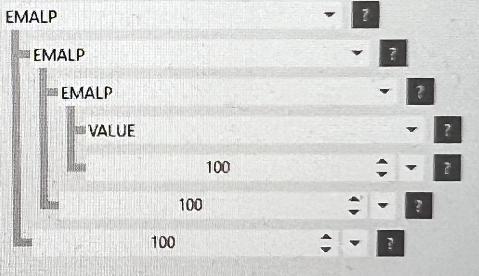

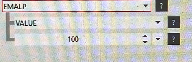

    You can keep this basic rule in mind:
    Exponential Moving Average Low Pass (EMALP) 1st. Order:
    EMALP 2nd. Order:
    EMALP 3rd. Order:
    EMALP 1st order keeps the response pretty vivid which means the start impulse will remain swift and slow down just after. (Higher value more smoothing effect)
    If you want to smooth the first impulse as well use EMALP second or third order. (One EMALP over another).

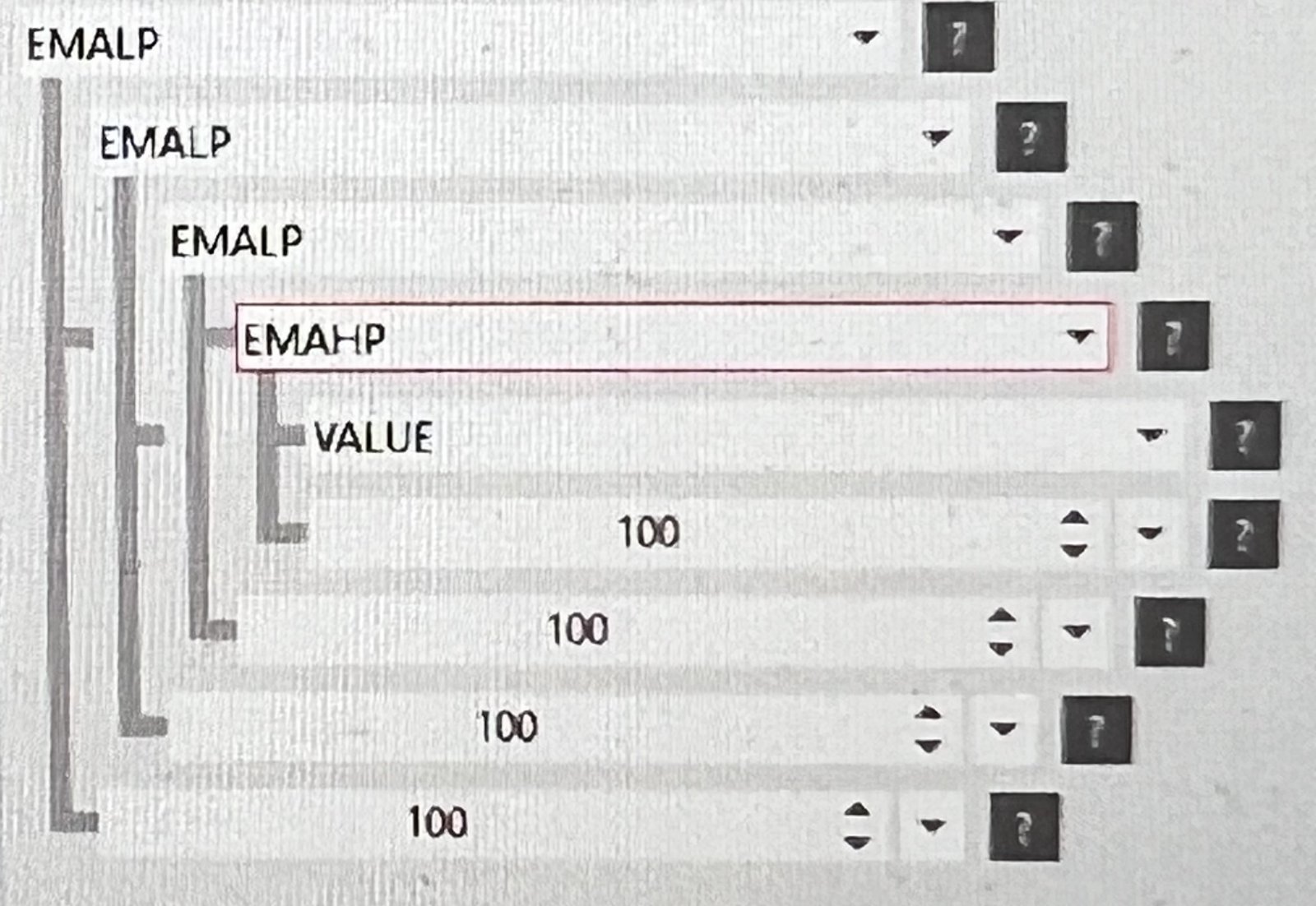

    you can add EMAHP (High pass) to keep the movement close to the center (Lower value faster return effect)
    That’s simple nevertheless very powerful basics to start with.
    Edit:
    In most of the cases you don’t need more than that - with a good balance of those combinations you can go very far in signal processing.
    Experiment with this before you choose more advanced filtering.

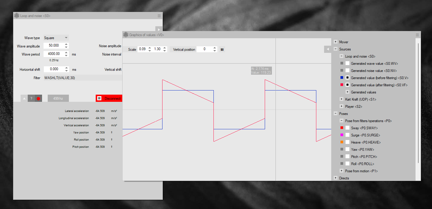

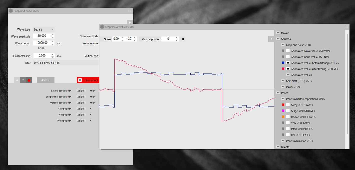

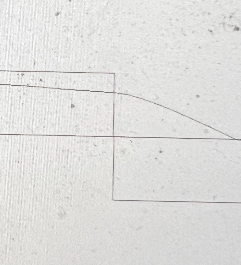

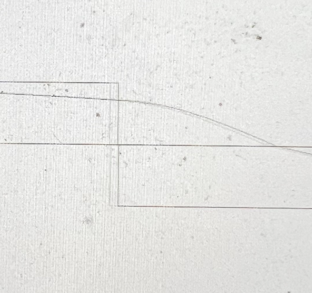

    There's now a WASHLT filter. Here you can set the maximum speed a value goes back to zero.
    WASHLT(VALUE;10)
    Means the maximum speed is 10mm/s or 10º/s if a rotation
    Example in action (red after filter):
    We can see that the variations are kept but the value is going back to zero.
    With some noise:
    Would like to smooth start and stop, but it's near impossible to do it. I have no ideas right now for that.
    EDIT: But this is washout not any target value, for that there's a MAXDELTA if I remember...

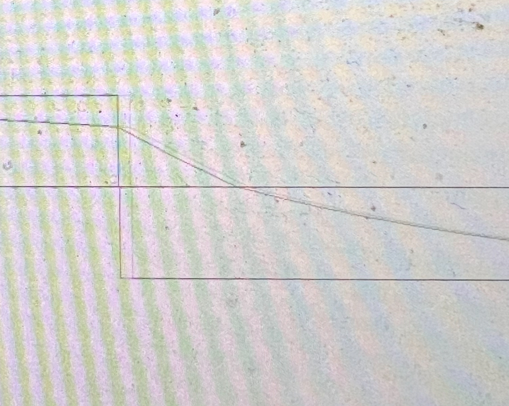

  8. pmvcda
    pmvcda aka FlyPT
    Nov 3, 2010
    2,180
    Portugal
    15,394Coins
    +2,604 / 17 / -0
    Is this the follow alghorithm or the transition from last good pose?
    Sorry, can't see in the image
    EDIT: Ignore, I already know, in my test I was using the wrong one lol

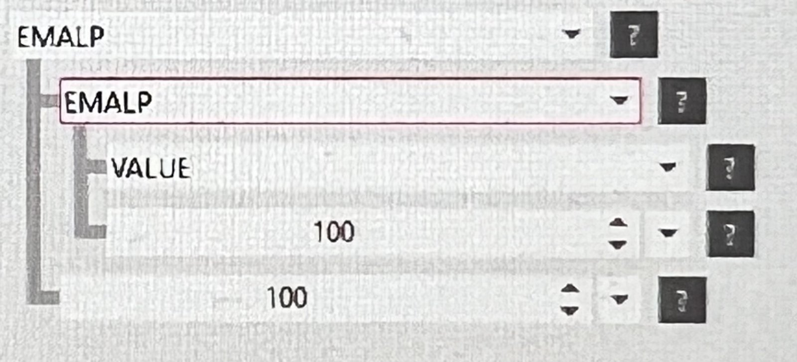

    Higher values for the 1st order EMALP alone will make the “corner” less steep (abrupt), nevertheless you’ll always keep the small kick. Imagine a zero delay reaction.
    second order:
    Third order:

    You understood I think, it depends what and how you want to “smooth it better” :).
    Use 1st order if you want to keep signal details (no delay) and use ordering 2nd or 3rd if you want to make everything smooth and swim.
    Most of the time I use on a 6-dof 1st and 2nd order for the main dofs and 3rd order for coordination channel. (Mix surge in pitch - mix sway in roll)

  13. pmvcda
    pmvcda aka FlyPT
    Nov 3, 2010
    2,180
    Portugal
    15,394Coins
    +2,604 / 17 / -0
    @hexpod ,
    Seems it's solved for next release. Hope tomorrow. In the middle of other problems...
    Looking close, we can see the transition is made and that while transition is performed we follow the latest requests to the rig

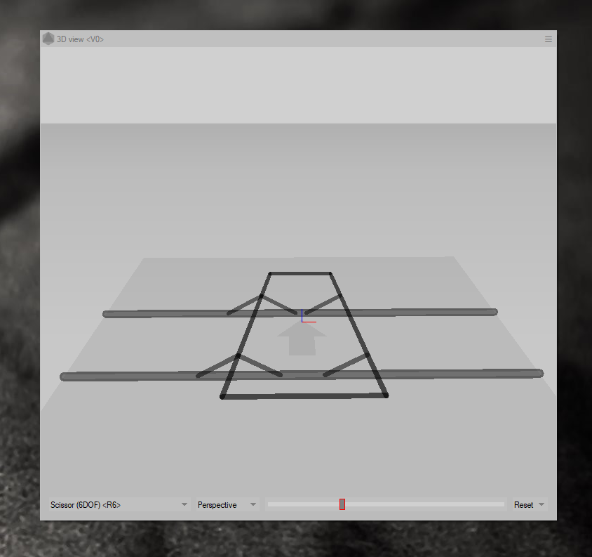

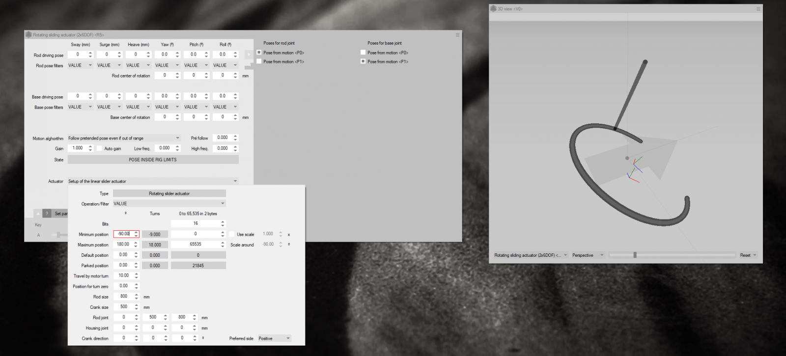

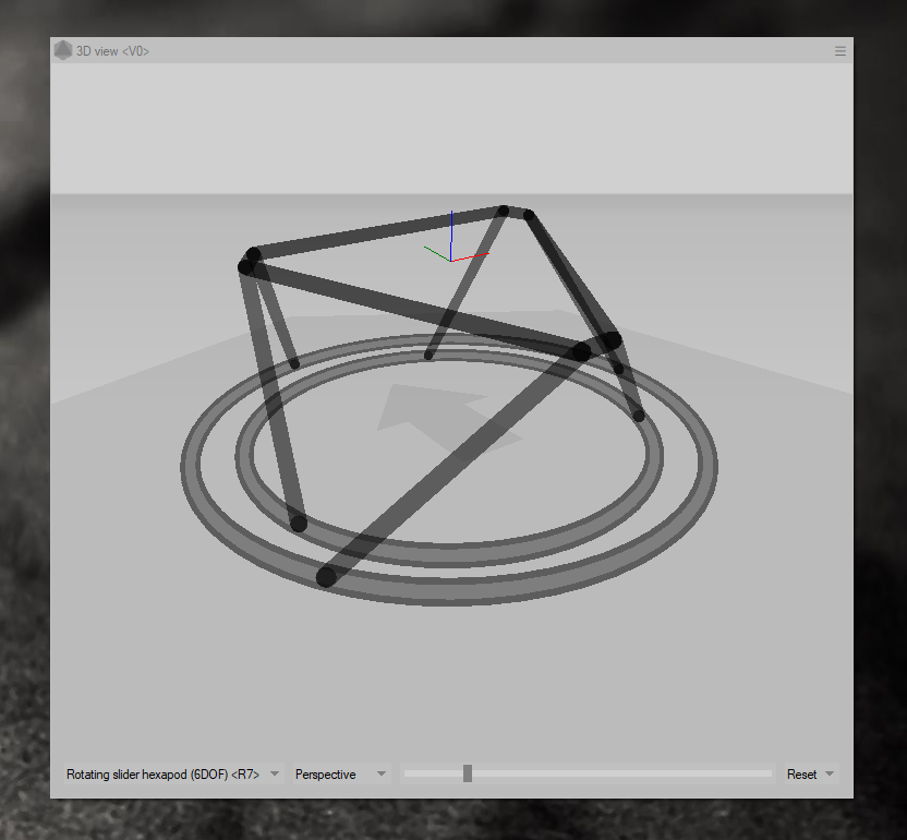

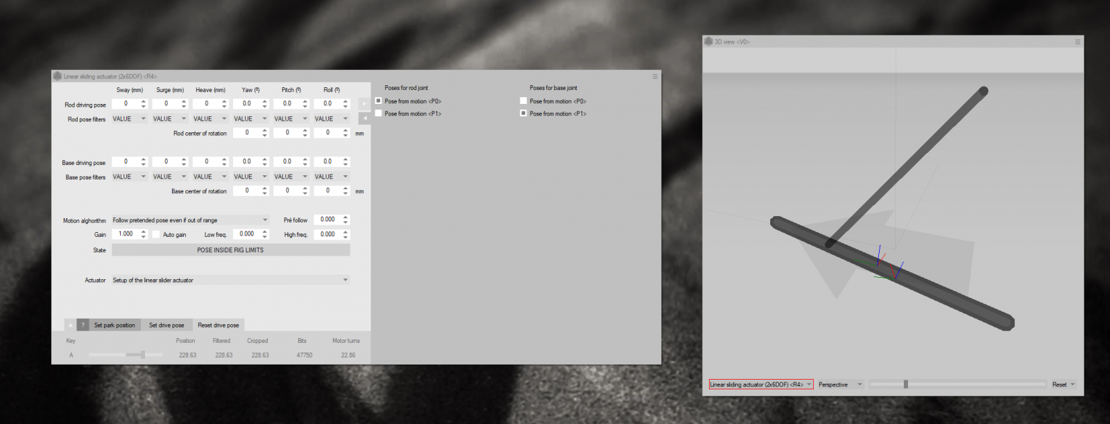

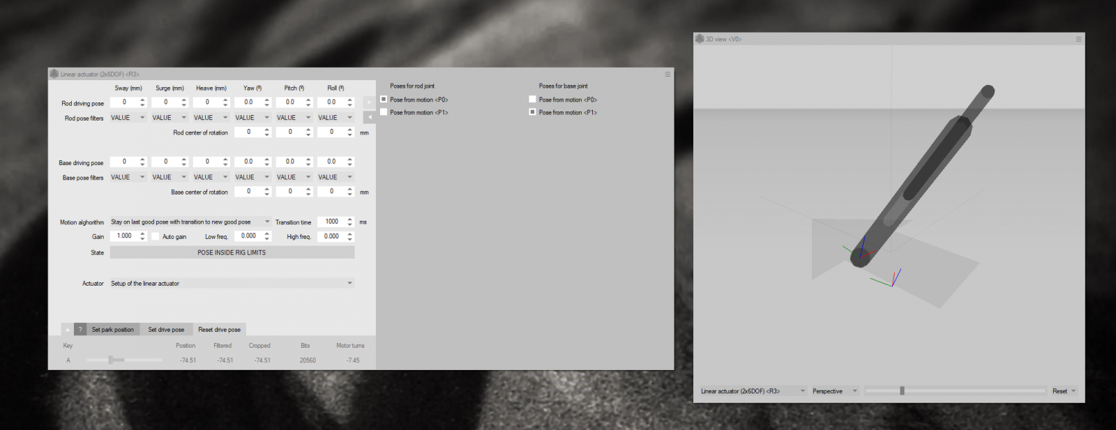

    Some new features in Mover:
    Actuators with two poses, one for each joint:
    New types of actuators:
    A bar with a joint on a linear rail (sliding linear):
    That actuator on a rig:
    A bar with a joint on a circular rail (sliding linear):
    The actuator on a rig:
    Some others....

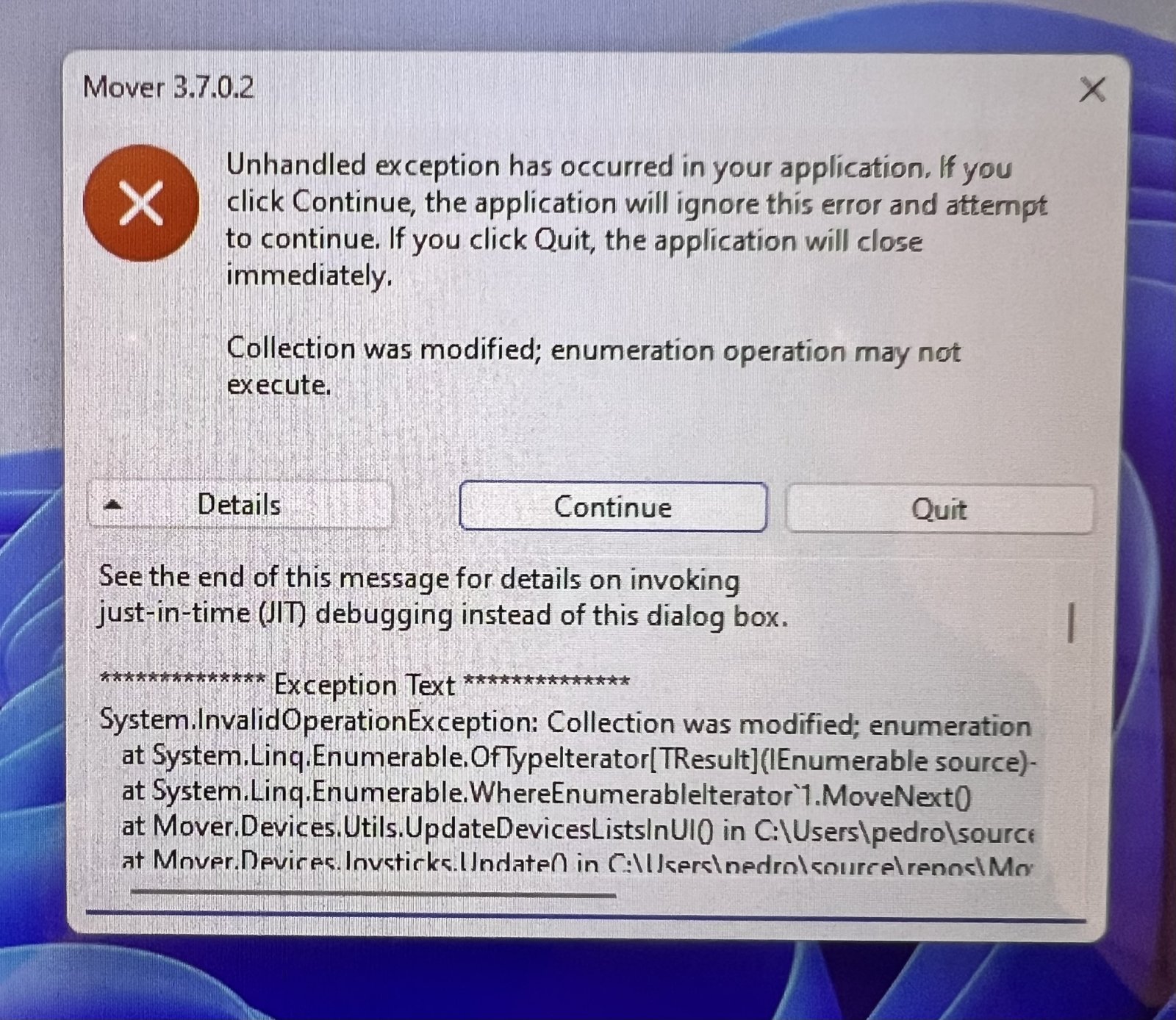

  15. hexpod
    hexpod http://heXpod.xyz
    Apr 18, 2016
    1,205
    berlin
    7,751Coins
    +373 / 5 / -0
    DC motor, 6DOF
    System.InvalidOperationException: Collection was modified; enumeration operation may not execute.
    at System.Linq.Enumerable.OfTypeIterator[TResult](IEnumerable source)+MoveNext()
    at System.Linq.Enumerable.WhereEnumerableIterator`1.MoveNext()
    at Mover.Devices.Utils.UpdateDevicesListsInUI() in C:\Users\pedro\source\repos\Mover3\App\Devices\Utils.cs:line 9
    at Mover.Devices.Joysticks.Update() in C:\Users\pedro\source\repos\Mover3\App\Devices\Joysticks.cs:line 158
    at System.Windows.Forms.NativeWindow.Callback(HWND hWnd, MessageId msg, WPARAM wparam, LPARAM lparam)
