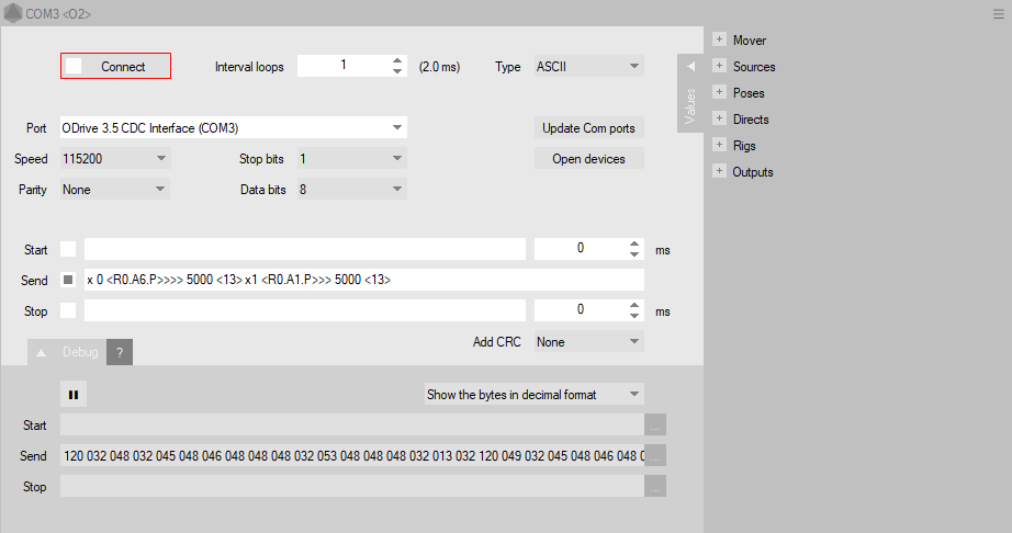

  5. SilentChill
    2,645
    20,588Coins
    +3,567 / 34 / -0
    Been really busy lately so not had chance to try again but I still can't get my rig to move all I get is a clunk and the values move but the rig stays still. Using Bits doesn't work either

  6. PeterW
    PeterW alias Wickie
    Oct 21, 2018
    228
    Dipl. Ing. Mb (FH)
    1,755Coins
    +426 / 3 / -0
    Hi Craig, do you still use the same Odrive-Firmware? I think this expects cpr and not turns, so maybe you get something like 1/8192 turns (so close to nothing) because I think Mover 3.7 gives turns to the Outputs? Maybe you already have this in mind.

  9. SilentChill
    2,645
    20,588Coins
    +3,567 / 34 / -0
    I didn't use any kind of filtering in the old Mover I just put the string into Mover and it worked set at 18 bits. I have no idea why its not working I've tried everything I can think of but it just doesn't change anything. There must be some difference between the old Mover and new one to make it not move at all. I have set the bits to 32 and 64 but it makes no difference.

  11. pmvcda
    pmvcda aka FlyPT
    Nov 3, 2010
    2,180
    Portugal
    15,394Coins
    +2,604 / 17 / -0
    @SilentChill , also it's x1 or x 1, seems there is no space in your string
  12. SilentChill
    2,645
    20,588Coins
    +3,567 / 34 / -0
    Using ascii
    I was just testing with spaces and no spaces and no speed that was a quick screen grab.
    Old setup was x 0 <AxisA1> 5000 <13>

    Found a bug causing an error in the byte format... It will be solved in the next release.
