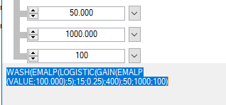

    That wash... it's an experiment with high pass filters. Not good enough in my opinion

    It's because it's not washing out properly. Washout should be a constant slow rate below perceptible levels, not a decelerating movement.
    Edit: Actually it should start slow and slowly accelerate below the perception level and do the same for the stop part.

    Agree, reason to have DELTAS in the filters.
    The WASH should use them. Have some ideas but did not implement yet
    That part on feedback is 75% done, hidden in the code.

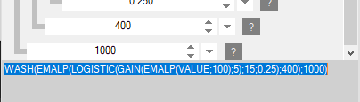

    I'm not sure if I understand, maybe you mean This to the right of the motion algorithm? It seems doesn't work

    In the pose you have 7 gain, try with 1 and remove the actuators filters
    Edit, yes thats that control

    If remove the actuators filters I lose the actuators maximum speed right?

    Seems all actuator filters do not affect Motion Compensation and 3D view in any motion algorithm, maybe I am wrong about something.

    I think we are talking different things. Any filter on the actuator is not going to show on the 3d view.
    This would require lots of calculation.
    Thats why i say you should use the motion alghorithm to kind of logistic all the rig when reaching limits. With that you see the results in the 3d view and have vr compensation.
    Actuator filters are there for simple actuators or experimentation or for who has no vr and wants to control motion in the actuators
    Rig motion should be on the rig not actuators or motion cueing is useless.
    I undestand what you want, to make it safer near the actuator limits, but with the motion alghorithm that's already there

    Thank you Pedro for the explanation, now I've got it. You are right in my case the option "Follow pretended pose even if out of range", Now I understand what "motion algorithm" is and this feature is amazing! Well done!
