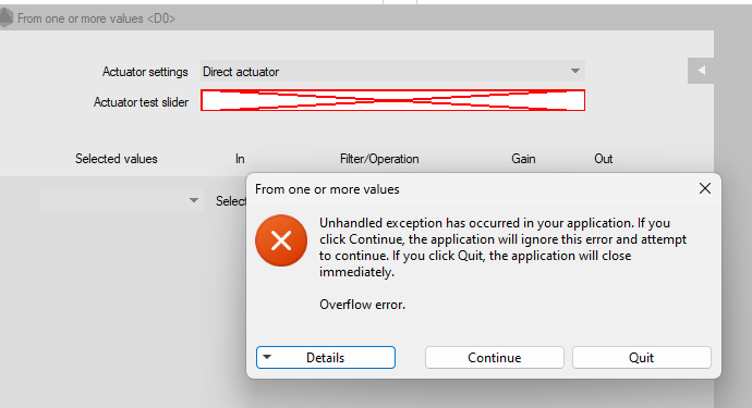

    Bug:
    Add Direct, click Actuator test slider.

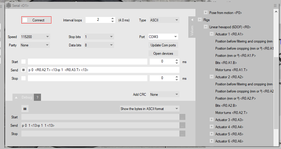

    Weird Bug: if I name my Rig "MXP" I can't get it to use its value in the serial output. If I name it "MXP1" same problem. If I name it "RMXP" it works and I can reference it.

    What I see is that when you change the key, The key in the output is not updated... It's visually, but not in the calculation showing a blank output.
    Changing the key in the string or dragging another key, updates it correctlly.
    When possible, can you confirm this please.
    Also, some confusion can come from name and key. Name is just what shows in the window while key is the important one.
    EDIT: OK After some more testing, it's worst than I thought.... Looking for the bug right now

    Hi Pedro!
    I did some first adaptations and tests with Mover 3.7 on my 6DOF Odrive-Rig.
    I modified the "old" output-string to the new one: "p 0 <R0.A2.T> <13>p 1 <R0.A3.T> <13>" (here for the actuators 2 and 3).
    I used the motor turns T for my Odrive, because the official Odrive firmware expects the positon in turns (thanks for this feature !!!!)
    So far so good.
    After some try and error with some settings, the actuators moved to the expected start positon - WOW :)
    But as you can see here in this short video :
    it seems that my rig gets only the full turns (integers) and not the decimals (floating) ??
    In the serial-output-window I was only able to switch between "binary" and "ASCII" but I was not able to choose "decimal" like in the "old" mover. Maybe this could be the reason?

    HAve
    Try using <<R0.A1.T> instead of <R0.A1.T>. That should set the output to a double (float)
