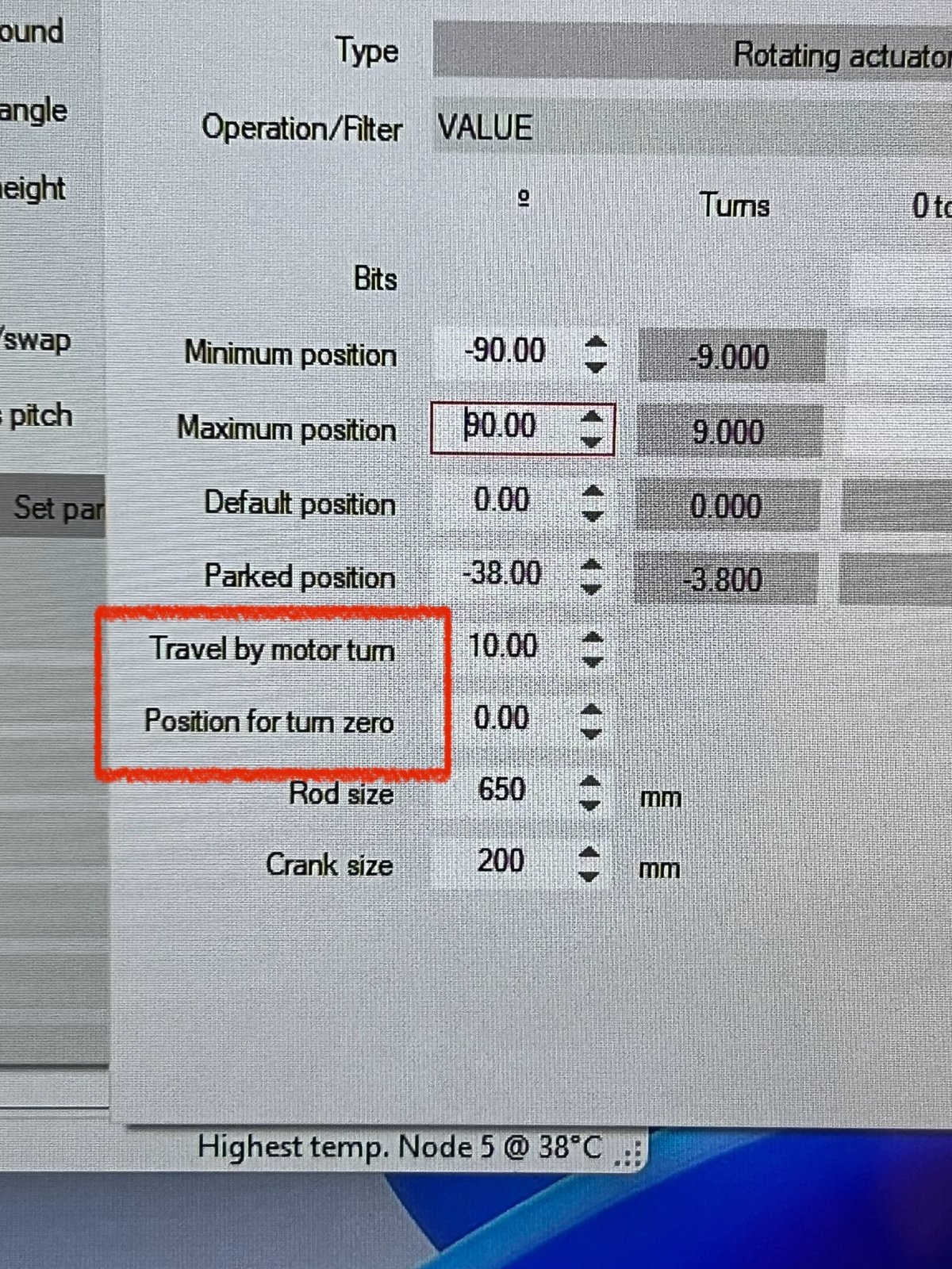

    Some rigs (odrive) receive the number of turns as a position.
    For example 1 turn can be 1mm
    Also we need to set where is turn zero in the actuator position (min/max)
    Edit: instead of mm it can be degrees

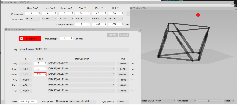

    Is this the correct way to set COR? See pic, red dot is head location.
    In MC, head location I put measure from COR to real head location?
    With these in OXRMC config file I put zero to COR values?
    I have rig where seat is below the top joints of rig.
    Edit.
    And in the RIG module COR values dont align with Sway, Surge and Heave

    I advise one empirical solution :
    Whatever you choose as center of rotation of the platform, set up slow rotational loops in Mover, start with yaw and once on the platform, move OXRMC indicator in the HMD until you find a position where it will be steady. Doing so you should find the correct spot for vertical axis IMO. Similarly you can proceed for the two others.

    That is how I have set OXRMC before.
    In Flypt VR MC, head location overrule OXRMC COR values? Or how to use these values?

    The default COR (0,0,0) of the rig is the center of the top platform (hexapods).
    The head distance to the COR can be:
    x=0mm, head lateraly aligned with the center of the top platform
    y=-70mm, head 70mm behind center of top platform
    z=+350mm, head 350 mm above top platform
    If the game physics are relative to the COG (center of gravity) of the vehicle and you know (can estimate) the head position in the vehicle relative to the COG then you might have a distance like (example of a car with driver on the left):
    x=-300mm, the head is 300 to the left of the COG
    y=-100mmm , the head is 100mm behind the COG
    z=+600mm, the head is 600mm above the COG
    To get the COR correction relative to the COG:
    x=300-0=300mm
    y=-100-(-70)=-30mm
    z=600-300=300mm
    This is good for small distances like cars, not for planes where you should use the correction in the pose.
    With this, you don't need to adjust the head in the VR compensation module.
    If you have an hexapod, then let's be real and simulate the position of the driver. You can't do it in other rigs where the COR is on the floor like the 4 actuators rigs. There you can make the corrections, but since there's no sway or surge, you always get those false cues.
    So what is head correction in the VR compensation output?
    Well for you, to fine tune the VR compensation.
    Or if you want it simple, put there the head distance to the center of the top platform and ignore corrections of physics relative to COG.
    For 3DOF rigs, you can just set the head position relative to the center of the 4 actuators at floor height. This corrects the rig motion for the head position.
    Now, this needs testing to be sure I got it right on this release.

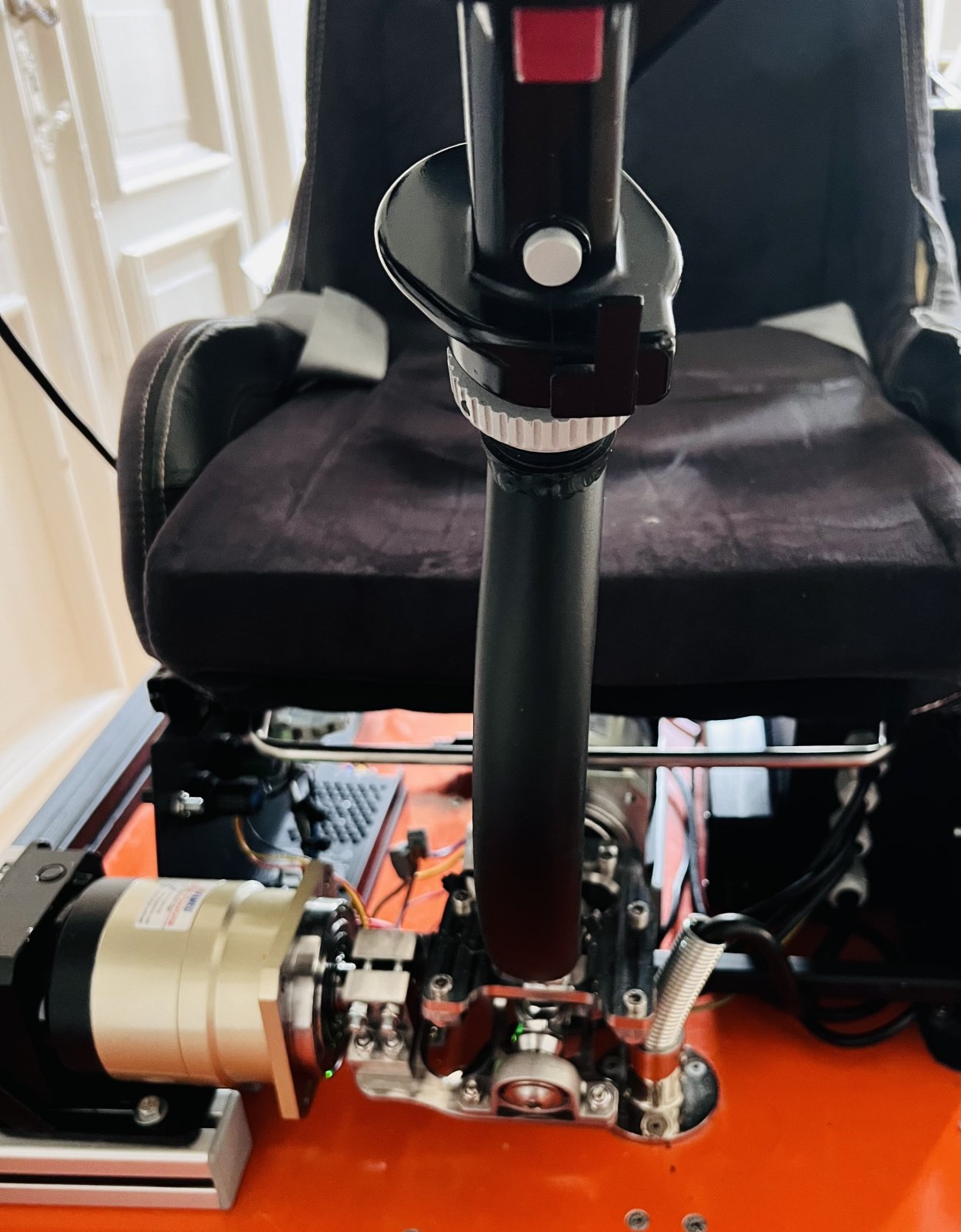

    I recently designed a pancake heavy duty joy gimbal to fit Walmis NEMA 34 proprietary servos (which have a nice anti cogging build in feature) and clever logic board (which accepts various grips) which is part of his DIY kit combo.
