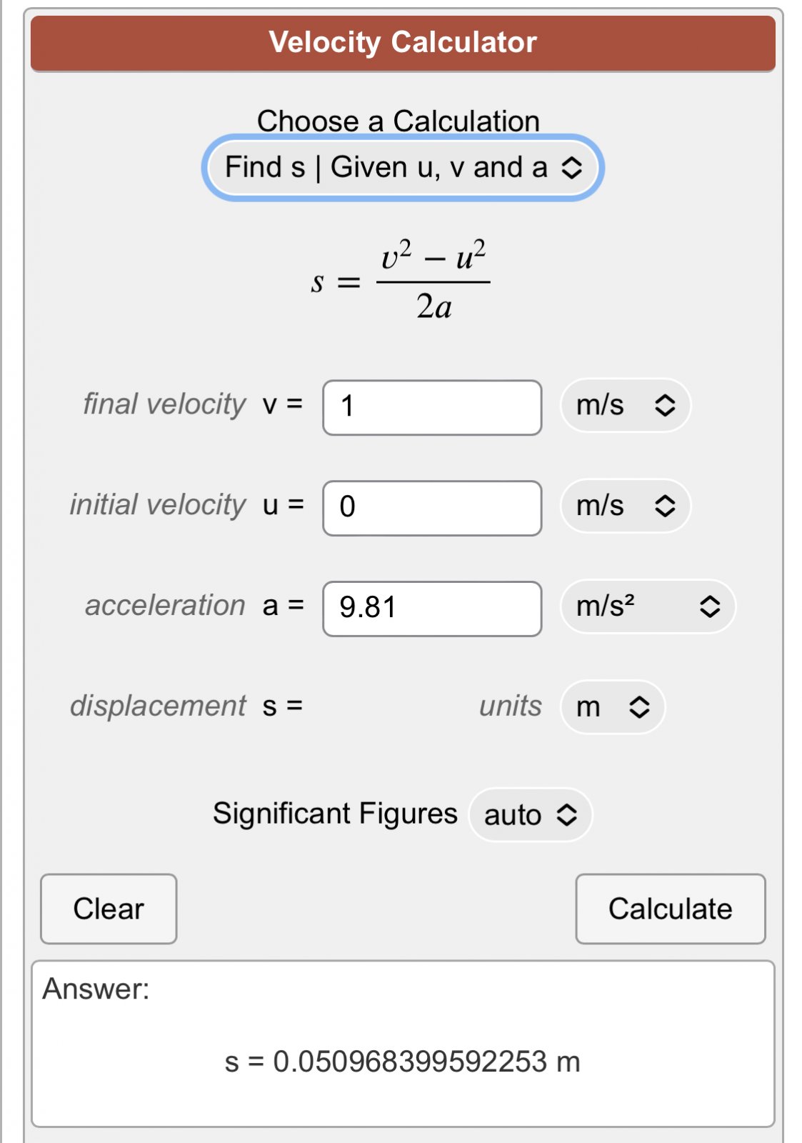

    Over 800mm you can accelerate at 9,81 during 04s. BUT at this point you’ve used the whole travel and you didn’t start to decelerate.
    https://www.calculatorsoup.com/calculators/physics/displacement_v_a_t.php

    so if the max speed of an actuator is 1m/s we can simulate 1G acceleration over a displacement of 5cm. That’s the limit.
    someone corrects me please if I am wrong.

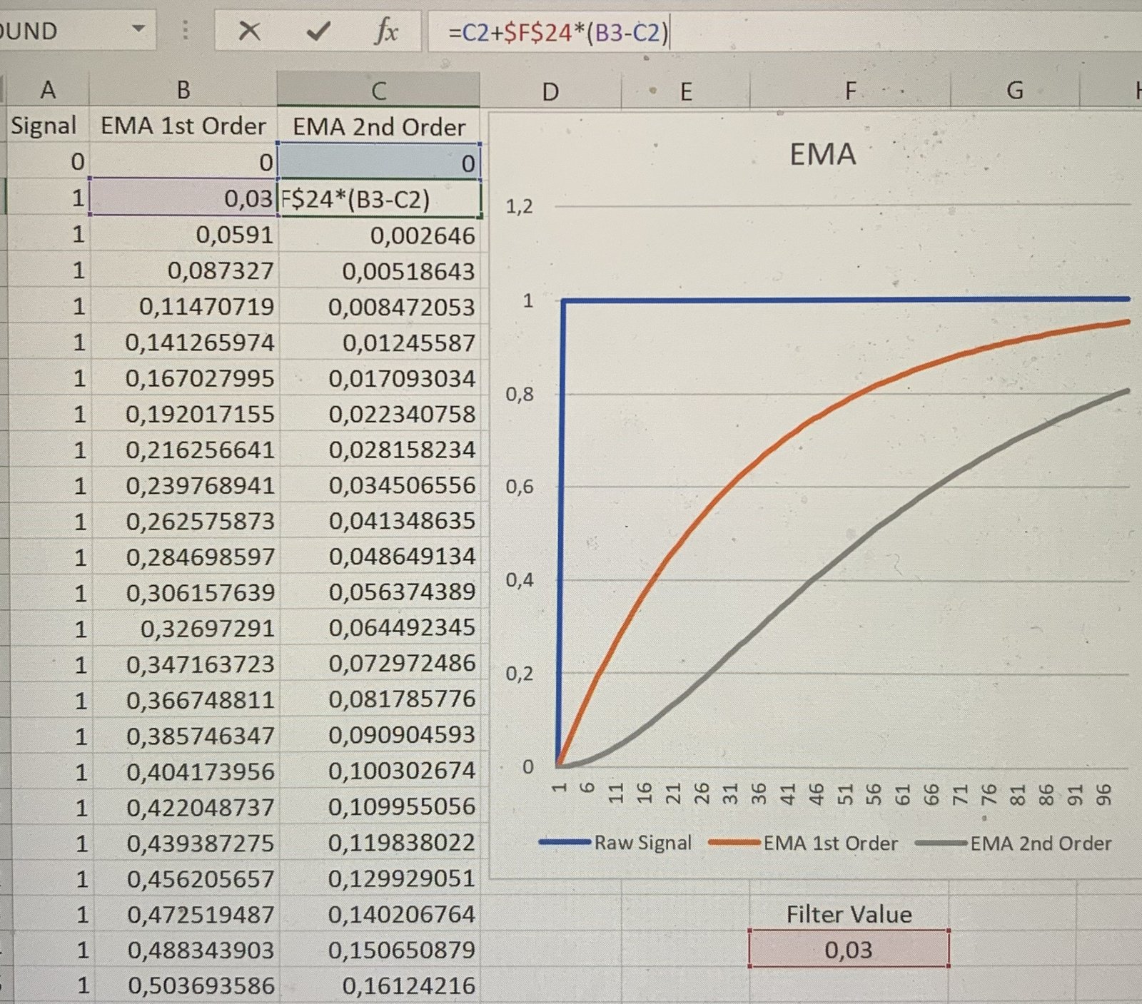

    I think you just have to select the right filter for the job. For longitudinal acceleration that should be an H1L2 type of filter (as I call it) or "EMALP(EMALP(EMAHP(Value)))" as it is described in Mover.
    This filter system will effectively feel like an acceleration ramp together with a "washout".
    Try it out... let me know how it feels.

    High pass 1st order Low pass 2nd order (H1L2). I like Mercedes Sprinter codename.

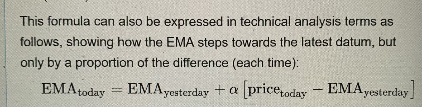

    It is indeed crucial to use the second order if you want a gentle and fast ramp.
    you can visualize the principe here :

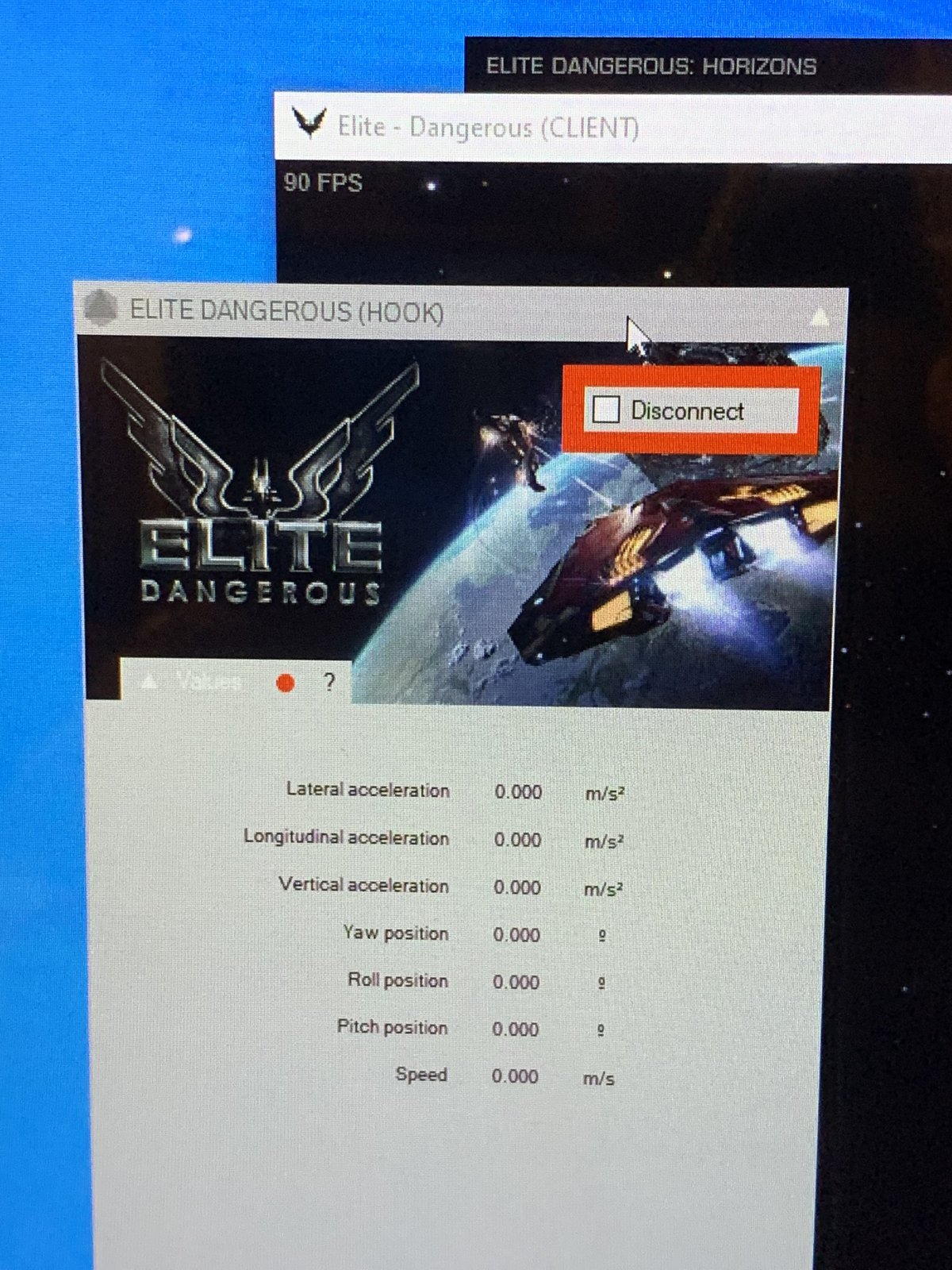

    I have trouble connecting to elite dangerous. Could someone help plz ?

    Resolved, I was able to get the motion in Mover through Elite Dangerous SimTools plugin
