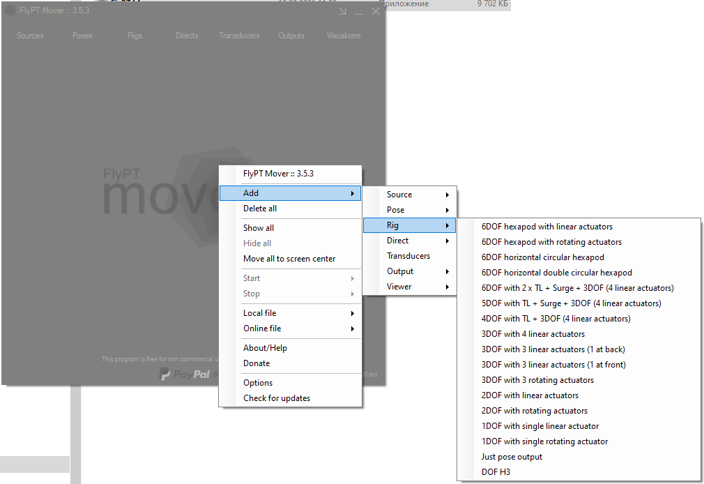

    Hello everyone. Help me, please. I can't find information about how to add a new rig. I want to try to make a 4DOF platform witn 4 linear actuator and test FlyPT.
  11. Avee
    Avee Virtual Pilot
    Jul 5, 2020
    140
    1,113Coins
    +35 / 1 / -0
    That depends on the geometry of your rig. What are the 4 DOF? If it is a square rig with an actuator leg on each corner, you need the 3dof with 4 linear actuators. That supports pitch, roll and heave DOFs. What is your fourth DOF?

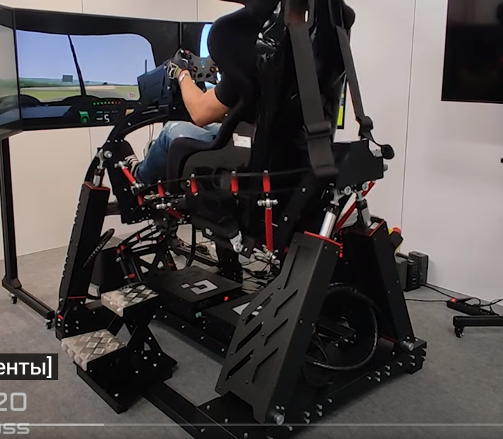

  12. MaxVi
    MaxVi New Member
    Dec 4, 2023
    Moscow
    27Coins
    2DOF, 3DOF
    Hi, i want made 4dof like on picture
  13. Avee
    Avee Virtual Pilot
    Jul 5, 2020
    140
    1,113Coins
    +35 / 1 / -0
    I don't think there is a preset for exactly this rig, but what might work is if you use the horizontal circular hexapod and limit sway and surge to zero. Just discard the inner two front actuators and pass the outer ones to your two actuators in the front.
    But I haven`t tried anything like this on my 2DOF rig, so don`t take my word for it :)
    Edit: or even better, make two rigs with the same geometry, additionally limit the first rig to zero degrees yaw. Now take the two front actuators from the first rig, and the back 2 actuators from the second rig without the yaw limit.
