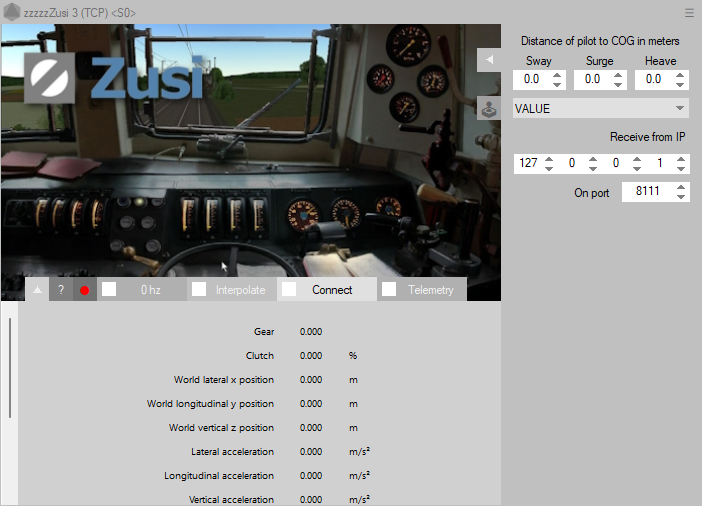

    Current version, no.
    New release has Zusi added:

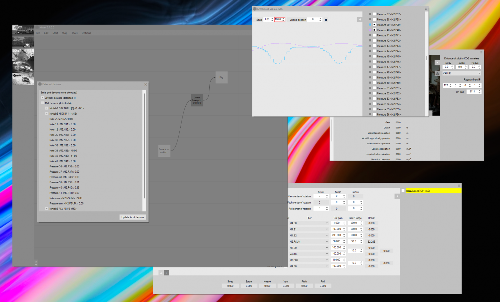

  7. pmvcda
    pmvcda aka FlyPT
    Nov 3, 2010
    1,888
    Portugal
    14,329Coins
    +2,229 / 17 / -0
    Almost...
    Midi in action
