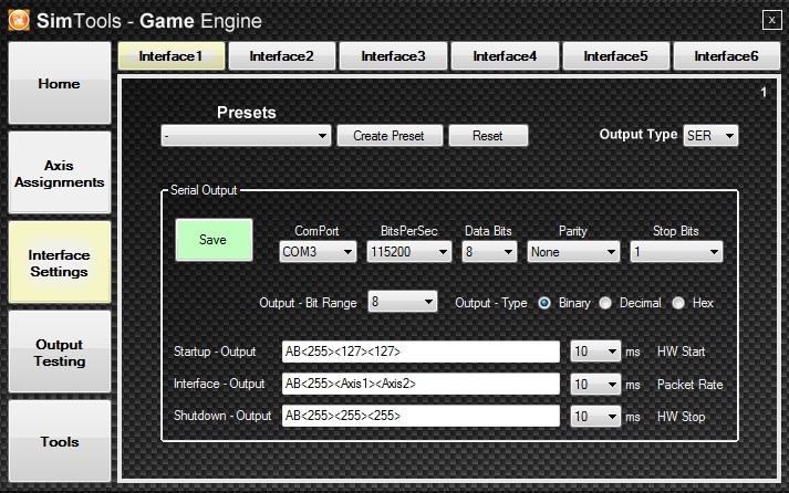

    Hi Guy’s ,
    Need to restart an old 2 dof sim and would like to know the serial to enter in the software .
    It’s for an old Thanos board amc1.6 aahah lol my first tries for a sim !!
    The serial string was to comunicate with xsim : AB~255~~a01~~a02~
    If Thanos could confirm if it will work with fly mover software ?
    Thx

    From a post in the forum (here) :
    @Thanos could confirm.
    21,032
    147,890Coins
    +10,880 / 54 / -2
    Not sure about the rest but Interface Output for SimTools 2 should be <Axis1a><Axis2a>

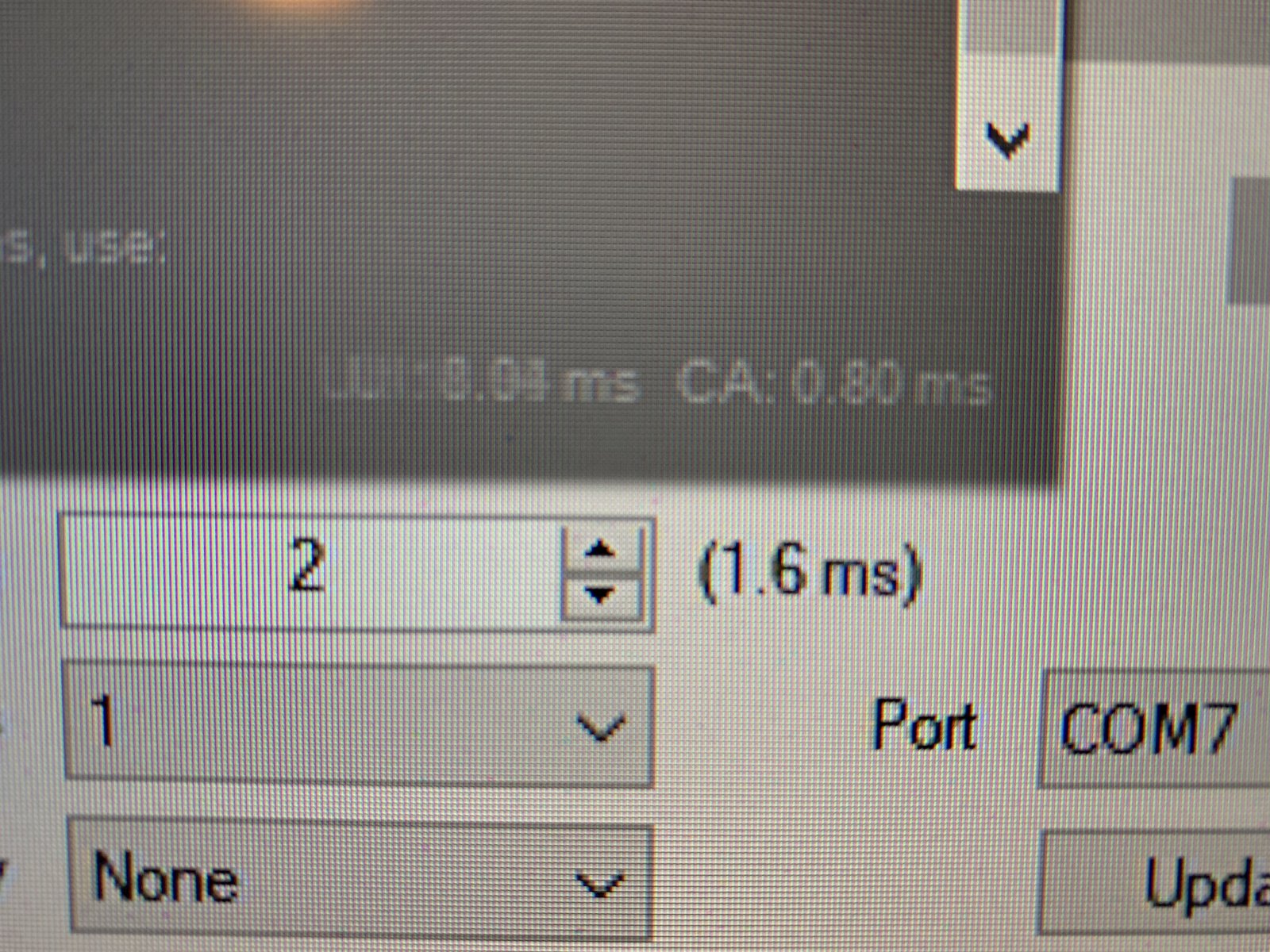

    I have a slightly jerky behavior with @Thanos dedicated interface.
    It’s all right when “high precision” is checked.
    If I want to avoid a high load consumption I have to uncheck the “high precision” mode and increase the interval loops to 2. (4ms) in the regular serial interface.
    That’s what I am observing;-)

    Are you sure that in the low resolution it keeps showing the 2 or 4 ms?
    I saw there 1.6 but after some manipulation it went to 4. I am talking about serial interface timings

    Wait it seems fine if you restart

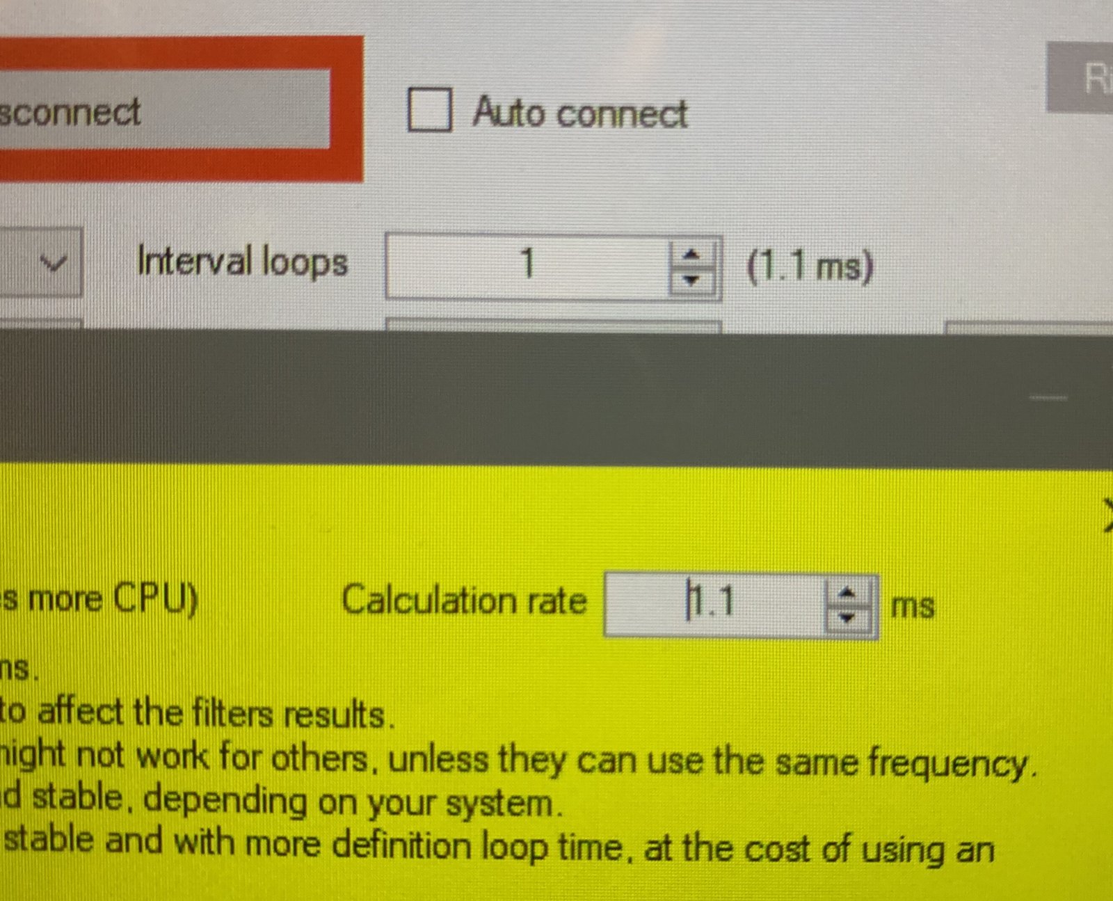

    Oh yes jerky transitions are a good symptom if you went to low with the timings. I didn’t know that the serial interface and mover timings are interdependent.
    But actually it seems there is always a way to avoid them by not going to low with them.

    Timings are related.
    The frequency that data is sent on serial, is a multiplier of the calculation speed.
    That's what you set in the output module.
    So if you have a calculation time of 0.8 ms
    And use a multiplier of 2, it means data is sent on serial at 1.6 ms.
    The idea here is that there's no need to send the same data two times if the serial is faster than the calculation (abnormal situation). So you cant set serial under calculation speed.
    Also the opposite, what Mover does is if you use a multiplier of two, it sends data in first calculation. Doesn't sent in the second, and sends again in the 3rd.
    Now, I can make it send at any rate if you find it better, but the frequency of the value sent is not the same of the calculation and values sent can be "old" or "new" in the time of calculation.

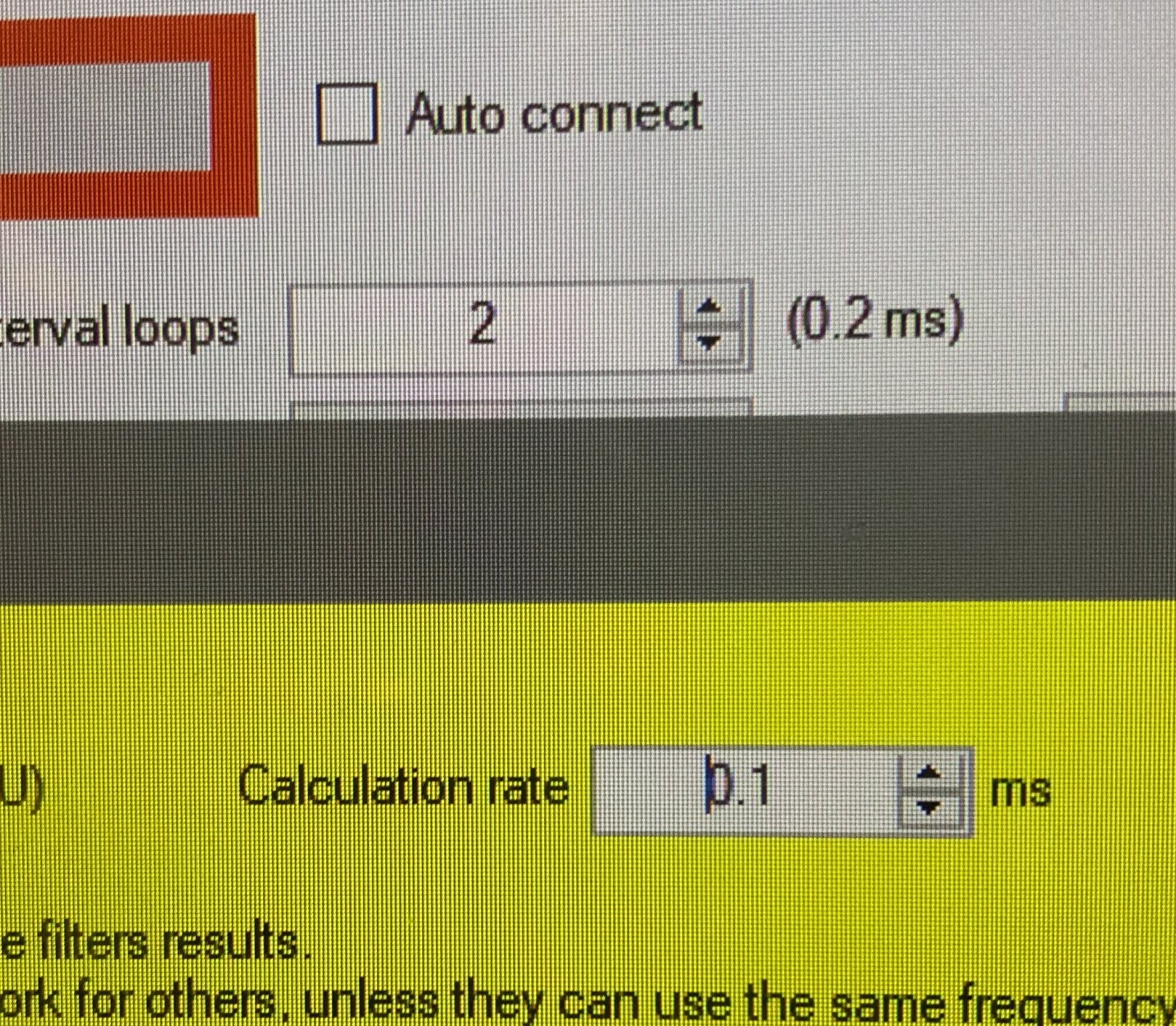

    Maybe I like better 2ms interval loops / 0.1 calculation rate.
    Hard to say. One has to test it with a scope.
    @Thanos, maybe you could give it a try to see which config is more suitable. (experimental 2.8 build)

    In my opinion, you don't need to make more calculations between serial updates @ 2ms rates. It's already fast.

    What I am sure about is that if you set the loop interval to 1, you may not go below 1.1 in calculation rate and vice versa, if you want for some reason to set the calculation rate below 1.1, you may want to set the loop interval below 2.
    Otherwise you destroy the motion smoothness.

    I don't know how the board works internally, but she might not get all the data or may have the data corrupted bellow the 2ms. I know @Thanos talks about 2ms as the minimum to be on the safe side.
    And that's pretty fast. Now you can have 0.5ms calculation (only in high precision) and send info at each 4 calculations.
    Low precision works in 1 ms steps, so minimum there is 1ms even if we set it to 0.1. The value is rounded to the next integer.

    If you transmit faster than 2ms, the AMC controller might still be processing the last position, and will miss the start on the data packet. Essentially will skip the whole packet, until it reads the ID bytes once again.
